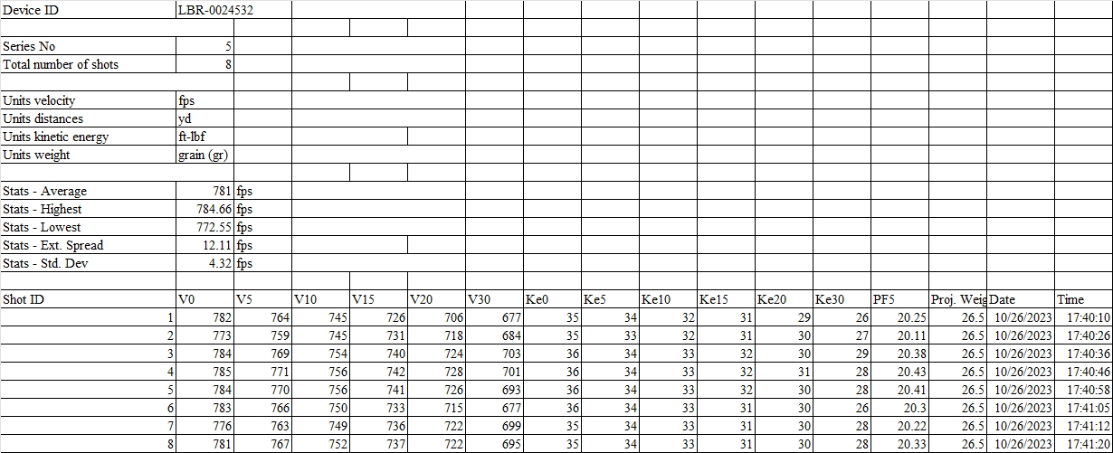

Ballistic Coefficient = 0.033134
Chris,
thank you for sharing your data! 👍🏼
Assuming typical Florida atmospheric conditions, the GPC ballistic calculator spits out the following BCs for the velocities in the table:
1: 0.0246
2: 0.0266
3: 0.0329
4: 0.0317
5: 0.0289
6: 0.0244
7: 0.0342
8: 0.0306
Something seems off with these BC values.... 🤔:
The variation between 0.024 and 0.034 is just very very large (42%).
And the BCs are spread out fairly even, as in "all over the place" — no concentration around a certain value....:
24.25.27.29.31.32.33.34
Not trying to criticize you and your shooting — just trying to make sense of the data. It wouldn't be the first time when the Labradar went off its rocker — or when wind messed up the data....

Thanks for all the work.
80 degrees
10mph from the east, so I was shooting into it. But my yard is fairly well protected
64% humidity
Pressure 30.13in (i'm about 30' above sea level)
Reactions: JungleShooter
