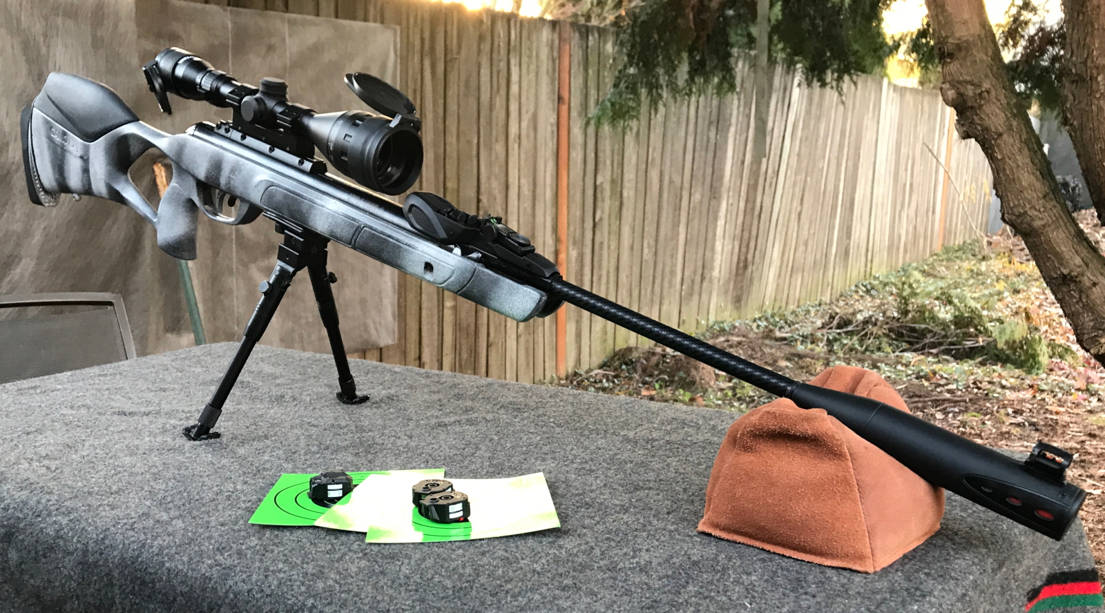

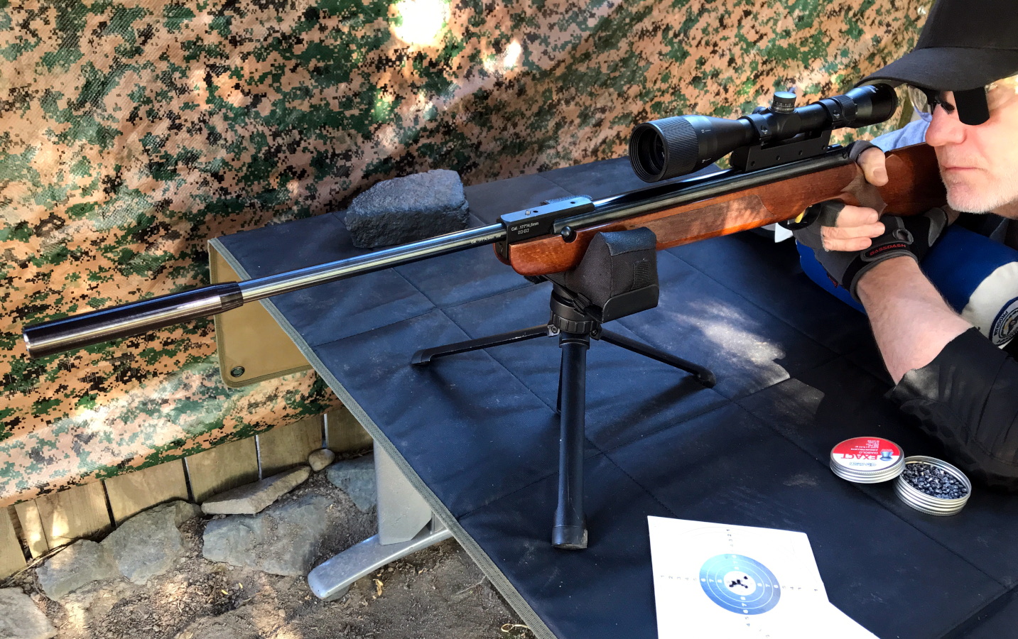

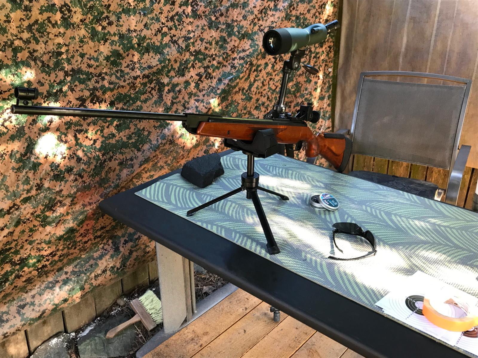

about how i shoot every springer....
View attachment 294813 View attachment 294815
works fine letting the tripod handle the "artillery hold" for me.
View attachment 294814 View attachment 294816
on a synth stock, i'll even add a bipod on occasion.
either are a lot easier than carrying sandbags around. and seems just as accurate.
just my 3-cents worth. your results may vary. :)
