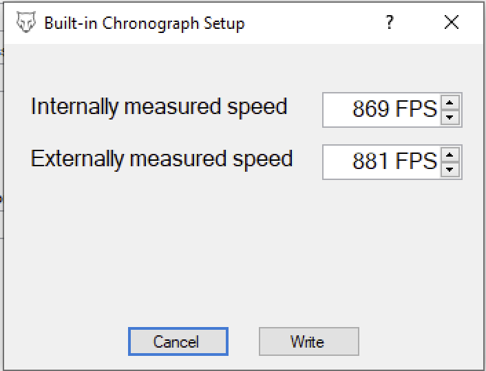

Have you tried updating to v1.3.7 of the firmware. Also there's the Chronograph offset compensation which makes you take a shot and the Built-In Chronographs Setup. Have you tried both?
I just hooked mine up to the software to check. Oddly mine is exactly 12fps off as well.
