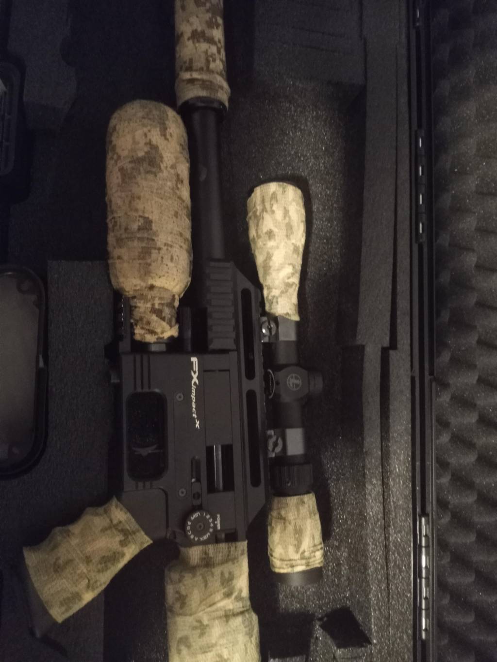

Impact compact. 22 lupuold rimfire scope. Rim fire rings extremely clear to 100 yard.no parallax knob . So lite I check to see if it's in the case. Out powers most and accurate. Love both my impacts.get new. Used are almost the same price.

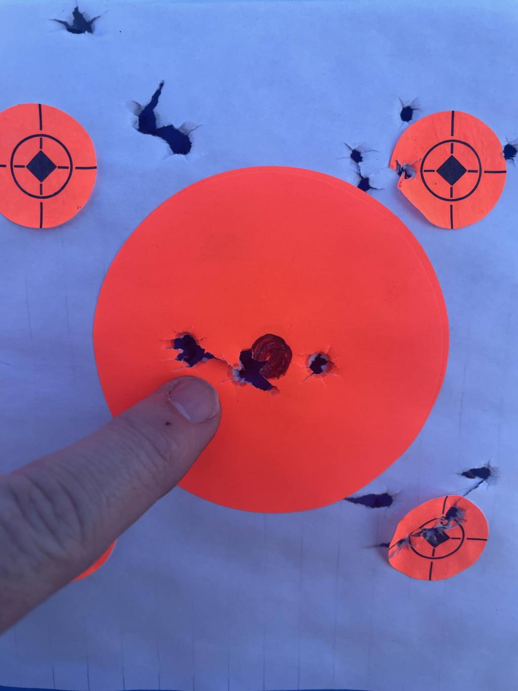

Here is a pic of the two L2’s and once I got the open sight one sighted in I shot this group. That is a one inch 5 shot group at 30 yds (keep in mind that is with open sights), and after the first shot less than a second, probably only a half second between shots.
The scoped L2 is a 350mm barrel, the open sight L2 is 250mm.
Way lighter my ass . Your gun has no scope. Comes tuned for pellets. And you can slug a compact 22. I'm hope that's a 50 yd group at least
