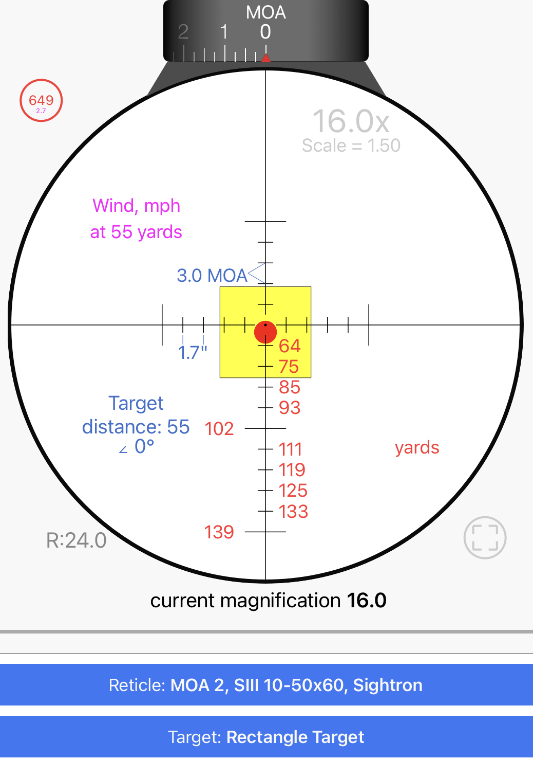

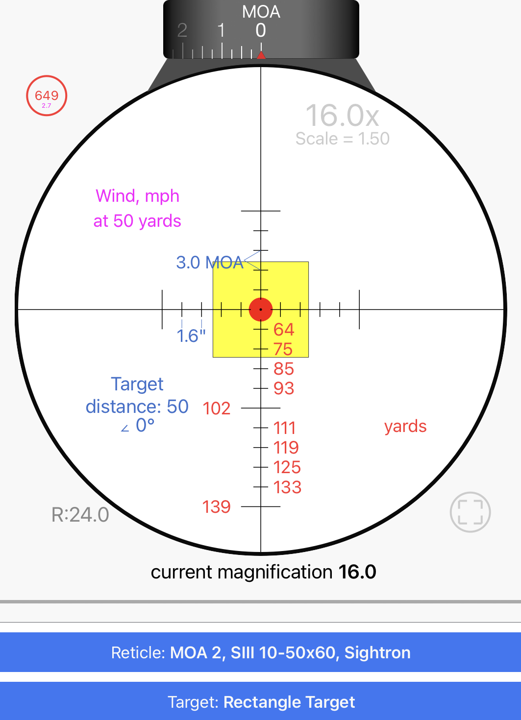

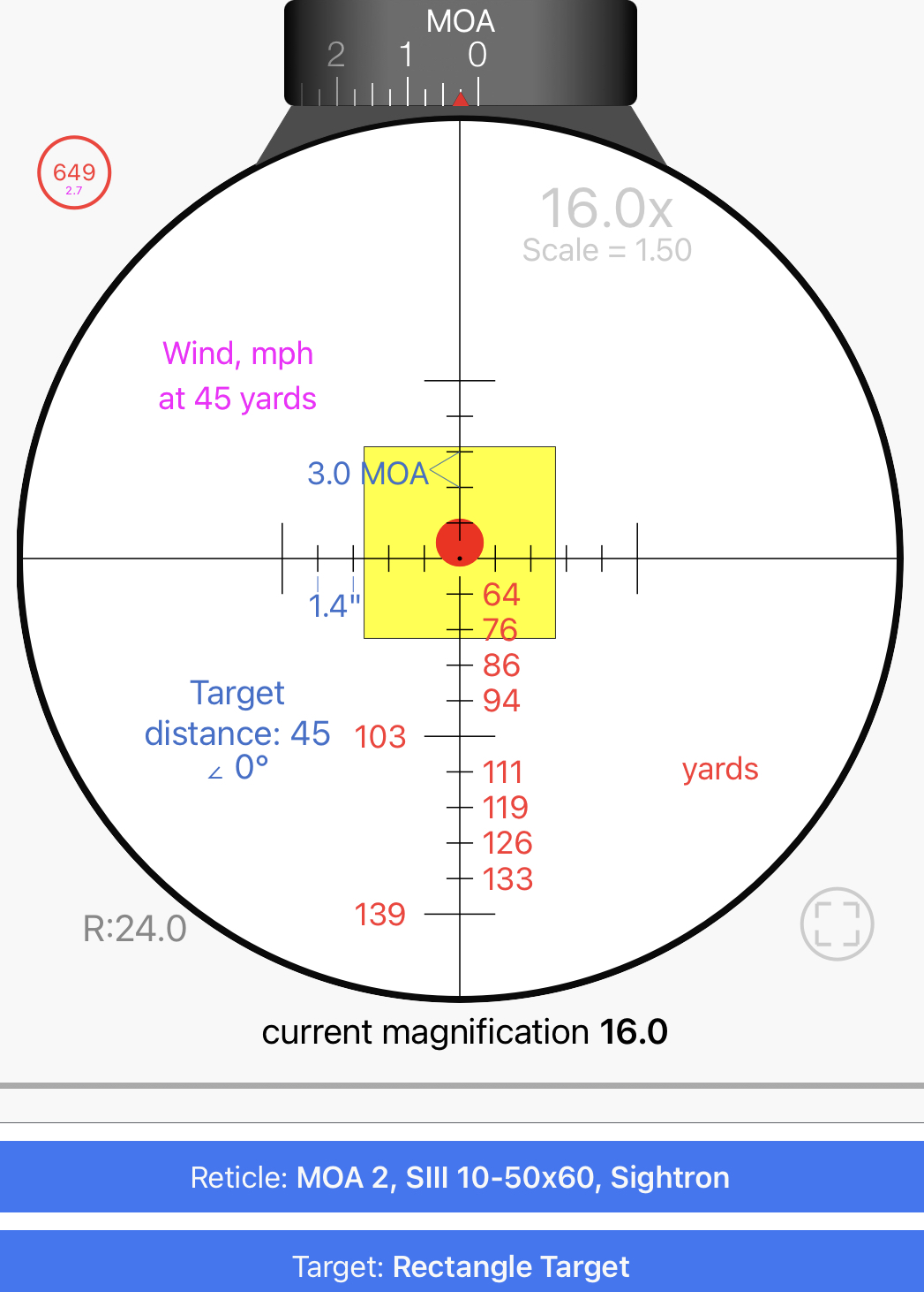

1 - Determine distance by placing an object of a known dimension between two or more marks also of a known dimension. (Most field target clubs mount the targets to a cinder block which we know is 7.625 inches square on the end. Some clubs utilize common size lumber such 2” x 8“ boards. Clamps are often used to secure the target which are not all uniform in dimension but you can measure a particular variety of clamp and keep a set of dope for that dimension.)
2 - Use data gathered from either parallax ranging a target with the scope focus or by using the known dimension technique above. Eg. - while ranging with parallax at 16x per the AAFTA HFT rules is often difficult, it is far easier to determine if a target is closer to 45 or 55 yards. I will describe this in more detail in a separate post.
The screenshots below, as I mentioned earlier, came from Chairgun Elite. I used that app because it is still available and supported. If you have Strelok, it would show the same dimensions and hold over values.
This first set of photos were captured while using the Sightron SIII 10-50x60 MOA-2 reticle at 16x. The zero for this set is 50 yards (for clarity), the scope is mounted 2” above the bore center line, the projectile is a JSB 10.3g being shot ts 915 fps and 19.15 fpe. You will notice that there are three MOA between the main marks at 16x. A 1.5” kill zone is 3 MOA at 50 yards.
The yellow square represents a common cinder block and the red circle is representative of a 1.5” kill zone. On my scope reticle, which I used here, a block is 15 MOA wide at 50 yards or 5 marks on the reticle. At 45y 5.5 marks and at 55 4.5 marks.
That, in a nutshell, is bracketing a known dimension block.

Instead of centering that block, move the left side over to the left side mil marker. From left to center is 50 yards. Easier for me to see the size difference that way.
c m shooter - yes, in the real world you would move the edge of the reticle to the edge of the block. Strelok and Chairgun Elite don’t have that functionality to move targets from left to right within the site picture. The point of this exercise is to see that there is enough difference that a determination of distance can be made using the reticle on an object of a known and consistent dimension.

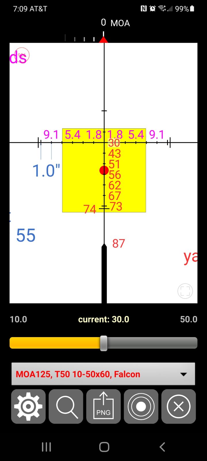

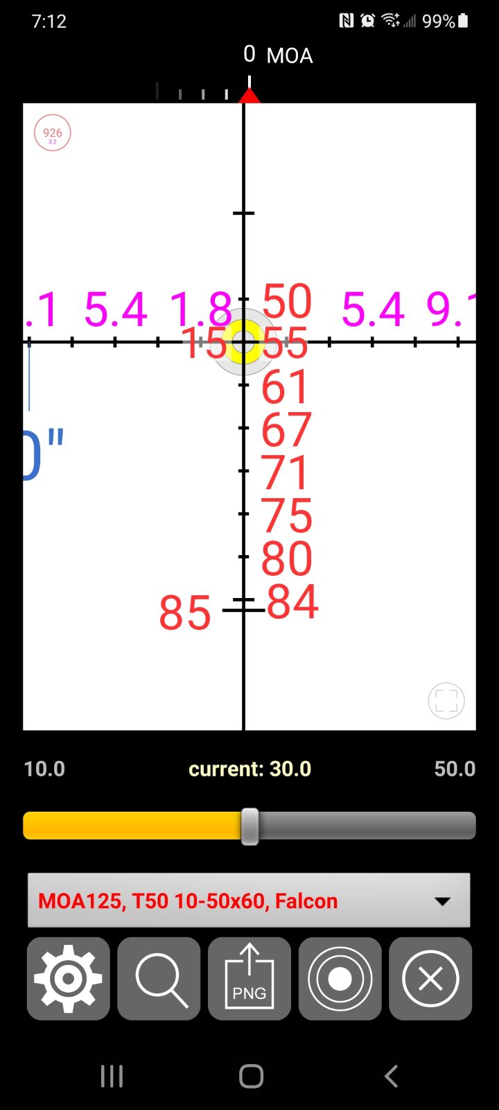

Here are some Strelok snapshots as my contribution to the thread. Note that I'm using 30x in my examples. These are for my WFTF setup, bracketing isn't just for the Home Depot squad (because of the buckets :cool: ). Another couple of notes: when using Strelok, make sure that the scope is set to the correct calibration on the scope screen. My T50 was setup to use 50X as the calibration when it's actually calibrated at 25x. My hashes were way off in the reticle view until I changed it. Also, I use 30x to bracket on blocks because I run out of runway at 50x. Also, I shoot at 30x, so it works for me. I bracket the kill zones at 50x because it works better for a 1.5 inch hole. Remember that 45+ yards is going to be a 1.5" kill zone or more. The "or more" can be a killer if you run into a 1 3/4" kill zone and try to bracket it as a 1.5" kill zone. I prefer to bracket on blocks for this reason, but sometimes there is no block. I like to bracket the longer targets as confirmation, especially if the targets are in the shade or the scope is getting hot. It adds about 5 seconds per target, but I only do it maybe 5 or 6 times in a match. I certainly don't mind using 30 seconds in a 60 shot match to make sure my ranging is good.
For posterity, my block brackets with a Falcon T50+ set to 30x are 45 yards - 9.9 mil, 50 yards - 8.5 mil, 55 yards - 8mil. So I can look at a block at 30x and immediately confirm the yardage.
