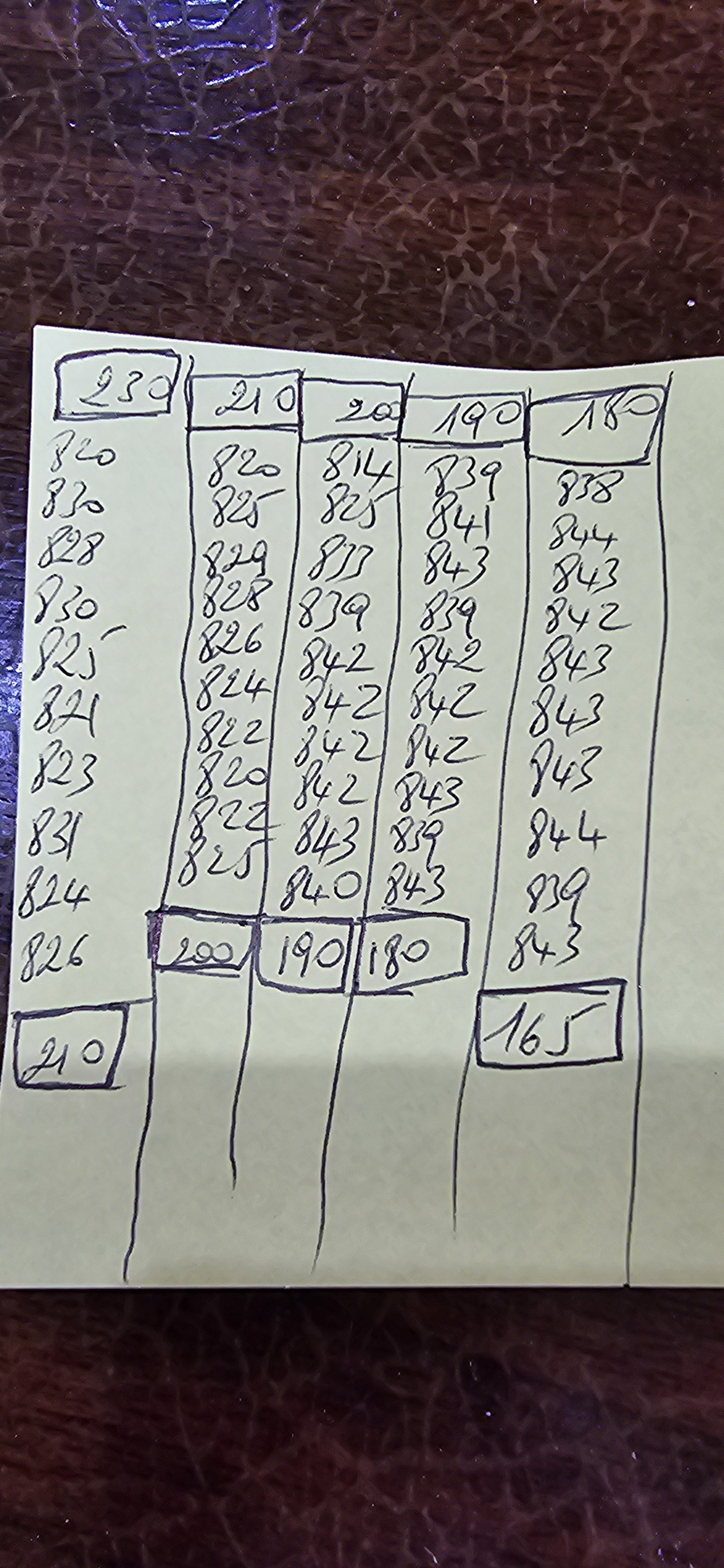

Ok guys so I did the test starting from 230 bar till 165 bar.
Velocity started low between 230 bar / 200 bar then started to jump up from 195 bar to 165 bar.
Attached is a photo of the results.
Shall I go to 130 bar or this is enough to find what's wrong please.
Thank you

Hello can you please have a look at the test i did per your request. Its posted under your ́reply thank you
I think what you posted is good enough. You have a reg problem. You are actually shooting the gun unregulated. Back when we all were messing with P15’s, most of us just immediately installed a Huma reg. The factory regs in those China guns were a crapshoot and some took a couple pounds of pellets to break in, then they still failed. If you’re not buying a Huma, you’ll need to replace all the orings in the reg. And while you’re at it, do the whole gun. That’s what we did. The factory orings in those guns are sub par.

I wish he would have kept shooting till it came off the reg, I think his reg might be to high
as to tuning to the plateau or the knee,,, I tune to the knee or a hair above, it is about first shot velocity, over conserving air for the best mpg result

That would mean suddenly his reg set point jumped up and that’s why his gun started shooting in the 790 range. Did it jump up or just bypass. When my P15 and Lelya went into the bypass mode, I got an incredible amount of shots starting way below my original velocity. He was already at 50 shots from 230b to 165b. Something suddenly changed. If he has to take the reg out to adjust it back down, why not just install new orings or a new reg. Either way, the gun has to come apart.
