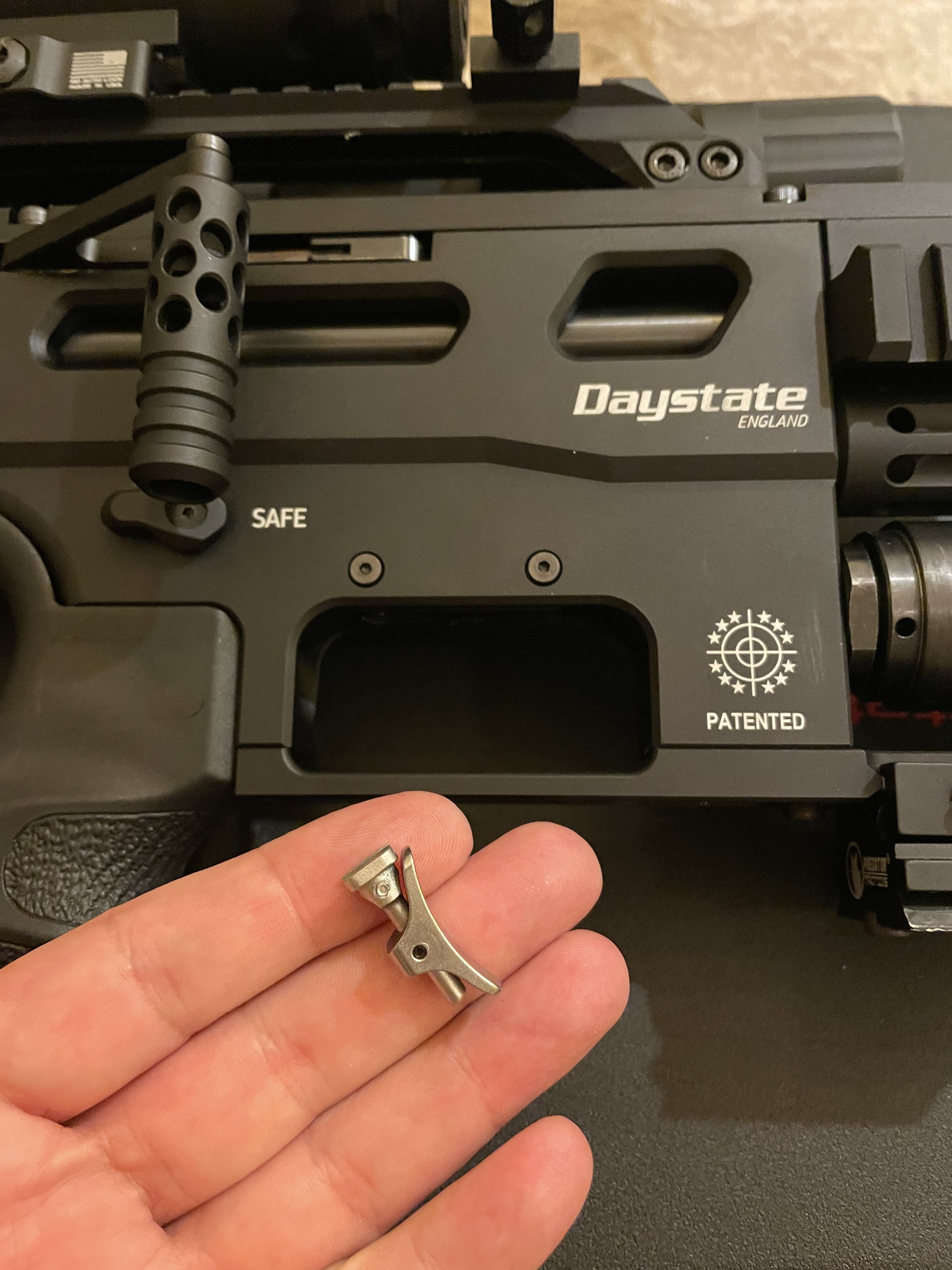

3rd time shooting the rifle and the trigger fell off. I have not touched any adjustment screws on this.
First the rifle stopped shooting while being loaded. Then I felt/heard something fall and the rifle went off. Good thing I was pointing into the forest. I look with my flashlight and no trigger.
I think I am getting done with these $2-3k European wonders (albeit the fact that I am from there originally). First my Impact M3 kept leaking, now this thing falls apart.
5 year warranty
