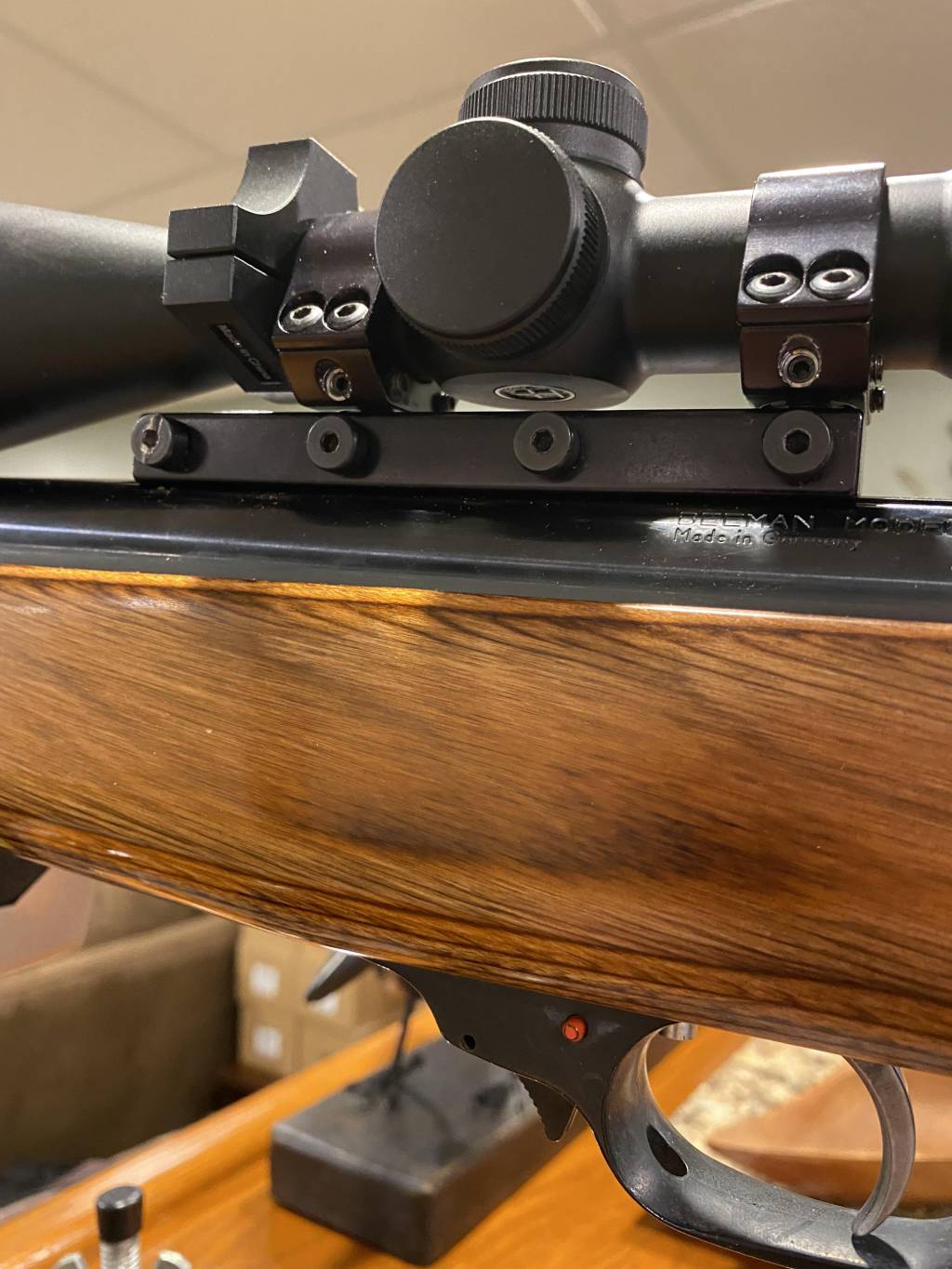

RX2 fitted With B-Square AA adjustable mounts

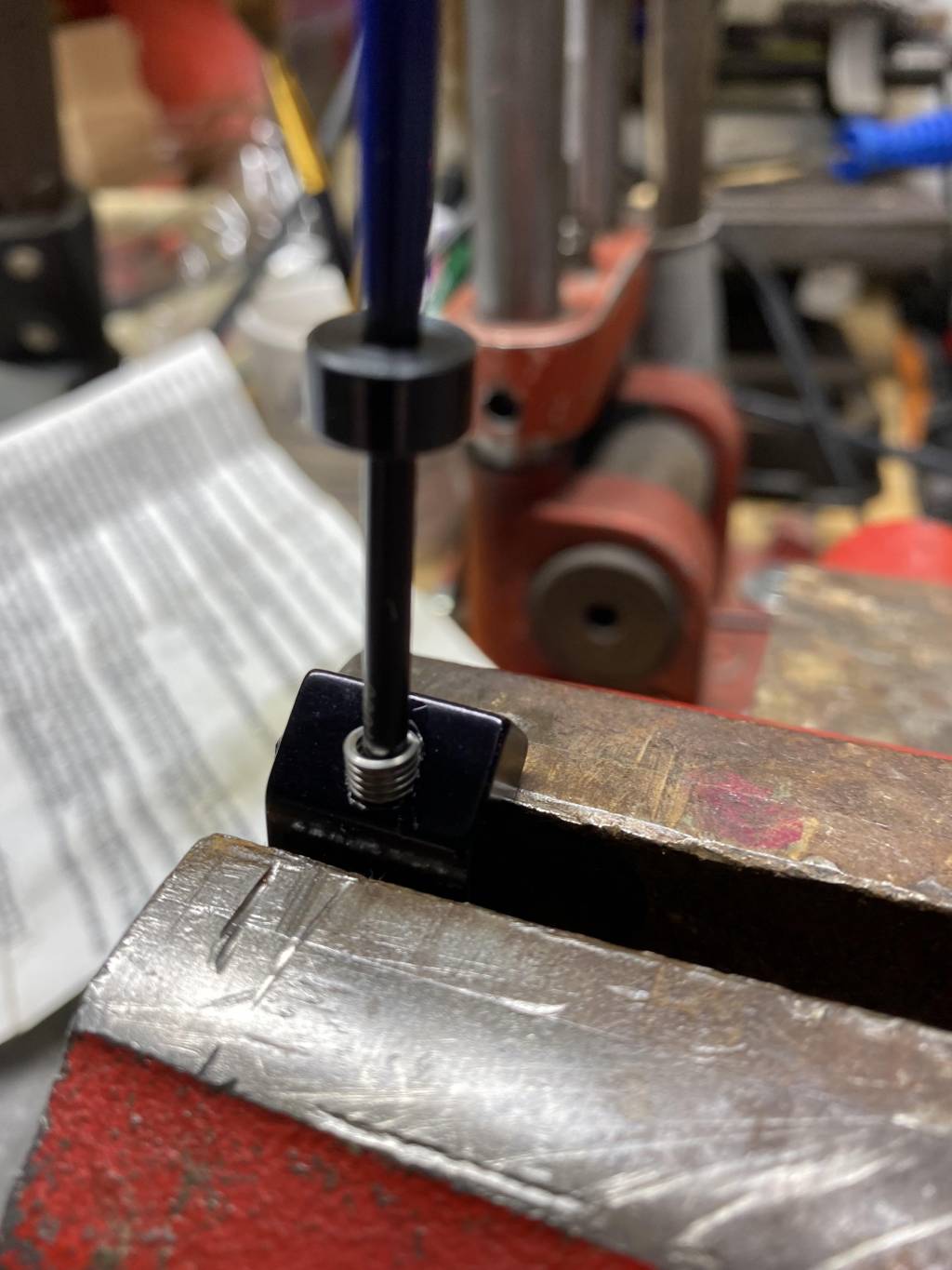

Made the stop pin and now installed hecoil inserts in the gimbals 2 were striped, I think this will be better then original threads, as the set screws will be pushing on the coils.
Think the mount will hold up to the RX2,
Good idea. I have used threaded inserts for several wood projects, but never thought to use helicoils in aluminum. I usually oversize and rethread the holes.
