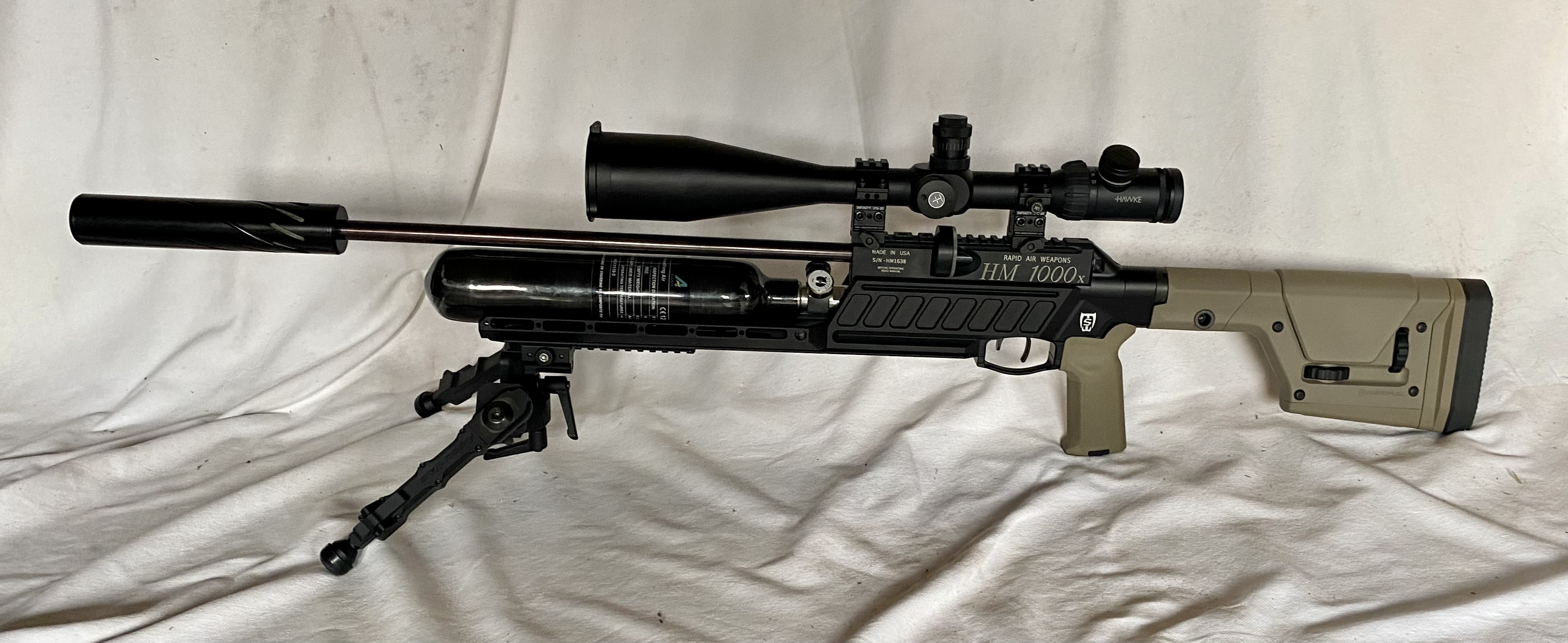

I have received the Saber RAW tactical stock Today 12/8/23
The stock is a very nicely machined item, however the HM1000 action will not fit into the stock ☹️ the bottom plug recess in the action is only compatible with the HM1000X action, even if the bottom plug recess was elongated ( slotted) to suit both actions the HM1000 with the standard ‘V’ quick fill and gauge will not fit as the “V” will foul the stock.
This is very disappointing as it was purchased specifically for a HM1000.
Luckily I have a couple of HM1000X rifles so it will be used.
I hope this is useful.
ATB
a not so Happydude.
