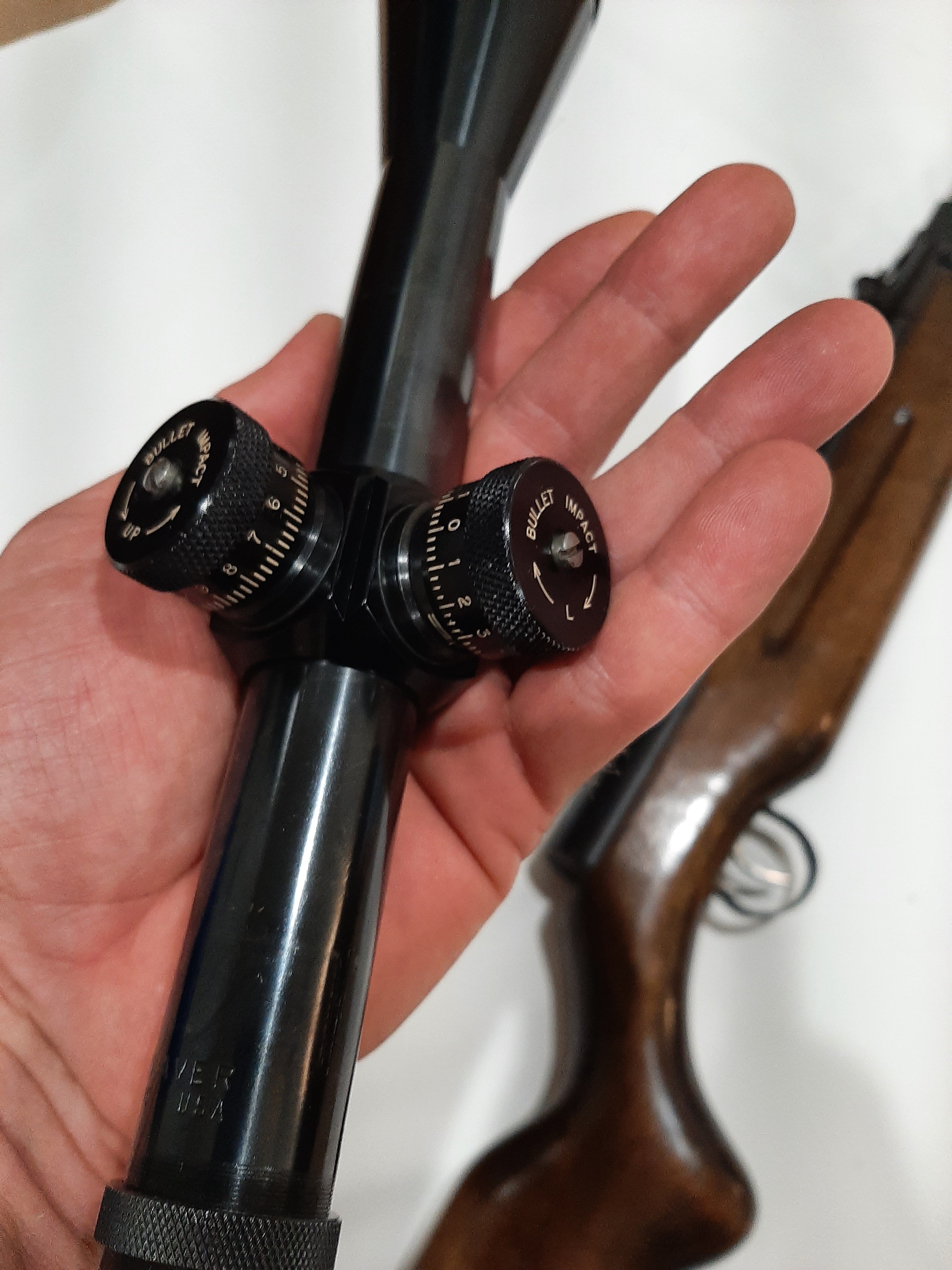

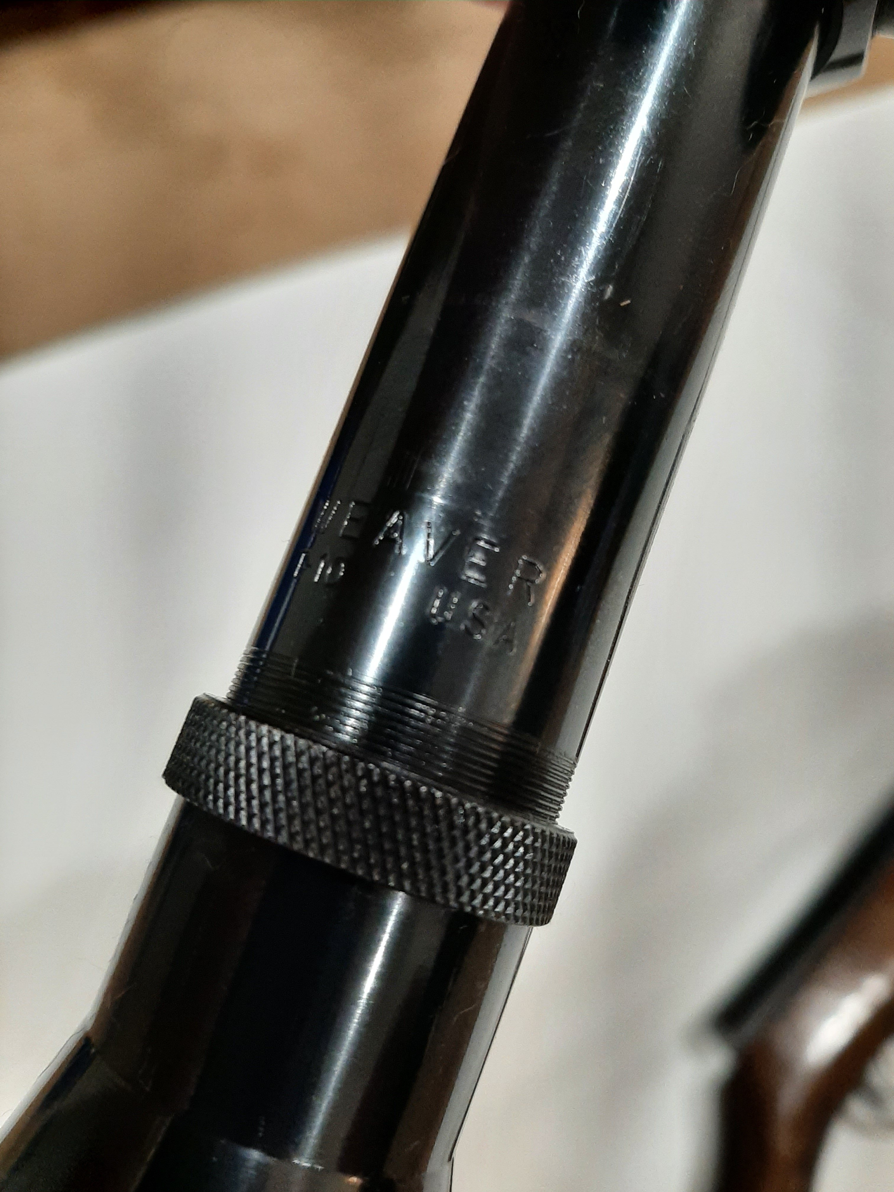

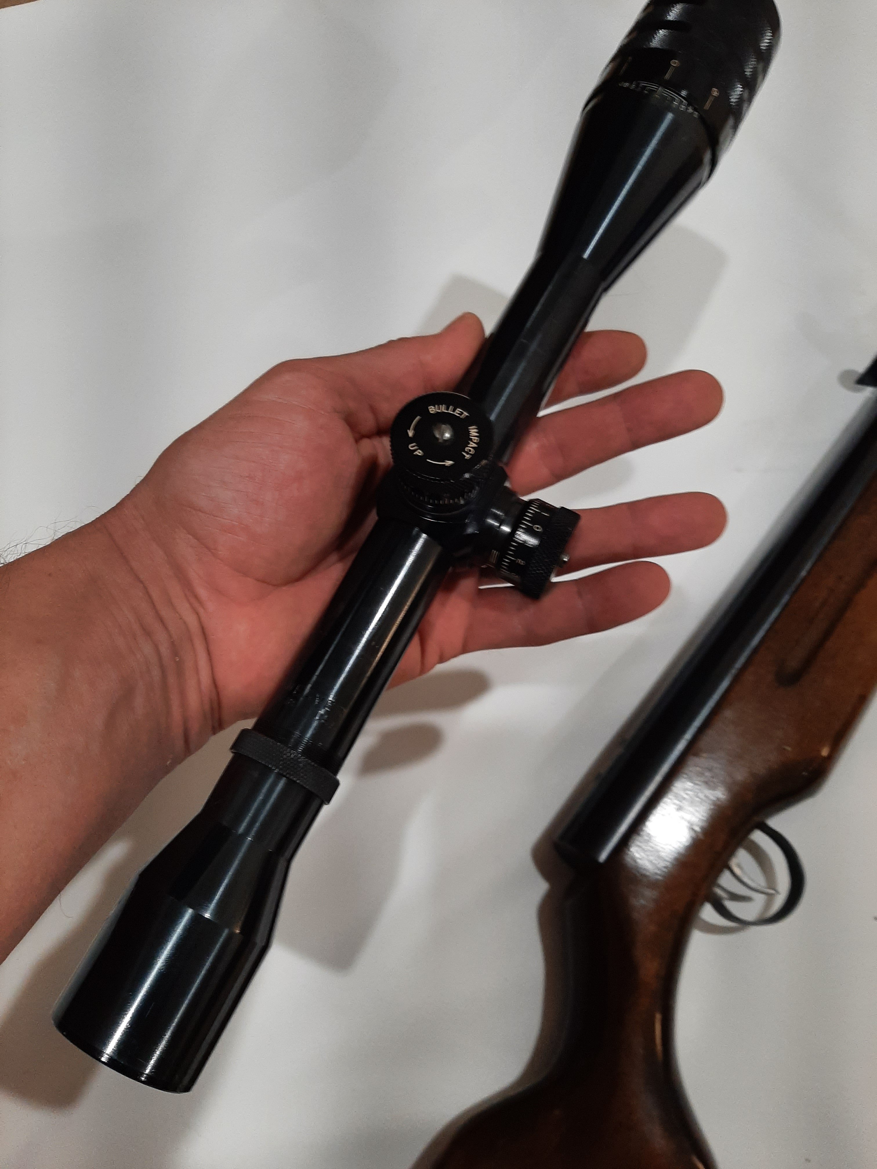

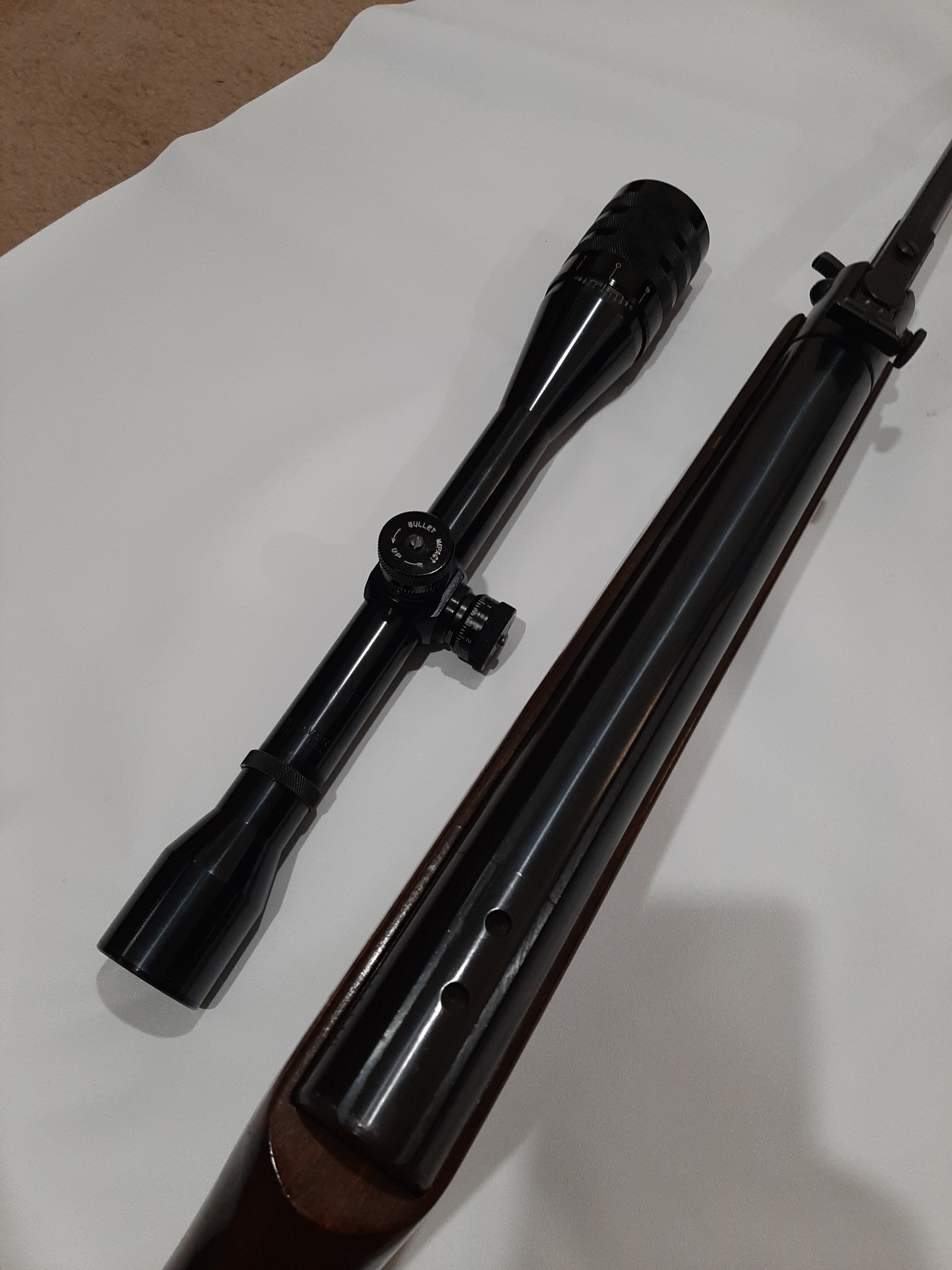

My steel Weaver T10 10× AO Made in USA 1977-84 & 1966 HW35.
