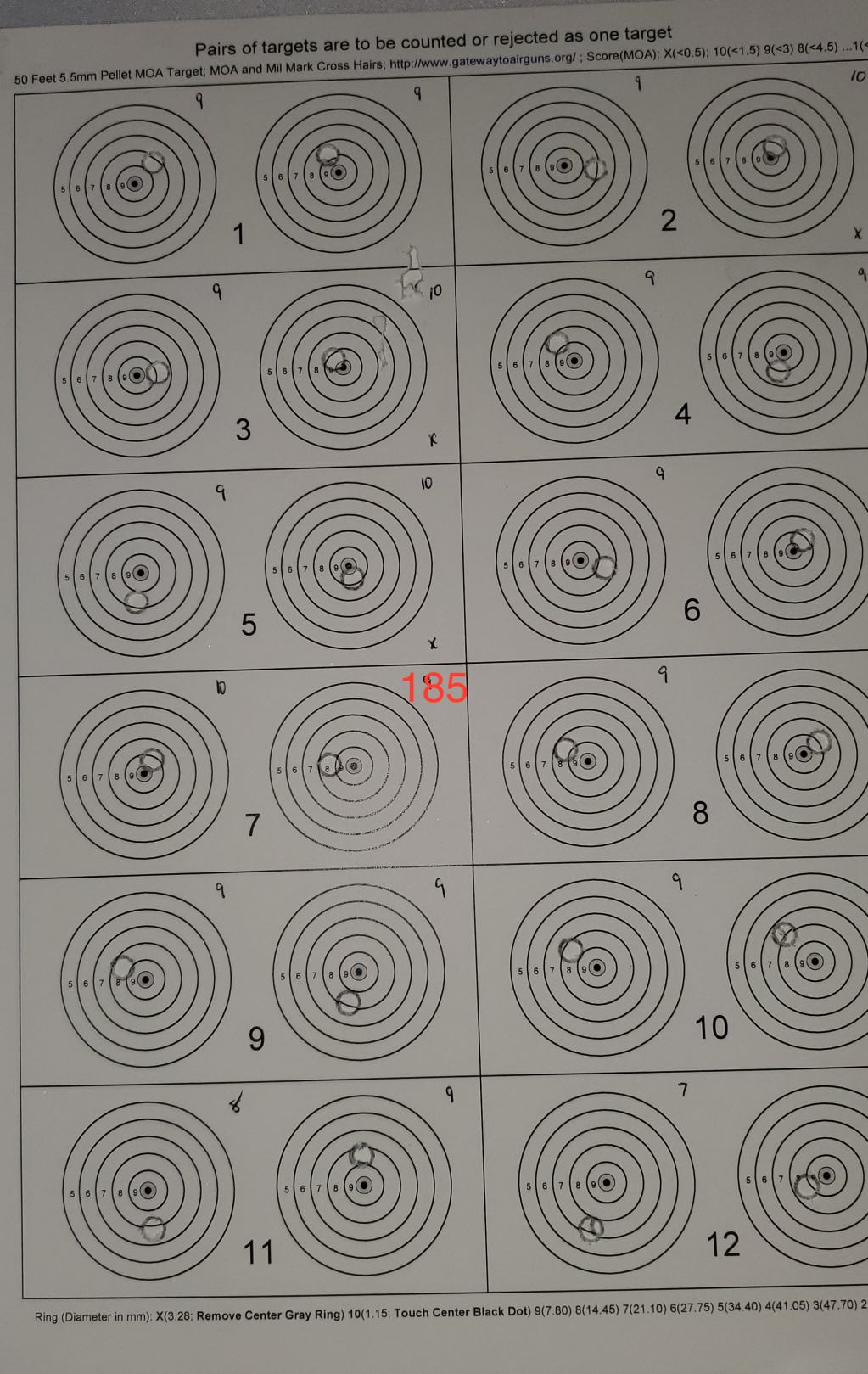

Good shooting, laz. What rifle are you shooting?
Shooting a Maverick with a brand new 600mm barrel. 150/130 on the regs, NSA 23gr slugs moving at an average 970fps. Was actually prone off the bipod using my fist as a backrest for these. My picnic table/benchrest is a little wobbly so wanted to try prone. Still under 200 rounds down this barrel so still in break-in phase I hope.
