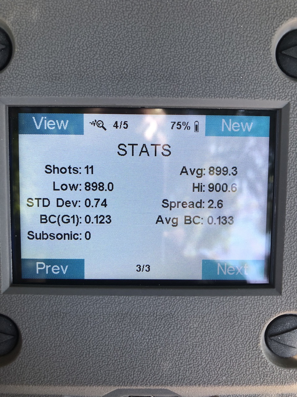

Here’s what I got. A G1 BC of 0.133 at 900 fps. Maybe I need to shoot them faster? But judging by the accuracy, they were stable…. The SF is greater than 1.5, so that shouldn’t be an issue.

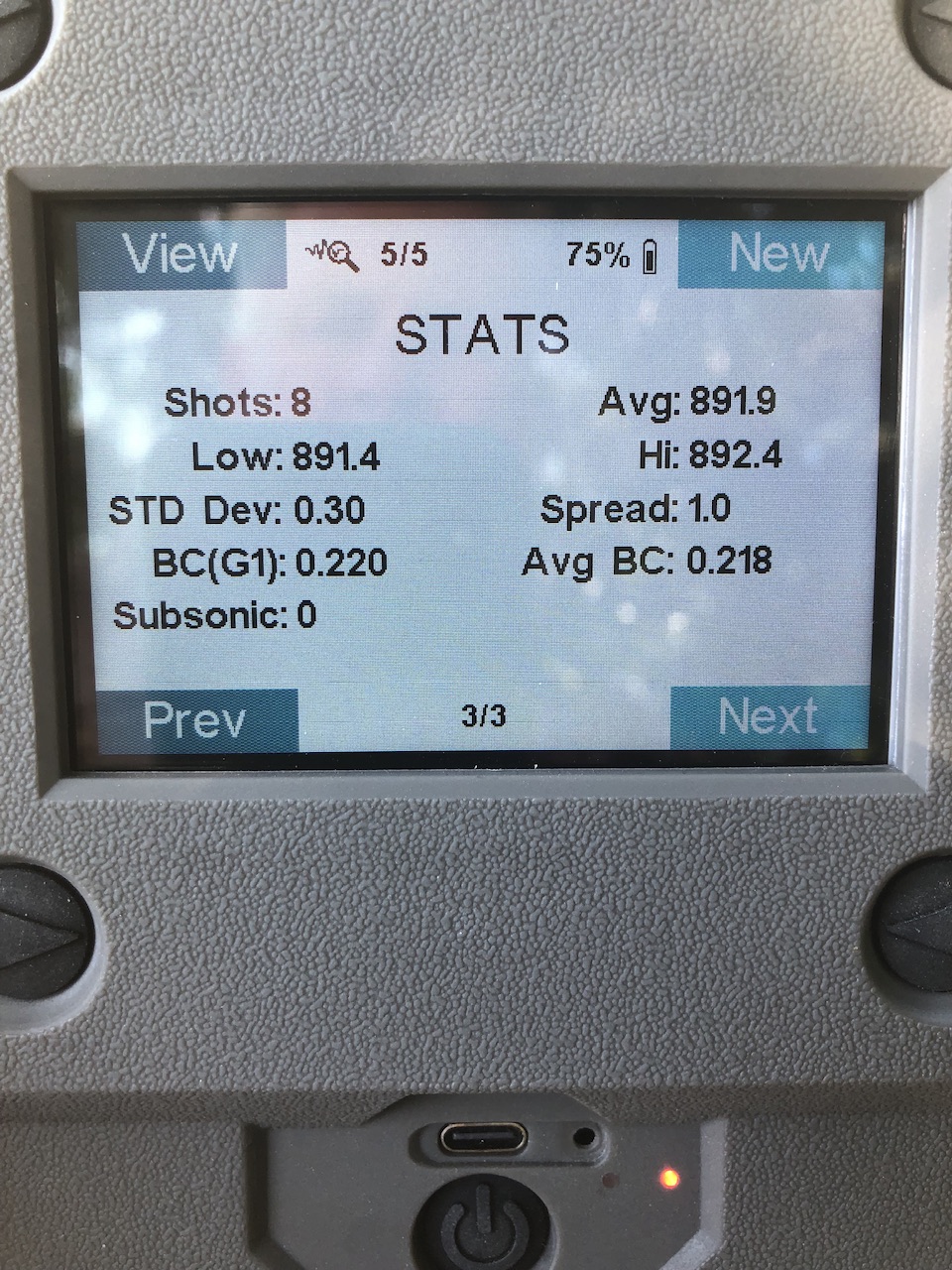

For comparison, this below is what I get from the Altaros ATP Smooth 49.5 at 890 fps and 100Y. A G1 BC of 0.218.

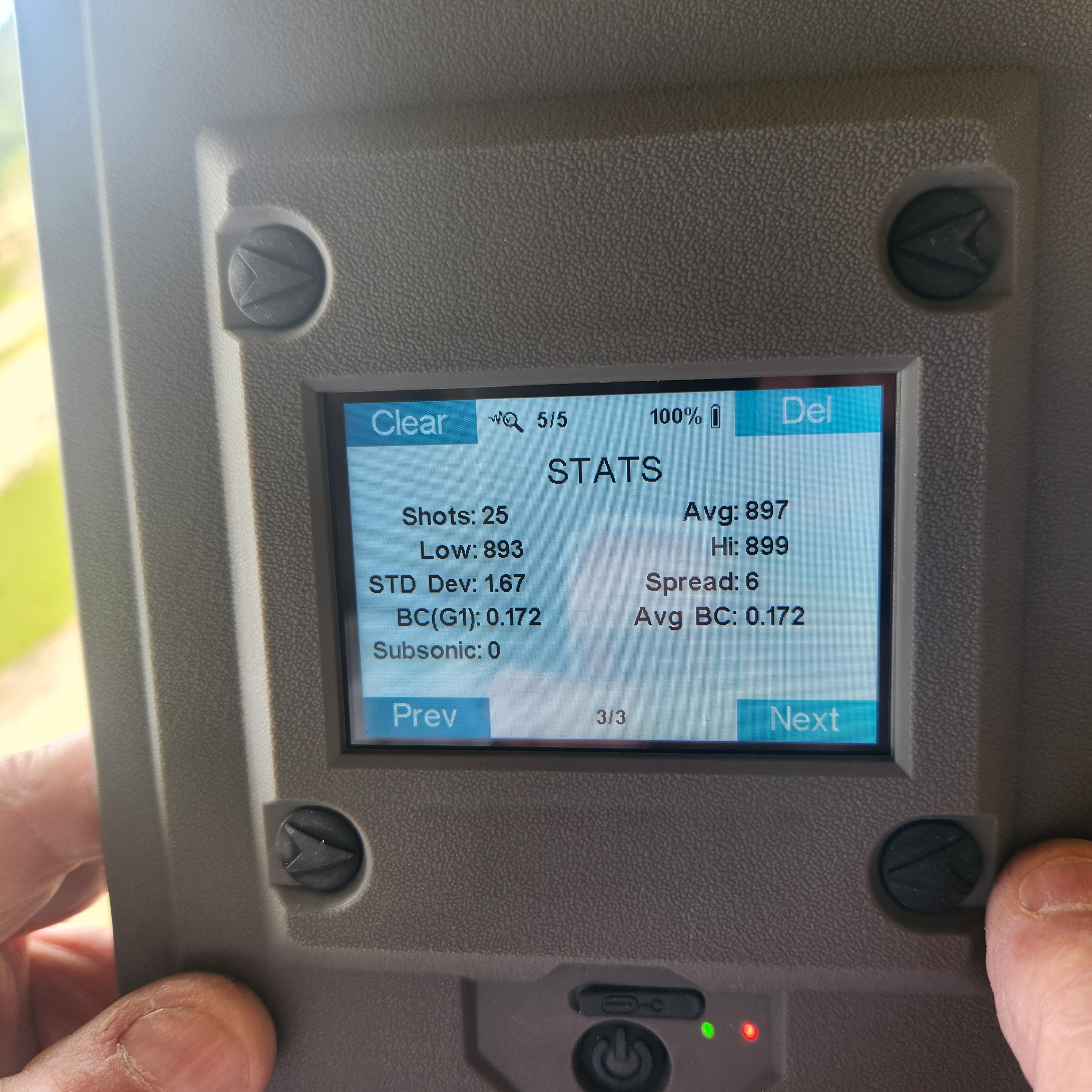

I'm not sure why your BC is so low with the Corbin/Skout slugs. That seems very odd. I ran a full mag of them over the chrony about a month ago in much colder weather and got a .172.
M3 700mm Superior Heavy View attachment 467677
