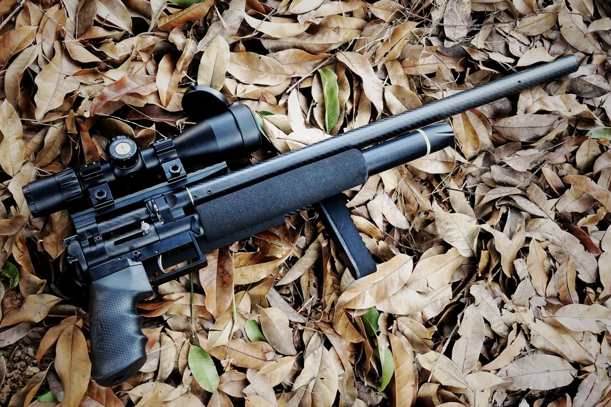

AEA Element MAX - this one puzzles me. What do you think?
As you might know, the AEA Element is a gun available in 22, 25, and more recently 30. I don't think it ever had the power to push 30 caliber. But the gun was ultralight (I think 2.8 pounds normally and 3+ lbs with the more recent regulator upgrade), relatively compact / carbine, has a bunch of awesome carbon fiber, magazine fed with an OK shot count for what it is, and reportedly decent accuracy.
So now AEA has announced the AEA Element Max. WTH?
So this one is 5.2 lbs, single shot with a single action revolver style thumb cocking lever, and some big power numbers and different calibers.
