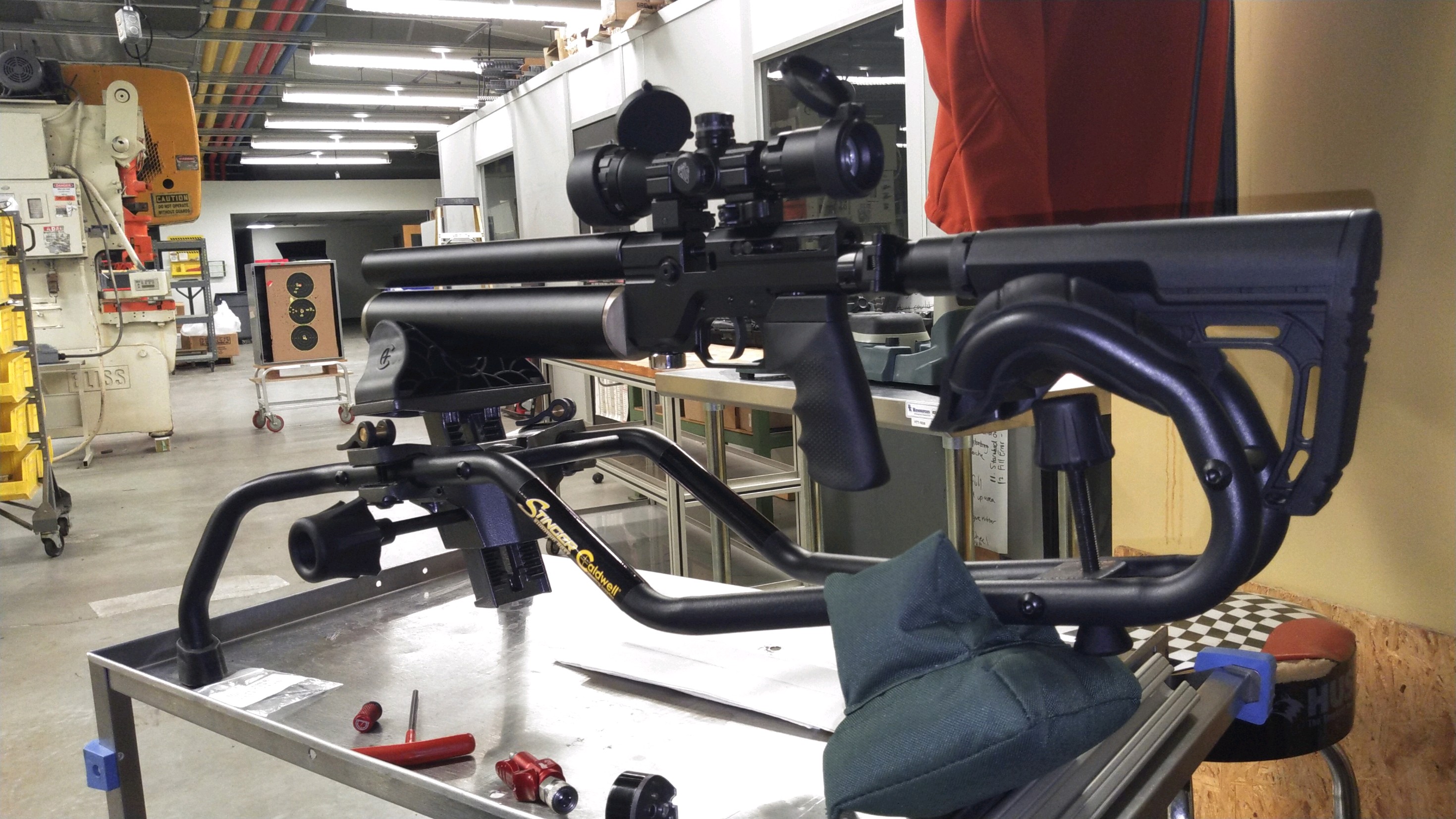

Just checking zero before some rats die. Can't wait to get to Florida.

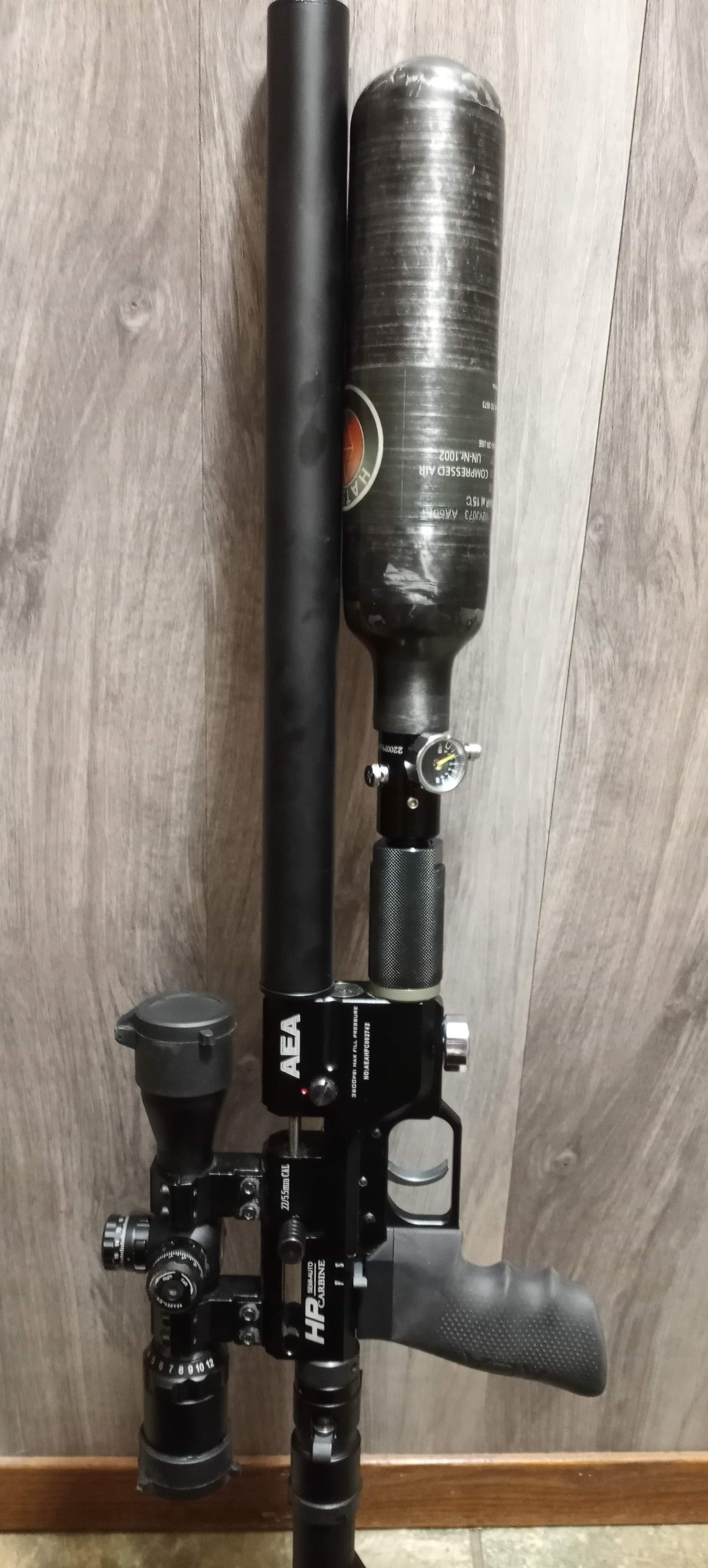

Show us your rig

Show us your rig

I have chronied my AEA HP SS in 22 again today.
The transfer port/power wheel is about one third from the minimum, hour 10 on clock (9 is the min, 12 is the max).
From about 240 bars to about 150 bars I get 3 magazines ,680 FPS to 725 FPS and back to 680 FPS with CPHP 14.3 grains.
Accuracy is decent, the trigger is single stage and a little too long and heavy.
Accuracy is almost comparable to a Benjamin Prod if you master the trigger.
