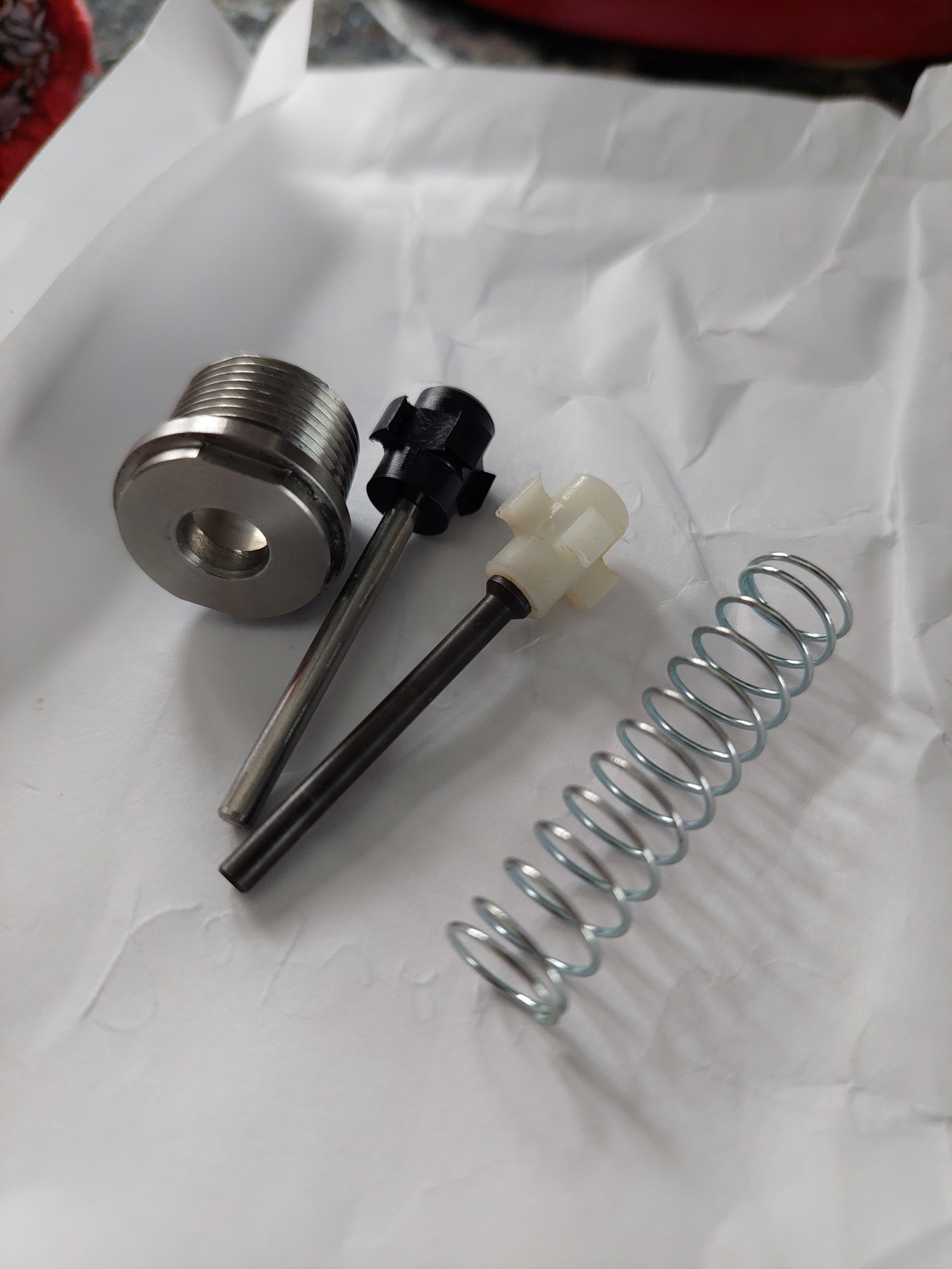

The older style one is just a cylinder shape that sits over a flat or slightly raised hole. The new style poppet sits in a beveled hole and seals by using the edge of the poppet pushing into the beveled hole.
The black one is my PEEK replacement next to the OE delrin one and an old style popped but made from white PEEK made by Dark Charisma.

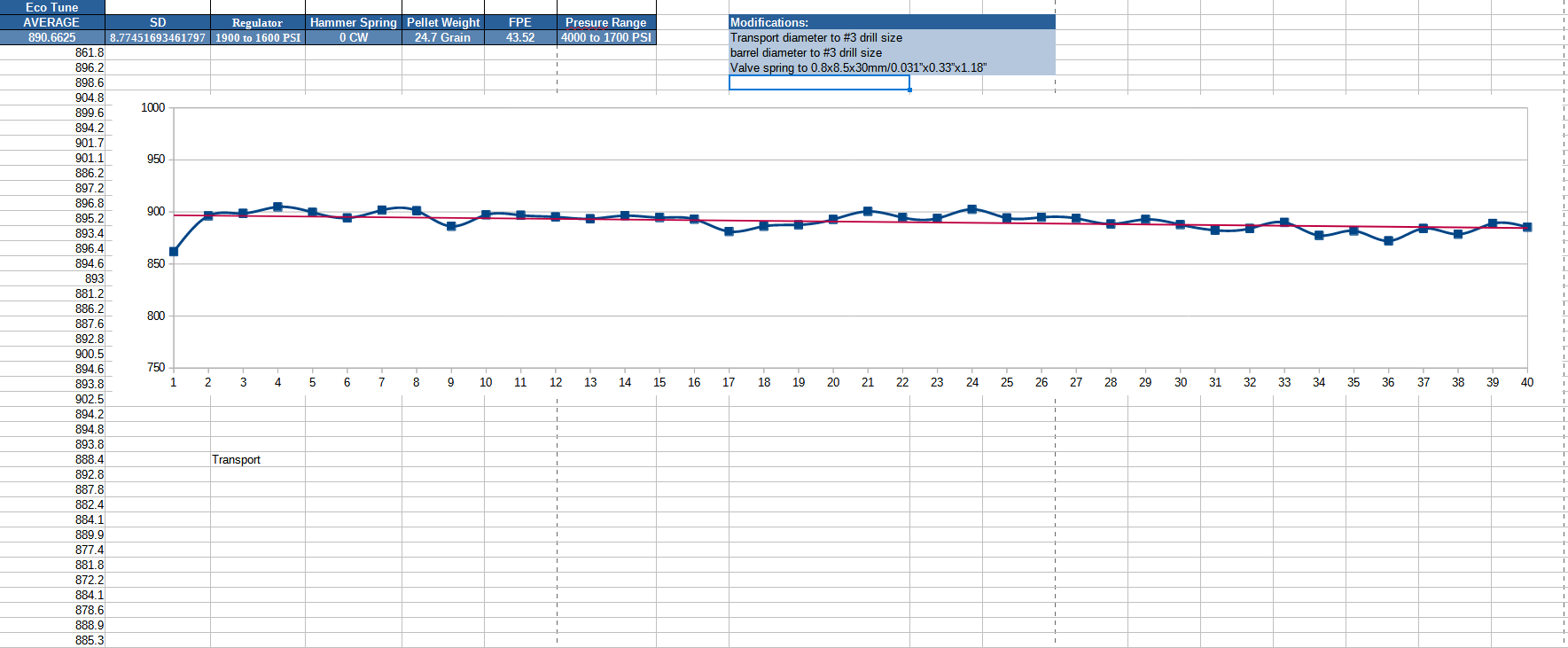

Here is Spring I use. I also use 10cc Plenum.
46fpe is respectable.
I have a customer / friend / collaborator, now running a .22 bullpup with a plemum I made for it and he's getting into the 60's fpe, that's also with porting done and a bigger valve / poppet.
I also have another friend / customer / collaborator that's getting into the 100's with his .25. He's the second I've now helped achieve .22LR power.

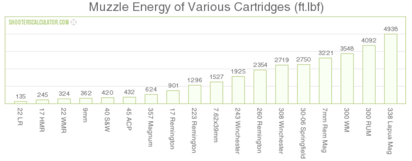

135fpe ? That usually requires .30 caliber with relatively heavy slugs.
CCI 22LR standard velocity states 102fpe muzzle energy. Other brands state similar performance.
CCI is playing word games now calling subsonic "standard velocity." It may be their new standard but not the rest of the industry. 1220 to 1270 fps was the standard from a rifle length barrel most of my life and specialty rounds like the stinger were even faster with their lighter bullet.
OK. I stand corrected. I looked at the first few results from a search and they all came back with around 100fpe so didn't look much further adding as they correlated with each other.

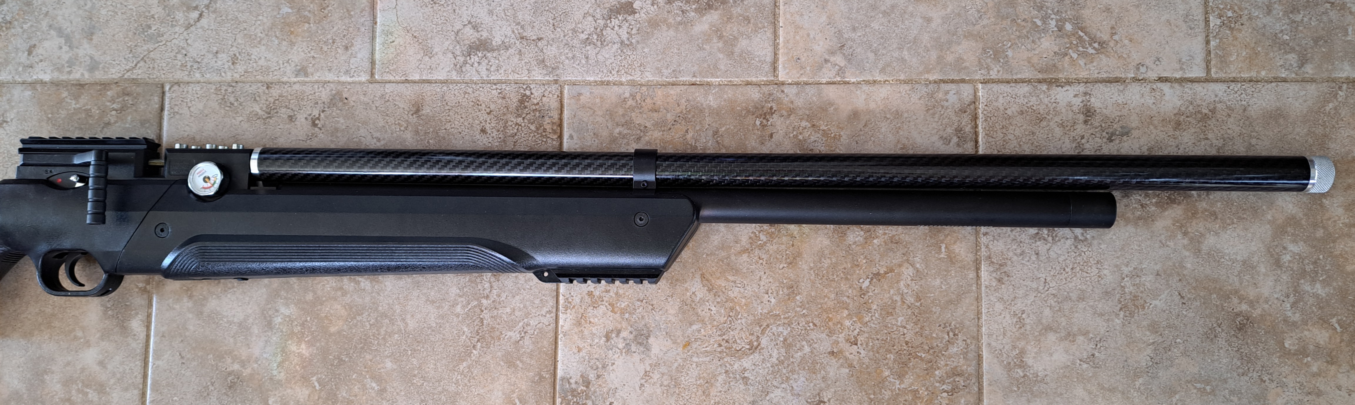

Stabilizing your shroud to bottle is what I consider an accuracy upgrade.

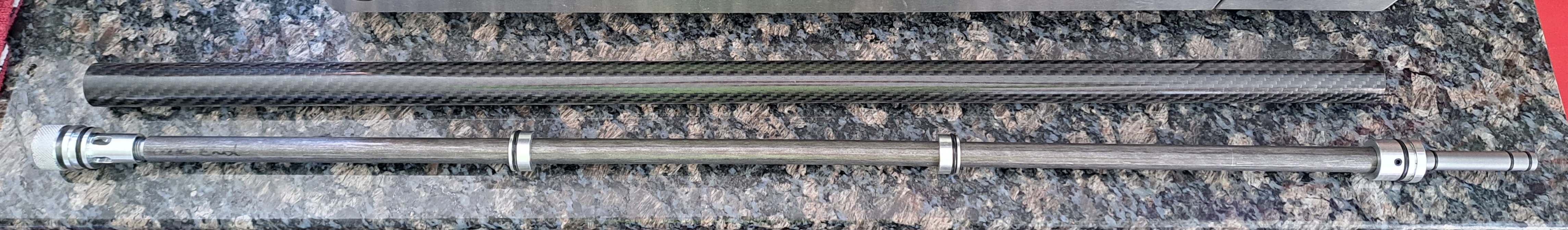

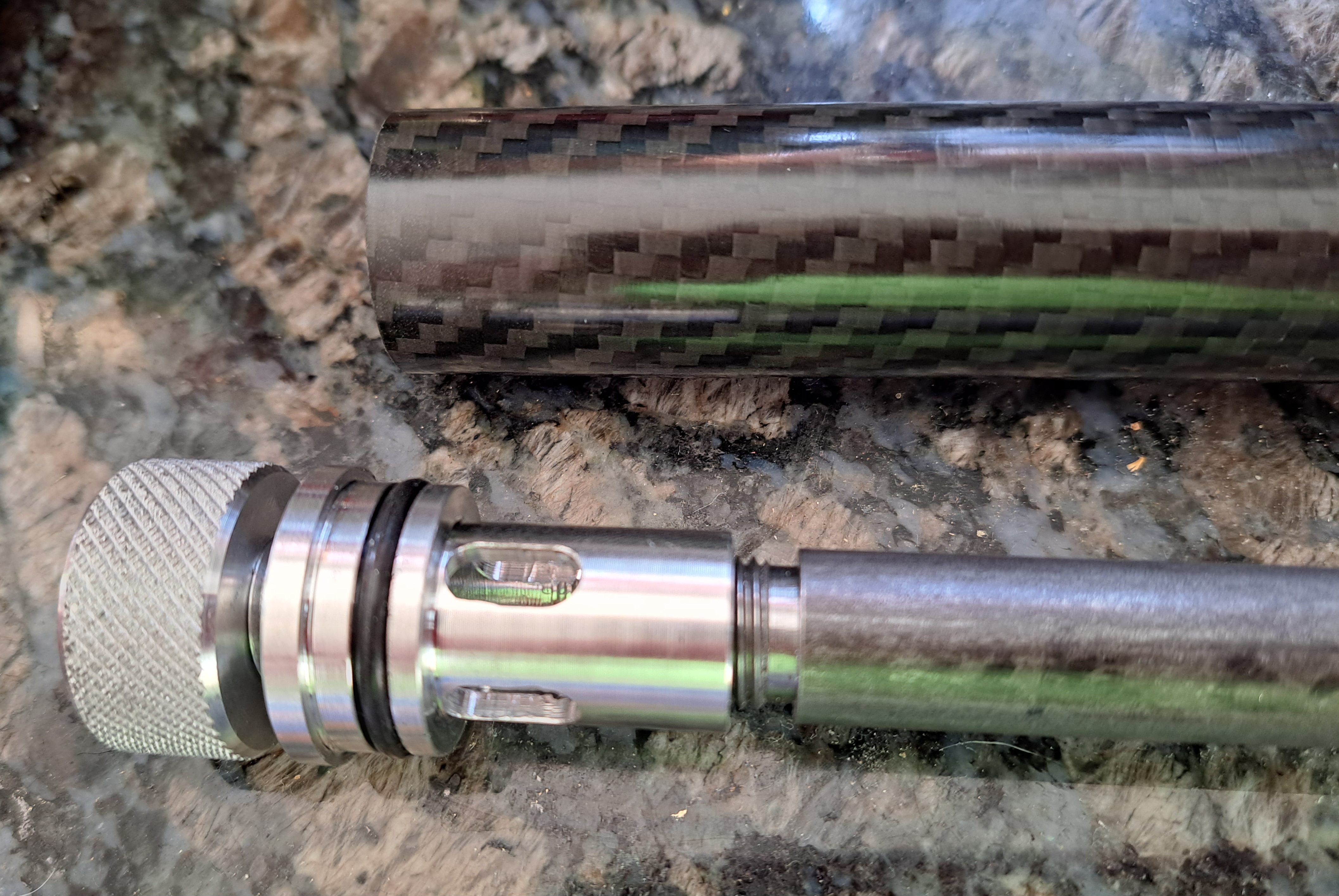

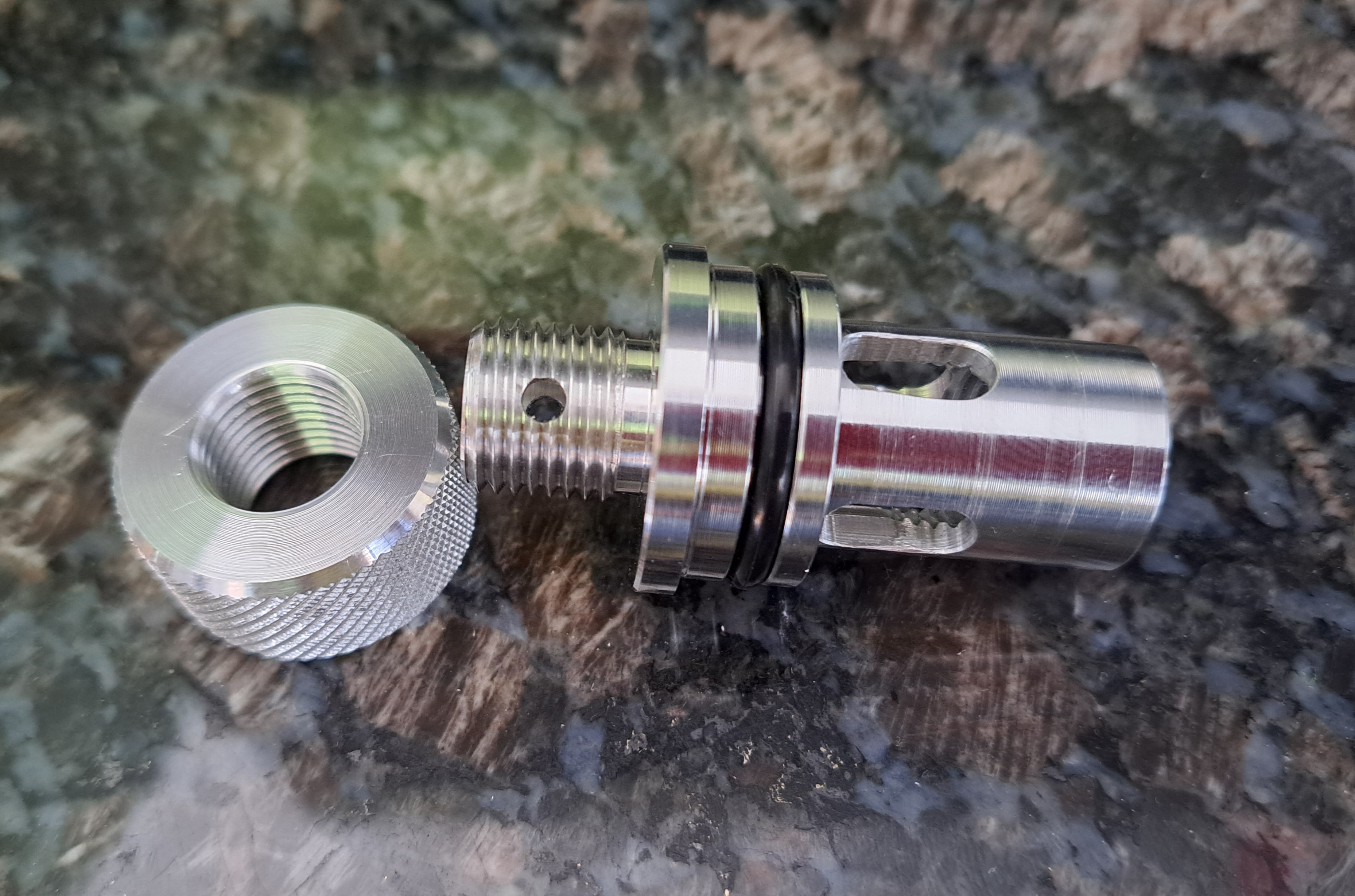

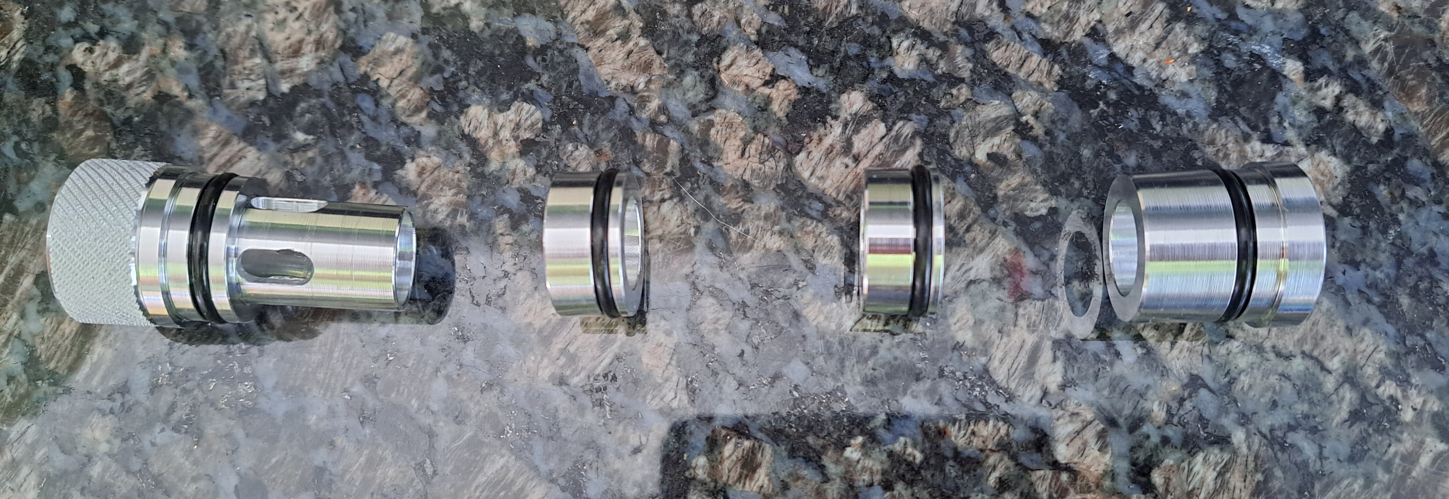

My I knurling didn't turn out the best and I need to polish some parts a little more and my slots are not the cleanest ( I went back in and lengthened them ) but I'm fairly happy with them for a first attempt.
None of it was drawn before I started. I just made to the 'design' I had in my head, which made it take twice as long as it should have.
Can you tell I'm my worst critic yet?
I don't know how much experience you have machining but keep lubricant flowing over your knurl the whole time you're cutting it for the cleanest result. WD40 works well. Give it a little scotch-brite while still spinning to knock off the sharp edges and Bob's your uncle.
I'm fairly experienced and have quite a bit of knurling in the past. I backed off the pressure to take a look and when I pushed back in the lower wheel engaged between the grooves and made new ones. My own fault.
