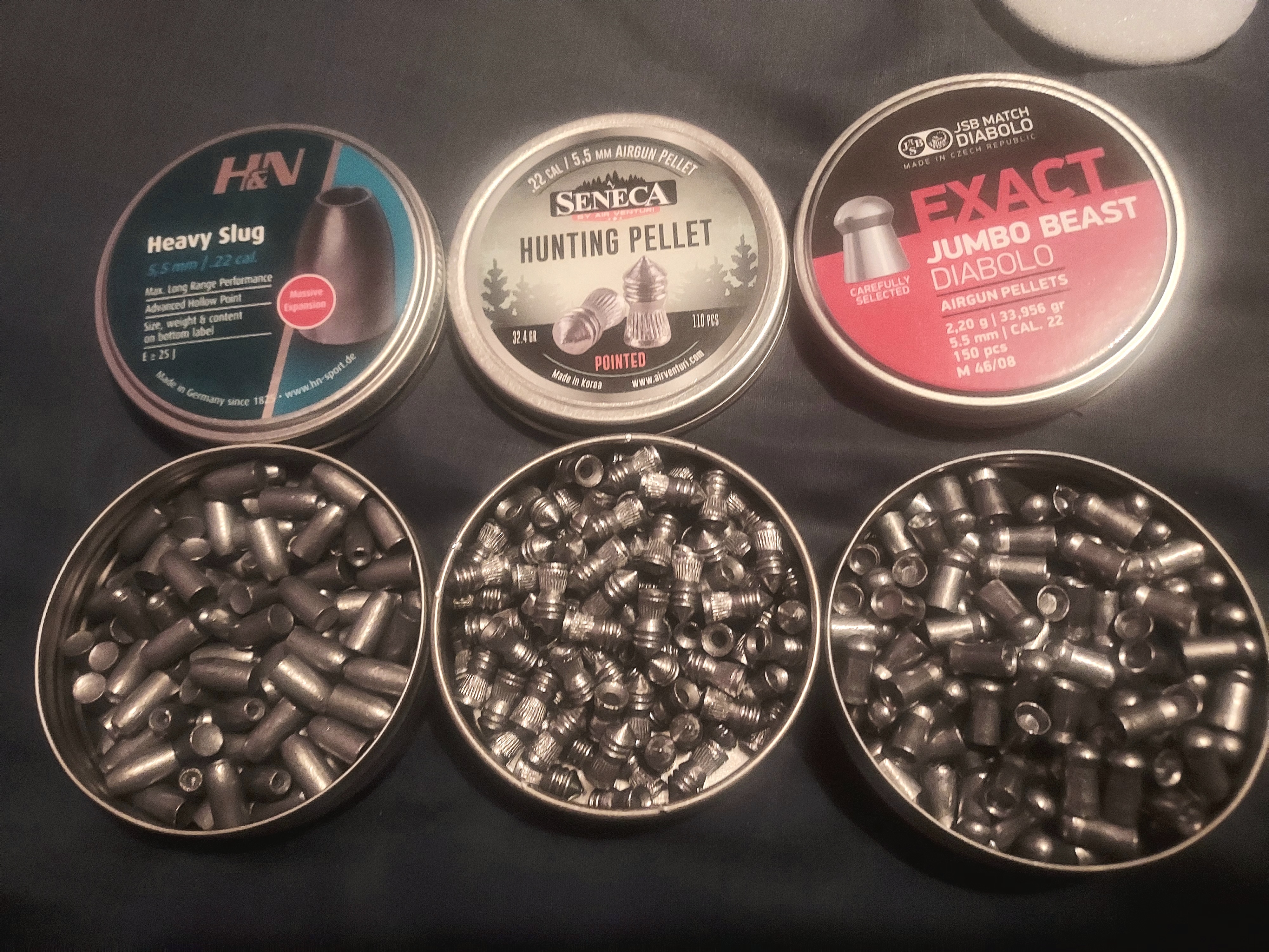

Anybody shooting JSB Diabolo Exact Jumbo Beast .22 Cal, 33.96 gr ?
I had tried the beasts awhile back and couldn’t get them to shoot fast enough to stabilize due to them being so heavy. They ended up tumbling past 30 or so. A higher power gun would yield different results, of course. But in that situation why not just shoot slugs would be my argument. With the shape of the beasts, you almost can’t even call them a diabolo anymore. It’s at the extreme, so without high speed and a proper twist rate it can’t stabilize like a normal pellet can at the slower speeds. YMMV. Always worth trying.
