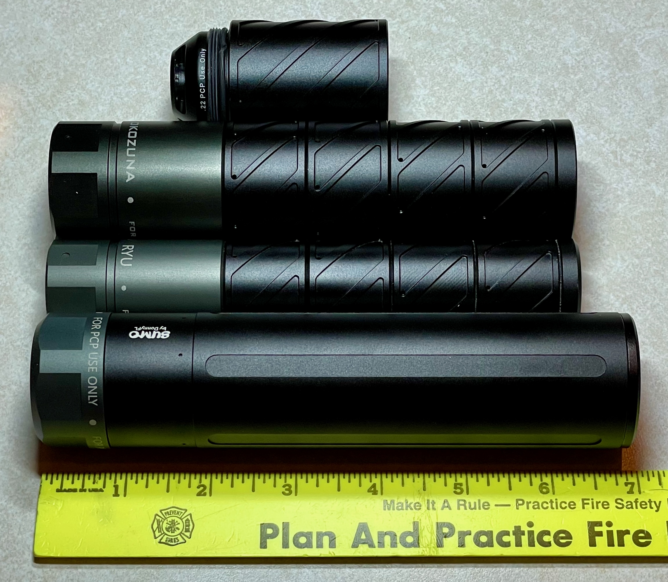

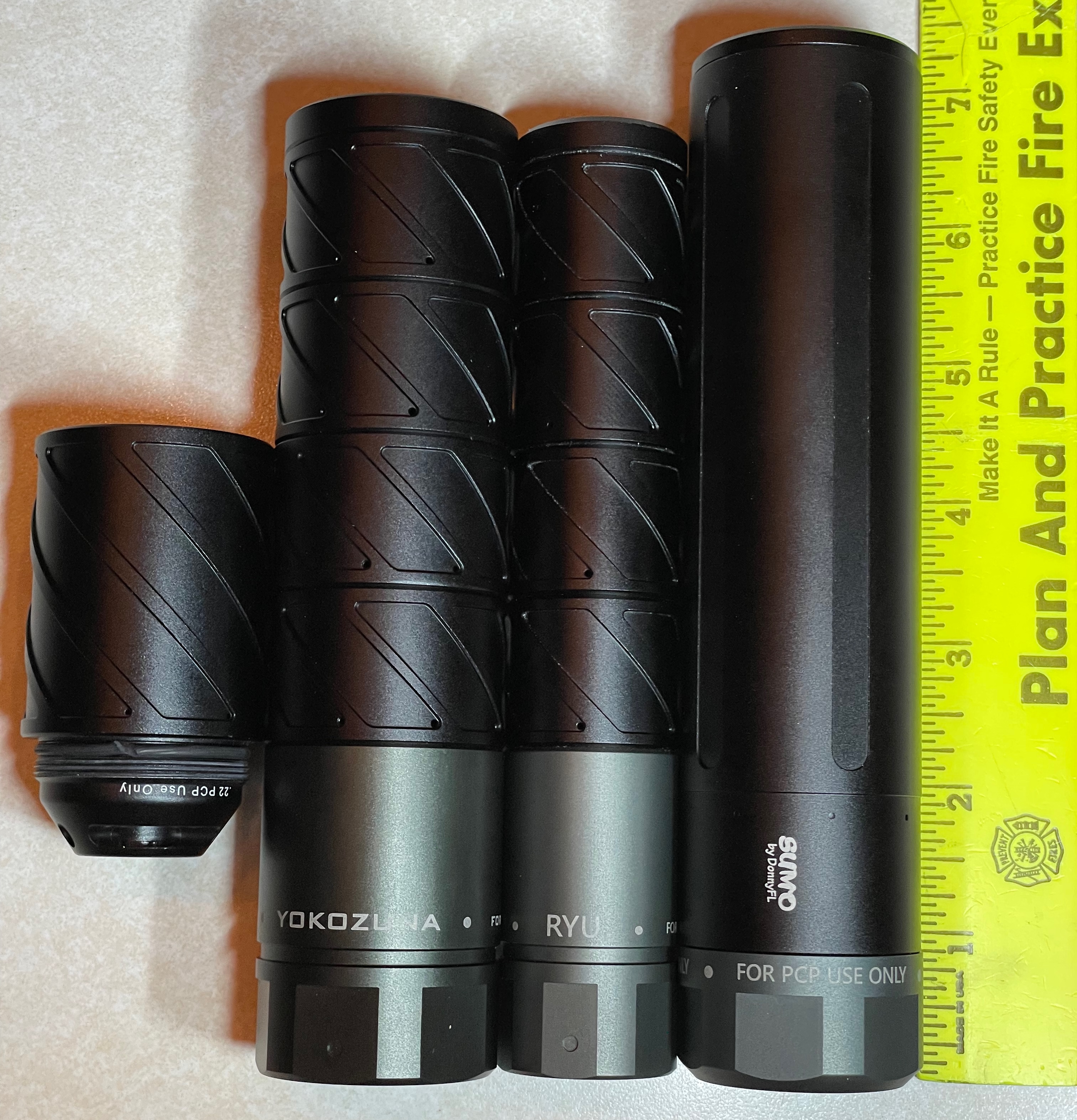

To my ears, the Yokozuna also had a softer sound, the Ryu a slight ping, and the Sumo a sharp ping compared to the Ryu & Yokozuna. The Yokozuna was like a whisper when firing the airgun empty, but that's not real world. I did a test without the QD adaptor to see if it impacted sound reduction. It did not. Also, POI change was manageable, not severe, when switching moderators. Hope this helps.
Photos of configurations that produced the best results. In the first photo, the Yokozuna extender is to the left of the Yokozuna moderator.
Note: Since I found the Yokozuna quieter w/o its extender, I ordered another baffle. Will update the Yokozuna avg dBA after testing with the additional baffle.
