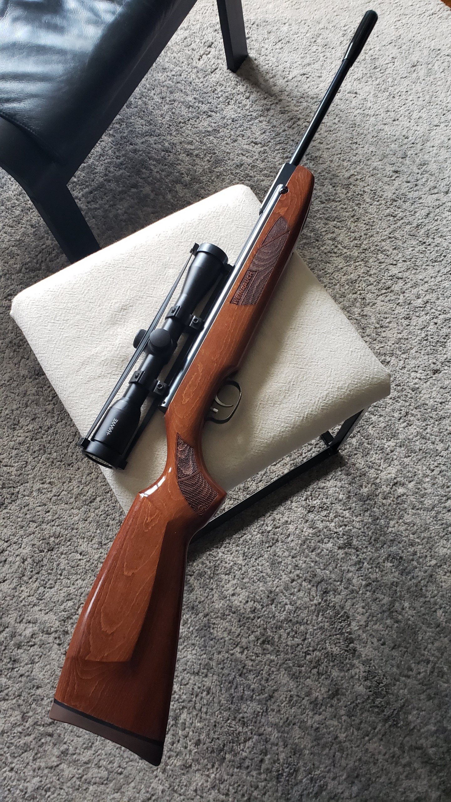

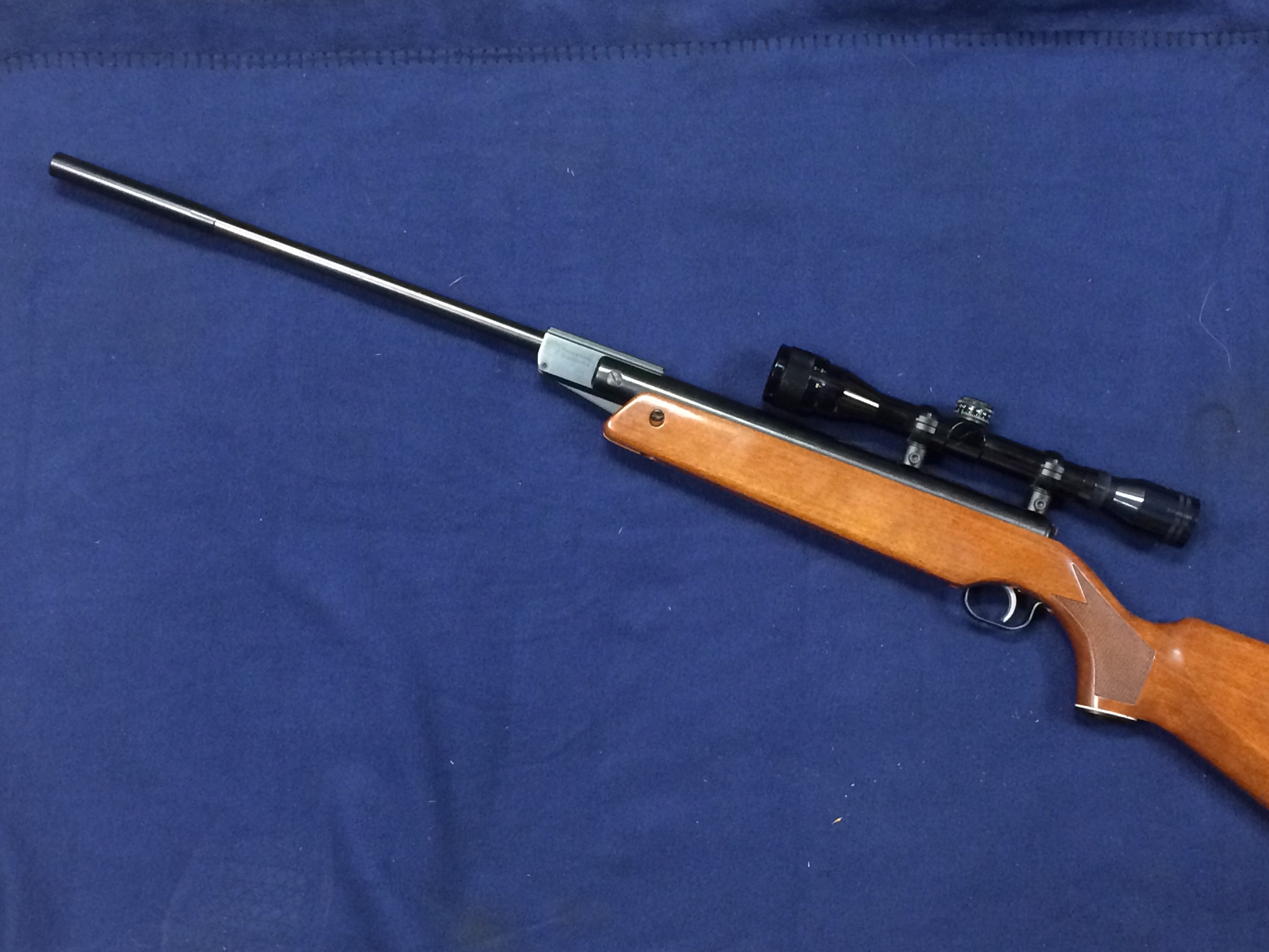

I'm not sure ARH has them any more. I looked a couple of weeks ago and they weren't in stock. RWS used to make a metal sleeve. And there's a member here that makes beautiful ones out of delrin. His login is SpiralGroove. His knock on as a press fit. They are very nice but can be tough to remove without damaging the muzzle brake itself. Here's a picture of mine on my Hw50. I'm ok leaving it on forever as a only want to use this gun scoped.
Good luck

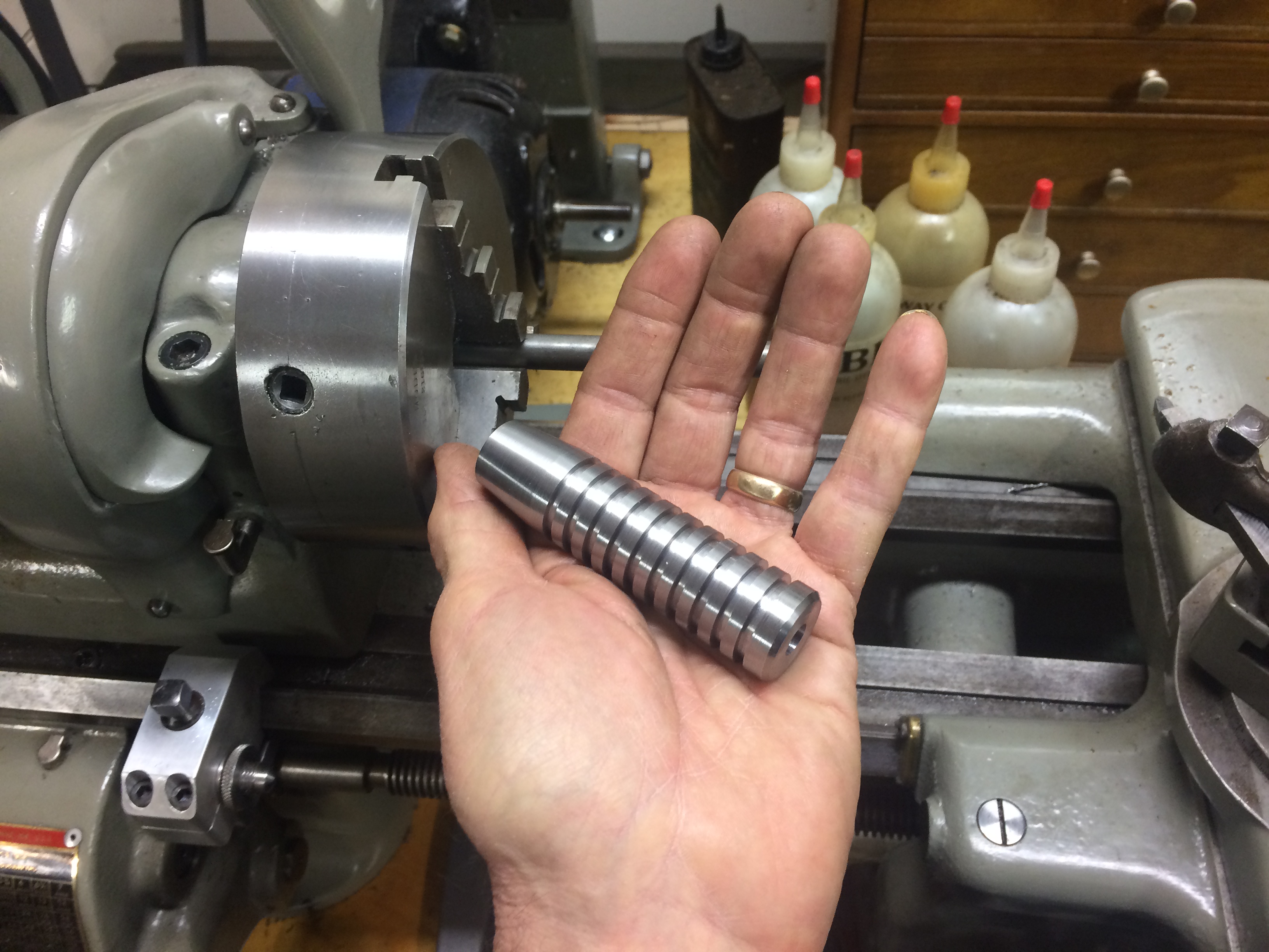

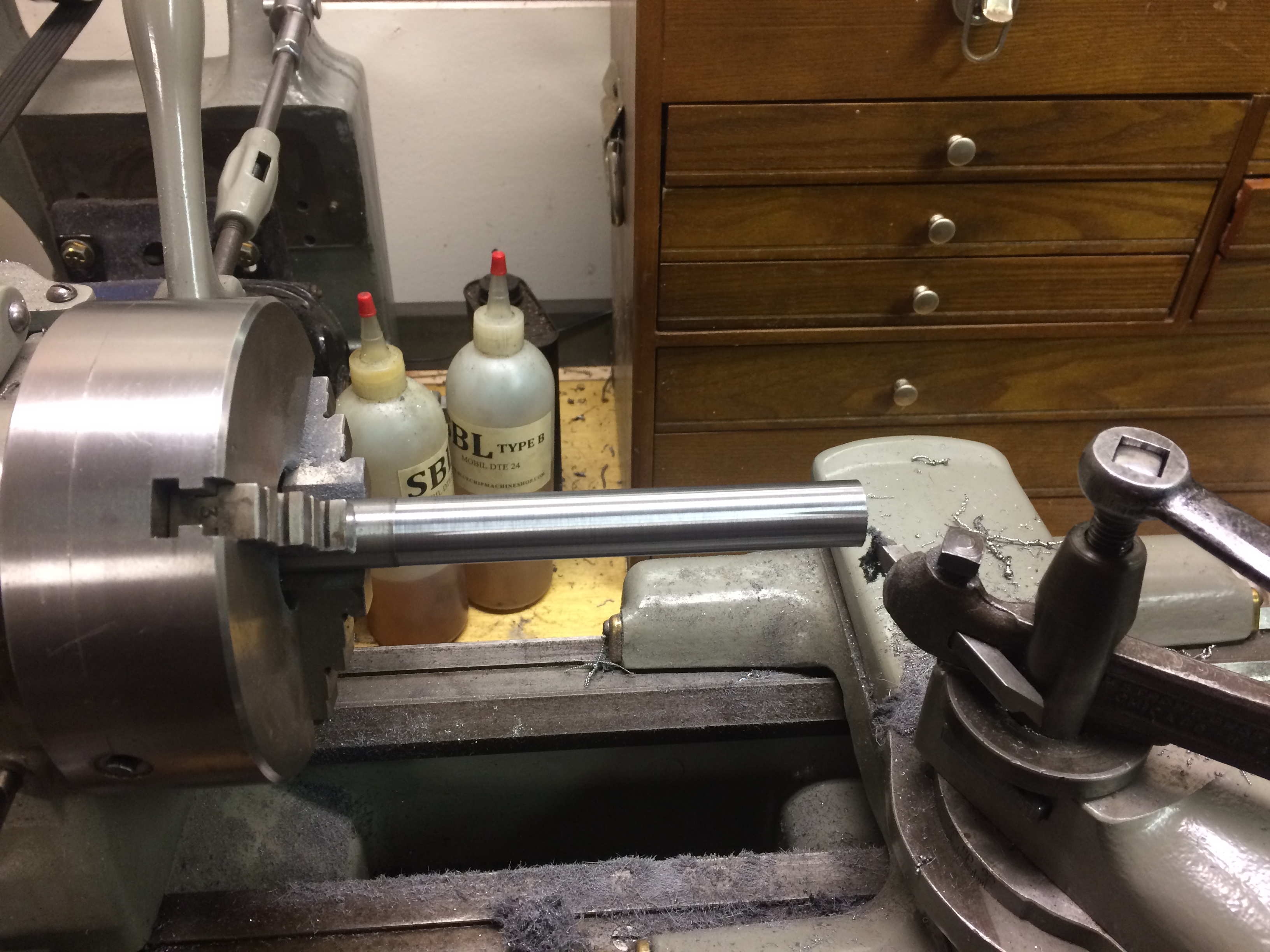

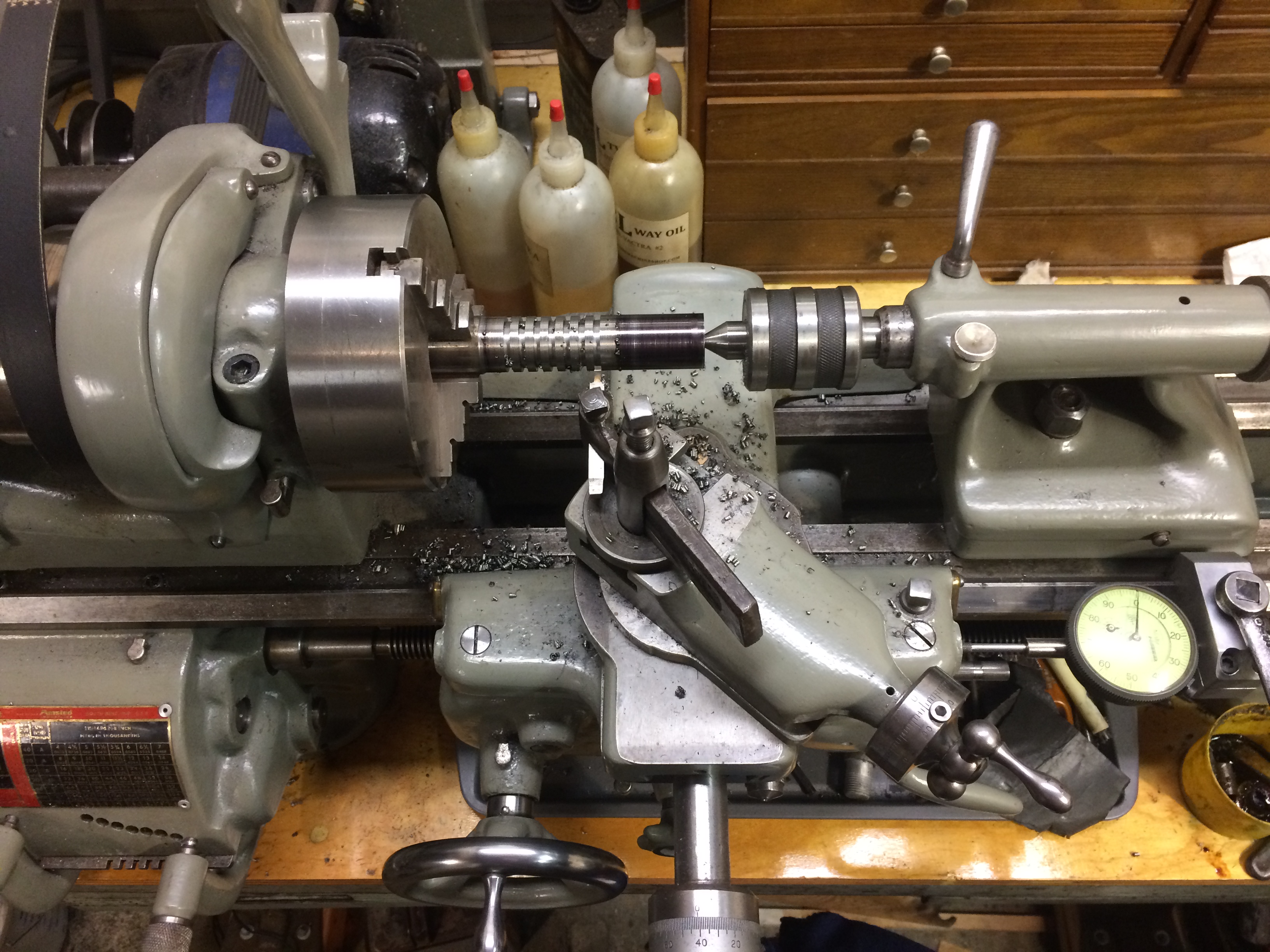

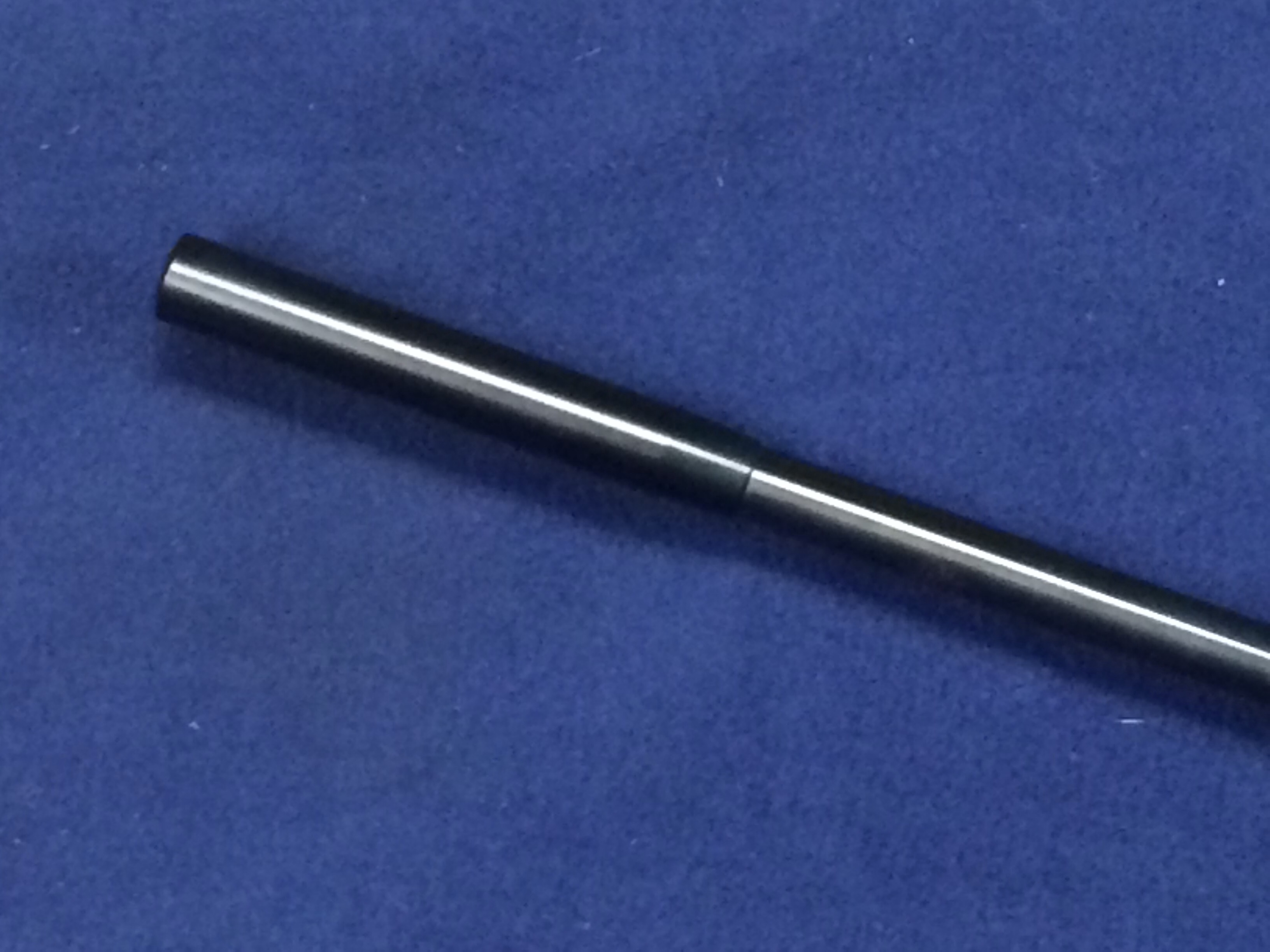

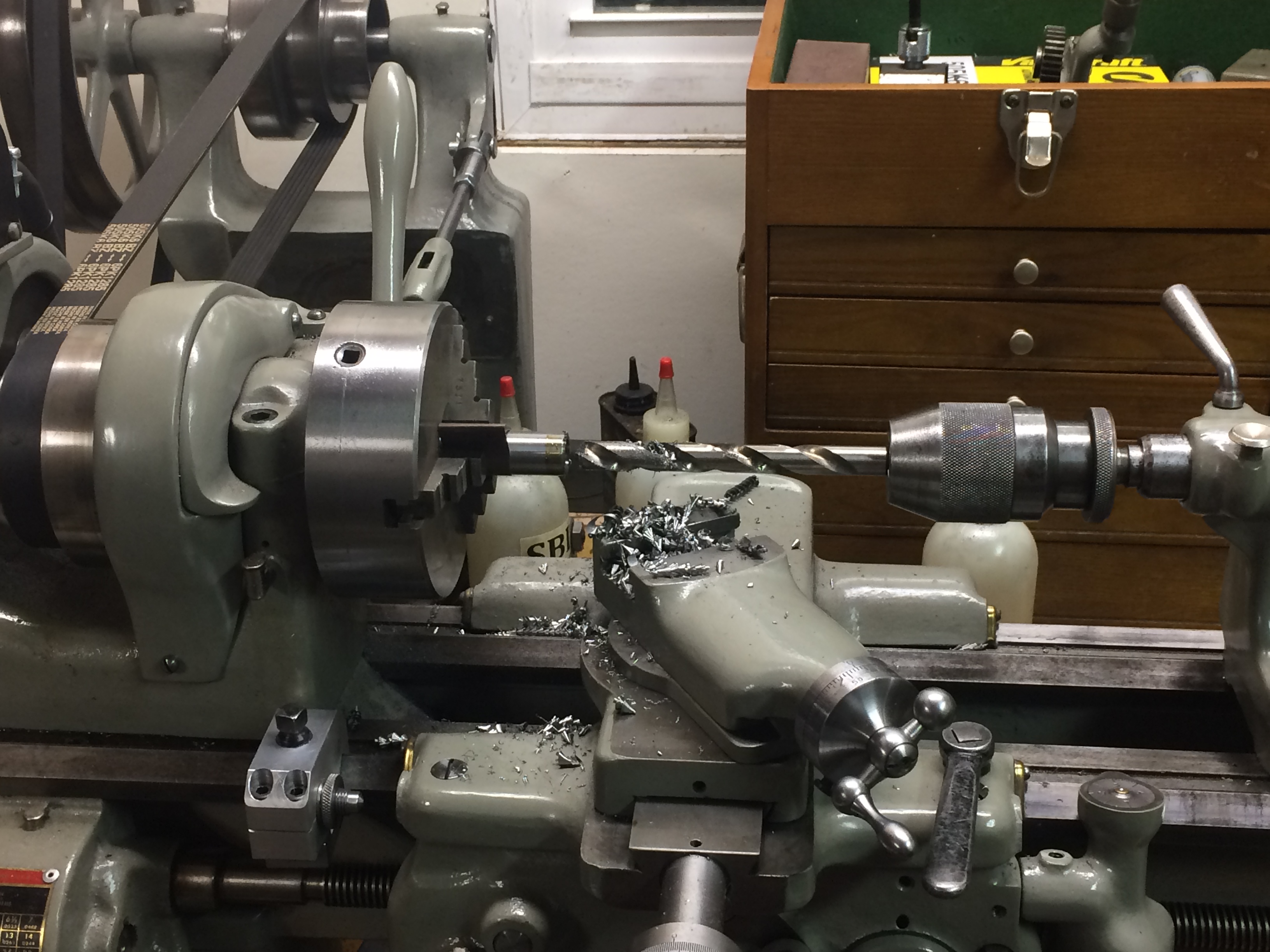

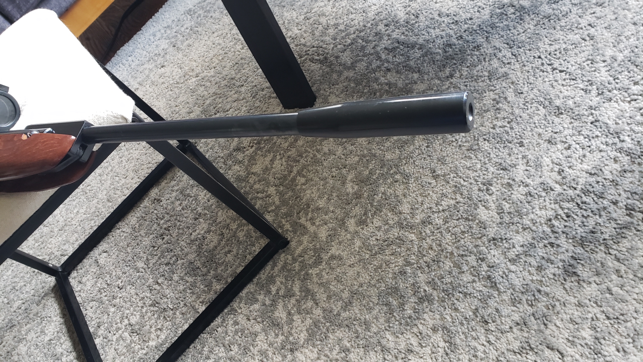

I prefer the slimmer and longer steel muzzle brakes I made. Glued on. Will come off with heat. Painted with durable epoxy paint.
Making one for my HW50 next.
View attachment 270938steel muzzle brakes I made. Glued on. Will come off with heat. Painted with durable epoxy paint.
View attachment 270933View attachment 270935
I agree the slimmer ones look better. Especially on a 15mm barrel. Yours are beautiful. Like you I'll glue on the ARH ones I orderd.
