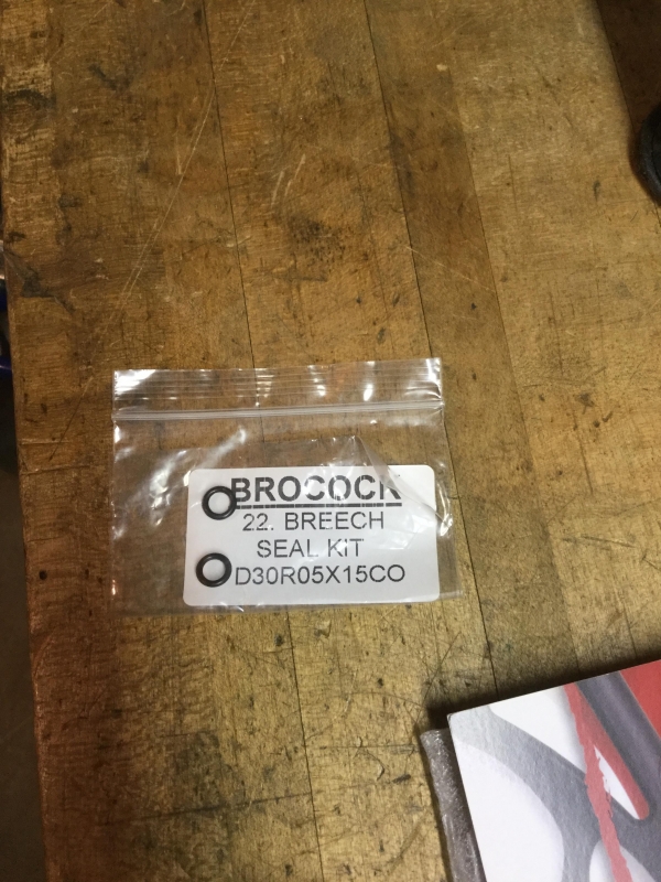

O ring for .22 looks like a 009 size, McMaster Carr has an excellent variety of quality O rings. I use Viton O rings
1538916426_20105701875bba004a0c0ba2.27835538_9D889EA0-0F33-4DF1-98C4-611719F9F3DF.jpeg
Yes, for Daystate Red Wolf .22 and Brocock Bantam/Sniper .22, the breech seal O-ring size is 5mm x 1.5mm. And Viton of 75 hardness seems to be the sweet choice for this. Available from a variety of vendors.

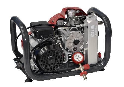

I bit the bullet a long time ago and purchased a Nardi Atlantic 100 compressor, fills bottle to 330 BAR, it was $1800 14 years ago, now they sell for $3195 at Pyramyd Air, this was money well spent, only takes about 10 minutes to fill bottle back up to 4500 PSI. It's a four stage compressor. Keeps all my PCP's filled. No more kissing ass to get my bottles filled Comes with refillable dry pack water/oil separator. Fire dept, Dive Shops, that was enough for me.
