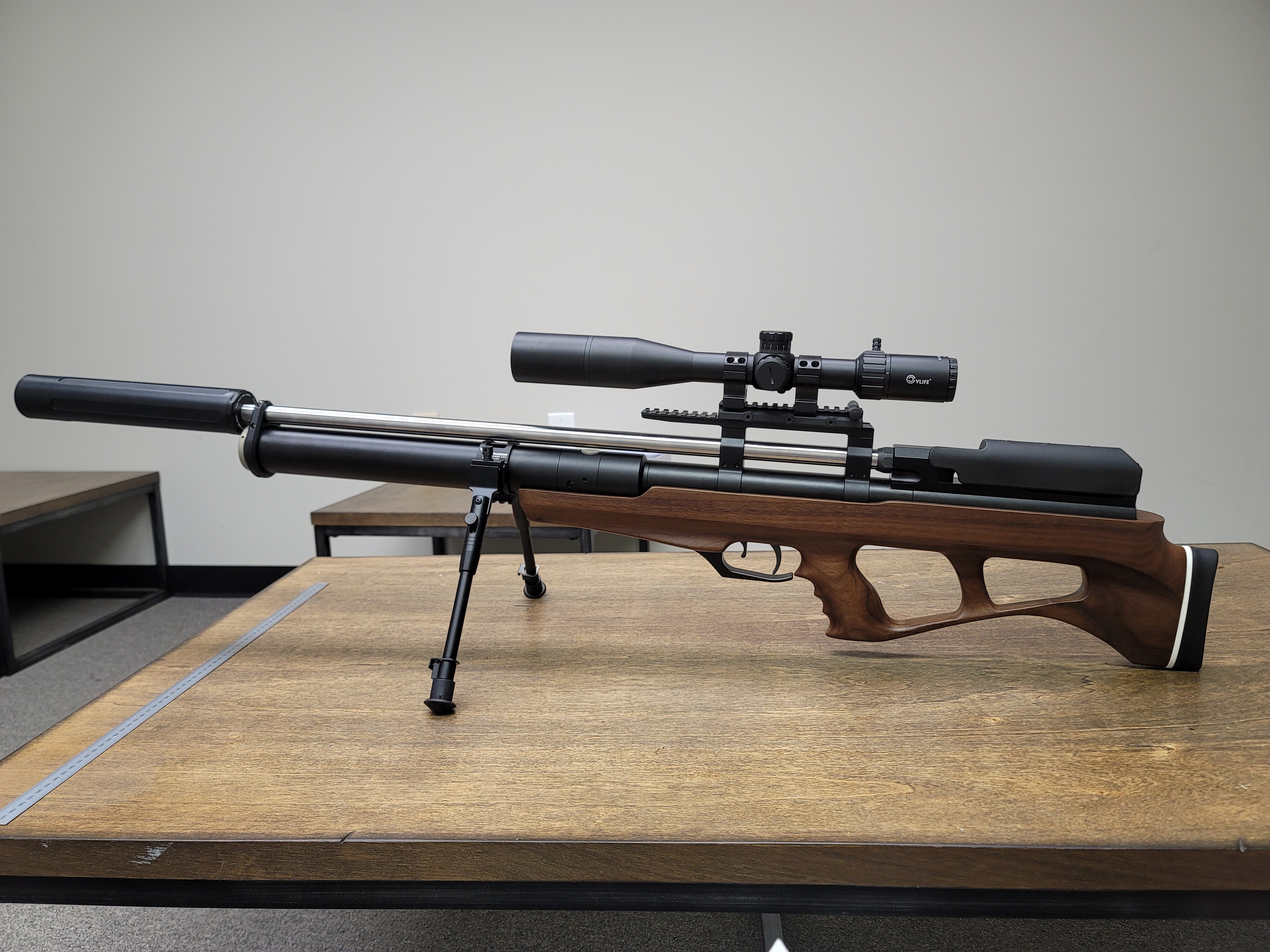

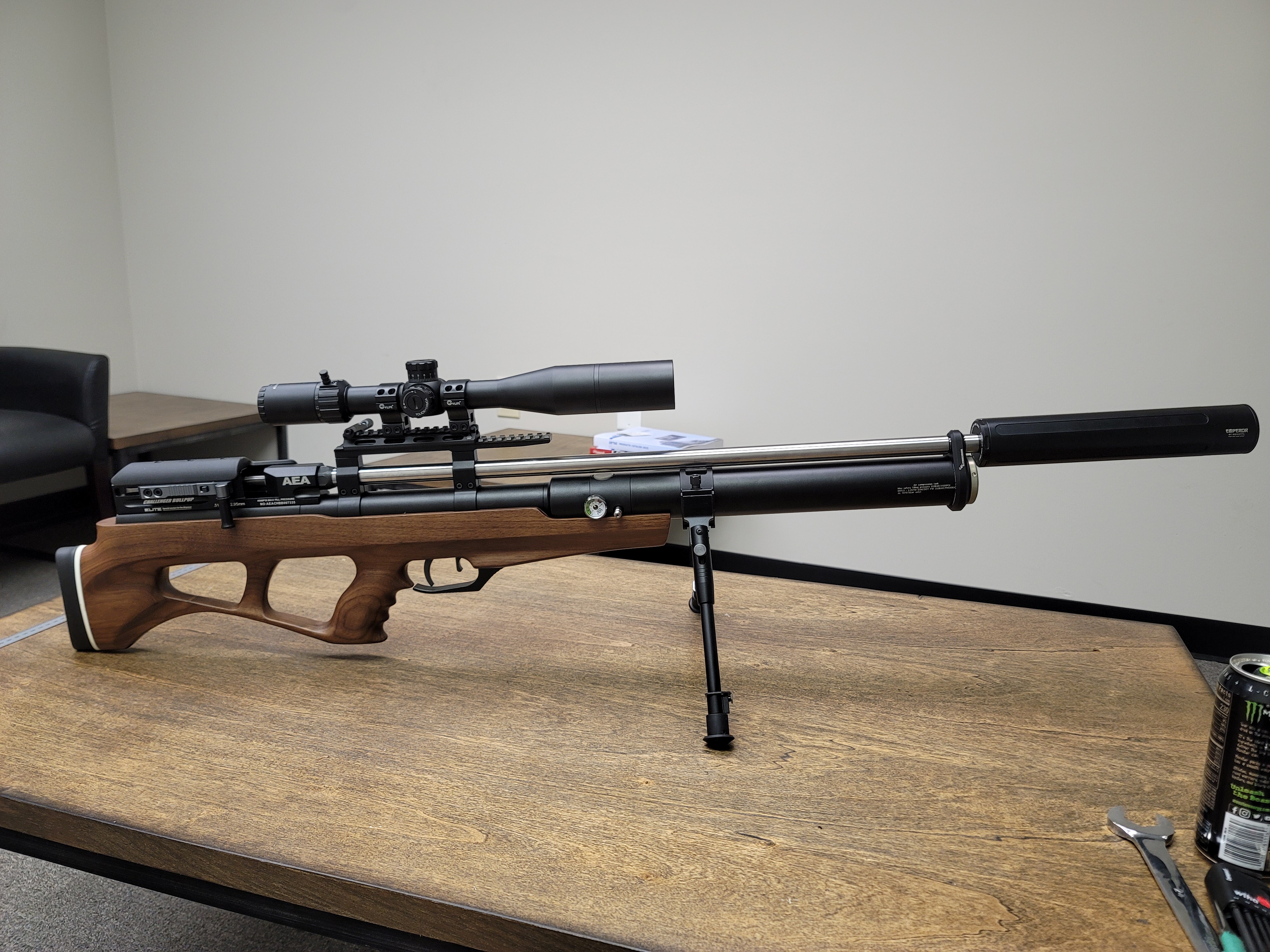

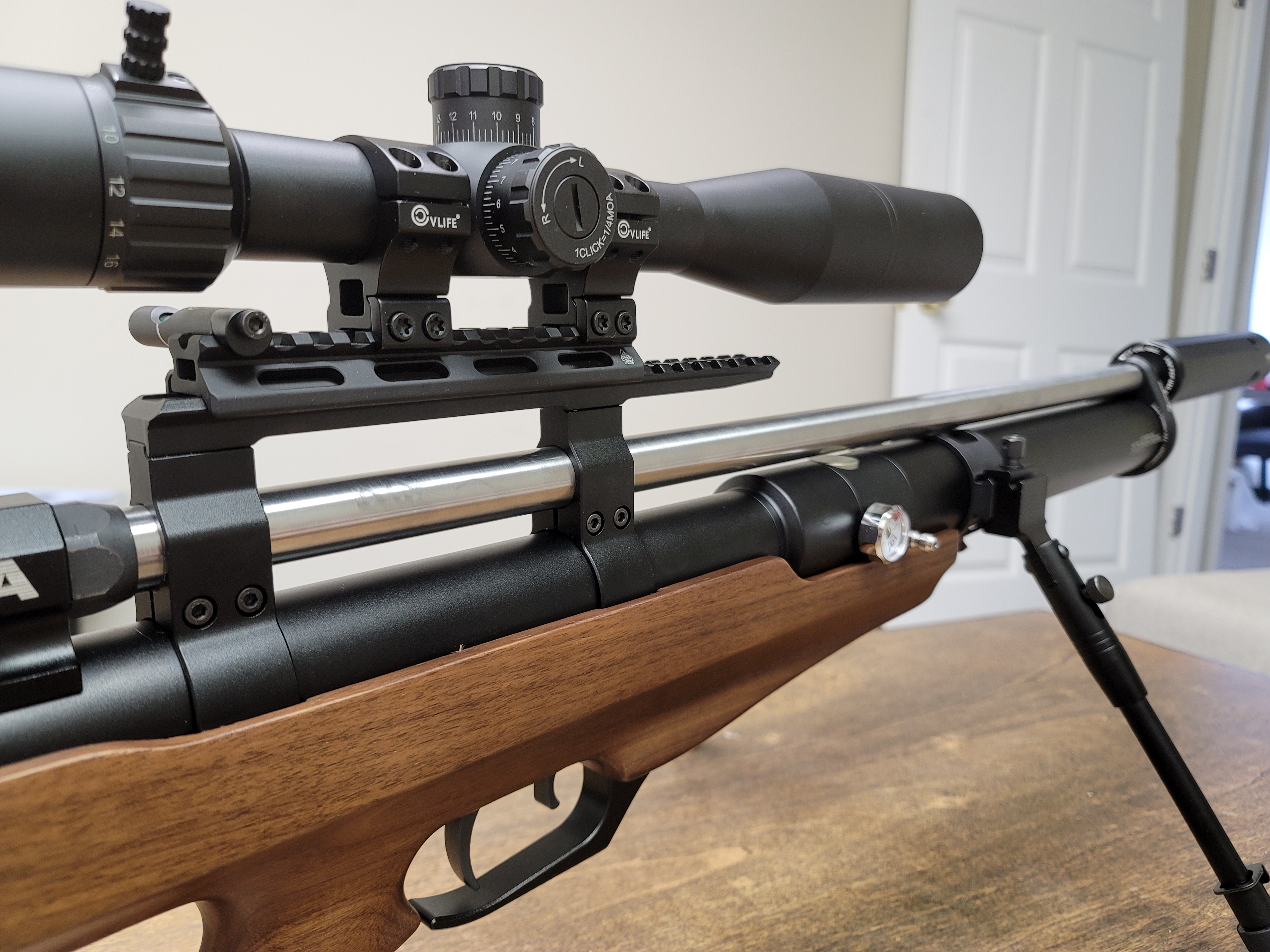

I picked up the challenger elite 51 back in January. Since then I've had nothing but severe accuracy problems. Many ammo types were keyholing and wouldn't consistently hit a 12"x18" target from 50yds. Some ammo was making better groups, but occasional fliers were so bad they would miss the paper. I dug into the problem by inspecting everything including the barrel. Turns out the barrel was made oversized. So big that a .510 slug would almost free fall down the tube. I sent the rifle back for a replacement which unfortunately wasn't any better. The retailer had done everything in their power so they put me in touch with AEA directly. The AEA rep offered no helpful solutions and made no offer to repair or replace. The rep stopped responding to my emails after the second or third reply. Completely ghosted.
Anyway, here we are. I've had this rifle sitting around looking like a $1000+ mistake since January and I finally have a way to fix it (hopefully).

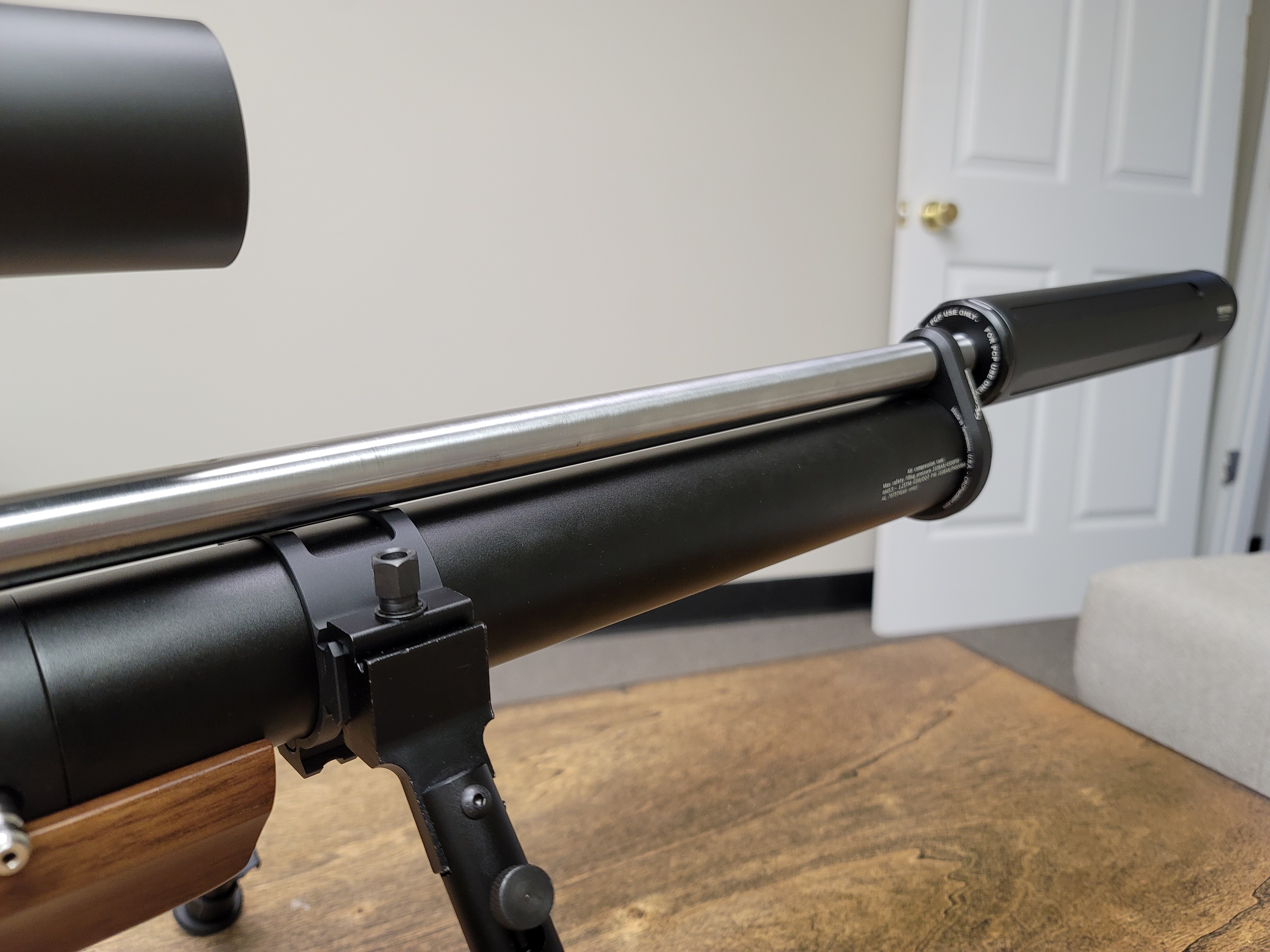

Step 1 was finding a blank barrel. Having a ~32" long barrel made things a bit difficult. Finding a blank with a reasonable twist rate that was long enough and didn't cost more than the rifle itself was pretty much impossible. So, I settled for a 30" long, 1 in 48" twist barrel from green mountain. Long enough, but just barely.
That blank sat around my shop for a couple months until a few days ago when I decided to start the project. Took about 10 hours with all of the measuring, modeling, programming and machining but it came out looking great.
Over the past few months I've made some other accessories for this bad boy as well. I made some billet barrel bands, some triple picatinny bottle clamps (shameless plug: now available at the pellet shop), and I have a prototype billet magazine on my desk that just needs a bit more work to be complete.
Only thing left to do is shoot it. Wish me luck. If a new barrel doesnt fix the problem I'll be at a loss for words. I've never had accuracy issues like this. Not with an air gun, not with a powder burner, not with a compound bow. Maybe with an airsoft haha.
Looks really nice with the raw barrel. I tried to cold blue it but it wouldn't take the blue at ALL. I just double checked the website and turns out it's stainless. Sweet!

On another note, the new barrel works.

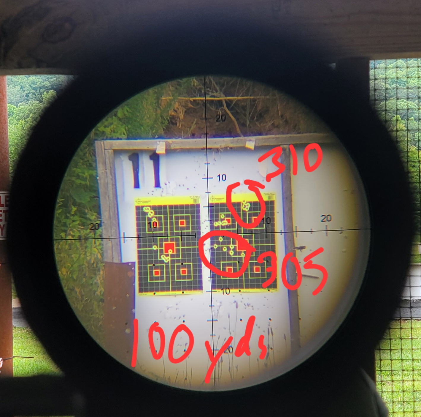

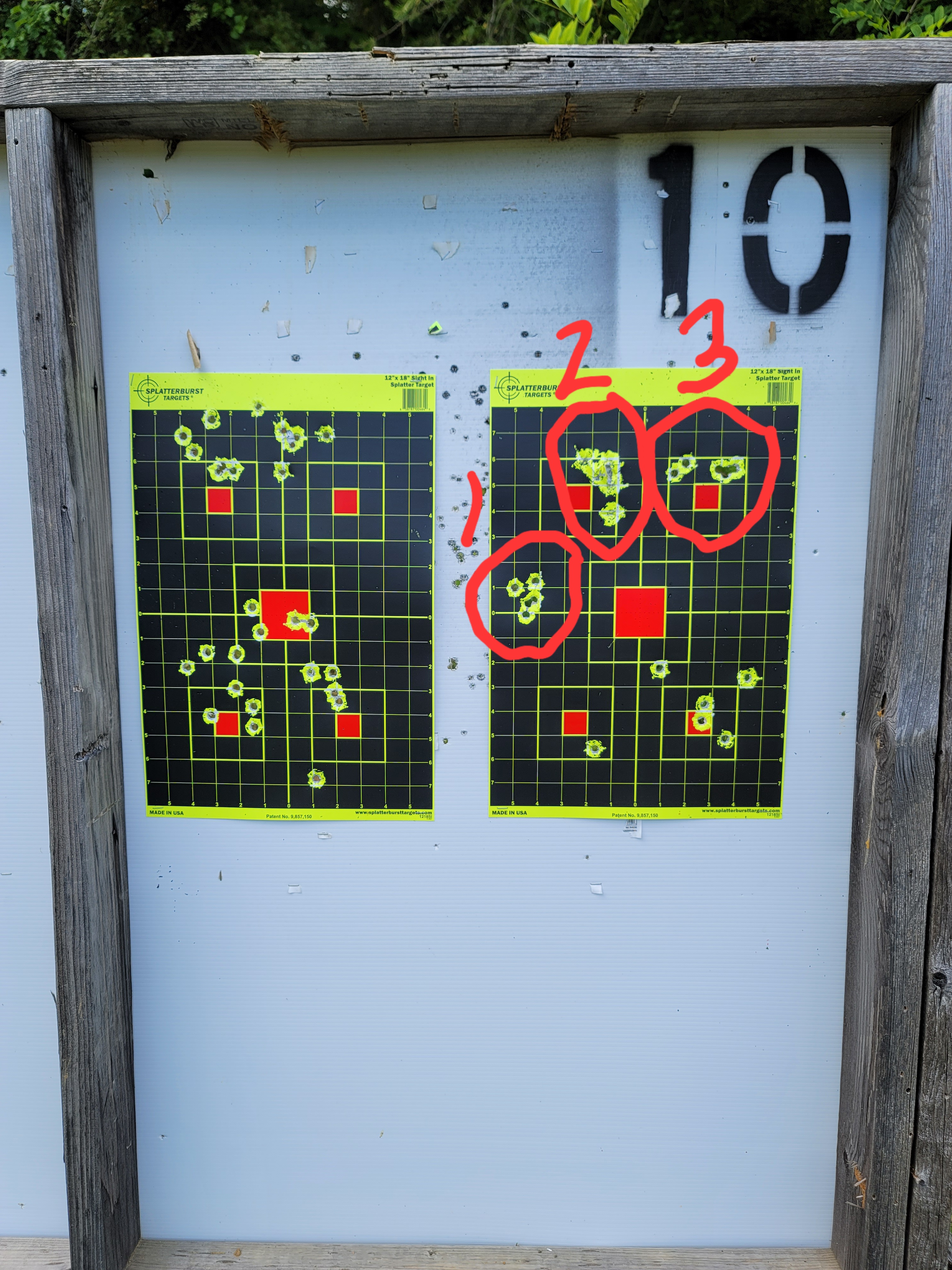

Great day at the range. All of the ammo I tried was stabilizing with the new barrel. Zero keyholing.
These targets are at 100yds. The first pic was me trying a bunch of different ammo. I labeled the ones that I remember. Reg set at 200bar.
1. AEA lathe turned .510. Figures the most expensive makes the best group. I only had 5 shots.
2. Some spitzer points I got from sonnysan. NOE mold I think.
3. Mr hollow point 255s
Second pic is mr hollow point 255s on left and mr hollow point 305s on the right. 255s were at 900fps and 305s were at 840fps.
Now if I could just adjust that hammer spring.... it's definitely hitting too hard at 200bar.

You have a shooter now!!!!!😀😀 More accurate than my Texan at a 100 yards....That is a impressive shooting big bore now!!!!!!

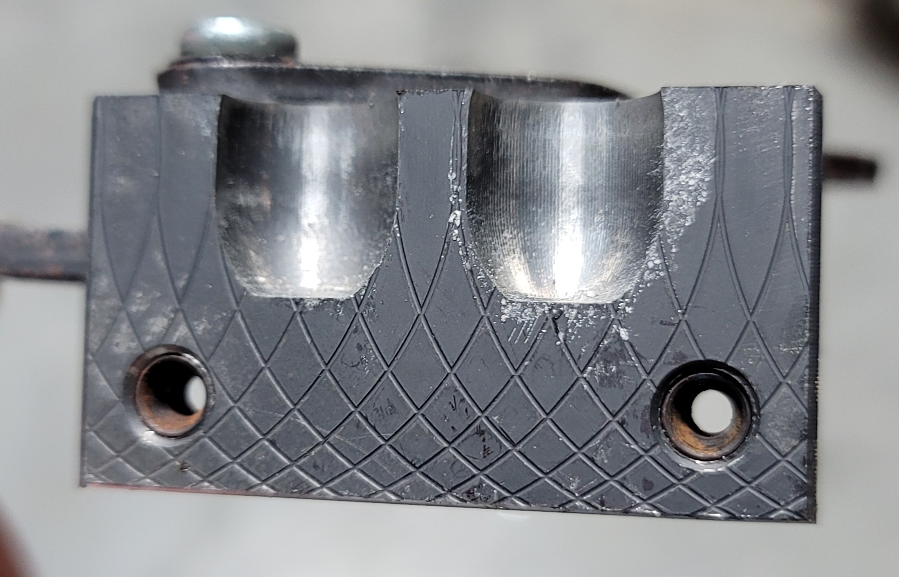

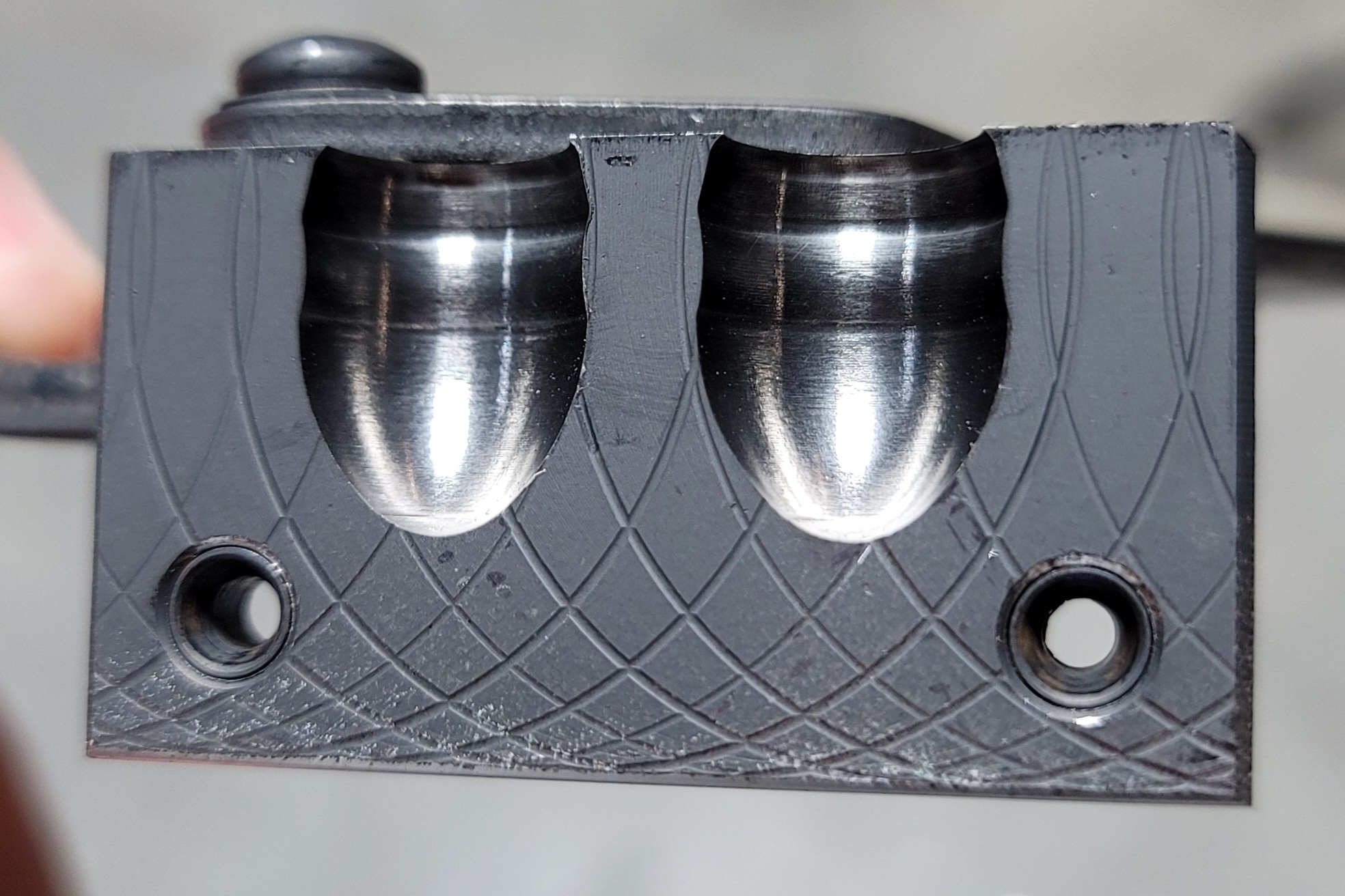

You are correct. A NOE mold: https://noebulletmolds.com/site/shop/bullet-moulds/512/510-401-sp-bj6/510-401-tc-bj6-4-cavity-pb/
