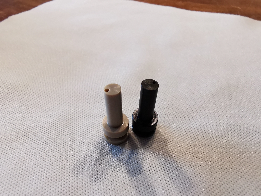

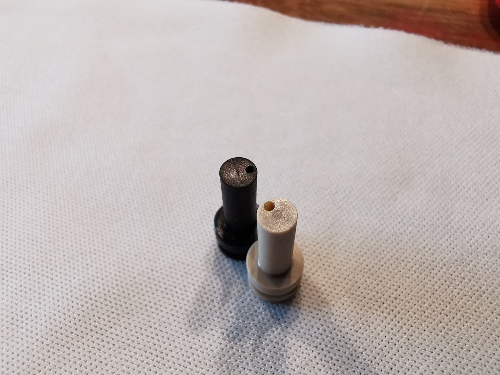

FX impact PEEK regulator piston
When your Impact parts are already spread out over a square meter on the kitchen table.......
I thought, why not make a PEEK regulator piston right away? :)
This was a challenge, making a 7mm x 16mm part on a 800 kilogram lathe and a 300kg milling machine.... the vent hole is 1mm diameter to give you a idea of the size.
Good news, it even works too :p
Not that the original Delrin one isn't good, but I had to try it out. PEEK is harder and stronger, but I had to find out if it is able to seal as well.

I believe you, there are differen sorts of PEEK. When you have the glassfiber filled version, you might get into trouble while machining.
I have used the unfilled natural version. It is very easy to work with, and I assume also better suited for sealing purposes :)
Thanks for the compliments guys, this one went well, just felt the need to try it.
It works a charm, no creep at all, and it seems to be very stable. Will see how it will turn out over time.
