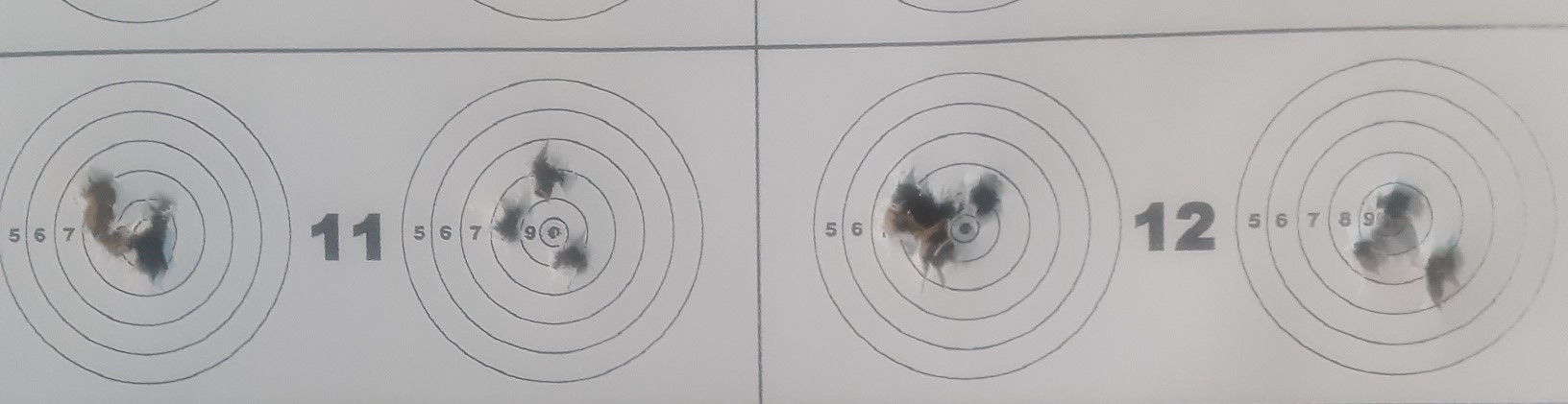

As planned, I shot all 8 of the .453 head size and an equivalent number of the .452 predominant head size this evening. I was waiting for the wind to die down and it did some but there was still a gentle breeze at about 2 O'clock (toward me and left to right). The .453 are in block 11 with the target on the left a 5 shot group and the one on the right a 3 shot. I did the same thing with the .452 in the 12 block.
I don't think they impact at a different point but both the 5 and 3 shot group with the .452s seems a little tighter. I will shoot a target with the .452s next. I still may not sort them in the future but how I do with the sorted .452s will influence that. For general shooting I am comfortable not sorting the question is just if I can raise my 30 yard challenge score a little with sorting. I measured velocity while shooting these groups. The .452 might have been a couple fps slower but all except the first shot were 87? velocity. The first shot was 865. This gun doesn't love it when I turn the hammer spring down 5% from the peak. But even though it's about 10 fps slower it impacts at the same place (at 30 yards).

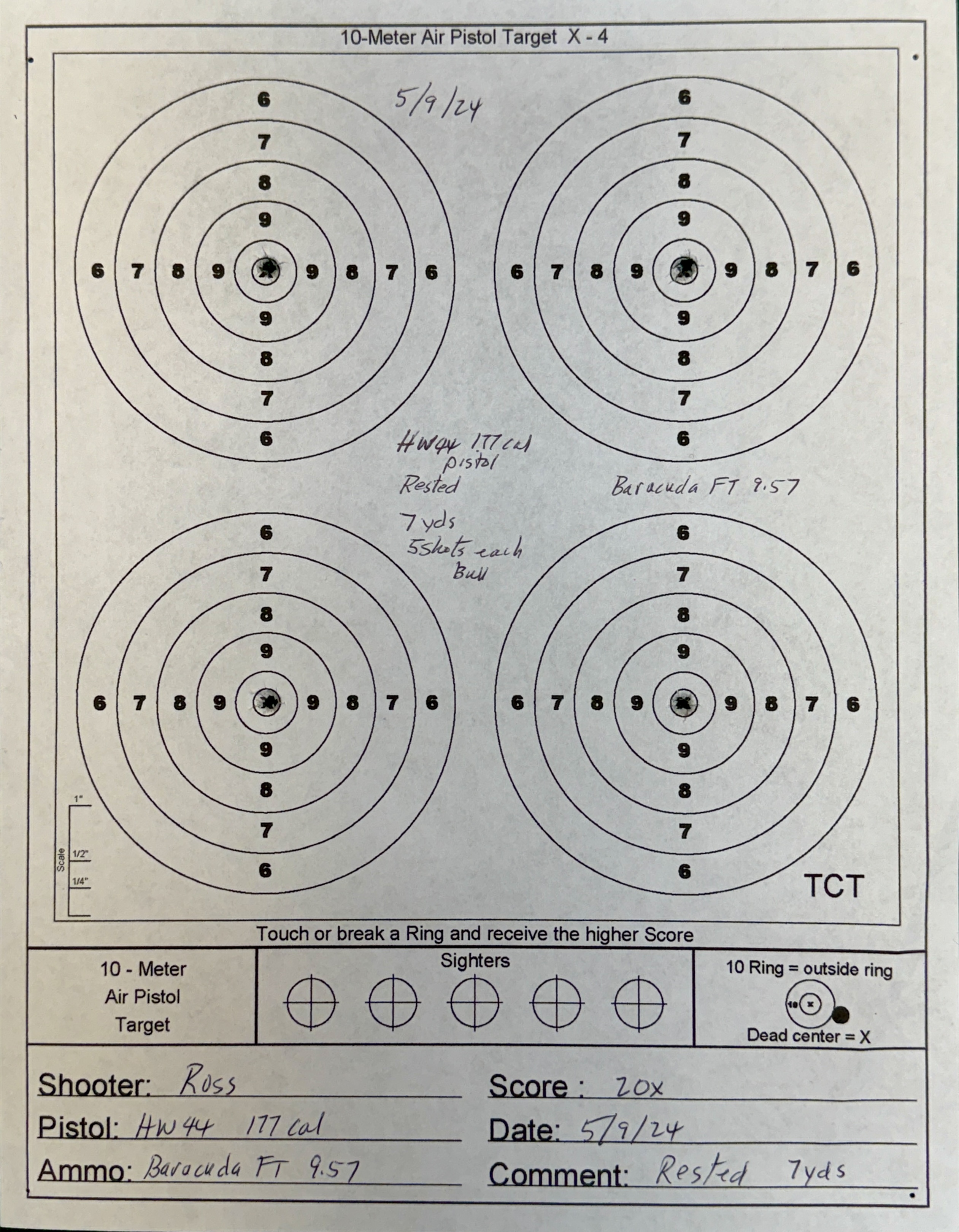

This target was at 30 yards which is where I shoot the 30 yard challenge targets. I wish my 30 yard groups looked like those 7 yard groups.
