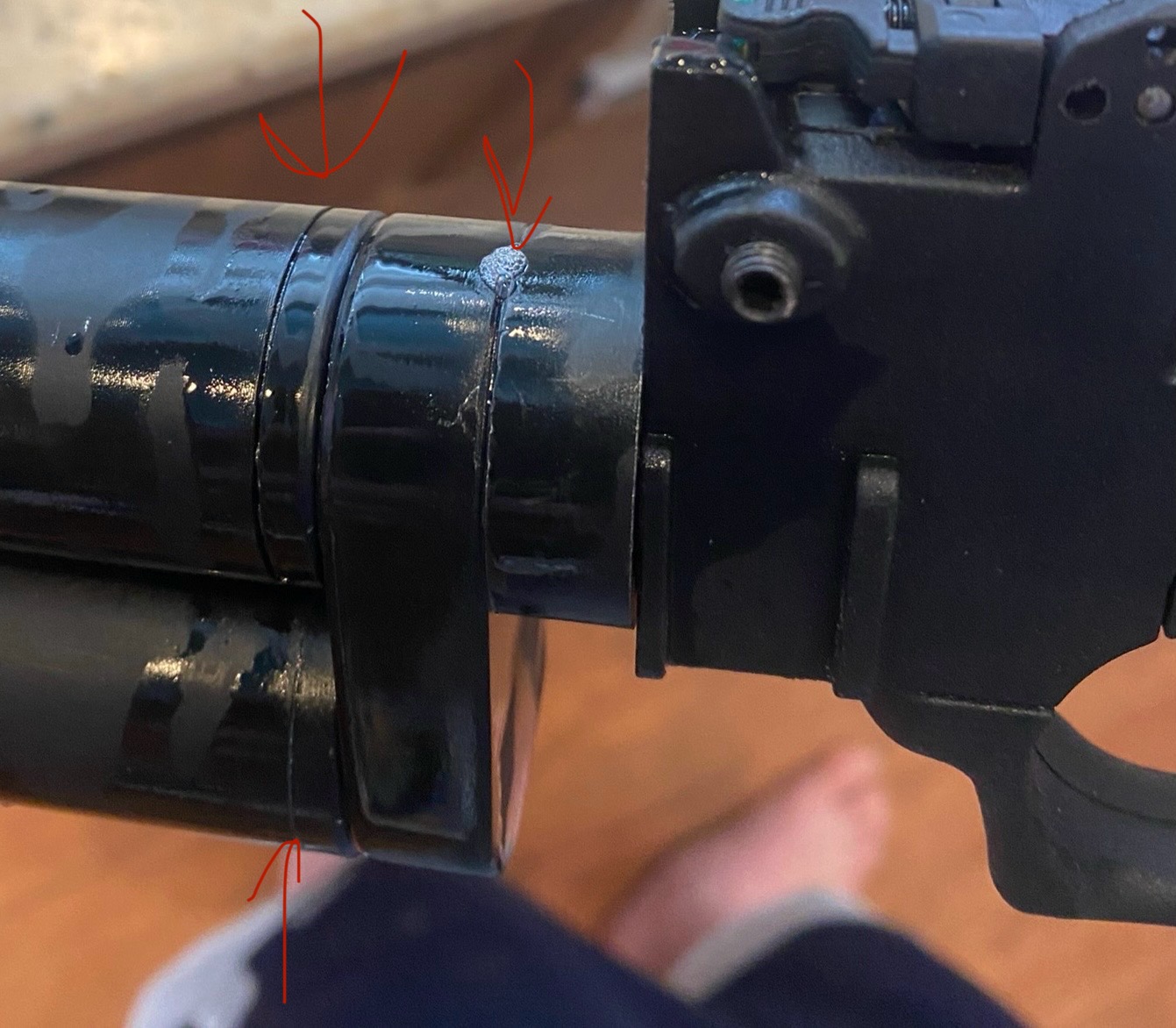

I spent quite a bit of time trying to locate leaks. I finally resorted to using soapy water. this revealed 3 different leaks. one where each reservoir meets the manifold, and then just after the manifold itself. Now I'm trying to decide about how to proceed, as I'll likely not have help from the company. I may start a dispute with the credit card company.
In the meantime, has anyone had this problem? I took the cylinders off and I'm thinking I'm going to need some tools to get to the o-ring (which I don't have a replacement for). Also the manifold has 4 Allen screws that seem to be loctited in, worried I'm going to strip it. I really wish they'd just send me a new tank. It looks suspiciously like there was a machining defect on the mating surface of the manifold where it contacts the cylinders, and it may have been dropped during assembly as there are some gouges.

With Hatsan it's probably an issue with assembly. So probably a pressure guage or the tank. Check tank o-rings and make sure your pressure gauges are nice and snug but not overly tightened. At the rate you describe the leak I would not be surprised if it was a pressure gauge that needs a little adjustment one way or the other. Usually if it leaks it is too tight. If it's too loose you will easily notice.
