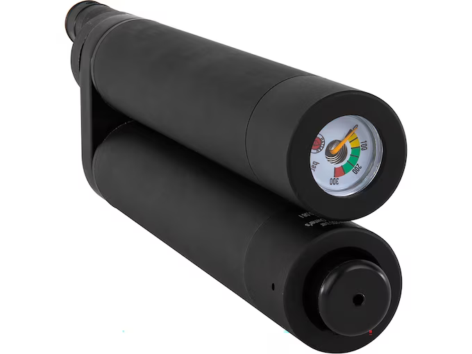

Pretty sure you can buy one of these for the Jet II and throw it on the Jet.
I want one to try and fit it to my Notos to add more air in a slim package.
I heard that there's a jet 3 coming 🤔 so will the make 3 tubes stacked? might be more height than grip.

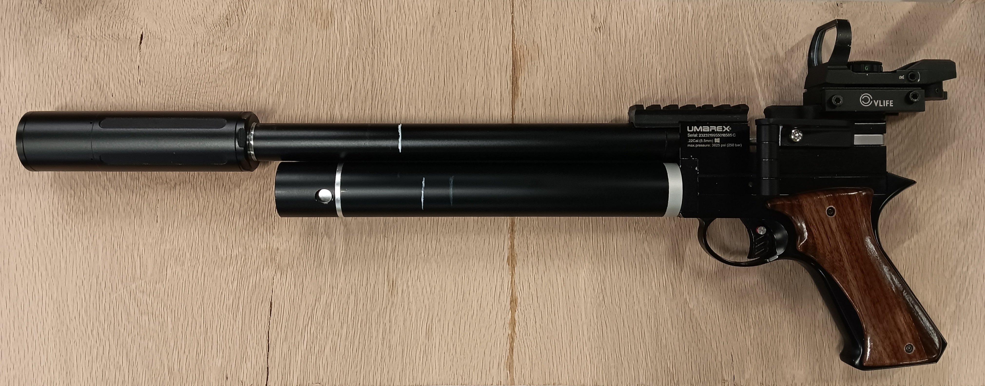

I have the notos with factory grips and open sights.. yes 22" long is too much, but I shortened it with a 4" moderator inside the shroud, I had to shorten the 11" barrel 4" and I expected it to be louder and not as accurate.. it's actually more accurate with my crown and thanks to Dallas for the moderator it's quieter than factory.. now it's just under 16 inches long..

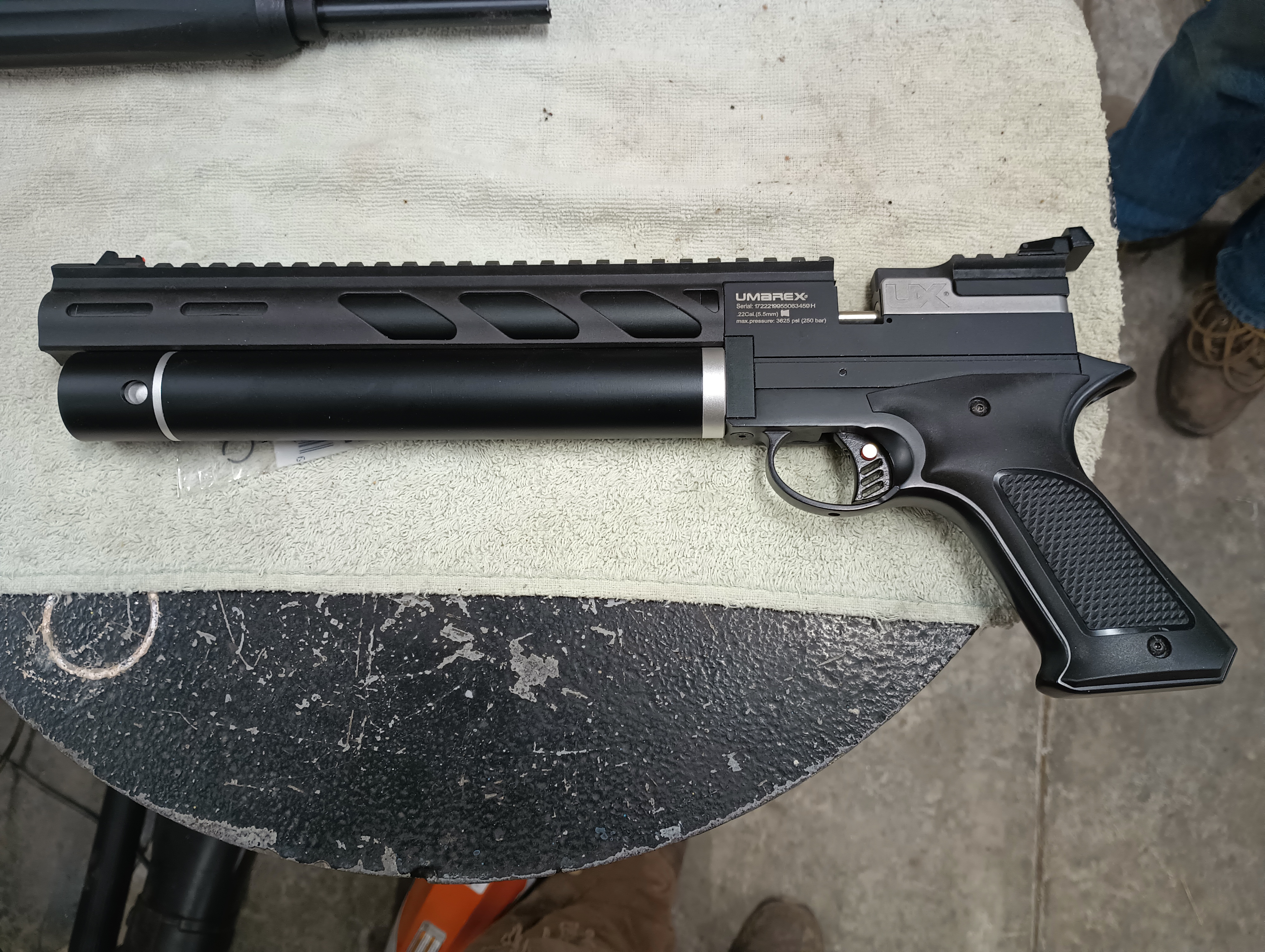

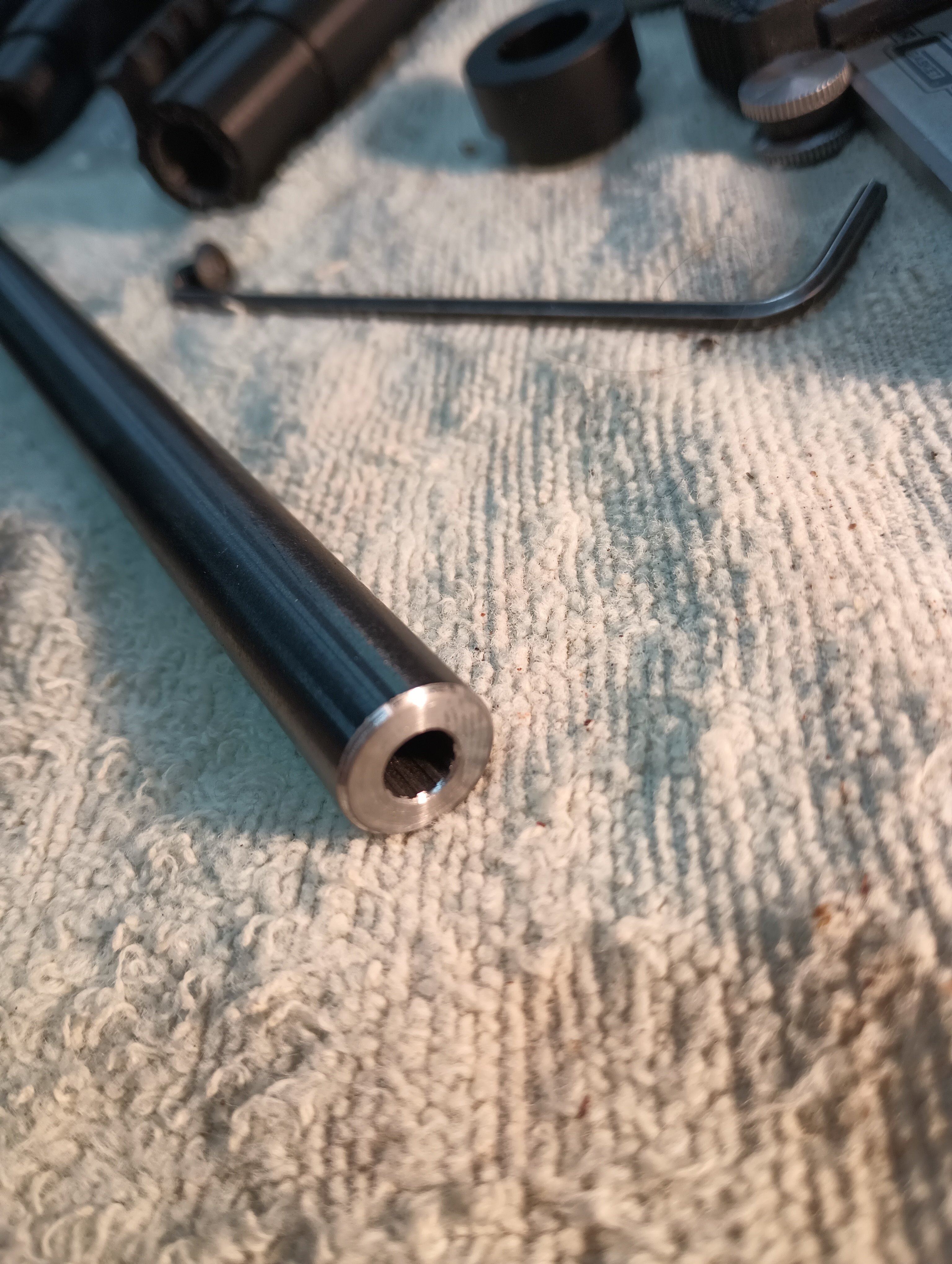

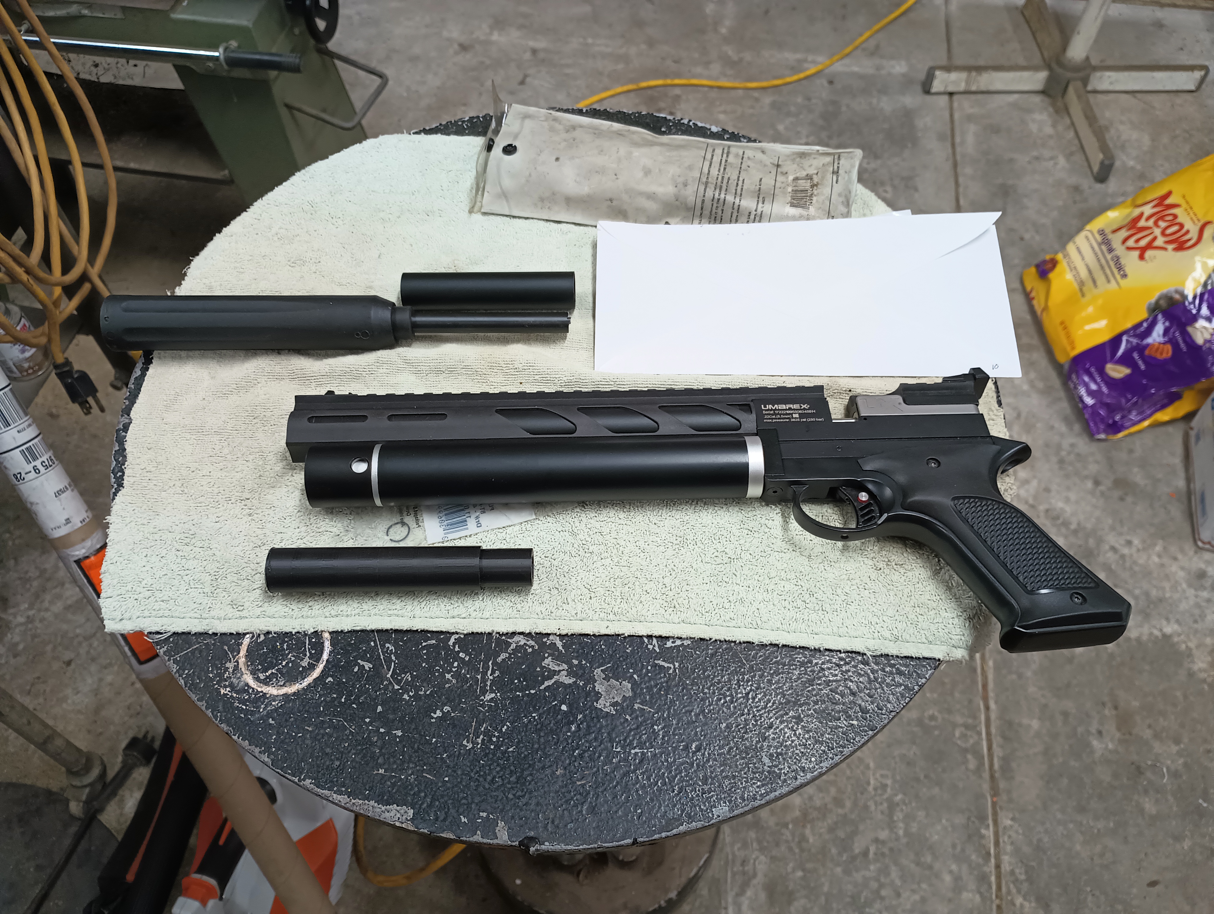

pictures of my finished notos, now a large pistol just under 16 inches long but it's better than the factory 22" long..
it now has a moderator inside the shroud and vents inside the inner shroud.. great new crown , I learned from a old gunsmith..turn the end perfect, do the outside corner bevel and then spin it on high in the lathe and use a die grinder attached to the lathe for a 45° with a fine stone spinning 19k rpm.. under a magnifying glass the inside of the crown was perfect and crisp rifling ends and it's quieter than factory, more accurate than factory..
thanks to firewalker for o rings and sharing information,
thanks to Dallas for getting the moderator printed
thanks to Felix for loaning a chronograph
Mark

Purdy dang sexy!
Looks factory! Very Impressive!
