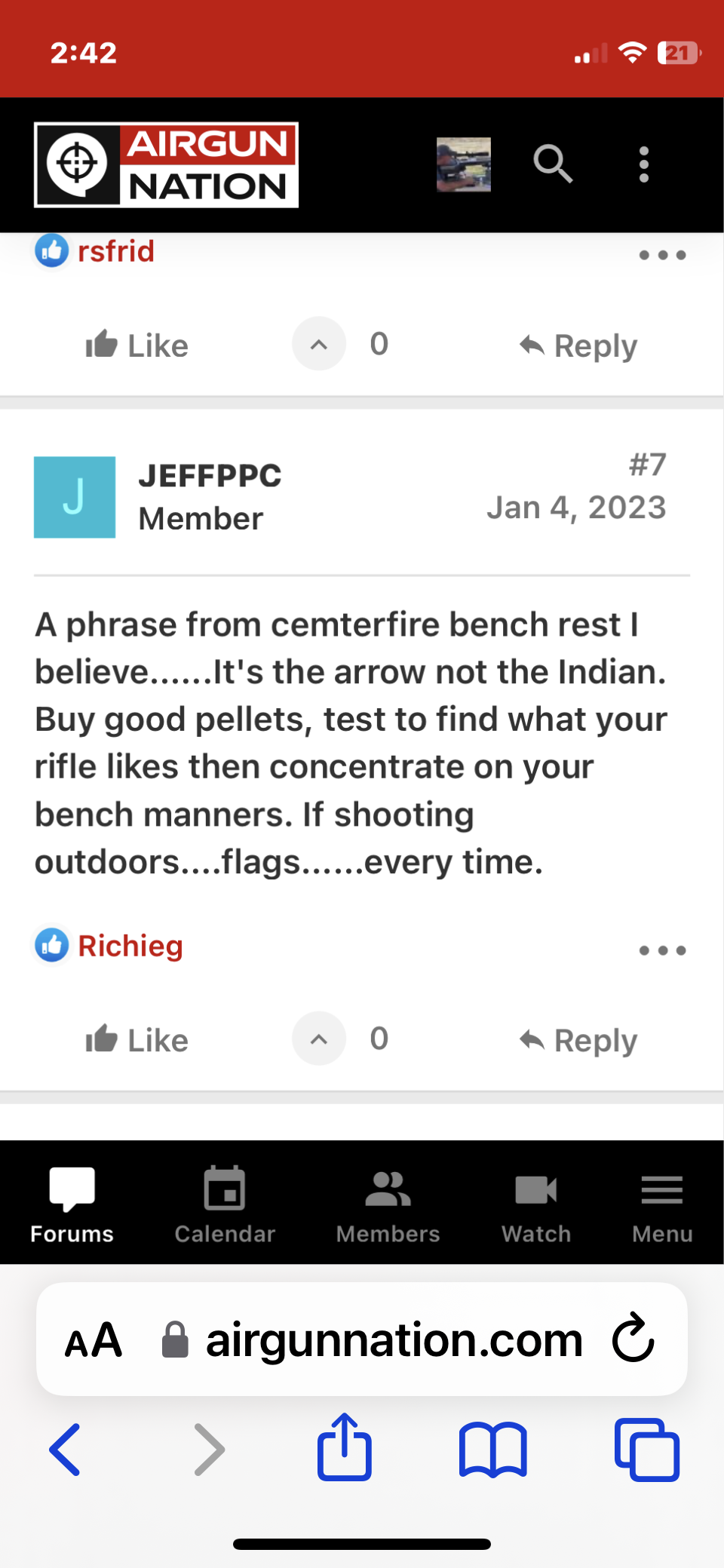

Hey Jeff…so which is it that you believe?
I quoted a phrase, not my thoughts or words. I am firmly in the Indian camp. Good equipment seldom fixes an incompetent Indian. But a good Indian with bad arrows will have a hard time. I have seen lots of mediocre Indians with good equipment seldom win. Usually the Indians who have put all work to develop good skills have also realized the importance of and put together good equipment. So in a word. Indian.
