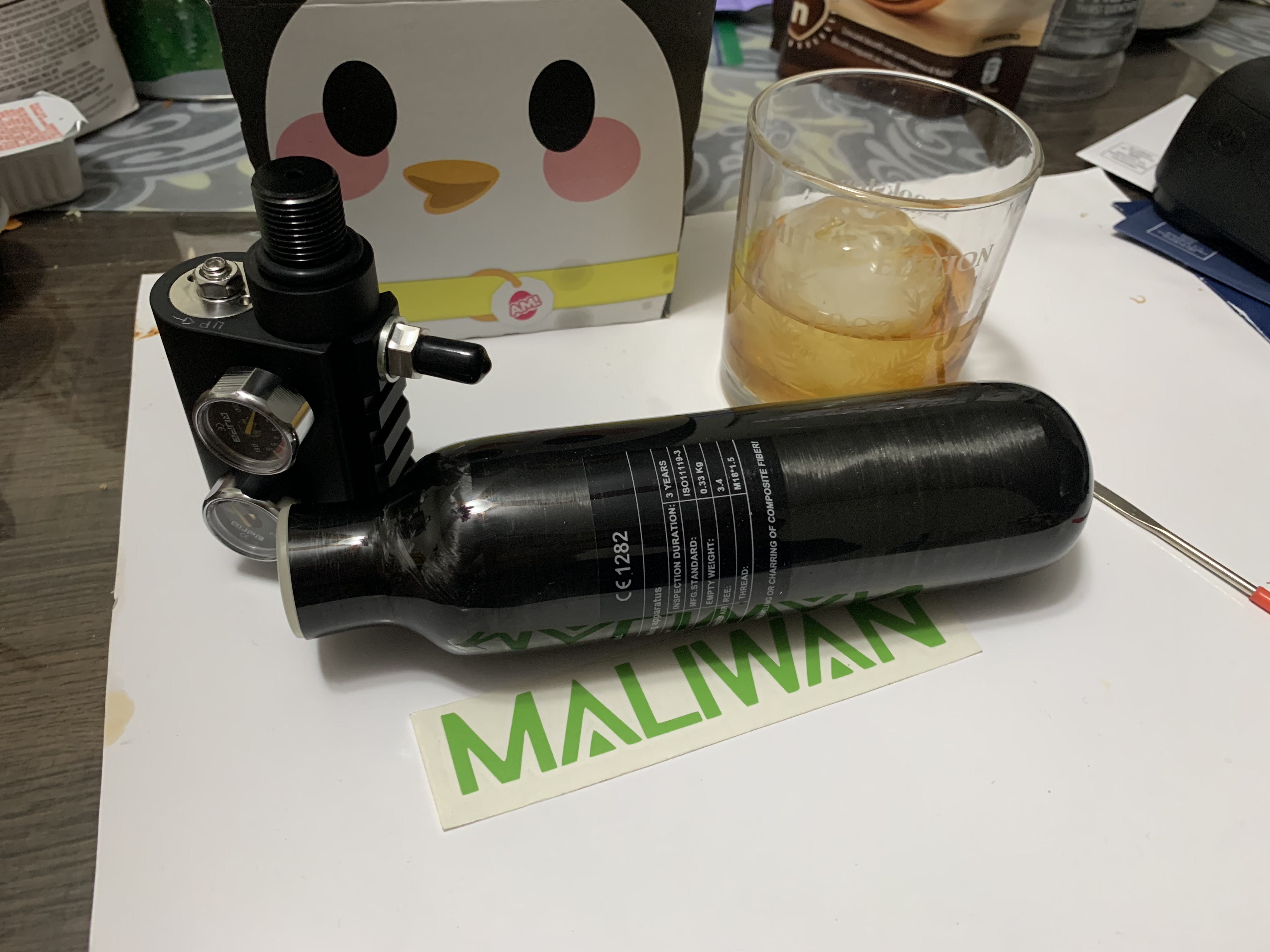

Noto is a great plinking/target airgun out of the box.
Adding a drop block for $70 and a carbon fiber bottle for $90 or an aluminum bottle for $30 would add another $100-$160 to an airgun which can be bought for about $220-$230 new.
It would also add about 1-2 lbs to a very light airgun.
What exactly is the point?

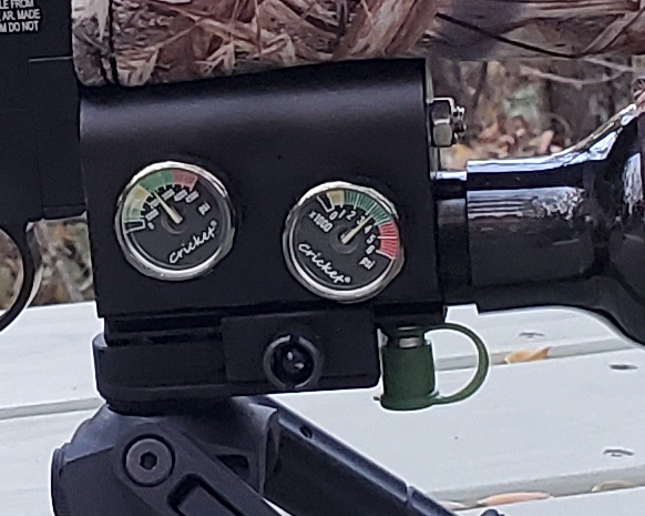

I couldn't resist. Bought a used Notos here off AGN and one thing led to another. Just finished up a bottle mod today with a Huben Cricket regulated pic railed drop block and 220cc bottle. Also added some camo bling. Shooting pretty good. Thanks all for the inspiration and direction for customizing this awesome platform.
That is so freaking cool! Well done. That shot count is awesome

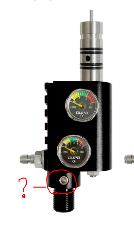

Can you show or point out on the picture of where / how you released the pressure on the drop block before you unscrewed it?
Also, If I purchased this one below, would I just loosen the screw that I have circled? Thanks again,
Hey Mik,
Adjusting the reg is pretty easy. The adjustment screw is shown here. You'll want to loosen the locking nut a bit then use allen key to make the adjustment. CCW to raise reg pressure or CW to lower reg pressure. OK to raise pressure with air in bottle, but should degas completely to lower pressure. Doesn't take much to move the reg pressure. Go in 1/8th turn increments or less if going up. If you're increasing it, you'll be able to watch the pressure rise on the reg gauge. A couple dry fires will settle in the reg pressure as you're adjusting it. Tighten locking nut when you're done.
I've got one like that and I loosened the nut and turned the Allen screw counter clockwise and it didn't change the reg pressure. I turned it more and still nothing.
Shaky2
Which Z-block you get? The Huben or the Qupb? I've used both. Some tradeoffs. The Hubens adjust to atleast 2500psi whereas the stock Qupbs top out around 1800. I added a shim washer in the Qupb zblock reg and can now adjust up to atleast 2400psi. Haven't tried any higher. The Qupb zblock has a larger body and thus larger plenum volume so you won't lose any fps at same reg pressure as stock Notos. Likewise adding the eBay 15cc plenum along with the Huben Z-block and you'll be back up at same or higher fps. One thing else with the Qupb zblock, the foster fitting base is much larger than on the Huben so it makes adding the bipod not as streamlined. It has to sit closer to the trigger guard. Both Z-blocks have outstanding regulators on them. If you're going for a power boost, up around 25-26fpe, you can bore out the tube adapter port and transfer ports. I've done this on 3 rifles with great results. With reg at 2200psi I'm up at 880fps with CPHP 14.3gr, 850fps with JSB 15.9gr and 750fps with H&N 21.1gr. HS 2 turns in with stock spring.

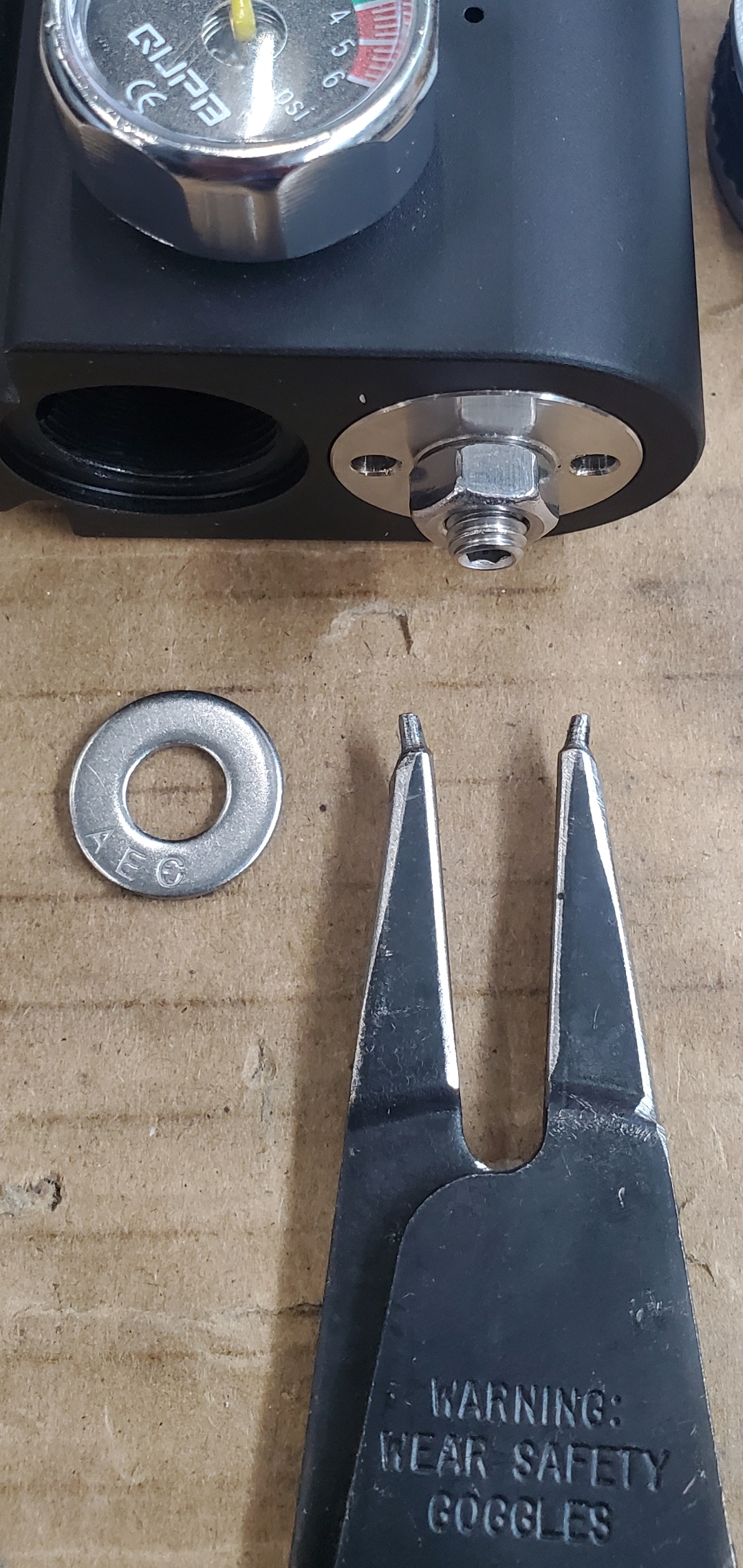

If you decide to increase the reg pressure, completely degas the rifle and then you can disassemble the reg and add a spacer shim. I used a SS washer I had on hand that was 16mm od x 7.4mm id x 1.45mm thick. I first sanded off the washer burr edges on a 400g sanding block. I used a snap ring tool to unscrew the reg access cover. Rounded needle nose pliers would likely work too. Remove the Belleville washers, 12 of them, and drop the shim washer in the reg cavity then replace the Belleville washers just like they came out. Here's the stackup that I had in mine. Inner ->shim | ))(( ))(( ))((<- Outer. Tighten the access cap back down. Loosen the adjustment locknut and tighten the adjustment screw CW to loosely seat it then back it off ~1/2-turn. Add the bottle fitting and the test cap on it. If the zblock is off the rifle, install the valve assembly on the other end. Hook up to your compressor and pressurize up to ~3kpsi. Watch the reg gauge, it'll only come up to around 600-800psi. Now you can slowly adjust the reg screw CCW until you are at 2200psi or so. Give that a try. If it's where you want it, degass the zblock and mount up on your rifle. I suggest keeping the test cap on for the initial fill and shoot a few shots to see where you're at velocity wise. At 4000psi on the inlet gauge, you'll get a few good shots with the reg test cap on there. This is faster than filling the 220cc bottle to get things dialed in. If it's shooting where you want, degass and swap in the bottle. If still too low, bump the reg up CCW another 50-100lbs. If too high, degass and adjust screw CW ~1/4turn inward. Pressurize and test it again. Adjust it until it's where you want it. On the QUPB Z-block I loosen the foster fitting to degas. The setscrew in the bottle adapter fitting is a bottle isolation "valve". Degassing with it resulted in a damaged/cut
oring on mine. That setscrew needs to be loosened ~3/4-turn to allow bottle to fill.

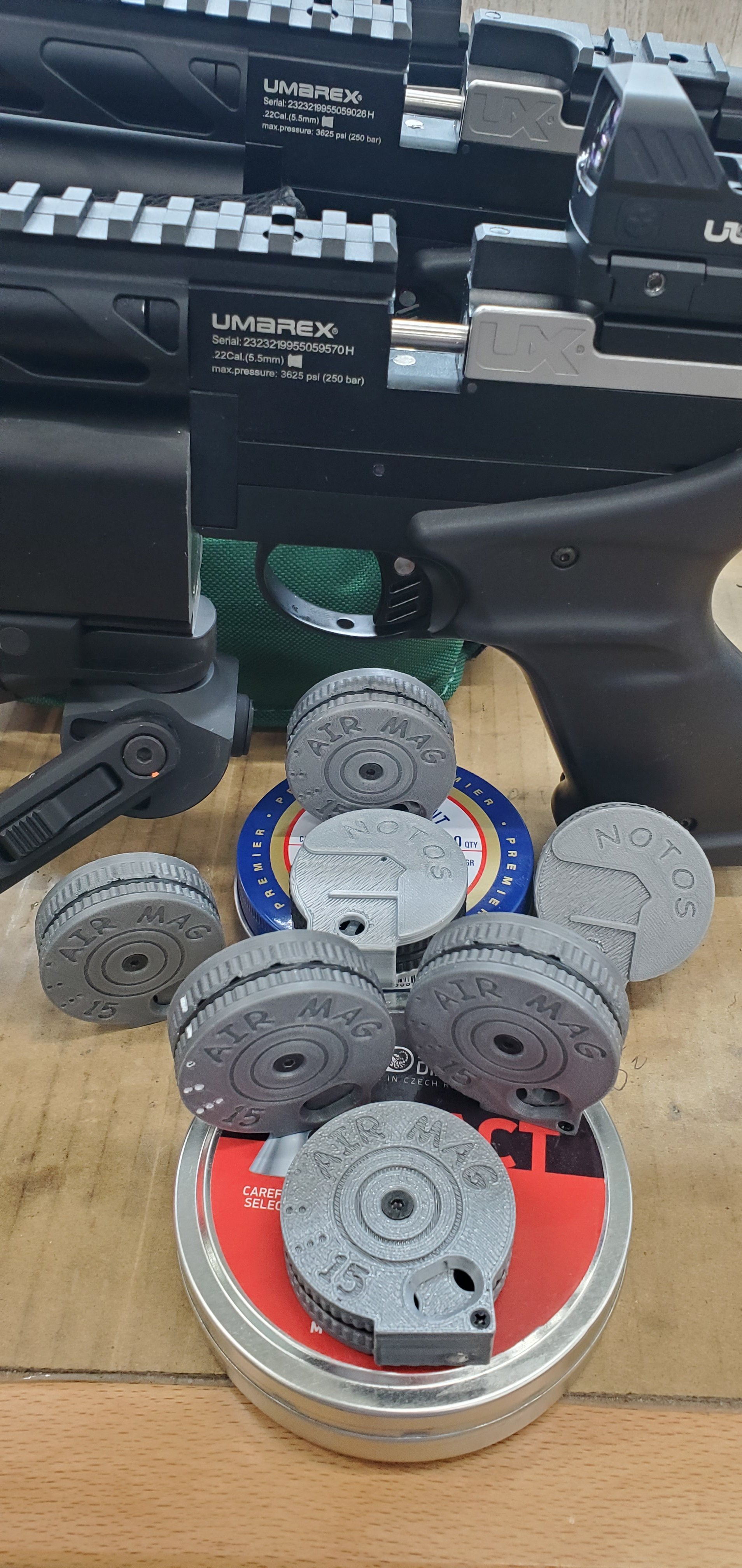

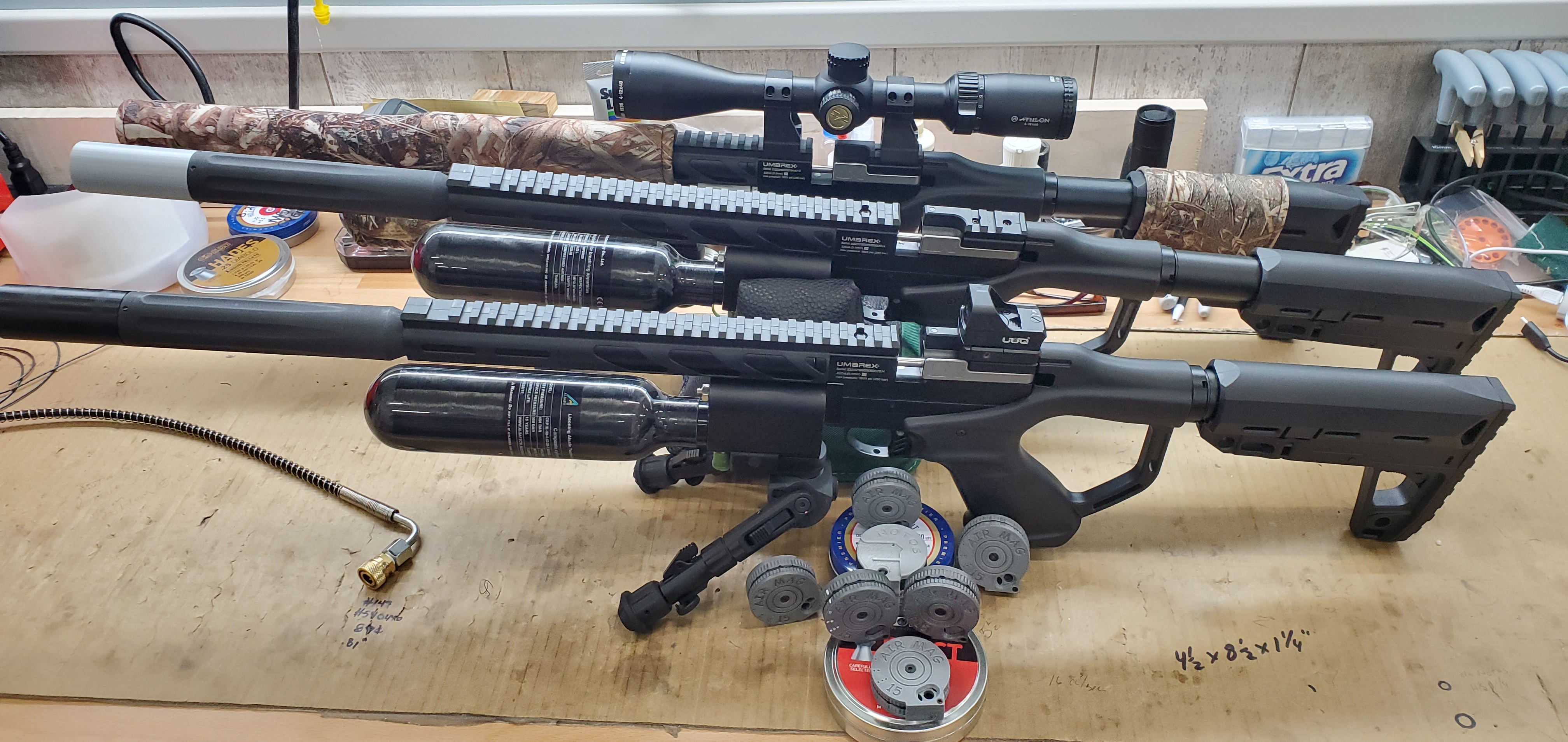

I've been a busy elf. I modified a couple more Notos's for Xmas gifts. Turned our great. Again used the Huben Z-blocks and 220cc bottles. I gave both a bit of tweaking too. Cocking lever smoothing, Breech and barrel polish, trigger job, power boost mod and I printed moderator inserts as well as several mags for each. I think my son and brother will be thrilled. Find out later today. I'll let them pick their own optics. Should be all set for a springtime Notos league!
Happy Holidays!
