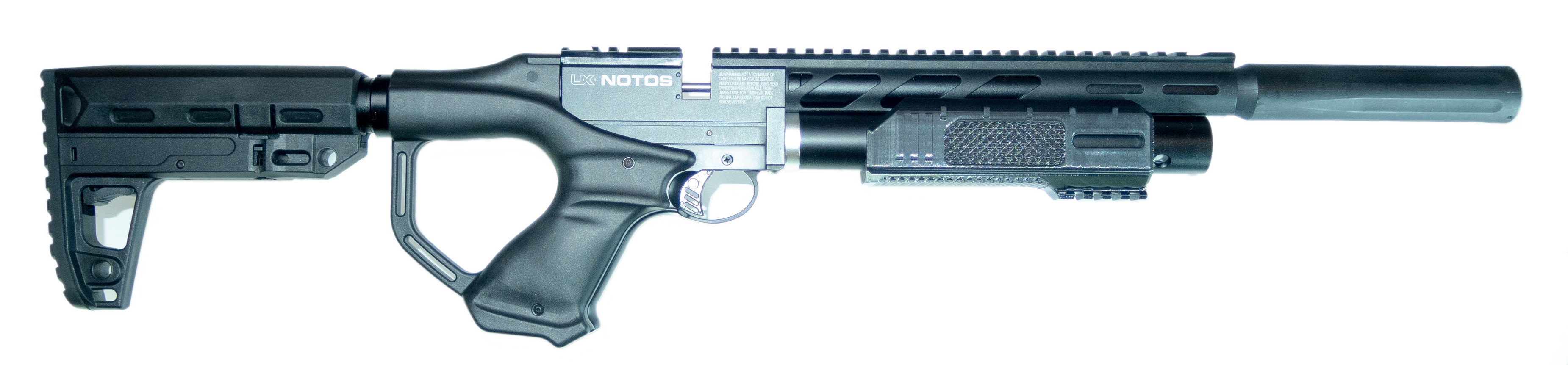

So far all I've done to mine was add the gauge block from Airgunarcheryfun. As soon as squirrel/rabbit season ends I'm going to open the transfer and barrel ports.

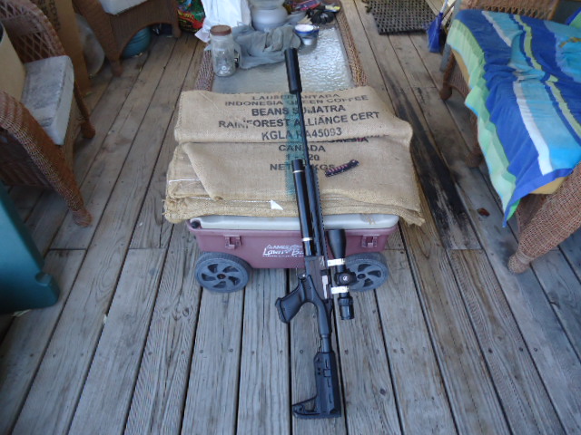

I couldn't resist. Bought a used Notos here off AGN and one thing led to another. Just finished up a bottle mod today with a Huben Cricket regulated pic railed drop block and 220cc bottle. Also added some camo bling. Shooting pretty good. Thanks all for the inspiration and direction for customizing this awesome platform.

i also like the stock slim feel but at the end of it all, i just want more shots between fills. opening the ports is well worth it for the amount of power gained. i can’t remember the exact diameter i expanded mine to but my notos is shooting 26.39 fpe with 18.1 pellets. 24shots with the stock tube tank.

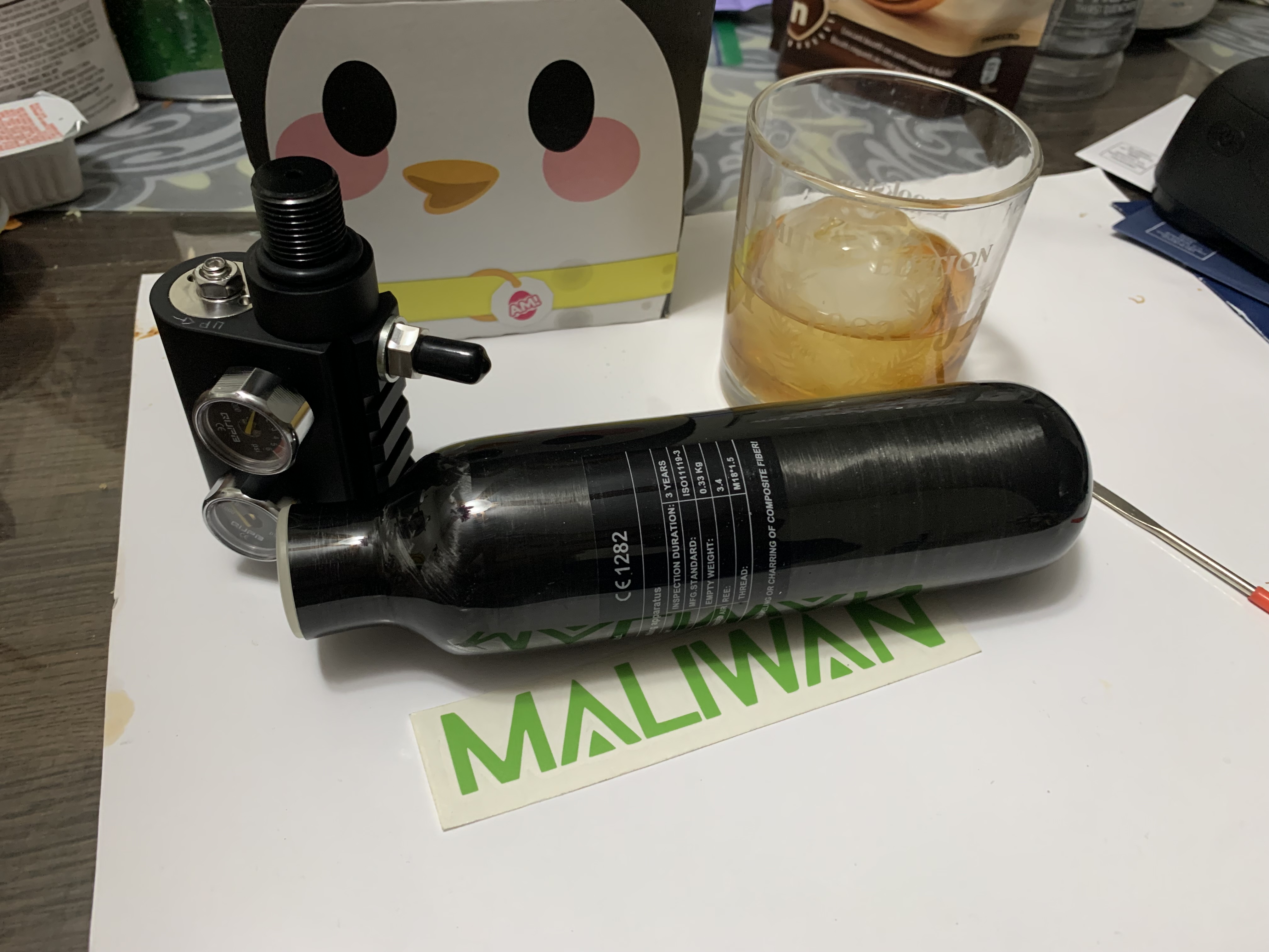

Hi NB1,
Barrel needs to come off first. Unfortunately I don't have a pic of the Notos receiver block with original tube removed, but yes, there is a M16 threaded male nipple fitting on the receiver that the drop block threads onto. The picture in an above post shows the silver face on dropblock that mates to the receiver. This had been painted but to get the dropblock to rotate and align properly to the receiver block, I had to remove a couple mils from the drop block face. I did that on a flat block with 220g then 400g psa sandpaper. I had such a small amount to remove, it wasn't worth chucking it in the mill. It just depends how the fit is between the dropblock and receiver housing how much material needs to be removed from the dropblock. The Notos itself is not modified and you can revert back to the tube easily. I chose a 220cc 54mm diameter bottle, but the Huben dropblock would likely work fine with a larger capacity 62-64mm diameter bottle. 220cc at 300bar = ~100 19fpe shots. That was my goal.
