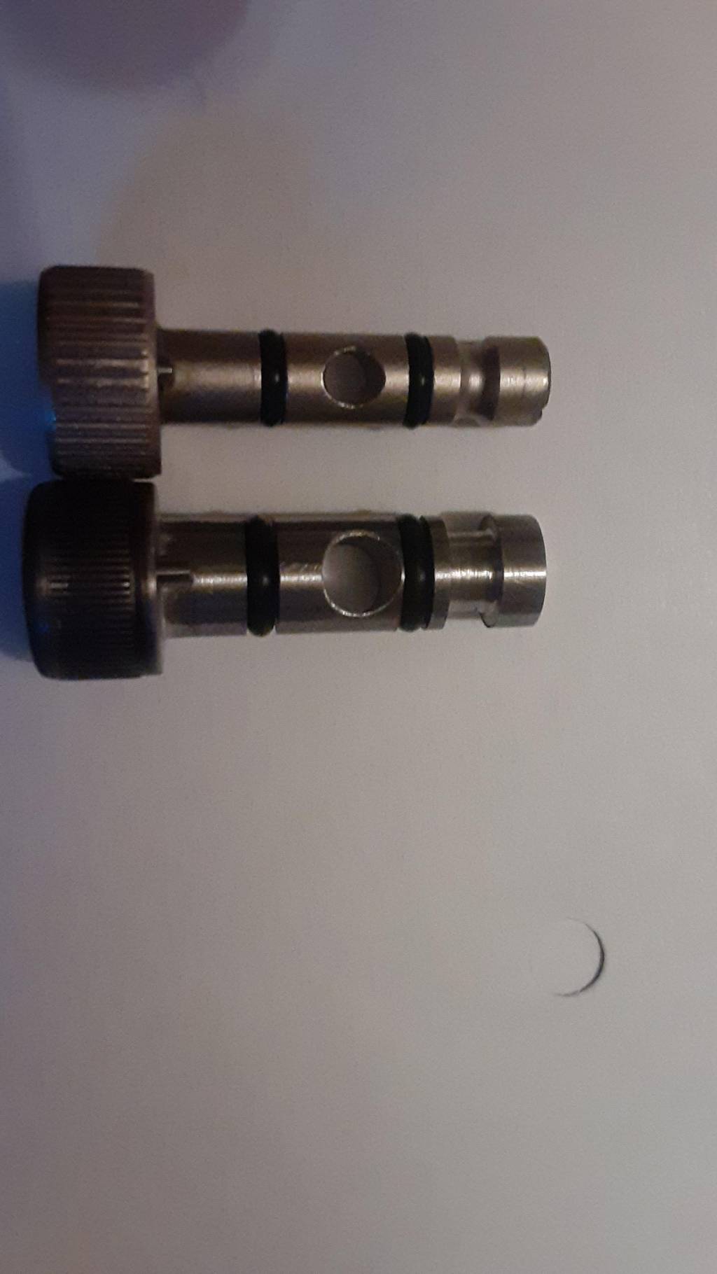

To remove permanently take it out. Drill and tap the hole 5/16"-18tpi and install a stainless cap screw 1" long apply loctite to the threads when installed and then drill the TP to size.
You can also Drill the hole to 5/16" and make a new larger adjuster from an 8mm bolt and then drill the transfer port.
That adjustable TP is 13/64" or 0.203" or 5.2mm depending on where you're from... lol That's as large as you can go without having to retap the barrel retaining screw larger.

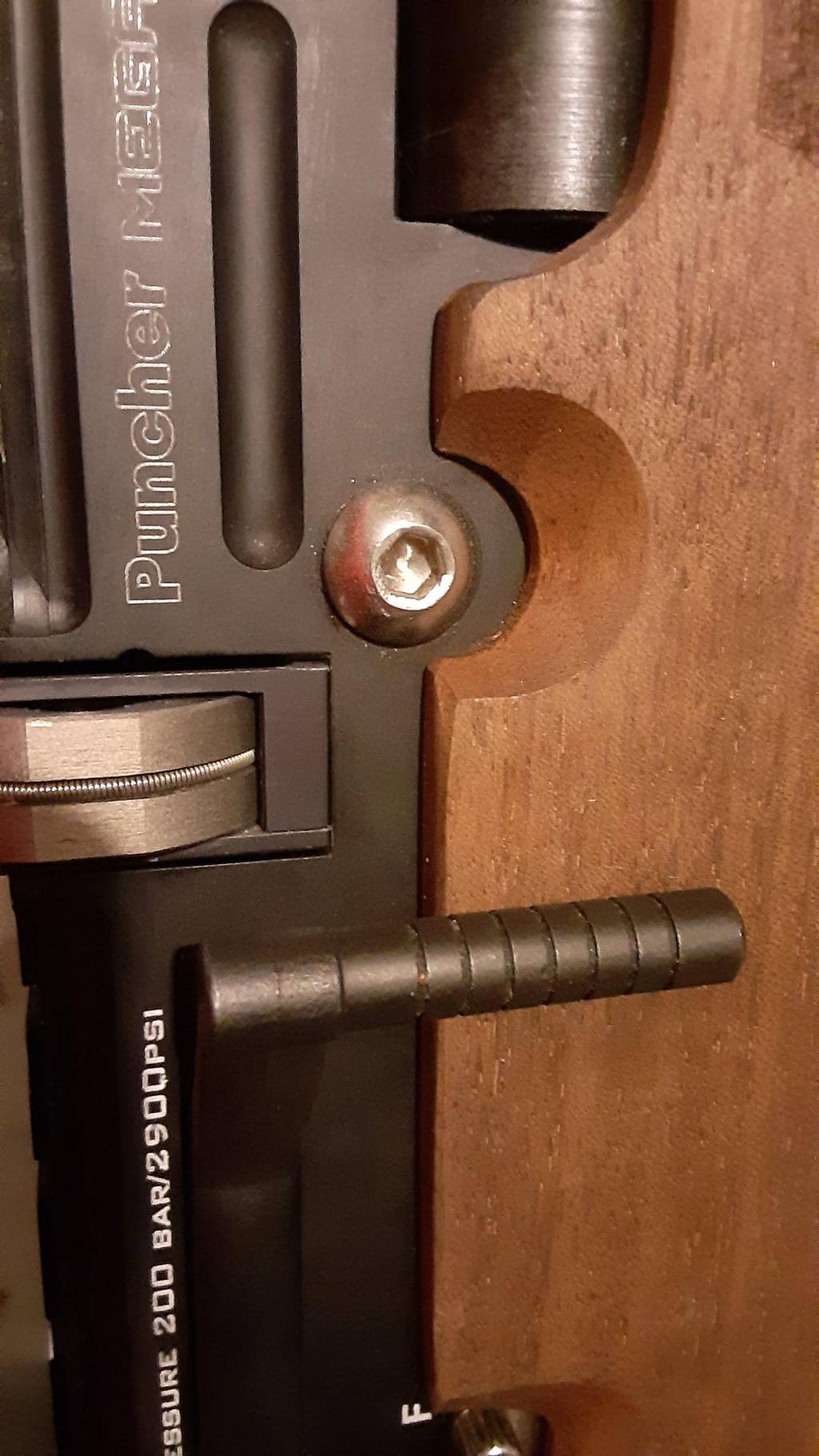

Hi I have a mega. Just got it.
It will not go over 170ms with 28gr hunter extreme.
I've checked adjuster is at max. I've checked its 3mm.
No noticeable air leaks.
Has euro hammer spring.
Any ideas buddy?
