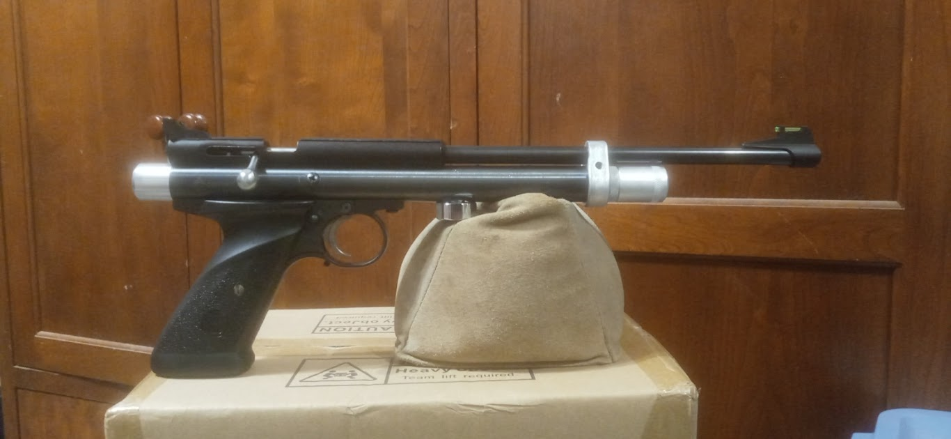

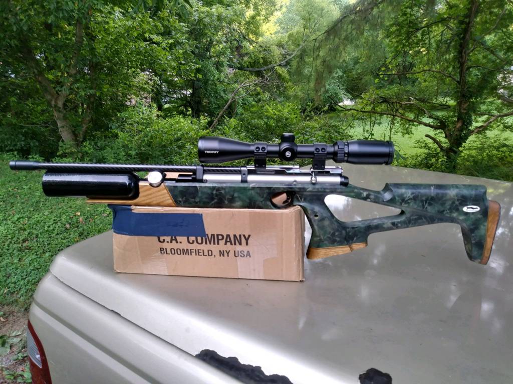

1556972376_9992190815ccd8358c9f2e7.05873606_2250 pcp conversion TEST MULE 004_zpspss6tzod.JPG

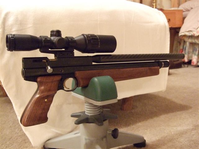

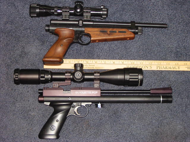

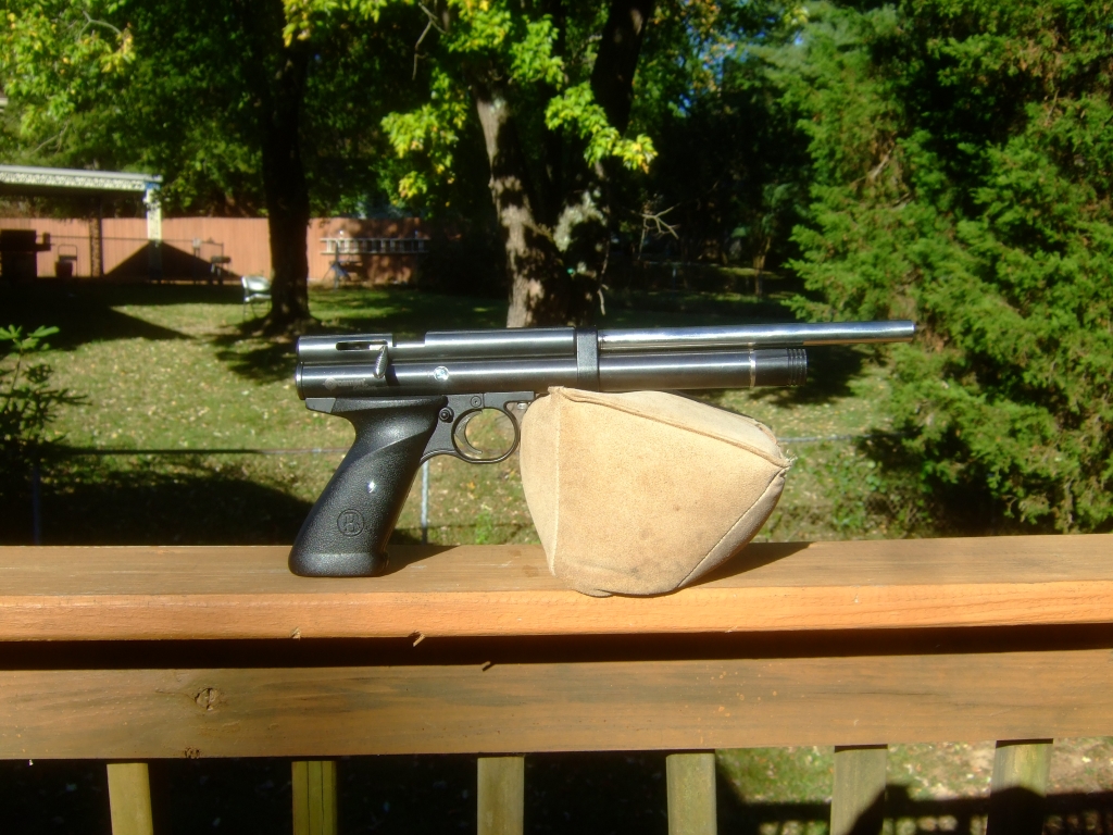

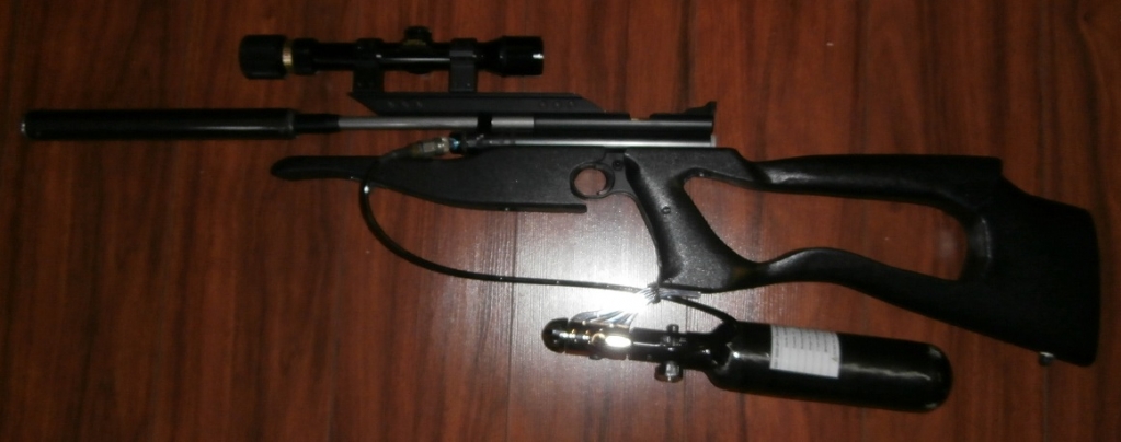

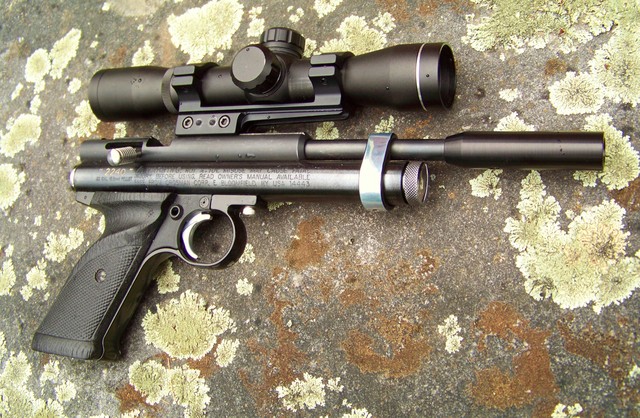

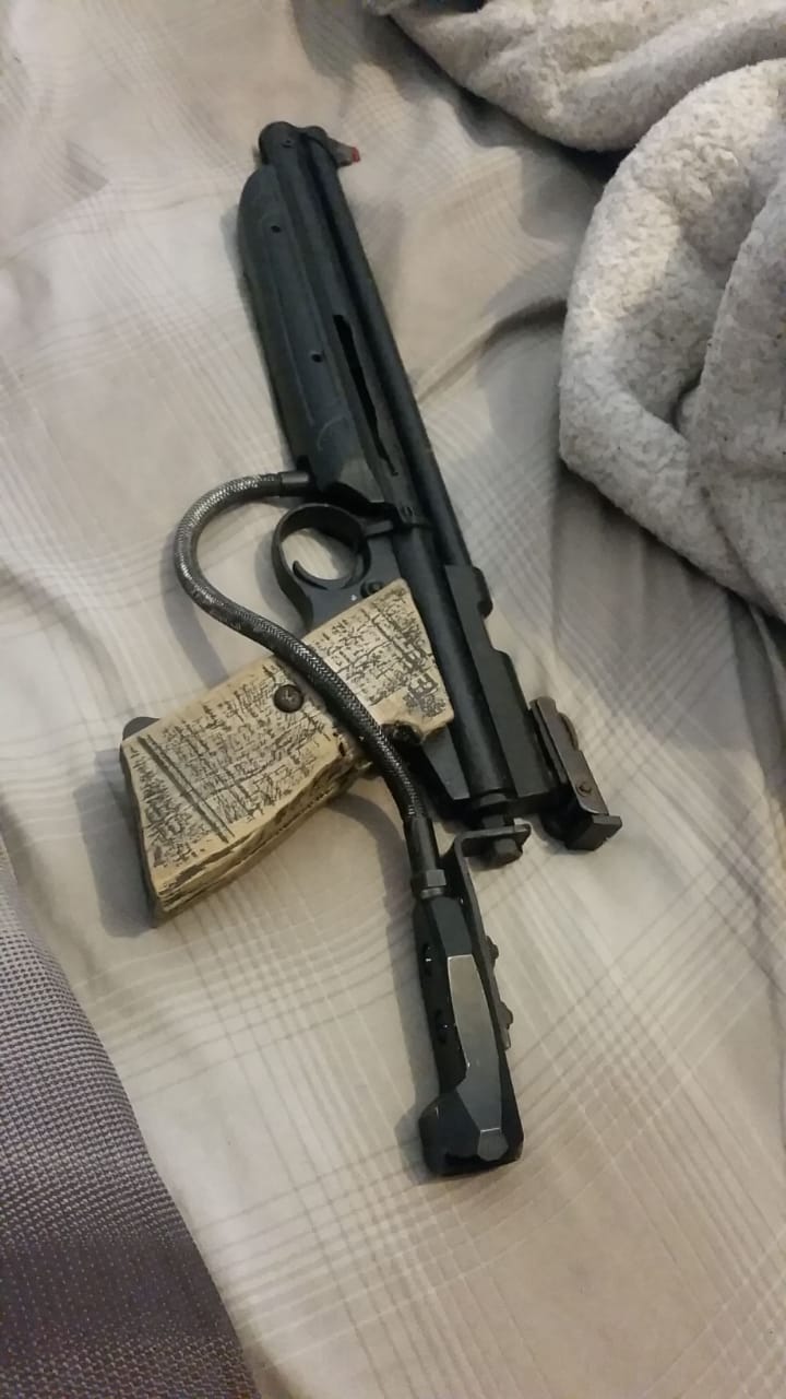

Cruising thru my photo gallery, and thought I'd post some build pics -

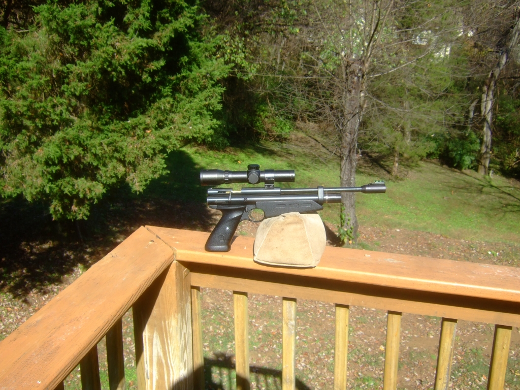

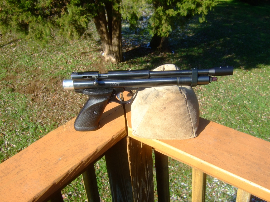

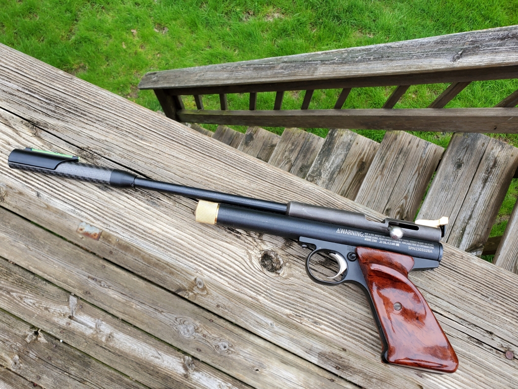

1556972080_3571934105ccd82307147f5.51611374_11-10-2015 State of Pistola 003_zpssspb0lnv.JPG

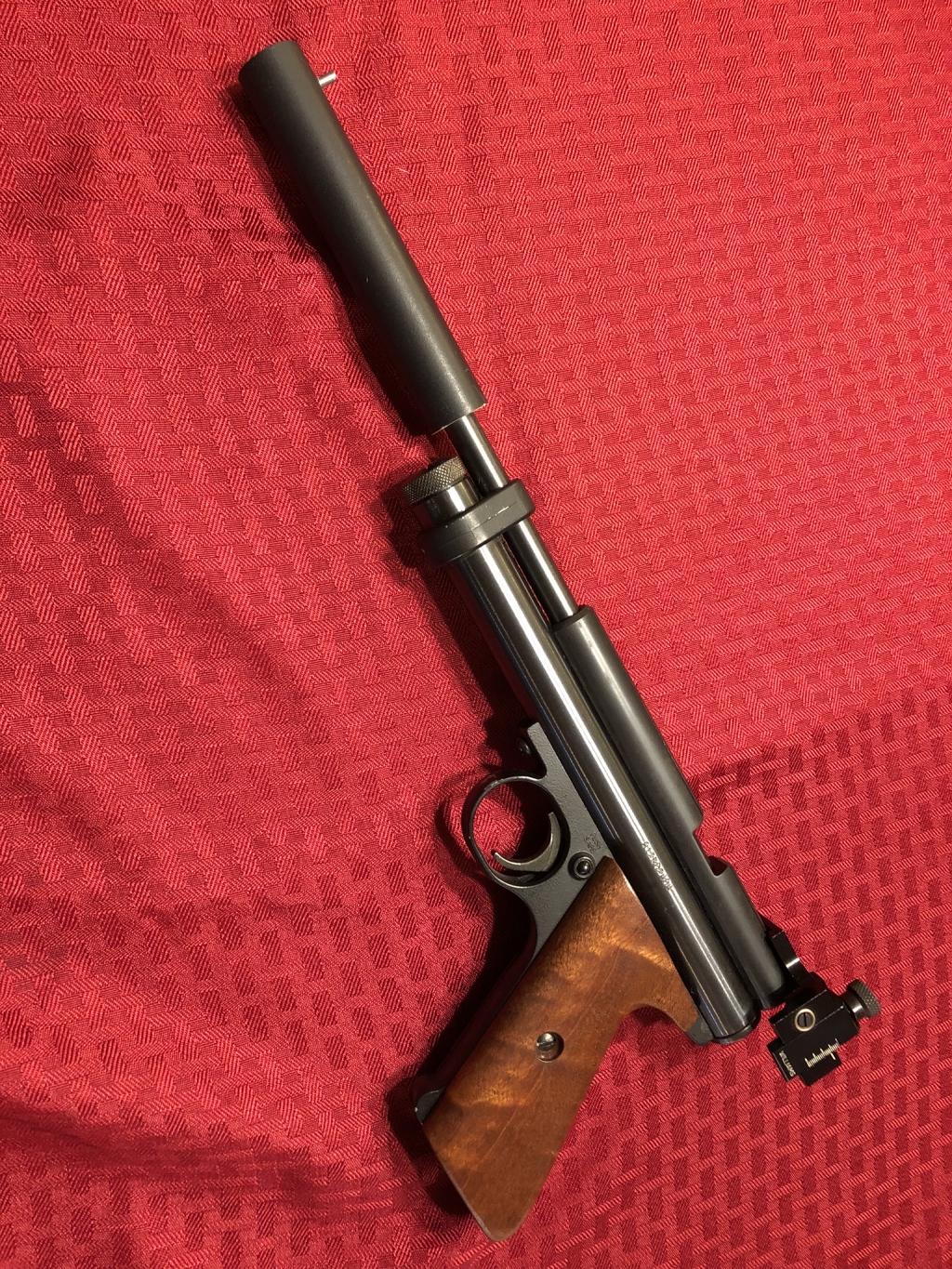

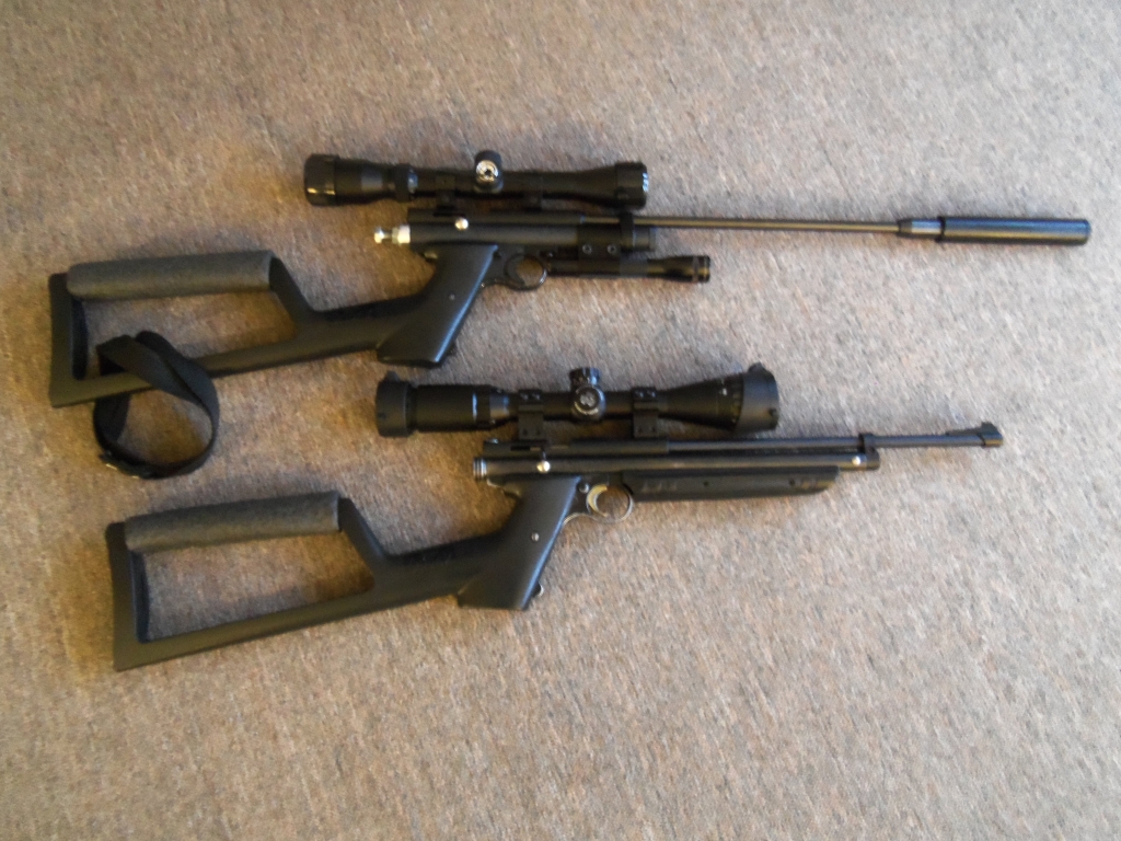

1556972096_14969301725ccd82404542f2.98421316_DonCothranPistolaadd12-23-2013001_zps7b83c8ac.JPG

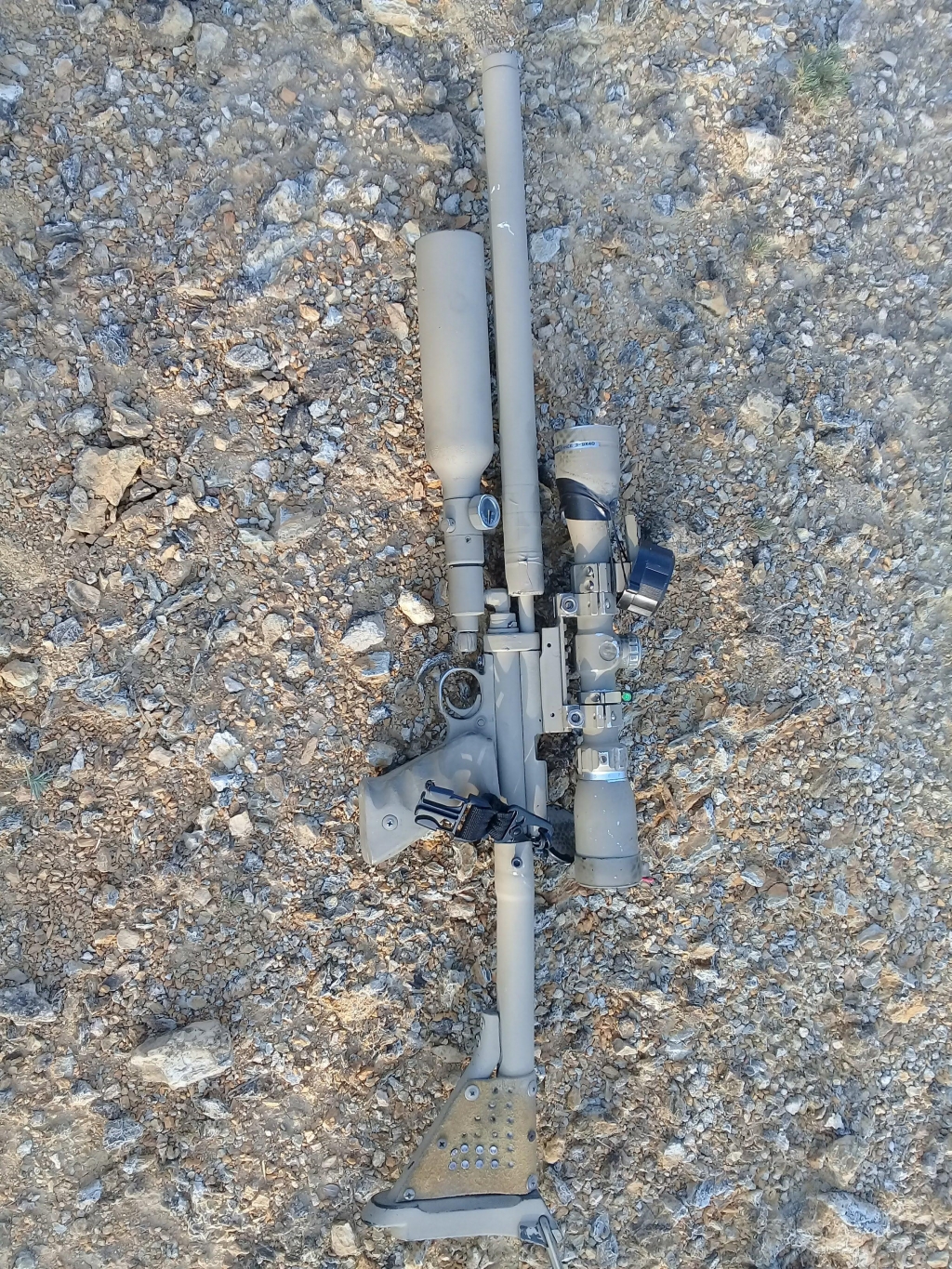

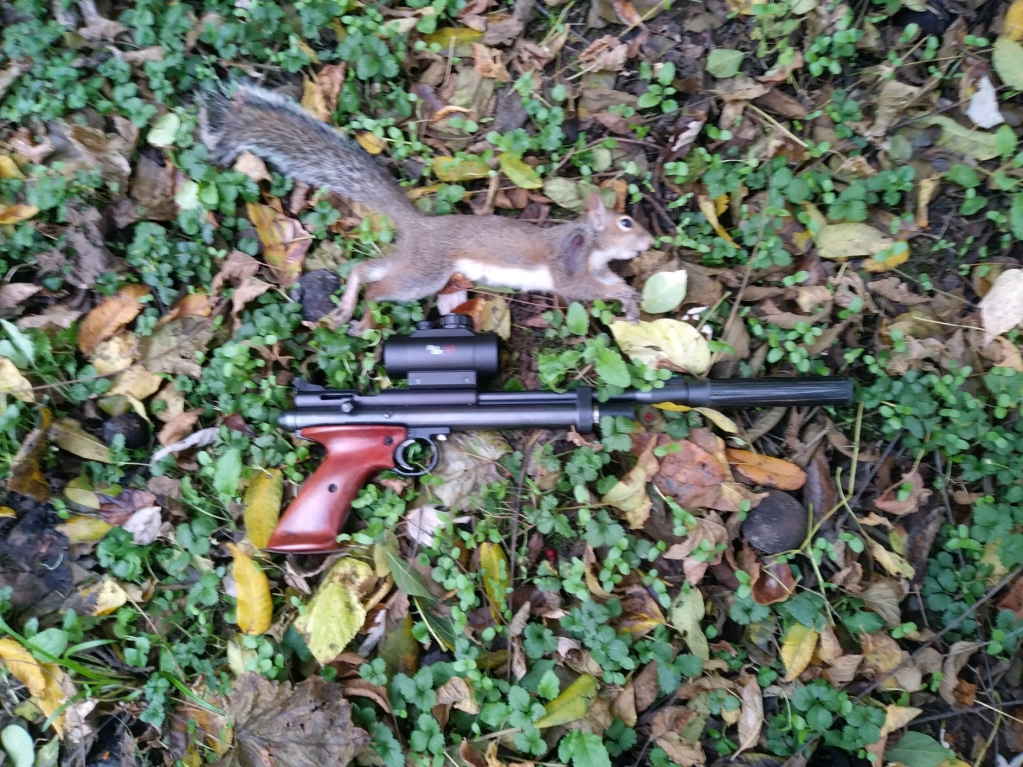

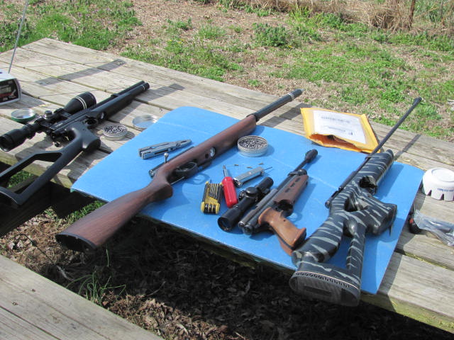

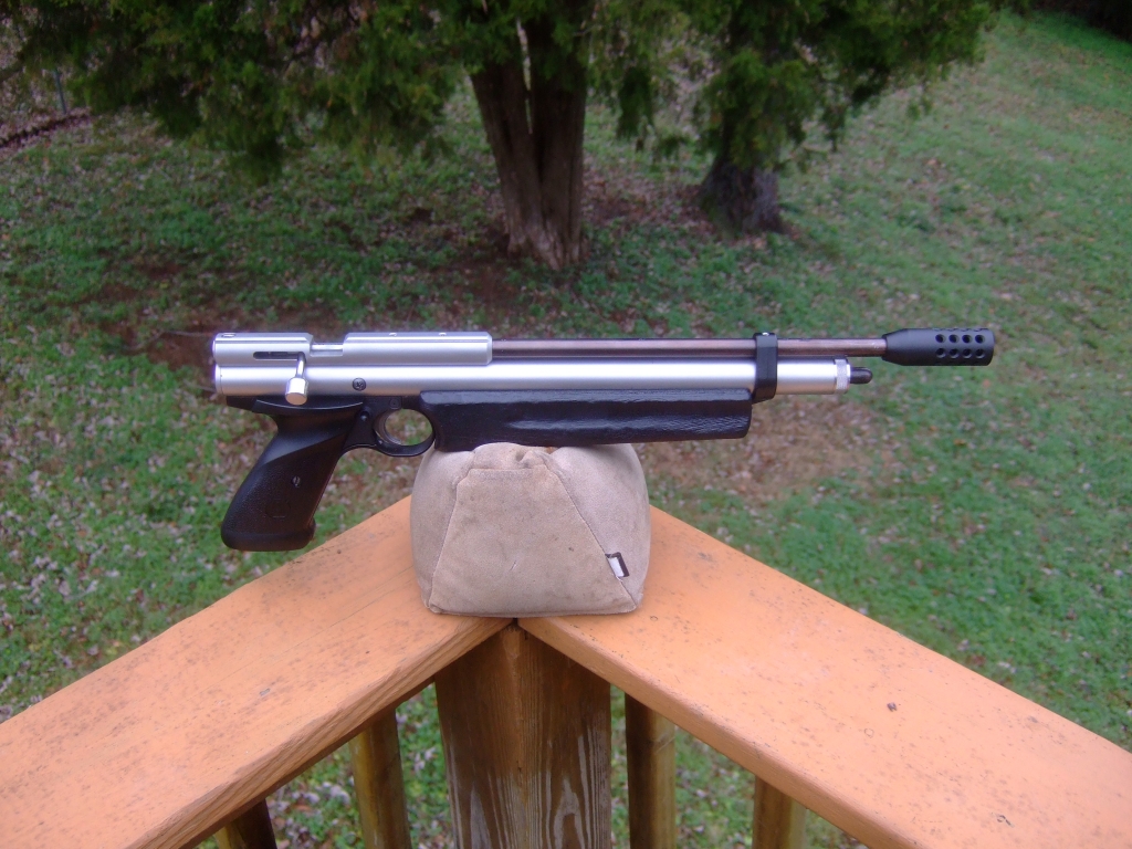

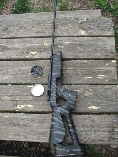

not a pistol, but wtf

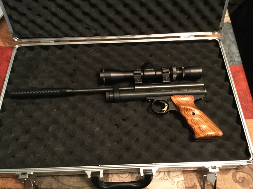

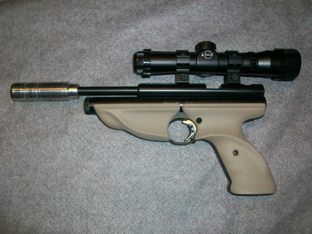

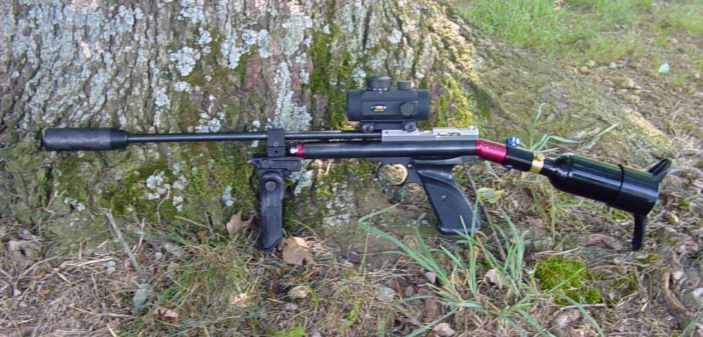

This was a 2240. Now a 2540 in a custom stock (purchased from a Forum member here although I do not remember who). It has a Baker Big Bore Breech and a 1/2" diameter 10" long .25 LW barrel left over from a shortening of an AirForce Condor Barrel blank.
It also sports an AirForce Rail, an OLD Bushnell Centurion Pistol Scope with a 2.5X power multiplier and a custom CF Silencer using AirForce Condor Baffles on a Best Fittings slide on silencer adapter with 1/2-20 UNF threads. Internally it has a Discovery spring and hammer. It has a custom Nylon Tail Cap that sets the spring preload. Ultimately I want to add a larger CO2 supply to it. 12 gram is only good for about 20 shots.
 07 Aug 2019 Final form. 4500 PSI CF Bottle, 1200 PSI Reg. Lots of shots. Bedliner stock finish. Stock now 2 piece. Baker Valve and Bulk Adapter.
All great! All fun fun airguns and likely shoot well above average, but that's just another angle of fun with modding & tinkering.

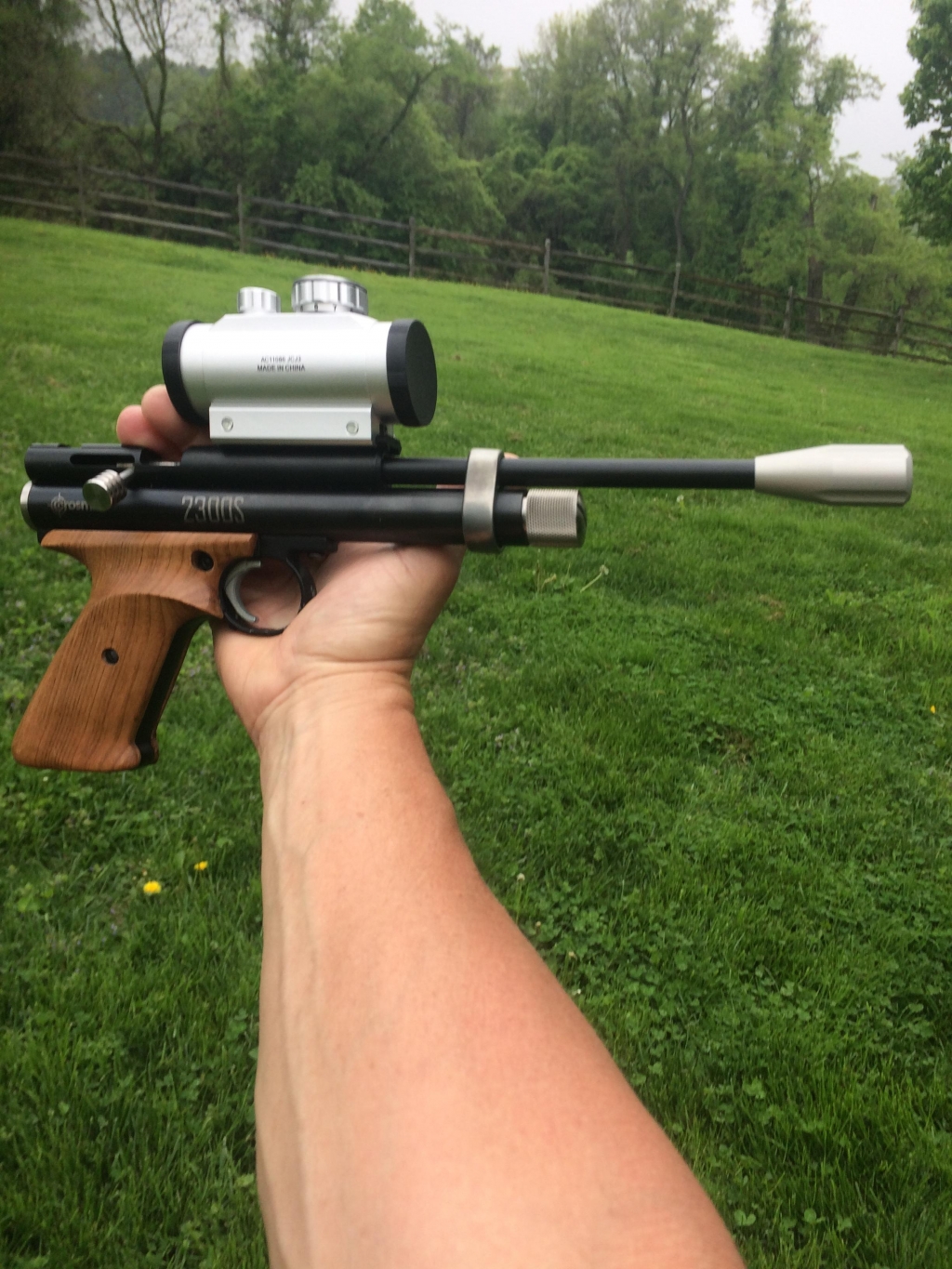

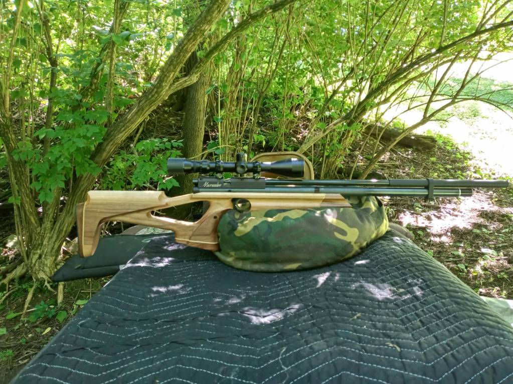

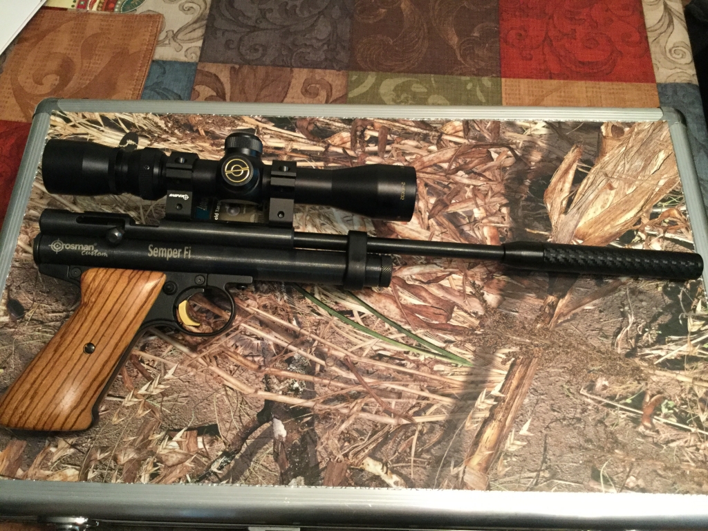

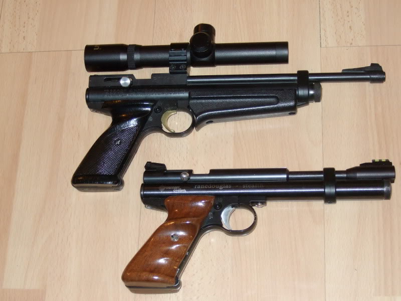

Tammy's old custom 22xx
An SSP Roz Sumpter made me a deal I couldn't refuse on. Part of that deal was "just keep it in the family" so after we had a nice time with it it went to live at Steve's house.
TC didn't like the swing gate so Steve swap some stainless steel bolt breech on it for Her, don't have a pic in that configuration. Thinking the only reason it left was the 1701p and no temp changes?

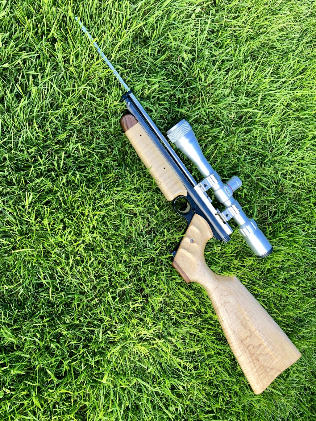

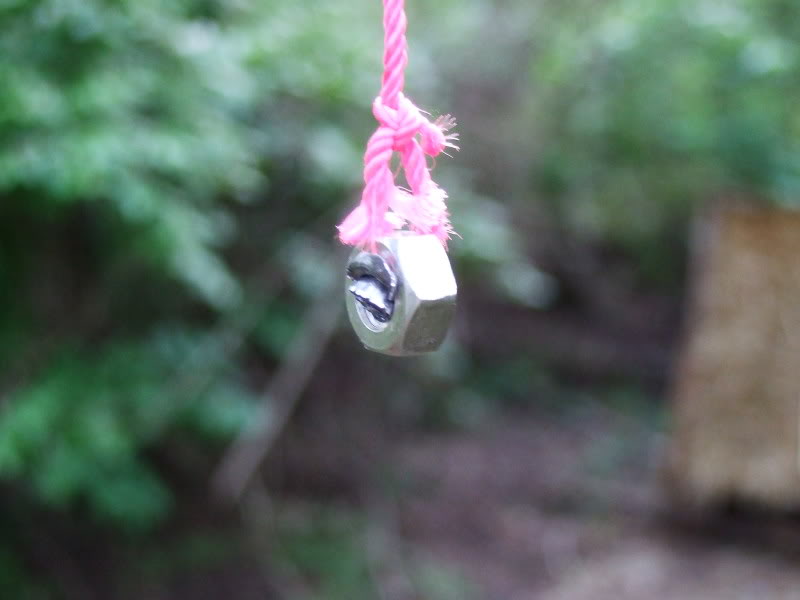

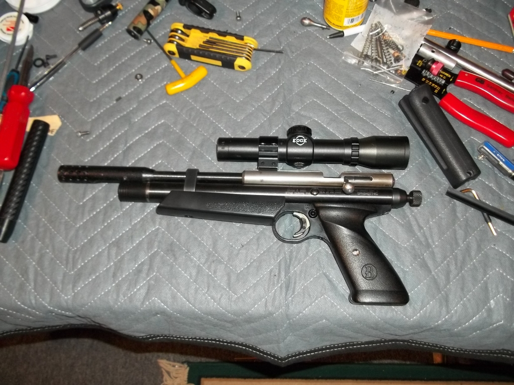

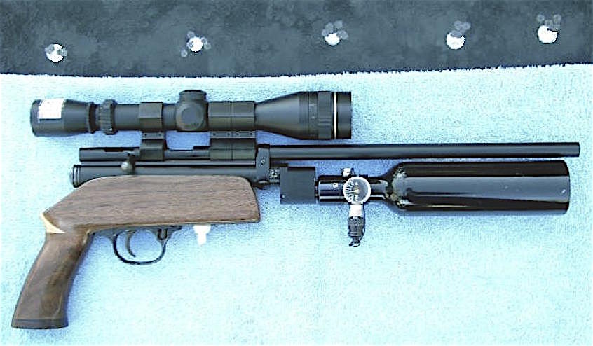

I converted a 1960s-vintage Crosman 187 Co2 rifle into a very successful regulated HPA-bottle field-target pistol that averages .67" five-shot groups at 50 yards with 8.4 grain JSB's at 780 FPS. After installing a lighter trigger spring, the factory multi-adjustable trigger breaks like glass at 6-7 ounces. Those white aiming spots are about 1/2" diameter, and the tightest group measured .34" c-t-c.
Couple more.

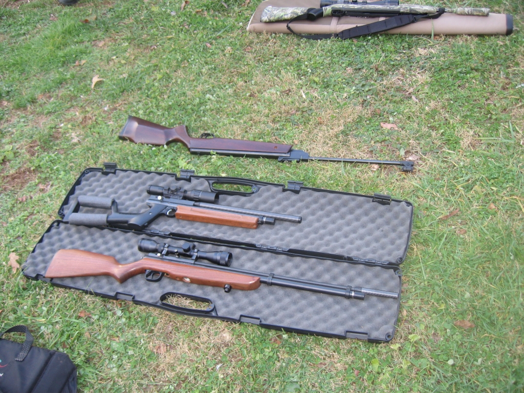

A visiting pistol up top and my then legal PFT kit

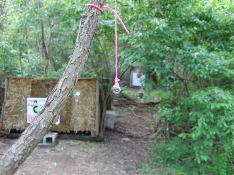

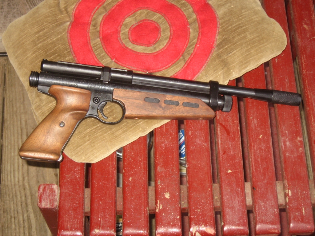

This one may be a stretch for some but a fellow shooter built it from scratch in his shop and the ONLY factory part was a Crosman 101 (the venerable put a squirrel on the table for supper)1940's crosman pumper ) would ring a 3/4" bell at 50 and naturally the owner made even better us of it's potential.
Good time!

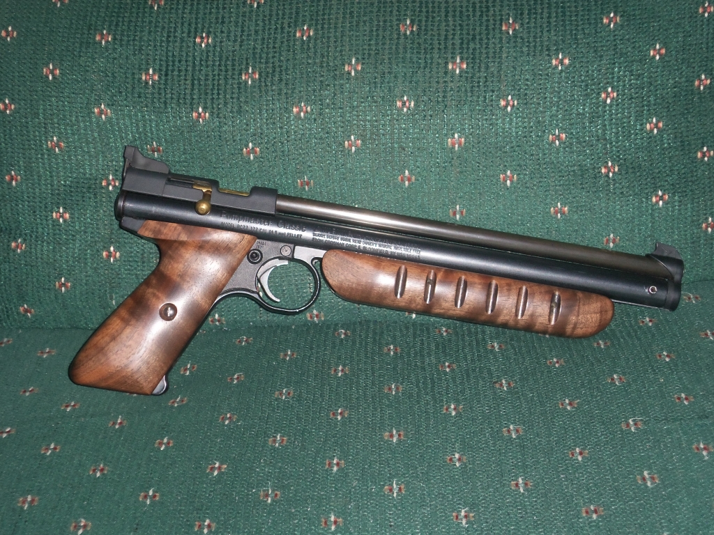

Thanks G. With over three decades of (amateur) airgun modifying, I consider 'Ole Homegrown' my greatest airgunsmithing success. And though very purpose-specific (field target), she's VERY GOOD at her specific purpose (and bench-rest shooting).
The 187 donor rifle had quite a lot of 'patina', but shot as well as many 1940s to present-day Crosmans, and lost no accuracy after chopping and re-crowning the barrel. Having some (limited) woodworking 'skills' from traditional bow-building, but lacking stock-inletting capabilities, I cut the inletting out of the white-wood rifle stock and built a walnut pistol stock around the white-wood (inletting) block. After that went well, I refinished the heavily-patinaed metalwork with Duracoat spray finish. That was eight years ago; and despite several bumps I thought would surely damage the Duracoat finish, it's still perfect. That stuff is tough, tough, TOUGH!
