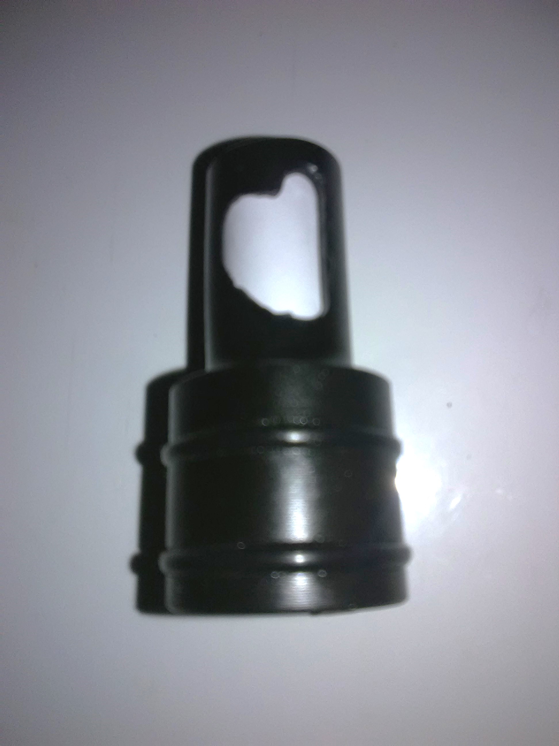

I don't know if the V3 comes with a depinger now but I 3d printed one for mine.
Reactions: jdanvers

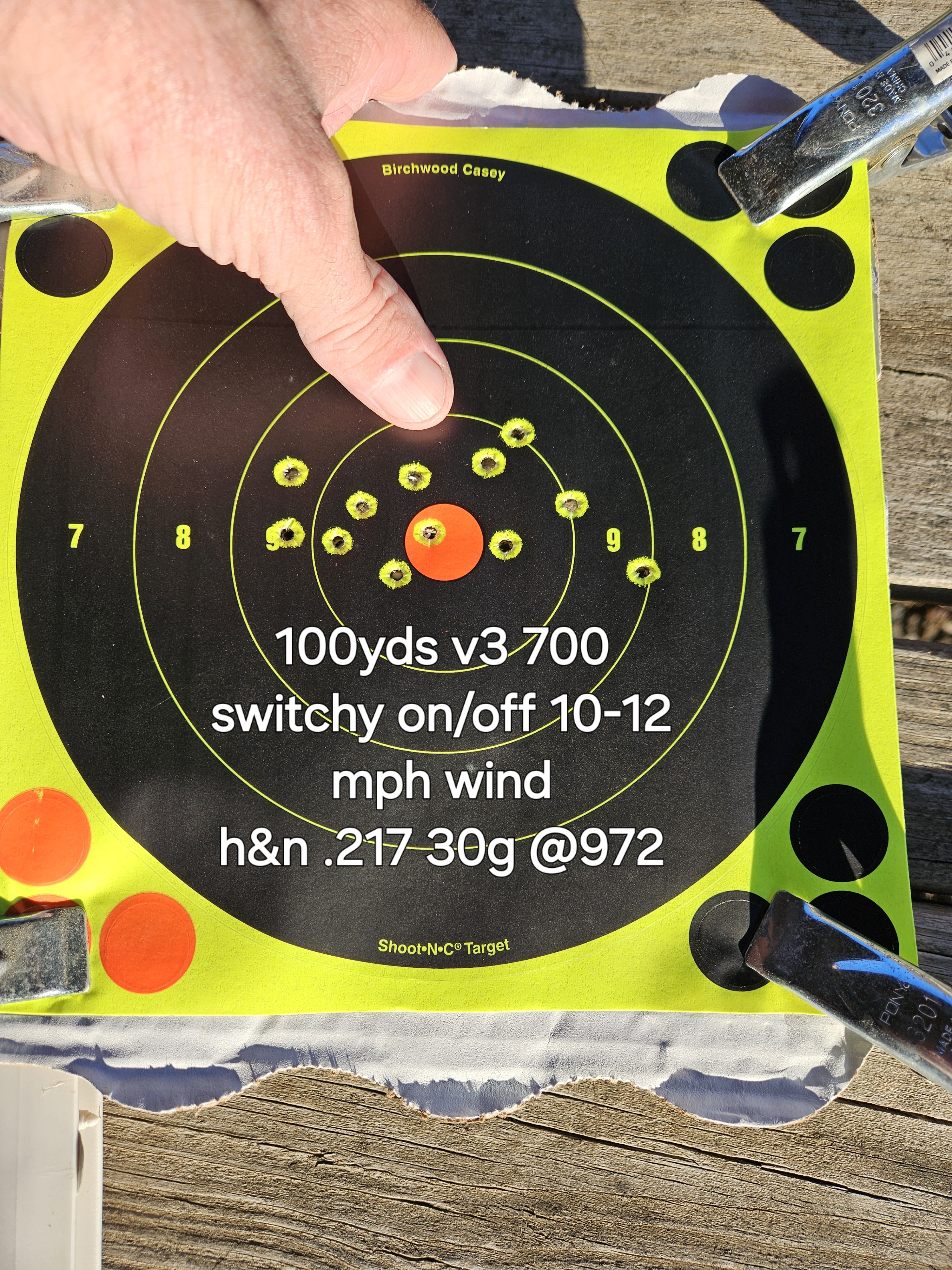

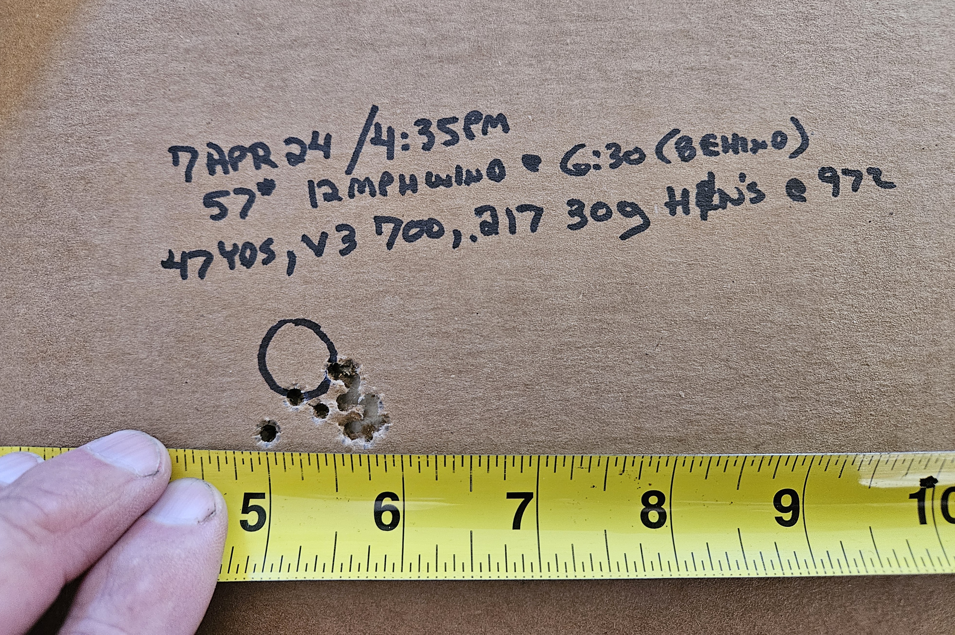

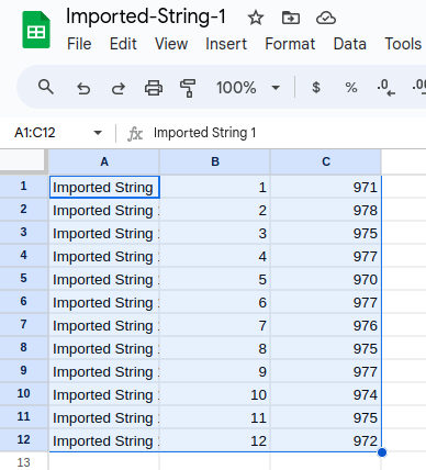

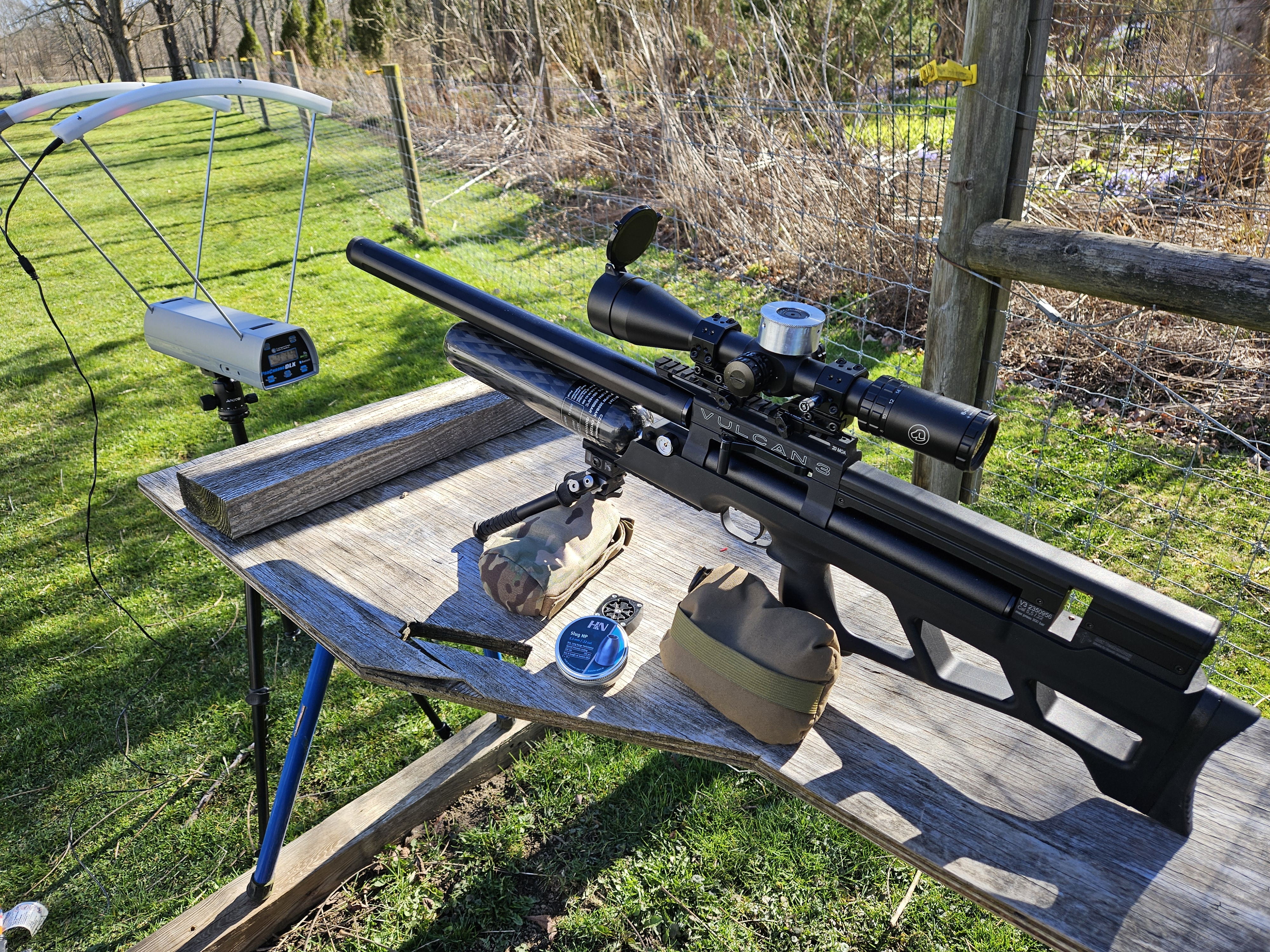

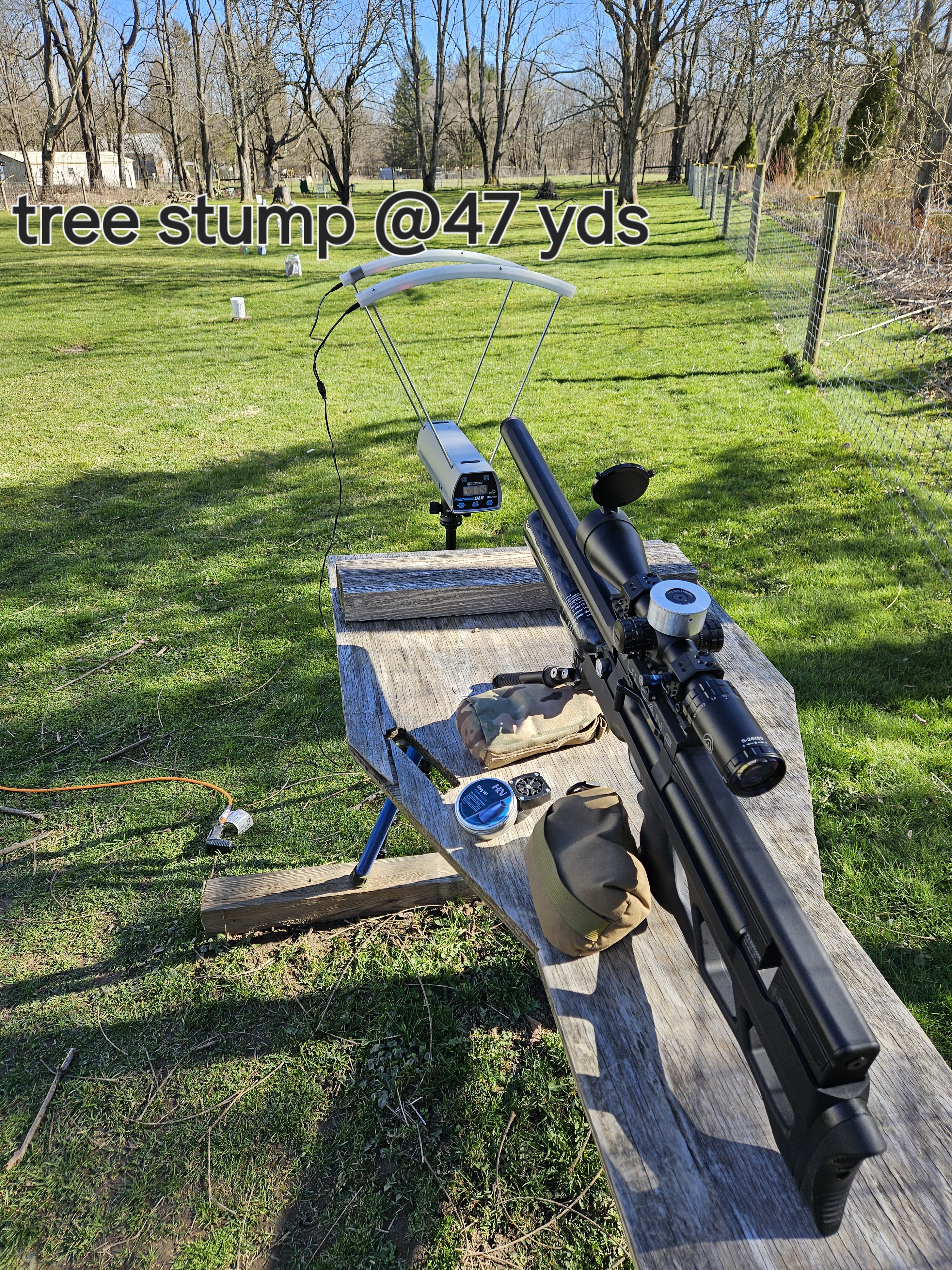

So . . . I did a little further rifling around in my 'box 'o various ammo's' to see if I had any other slugs I could try. I wanted to see if I had a .217 / .218 combo so I could get a feel for what the barrel prefers. ( I'm thinking it prefers .217's ) I found said combo with a couple of tins of H&N 27g slugs - one tin of .217's and one of .218's. This thing (the V3) EASILY dialed up to over 1000 fps with these and long story short - the .217's at 1015 average over a full 12 shot mag held a little less than an inch at 47yds in my back yard. ( a dead tree / tree stump out there ) 12-15mph wind coming from behind me at about 6:30-7:00. That was mid-afternoon'ish. I went inside, got something to eat, watched the boob tube and after a while got bored with that and noticed that the neighbors flag across the road didn't appear to be getting blown around quite a hard as it had been earlier in the day. check the weather on my phone - yeah - wind has eased up a ~little~ - but still going pretty good. Whatever - I'm going to try out those 30g slugs again. I make no changes to the gun - leaving it / the reg / hammer spring tension as it was from earlier in the day slinging those 27's at 1010-1020. I put up another target out on the tree stump and dial up 5 clicks figuring that for sure these, being a little heavier and likely going slower are going to drop some. Pew! "Whoa . . . . " It's good l-r but about a mil HIGH. 'High?" OK - whatever - I dial it down 10 and "blammo!". NICE . . . I unload that mag and real happy with the results -- I gotta go get my chrono and find out how fast these are going. Yeah - as expected a little slower - 972'ish avg as it turns out over the next 12 shots. But "oh my" - pretty nice for the very basic "tuning" I've done to this point and not in ideal conditions. (Windy - not doing this on a dead calm day)
Again - I'm pretty stoked about that 47yd'er . . . I look at Molly the dog and ask her if she wants to "go for a ride"? She knows what that means and was all excited and rearing to go! I grab a target from my garage, we jump in the car and off we go to the local range where I can take it out to 100. I quick "build" this gun in strelok guessing at some values, namely the scope height, and then key in the 100 yard distance, taking into account the still present wind - but now it's a l-r cross wind coming from 9:30-10:00'ish o'clock. It's getting later in the afternoon and it is letting up some but still 10'ish mph and now "switchy" - ie: on/off - sometimes 10, sometimes 15'ish, sometimes 3 or none (off). You can see in the attached pic - the vertical that strelok told me to dial up was damned near spot on, and you can also clearly see the horizontal where the wind was driving me batty.
I'm (basically) a happy camper with this thing so far - I don't really have a lot of rounds through it just yet - maybe a couple hundred - but - yeah. I'm almost inclined to just grab some more of these 30g H&N's but - more than one of you have recommended the ZAN's (30.5's) and the VK's are also reported to be very good as well. I may in fact pick up some of both and give them a test to see what's what before I decide to start marking up the turret tape.
