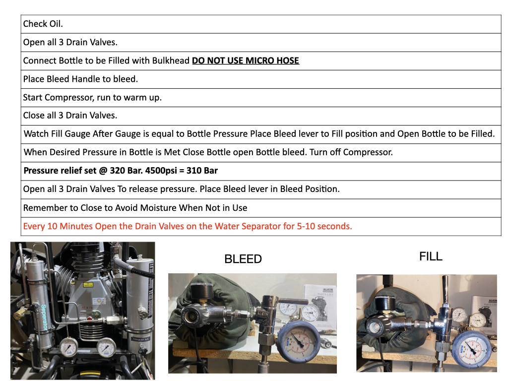

That’s a good question. Some people might. On a compressor with auto shut off it is probably safe because if the restricted flow rate of the microbore causes pressure to spike to your set pressure the compressor just shuts off. Then the pressure in the microbore will drop and compressor will restart (against some high pressure).
In the case with no auto shut off the pressure in the microbore will spike, and if you aren’t watching your fill whip pressure the over pressure valve “should” open and start hissing air. If you can hear it over the compressor noise.
There shouldn’t be any fear of blowing a microbore but just makes filling a pain.
And again, all of the above is valid only if the microbore is too restrictive compared to the compressors scfm.
Brancato’s tank valve is designed so that when filling your gun you want a slow flow rate. The valve just lets air flow through a restrictor. But when refilling the SCBA with the compressor the Brancato tank valve allows a much higher flow rate into the SCBA so as not to cause too much back pressure. Good thinking.
Also, some people, and mine does, will have a extended female quick connect Foster that has a restrictor for nice slow fills to the guns tank. Those Fosters restrict in both directions, so if a microbore has one of those on it, the restriction will slow things even more.
All you can do is try and see how it works.

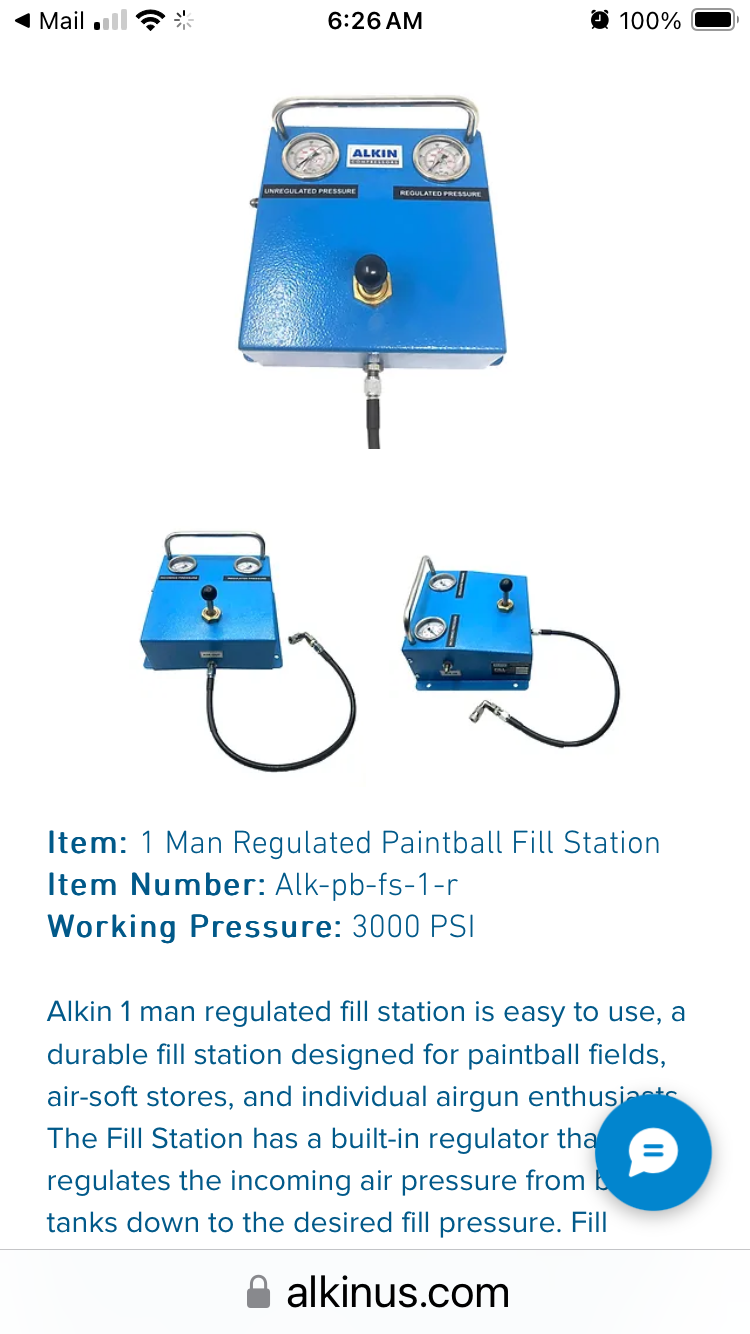

CA Varminter- can you explain in detail how your system works? I understand how it all works but my questions are what keeps air from flowing past the tank when doing a top off, and straight into that small box on the table? Lastly, when opening up the tanks valve to get air into that small box, what keeps the air from back flowing towards the compressor? Common sense tells me you have check valves in place but I don’t see them.
Maybe a close up pic of the connections up at the tank, and that small box, what is that, anyway? Do you have a link to that contraption so I can see how it works?
Hi Bigragu.
The setup is not mine... but a Commercial Paintball setup by Curly@Airetex
The Tank plumbing includes a check valve... So this will isolate the compressor .
So the Air will only flow in one direction, from the Compressor to the Tee fitting/tank/fill station.
So the small box [Paintball Fill Station] is a flow valve and pressure Gauge....
It also came with a Regulator. So it only would fill to a Set Pressure.....
Reactions: Ezana4CE
From Alkin New Jersey website.
Reactions: Ezana4CE
There were two issues I had when I first tried filling my tank. There was so mush restriction that the pressure relief would open on my compressor. When I used the micro hose. But connecting to the bottle directly I didnt have the back pressure issue. then I found there was a flow restrictor inside my female fitting that could be removed that I didnt know was there. Maybe I could use the micro hose with the restrictor removed but I have never tried. after removing the restrictor.
