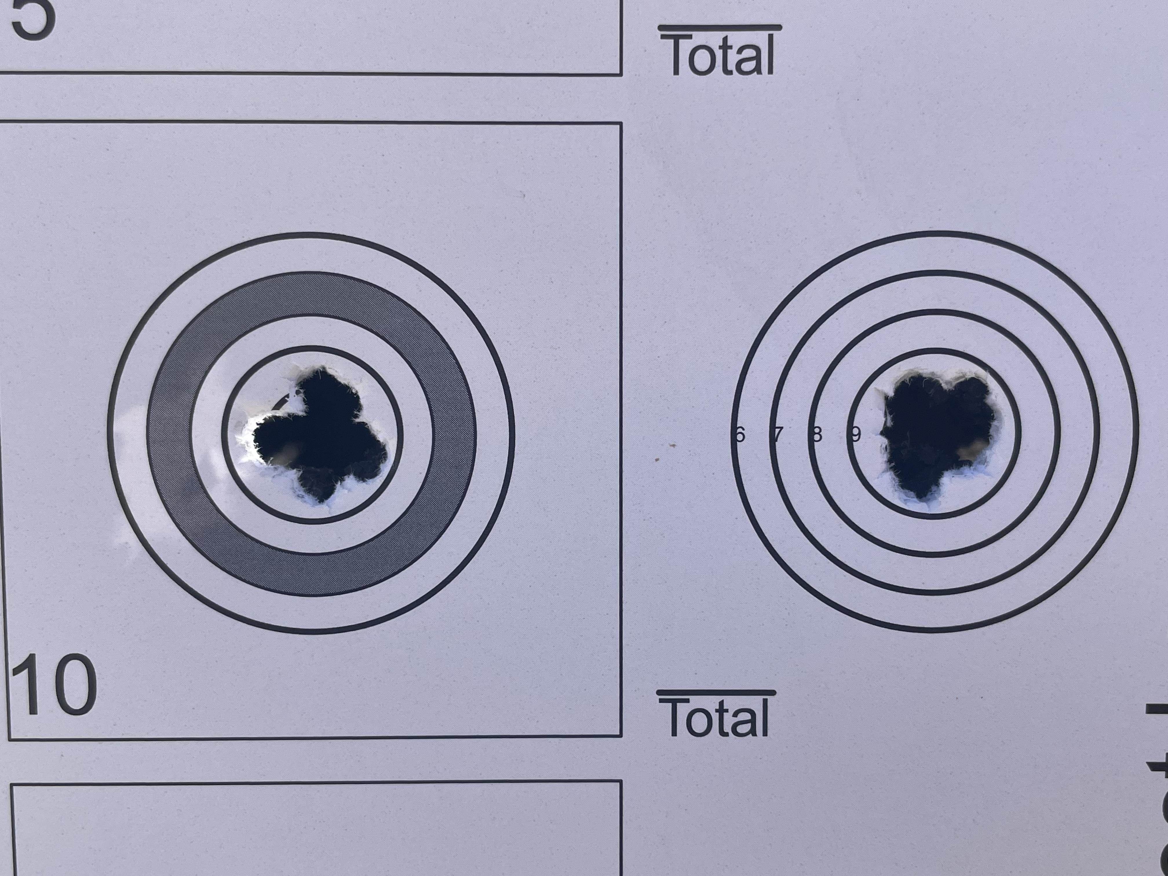

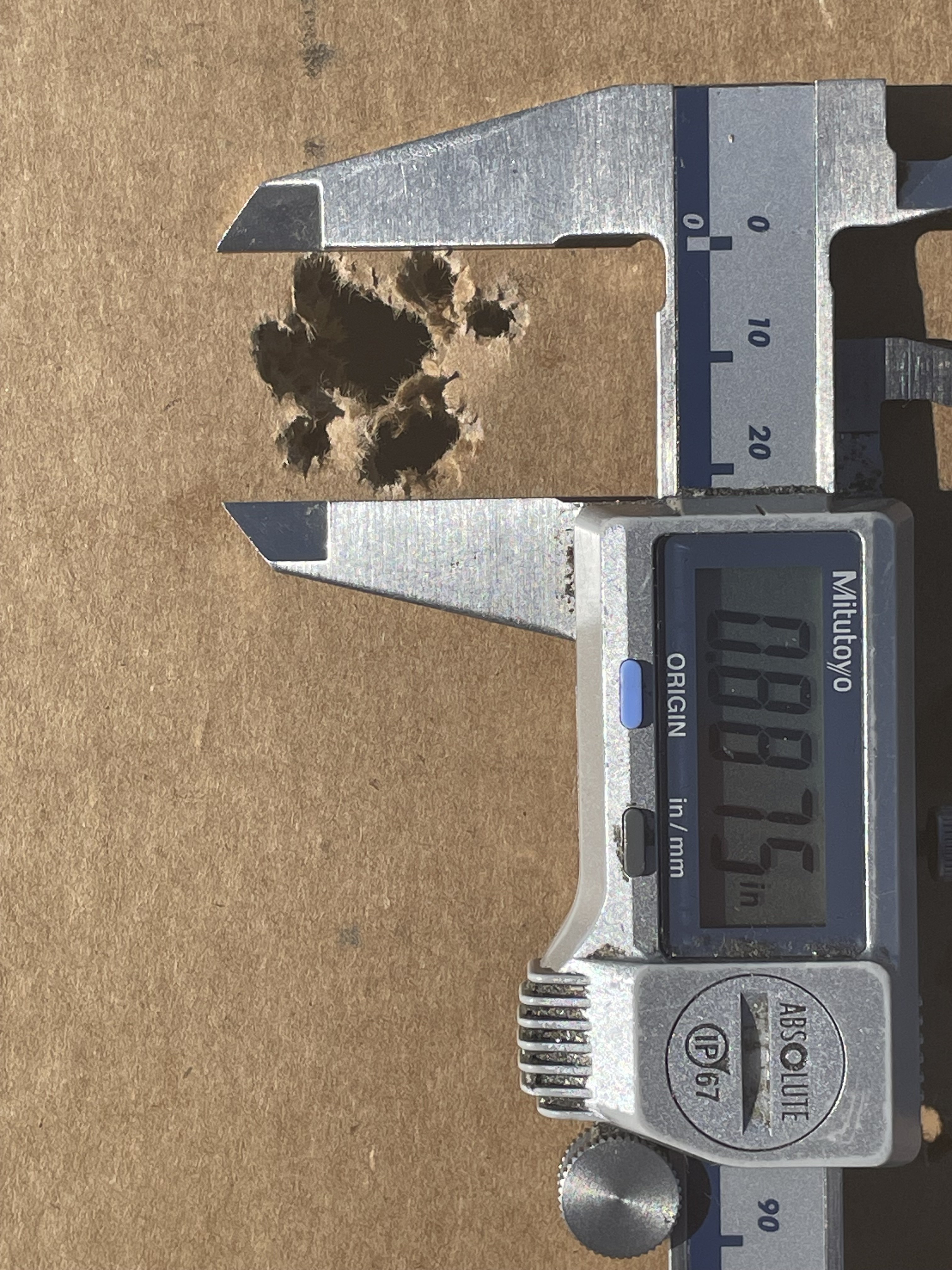

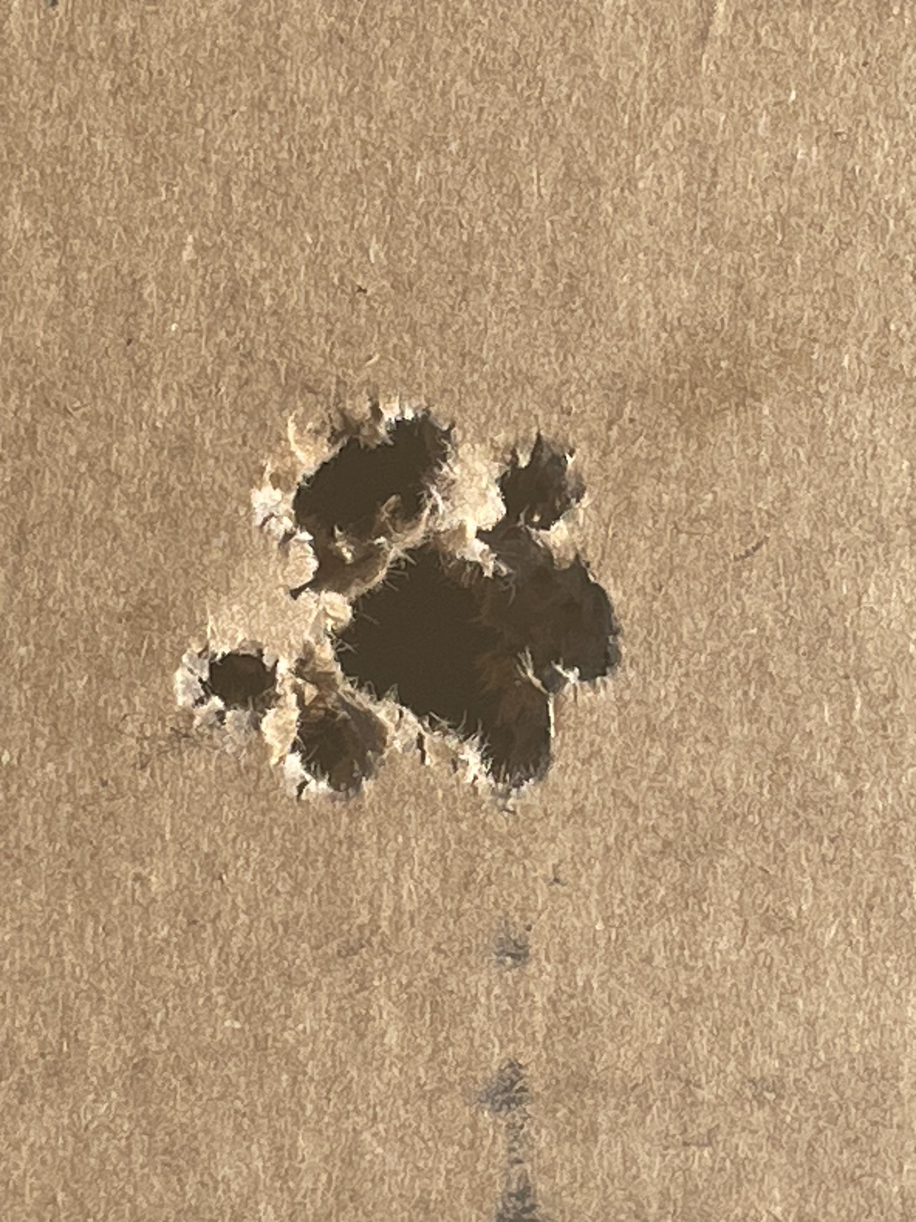

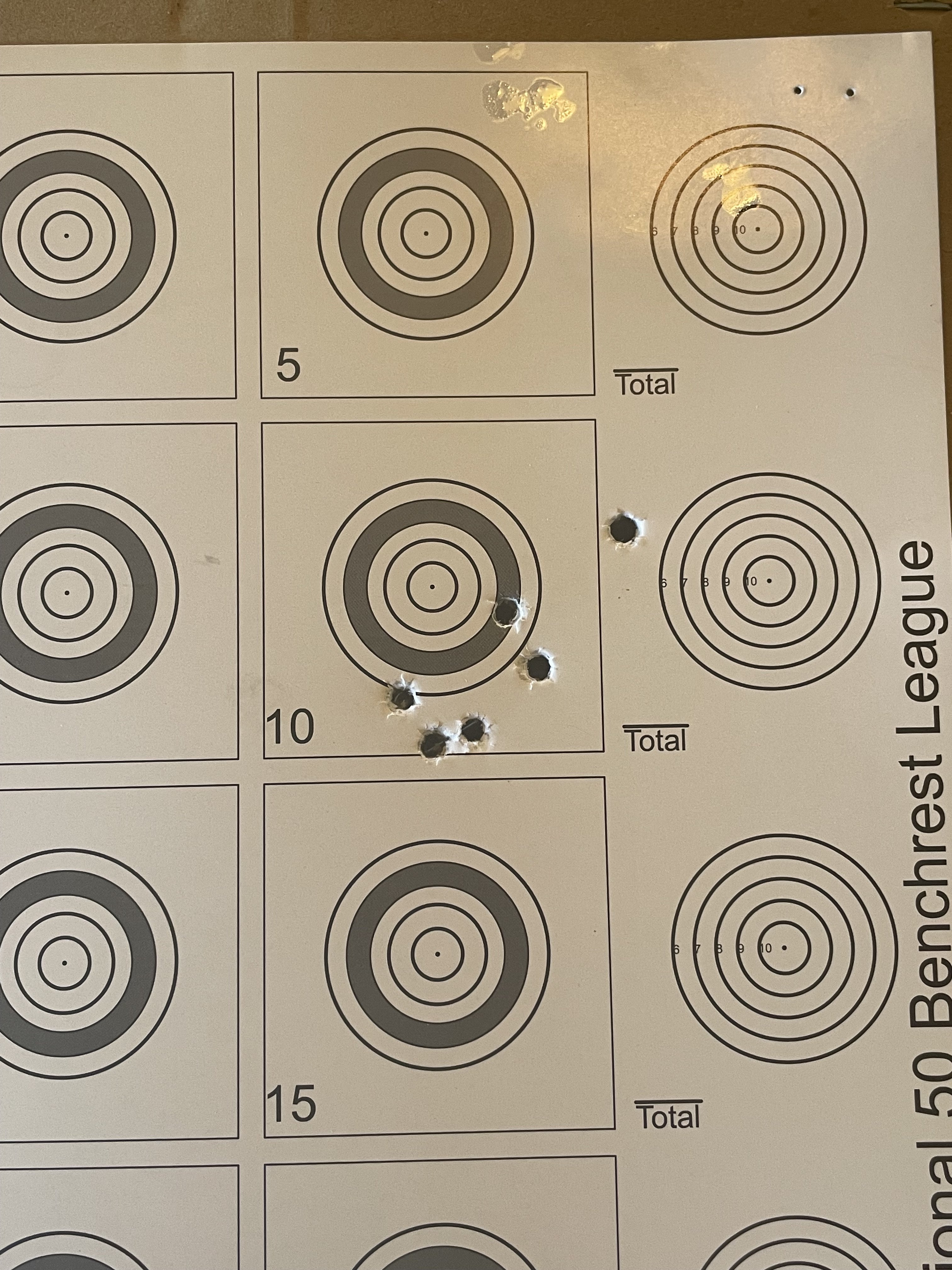

Shot this N50 card at 100 yesterday morning. Shot these other groups this morning. 25 shots at 100 and 6 shots at 200.
I couldn't even begin to see the holes at 200 through the mirage. I just aimed at bull 13 and shot. I wasn't even sure the first shot hit the paper. Without visual feedback there was no holding taking place. The scope clicks were made using Chairgun and a bc of .200. The mystery group landed one row high and to the right....so that at least semi confirms the calculated bc of .200 is within reason ...if not a little conservative.
I cannot for the life of me see what could be fun about shooting and not being able to see the holes made. 6 shots was enough for me...plus the 400y walk to see what happened.
The 200y group is about .8 Moa. The cluster of 5 in the 6 is about .400 moa.
The 25 shot group at 100 is about .65 MOA (said .80 at first...that was wrong).
The new slugs seem to work just fine at much longer distances than I will ever care about....and are holding a very strong .200 plus bc.
Mike

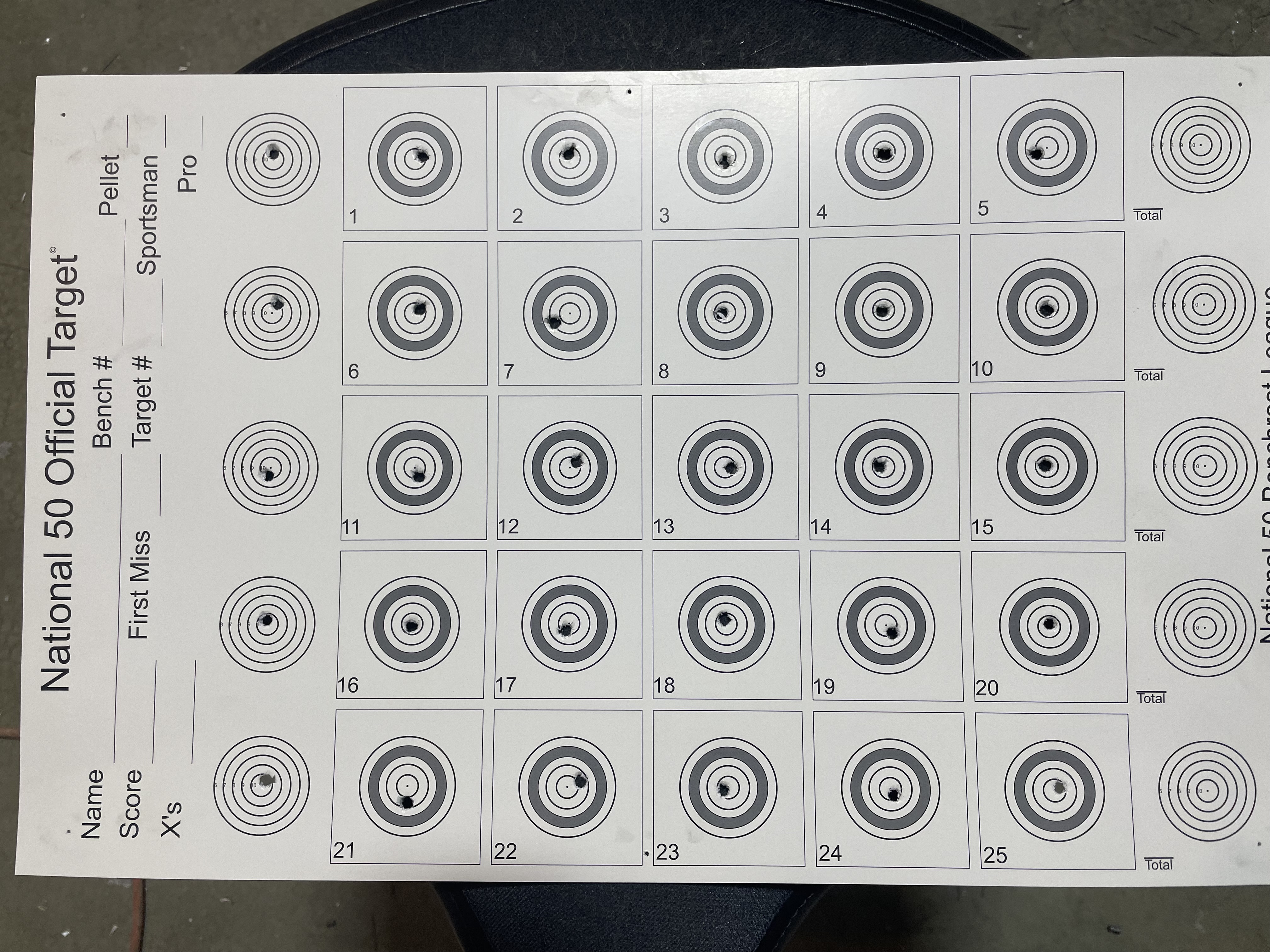

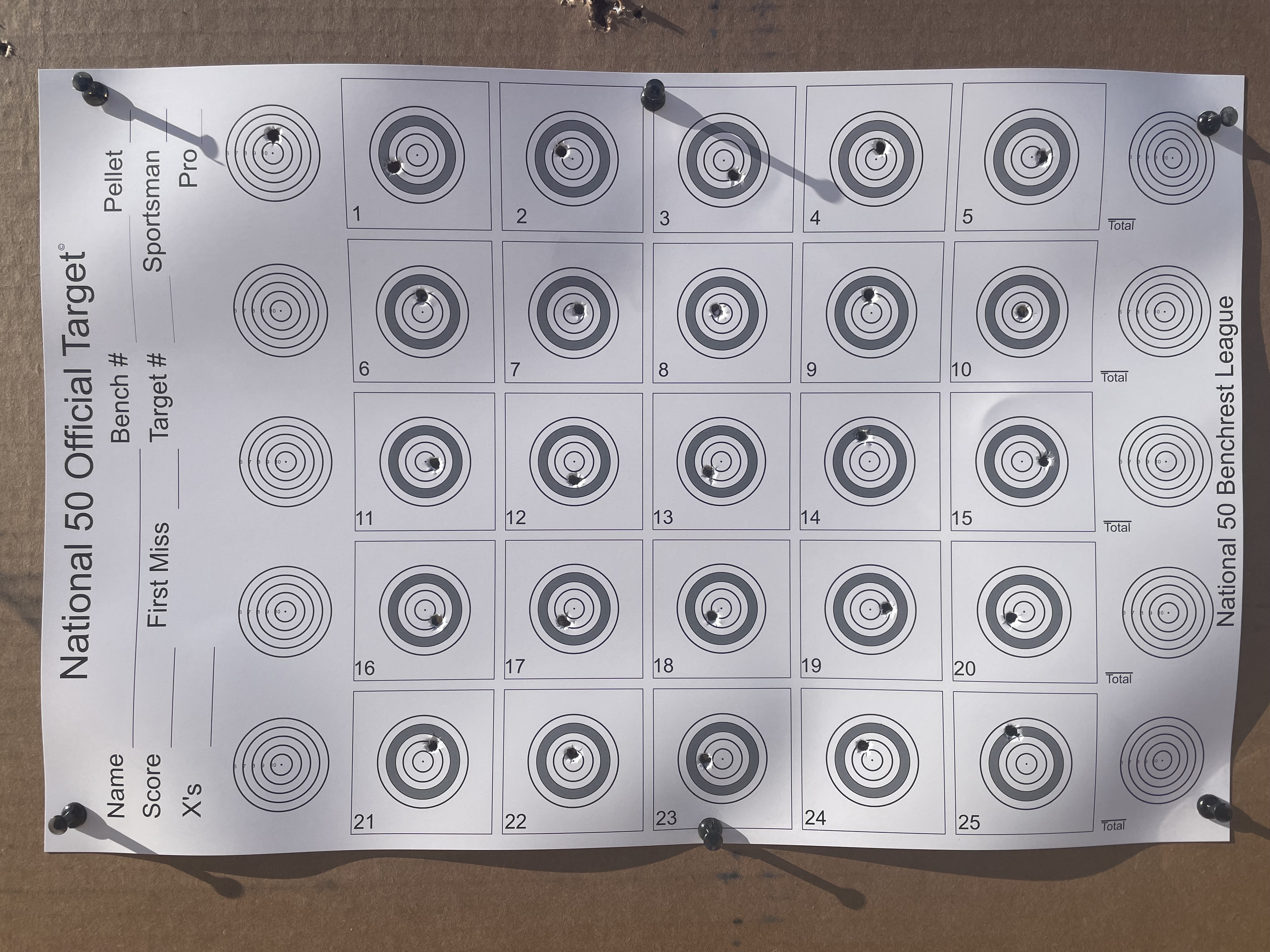

Here's some more 25 shot groups in heavy wind at 50. 10 plus
Little tweaks here and there.
The smaller set of groups took me about 15 minutes each. I was careful about what condition I shot. The bigger groups were shot in whatever condition presented itself once the slug was loaded and ready to fire. I shot both of those groups in about 4 minutes each.
Really happy with how things are going.
Mike

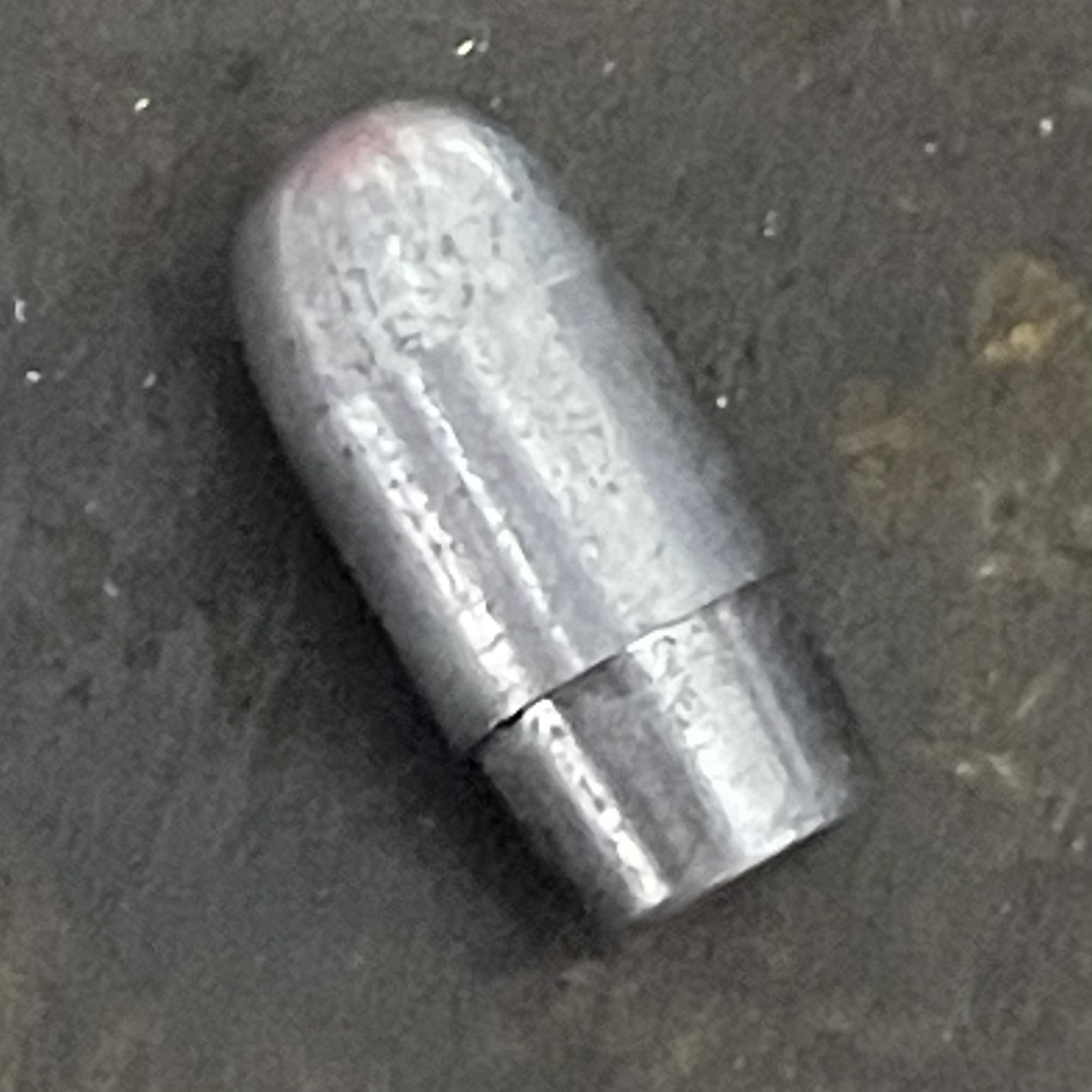

Out of curiosity why does your slug have a shoulder or step before the boat tail? Altaros uses a smooth transition as does many copper jacketed boat tails that I am familiar with.
They need a rebate to be able to swage them reasonably fast. You need a 2 piece main die body to get a smooth boat tail in a swaging operation...but it's a lot more complex and time consuming. It takes about 30
seconds to swage a smooth shoulder and about 2 1/2 to make a slug with a rebated boat tail. If I got even noticeably better results with the smooth...I might take the time. Truth is that I could not get as good of results as I'm now getting with the Alraros or my smooth shoulder slug.
A rebate boat tail design is better for group sizes at relatively shorter ranges due to intermediate ballistic characteristics as the slug leaves the barrel. This was the original reason for rebate boat tail designs. The drag will be increased slightly, but that would only be a problem at very long ranges.
Reactions: RM.510bigbore
That's interesting to know and seems to jive with my experience shooting both.
My smooth slugs or the altaros slugs are extremely sensitive to muzzle blast and require a very stingy tune to get good performance. Unfortunately a really lean tune also has the unwanted characteristic of much larger velocity variations with a wild deviation once in a while that really hurts on the target. I can tune these rebated slugs fairly loose by comparison and never get the wild one...all while getting top accuracy. I have no interest in shooting personally past 50y...but the rebated slugs do really well even out to 200.
Thanks for that info.
Mike
