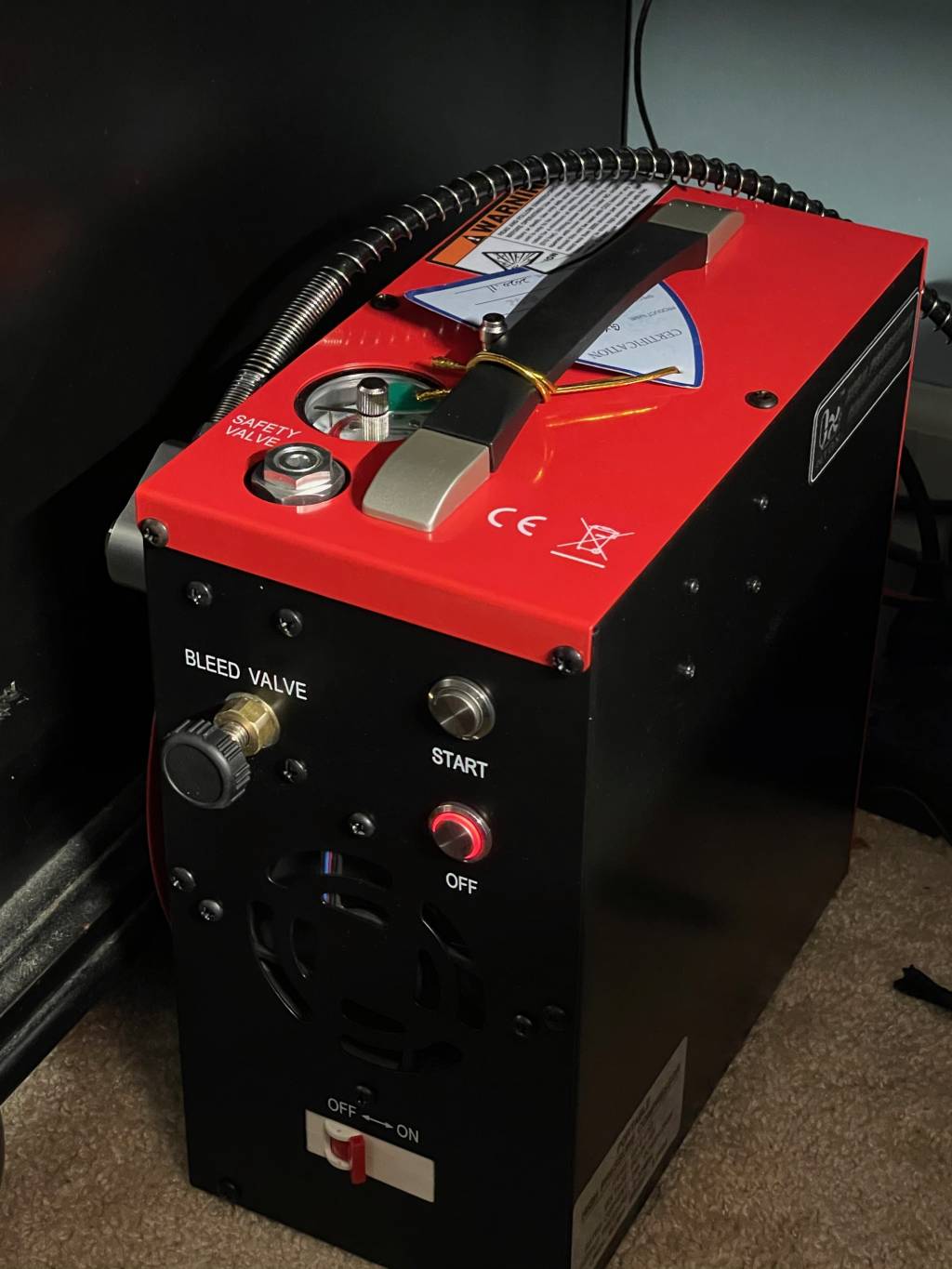

Took a chance - bought a GX CS3
I'm saving up for an Alkin, but in the meantime I wanted something to supplement my Shoebox which is getting up there in years. It's still a workhorse, but it's slow and I wanted something for when my tanks start getting low and I need a few hours to fill them.
Anyways - ordered a GX CS3 compressor from Amazon (yes Odoyle - I got the 4 year Assurion warranty). At least when it breaks I'm covered for a while.
Delivered today and very easy setup. Fans are louder than the pump running. Did a quick solid job filling my 350cc Leshiy 2 tank from 200 bar up to 250 in a couple of minutes. I'll try filling my 90ci paintball tank later to see how it does. Not sure what else I can say, I'm playing the Chinese compressor lottery and hopefully they've gotten things figured out with this generation.

Jim - thank you. This one is dated Nov. 2020 and the Amazon description clearly states an updated version that no longer need the grease addition. I'm not sure what they did or how it will effect longevity, but I did notice that the air output when filling a 90ci Ninja tank from ~1500 up to around 3500 where I stopped it manually (maybe 15 minutes runtime) the air coming out the front was very very warm. I mean really close to what I would call hot. I left the fan running for a good 10 minutes and the air was still pretty warm coming out. As well the whole outside casing was quite warm too.
My first thought is for the noise these fans make a lot more air should moving. They'd be better off with larger (which - quieter) 5 - 6" fans front and back and air flow would be better. I can see there's not much room in the case, in which case I would be fine with an externally mounted fan in the front that stuck out ~1.5". Overall I believe lack of air flow will be the cause of unneeded heat which will lead to faster wear on the high side piston.
Direct filling guns is what this is made for and that'll be its use. Especially for the Huben. It needs 170-190 bar setting to really shine with the right slugs. Even from a full 9L tank you won't get many fills that even take it over 250 bar. This little guy pumped it right up to 300 bar in about 2 minutes.

For longevity sake, I suggest that you run the pumps without load after the fill is complete. Ideally, you stop the process rather than the preset dial, and let the pressure out of the hose while the motor is running so there is not a hot spot created on the piston or cylinder.

So far so good with the CS3. Only pumping guns directly. I could tell about 15 minutes into filling my 90 ci (~ 1.5 L) tank that it was a bad idea. The pump gets pretty hot when running 15 minutes. So I think not doing tank and only filling guns will help with the longevity.
I picked up a vibration hour meter so I can at least keep track of runtime. It surprises me there is no 25 hour or 100 hour maintenance to do.

I've been doing what JimNM said - run the pump no load before and after filling. At first the pump was generating a bit of a burny kinda smell. It's becoming less strong as is runs so maybe just lubrication from assembly.

CTShooter - I offered to help Grandadmorgan with his pump problem, but he decided to take the return rather than twist a wrench on a new item. His call, but I do frown on people who must piss on another's decisions. I had the same issue with mine as grandadmorgan did, the pressure would not reach 1500 psi after the first session. There is a small grease catching check valve that often times needs a quick removal and wipe then re-inserted. In all, less than 5 mins for a one time fix to remedy the issue. I can point out the video and the time stamp where I learned the trick, or I could talk you through with or without pictures. Your call amigo.

Knock-wood I just hit 10 hours on this compressor. Been only using it for direct gun fills. Mostly a Leshiy 2 with 350cc tank and my Huben up to 300 bar most every time.
Following advice above I have been running the pump for about 2 minutes no load before and after each run. This seems like it has been effective at controlling moisture as I changed the cotton pads in the little high-pressure side ebay filter and other than a little discoloration they were basically dry.
