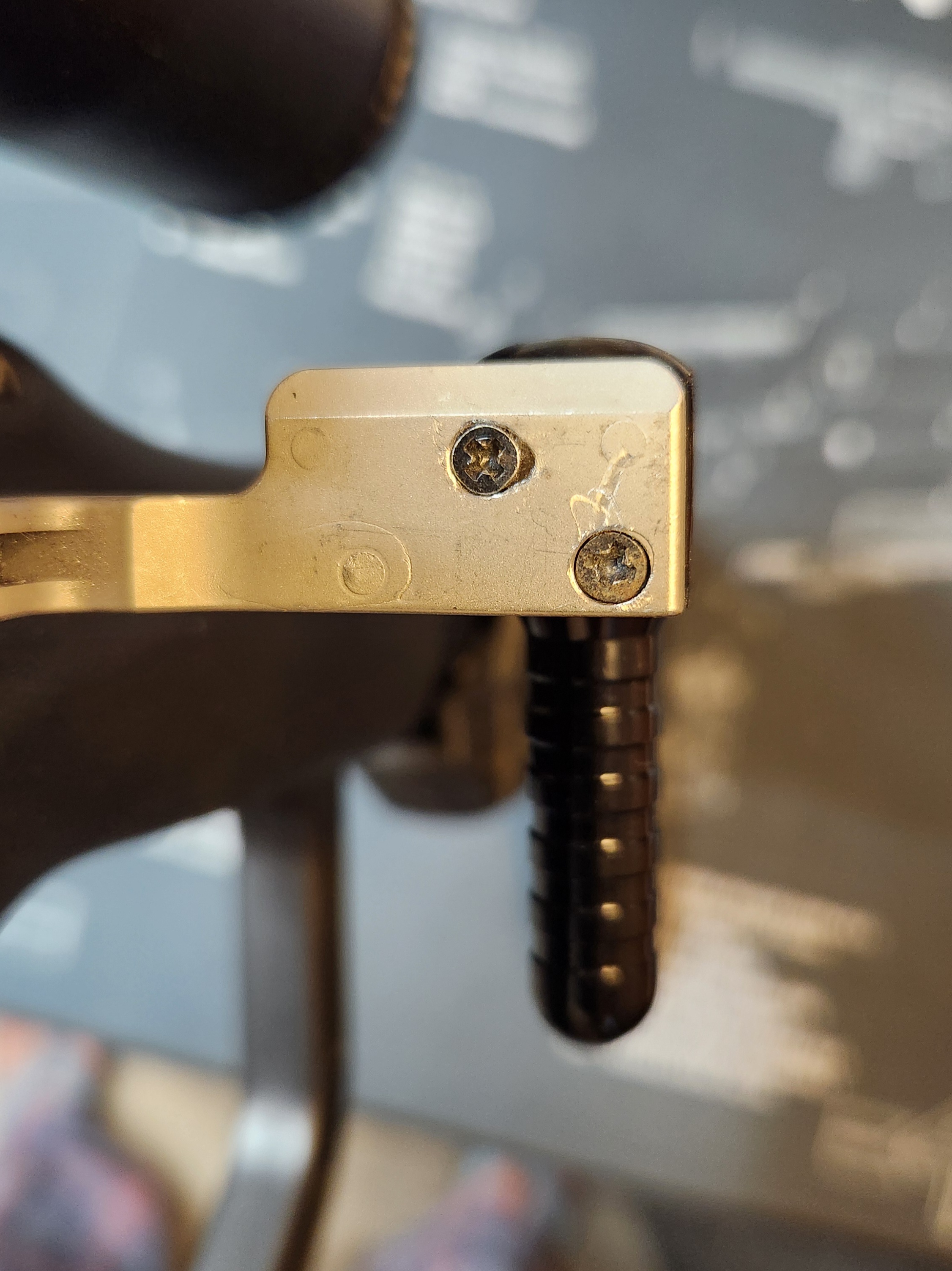

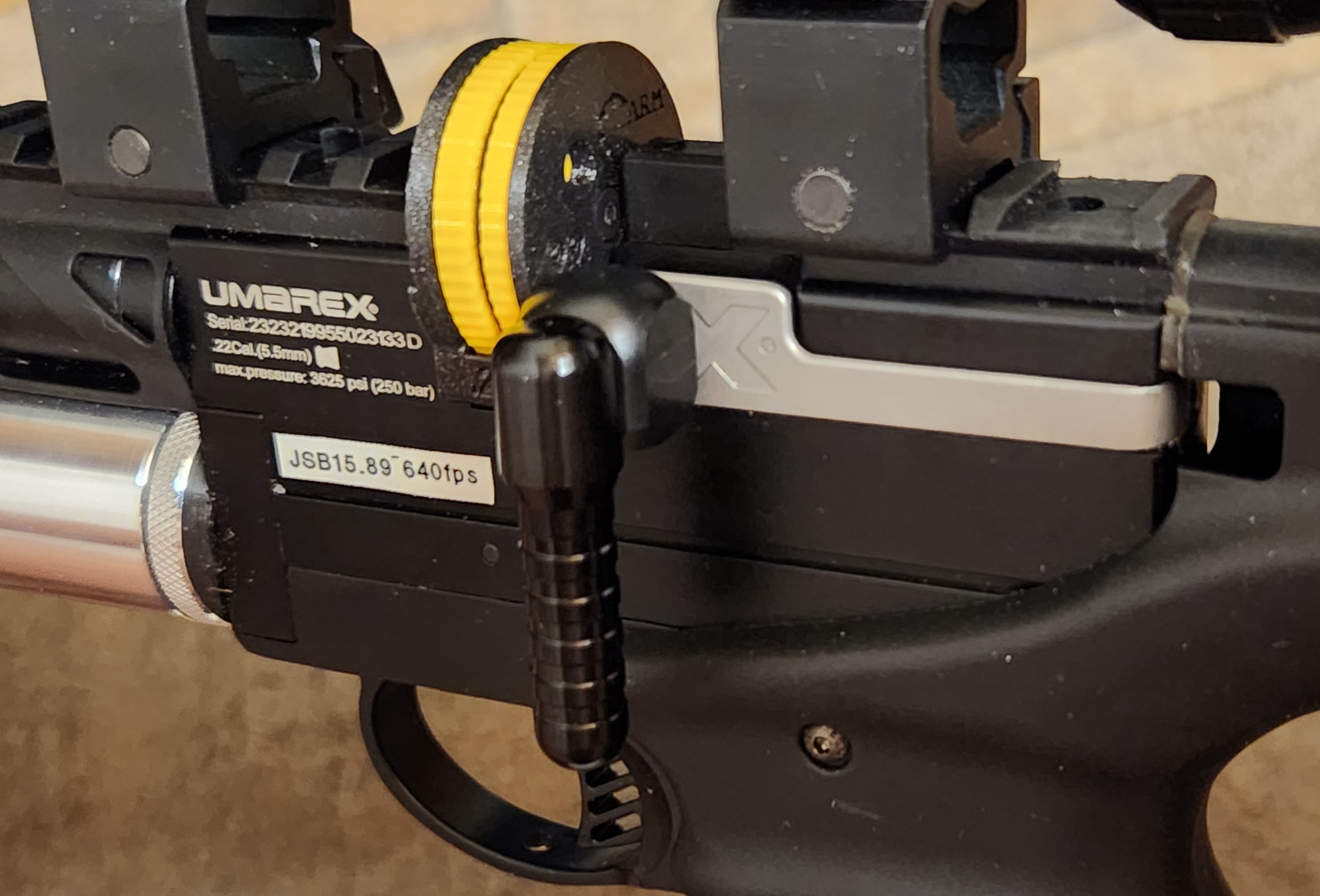

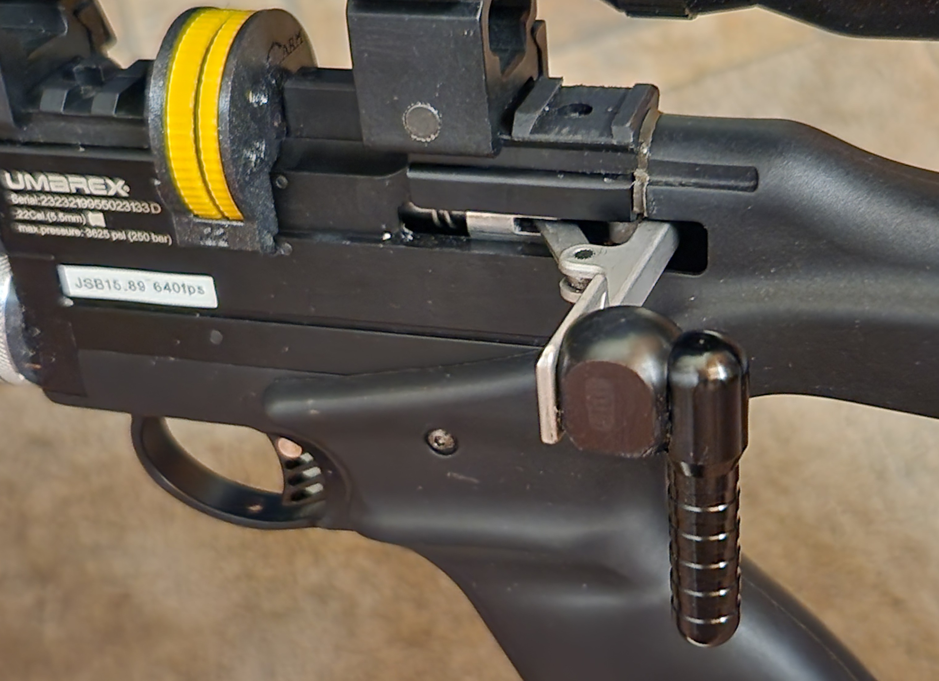

Back in post 848, I mentioned a charging lever handle meant for another gun.
I finally got one & attached it with 2 small screws. Clears the mag. Swings out no further than the end of the lever. Simple mod.
Yes, yes & no. I drilled 2 pilot holes through the Notos lever and into the handle's plastic spacer block. Then, countersunk reliefs into the back of the Notos lever so the screw's heads could fit flush. The holes were drilled diagonally above & below the center hole, so as to not weaken the metal Notos lever.
I used screws with more aggressive threads to better grip into plastic. They self-tapped into the plastic spacer.
The center threaded hole and its supplied setscrew are for securing the handle onto an Air Arms rifle lever that it was intended for.

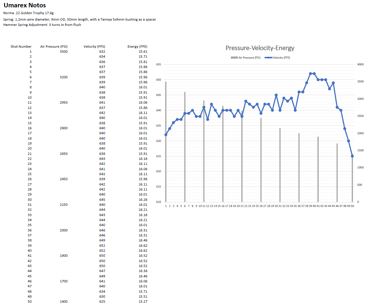

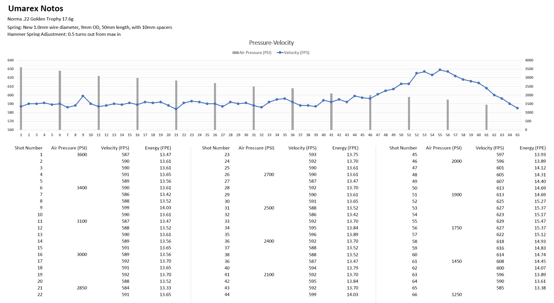

I hope this helps anyone looking for some spring information. I revisited the hammer spring that I replaced originally from a softer 1.0mm wire diameter to a stiffer 1.2mm x 9mm OD x 50mm spring along with a Tamiya 5x9mm bushing as a spacer and turned the adjuster 3 turns in from flush. If I were to back the screw out flush, there is a small amount of free flight. At 3 turns in there is preload for some wiggle room. It’s putting out Norma GTFT 17.6g at around 640 fps for about 35 shots before it encounters the off-reg bell. Additionally, I did a 5 pellet string with CPHP and those were 699-700 fps.
Attached is the string with the Norma pellets.
And here is the link to the spring.
*Edit #2: Uploaded a revised chart with FPE graph removed because it’s basically the same curve as FPS. Also had to change the weight to 17.6g from the incorrect 17.1g oops.

I have just tuned one of my Notos with the Norma 17.6 pellets too.
Like you, I get 5 magazines but in the 680-685 FPS range (about 18 FPE).
I start right under 4000 PSI (slight overfill) and go down to the 2000 PSI (factory regulator setting).

Those 17.6g Normas are pretty decent. For whatever reason my particular Notos doesn’t like the 15.9g…at all lol.
I opted for the pre-cut lengths because I prefer coil ends to be squared or squared-ground for consistency and reduced chance of buckling (messed with a lot of springs in my rc car racing days).
I just put the softer 1.0 x 9mm x 50 spring with 10mm of spacers back in a will do a string with that and post the raw data.

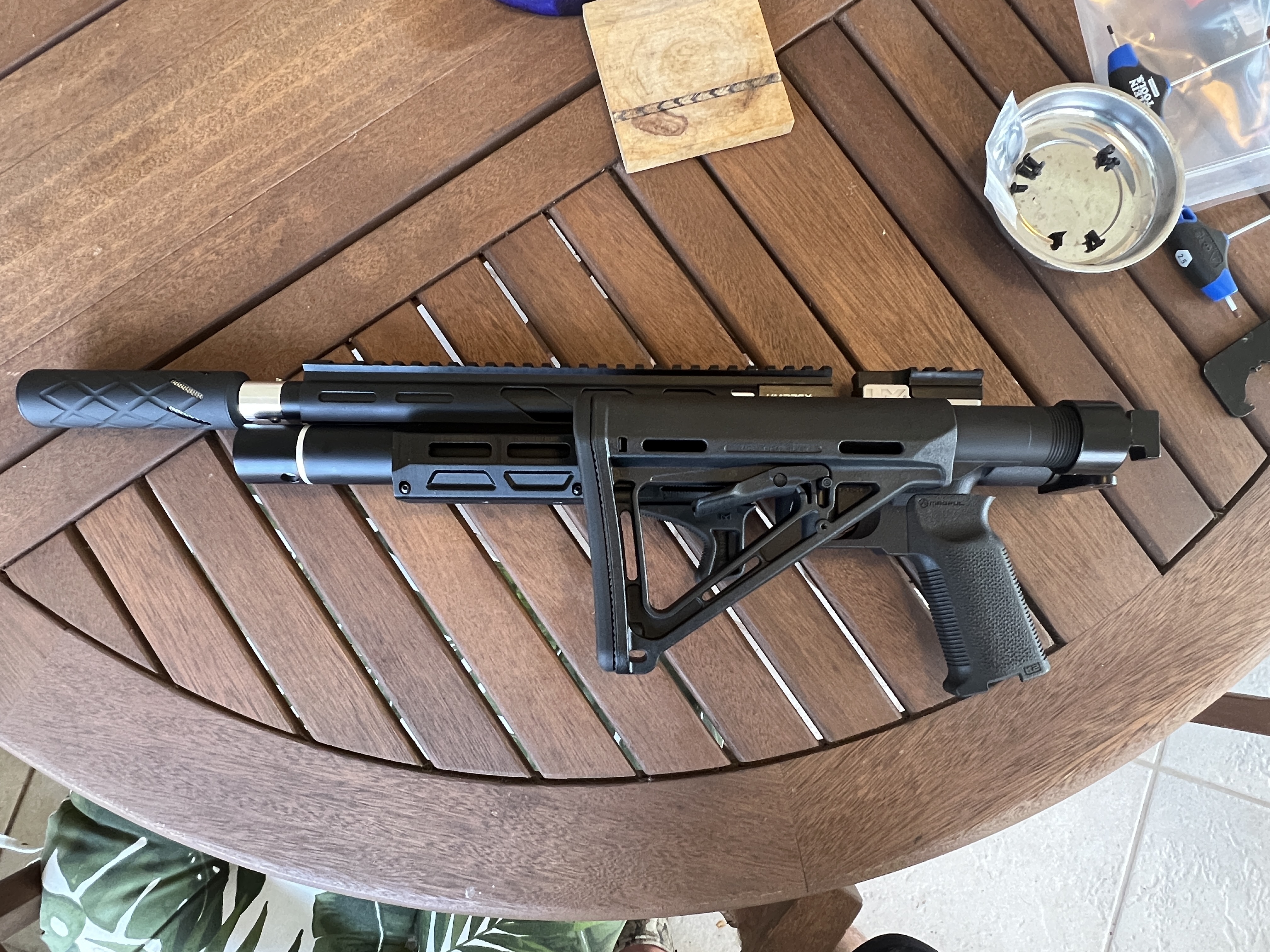

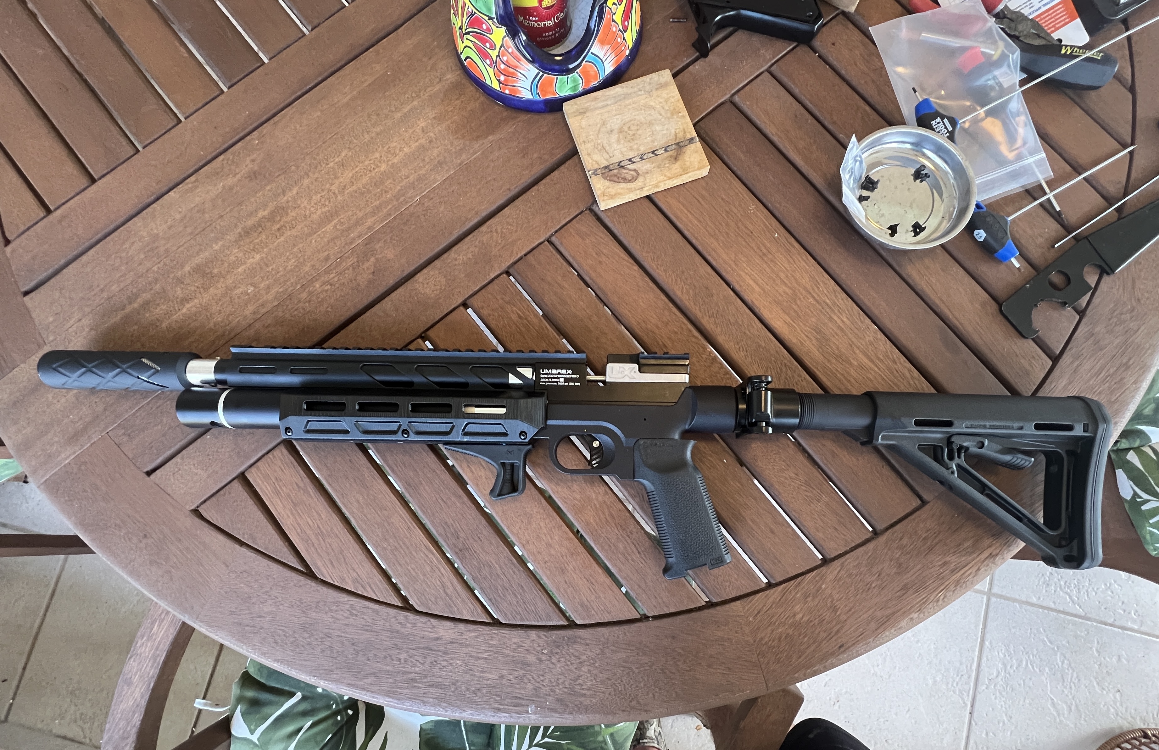

I made a blunder removing the factory moderator. I figured the barrel was more sturdy than it was. I cut it with a rotary tool on a vice. I was trying to set it free with a little arm torque and some channel pliers. I ended up bending the barrel. I reached out to @Firewalker and he had one he could sell me and took my barrel. He has a project in mind for it.
Lesson #1: Take your time.
Lesson #2: The Notos barrel can bend pretty easy, I'm not a gym guy.
I got your back!
Here is the data using a 1.0mm x 9.0mm OD x 50mm length spring with 10mm worth of spacers and adjustment screw half a turn counterclockwise from bottomed out.
Started at 3600 psi and stopped 65 pellets later after it dropped off the reg, climbed, then matched starting velocity. Trigger weight, bolt handle effort, and report were noticeably reduced. Feels like a mellow setup.
Link to short soft spring

The velocity spike when it falls off the regulator is documented in several places, like this one: https://hardairmagazine.com/ham-columns/tuning-regulated-pcp-airguns
