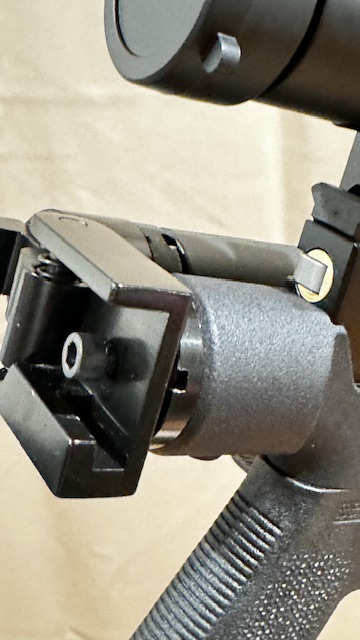

I added the buck rail conversion kit with the UTG side folder and a universal Saber Tactical picatinny to arca rail so I can place on a tripod if I want. Oh and a 0db 110 moderator on it.
For the UTG side folder, it was a little wobbly/play to it when it was closed and extended so I threaded the hole that was in the middle of the adapter piece and placed a screw in there with some Loctite to make it solid, pic below.

He has the wrong grip for the Buck Rail Conversion kit
I have my own grip on it. That one had the tang removed to once fit on a Maverick. It’s the same grip I use on my patrol rifle. It’s something know well. When it comes to form of function, I choose function. It doesn’t cause any grip issues.

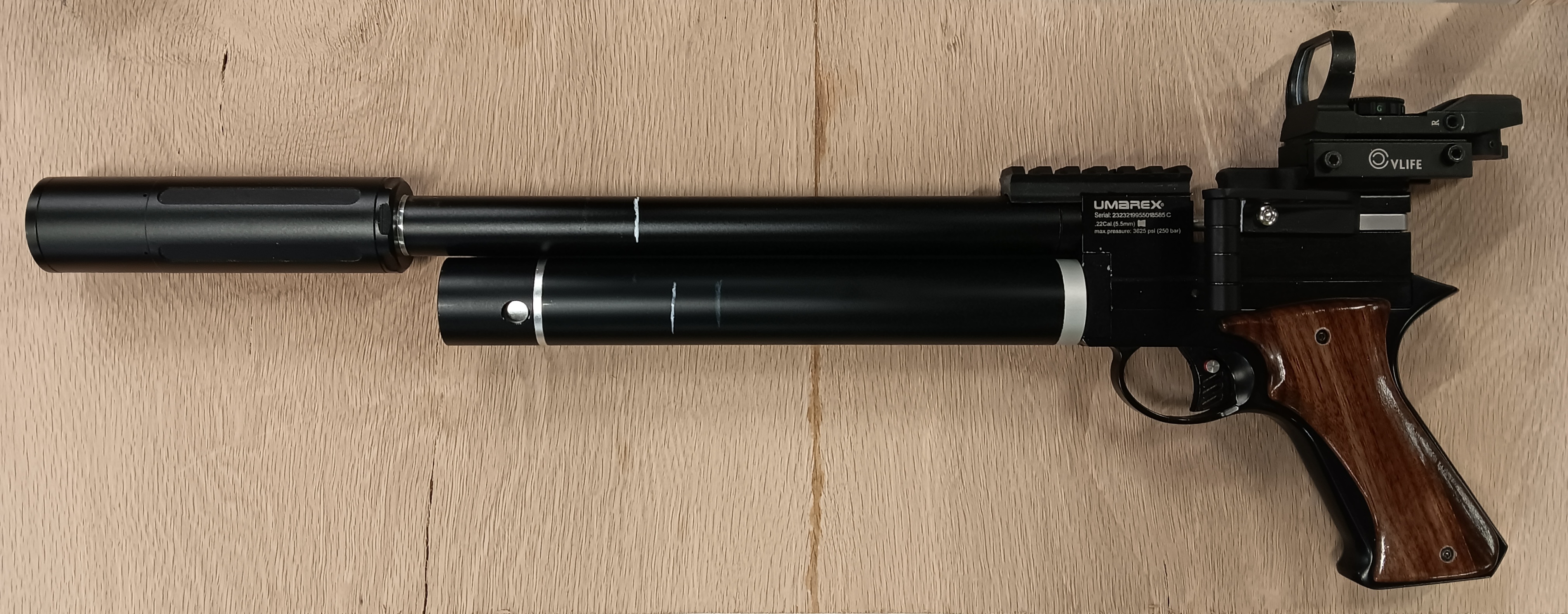

Getting closer to the pistol I want from the Notos. Note the bright white marks, this is where I want to cut her down to.
I think is looks good as is now too.
What did you do to it:
-removed shroud
-threaded barrel for a moderator
I think I could shoot mine an as a pistol by just adding the pistol grips.
Reactions: Firewalker

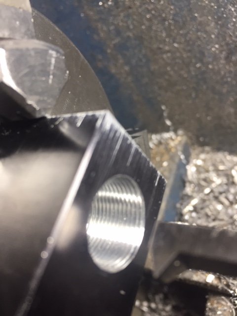

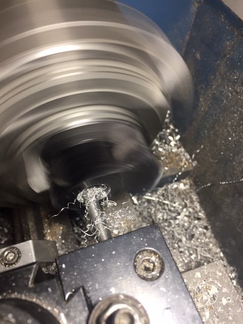

For those who want to install double tank on the Notos, this is how I did mine. Just remember that this is on the high pressure side, so make sure to use ASTM rated material. The tank thread is M28x1.0 mm. I like to single point thread for this application, same as the barrel thread to make sure it is concentric to the center line. This way both tanks are match and seamless. You can just copy the dimensions from your end cap and make it back to back so it seals on both tank. Original bore hole was 16 mm, I made mine 18 mm bore to gain some CC. I still have over 2.5 mm wall thickness under the O-ring grove, plenty strong for this pressure.
What is the outer diameter? I heard 32mm
