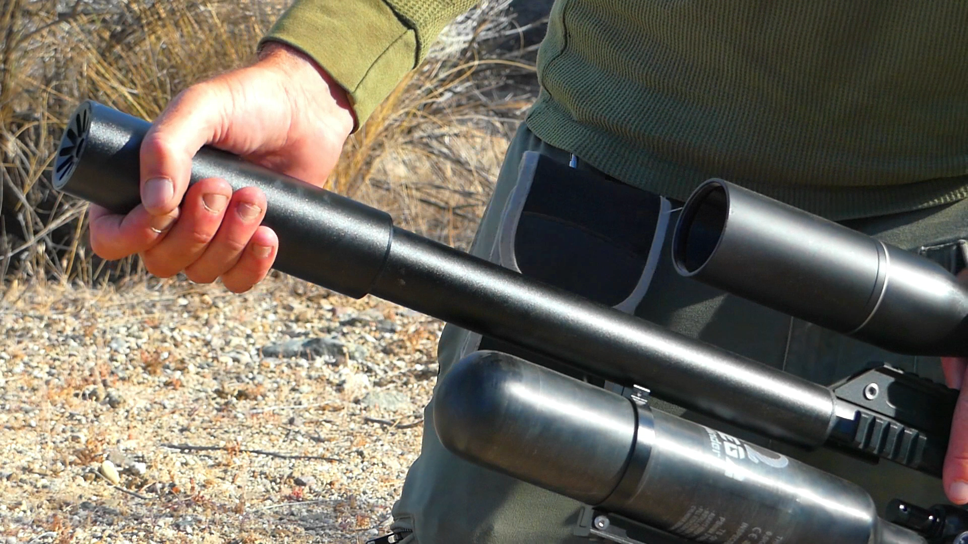

The shroud like everything else on the gun is very robust and of large diameter going into the removable 6 5/8" moderator with aluminum monocore.
I did test the sound with a DB meter from both the high and low power, this is in no way a scientific test but can give us some sort of idea of noise level. The average backyard friendly airgun will most likely produce around 75db. On the low end this puts out 95db and on the high end 115db, this is a bit more than a .22LR would produce. Again this will depend on the environment and specific tune of the rifle. I realize many spend a good dime on a new rifle only to immediately go out and purchase an aftermarket moderator for another few hundred dollars. In this case I really can't see an aftermarket moderator being any more effective than this quality unit, in that I see some added value.
