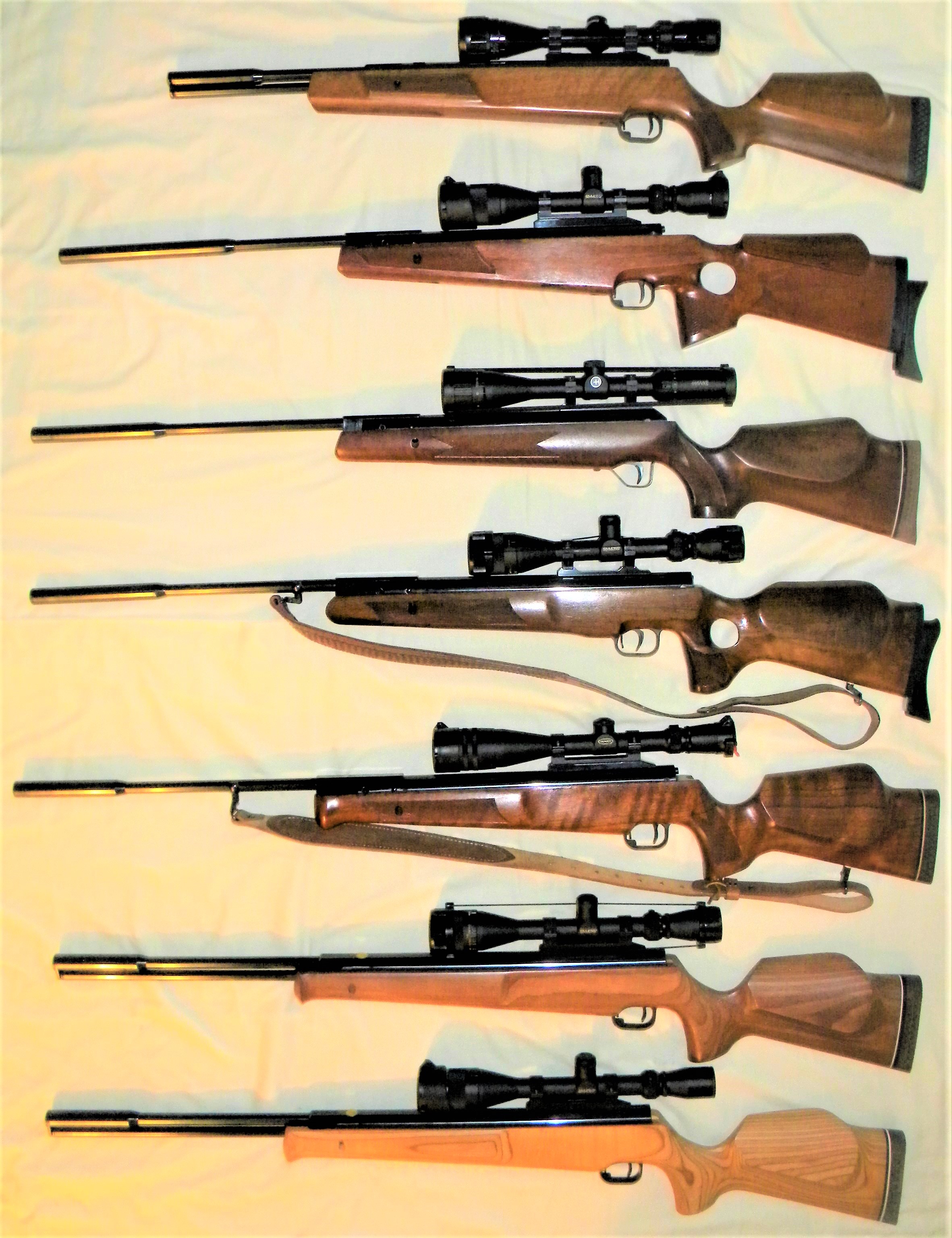

I own many. An old .25 Kodiak, a Turkish Patriot .25 conversion, a .25 Eliminator, and a bunch of SLR98s. I used to own more but sold them off.

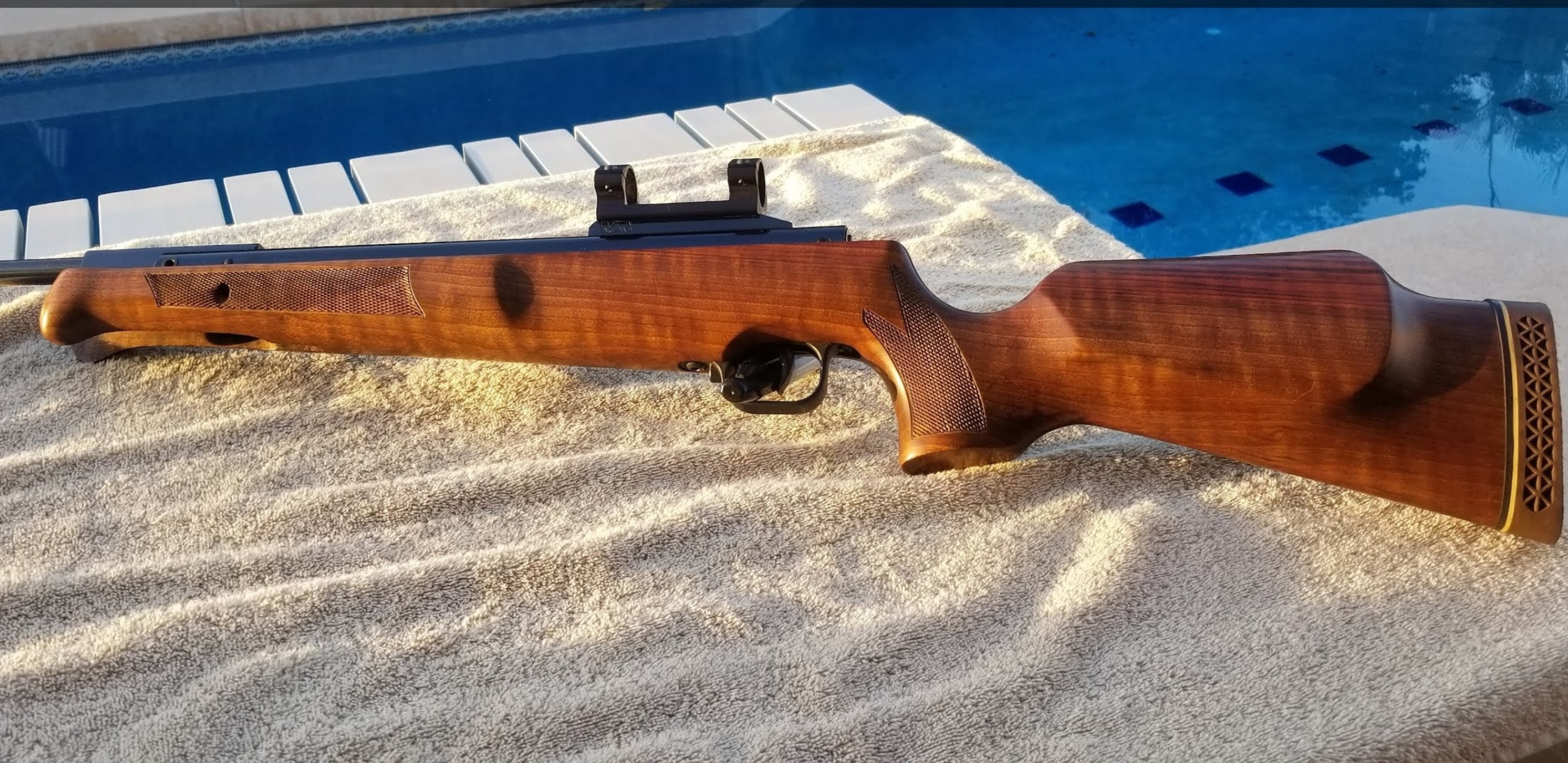

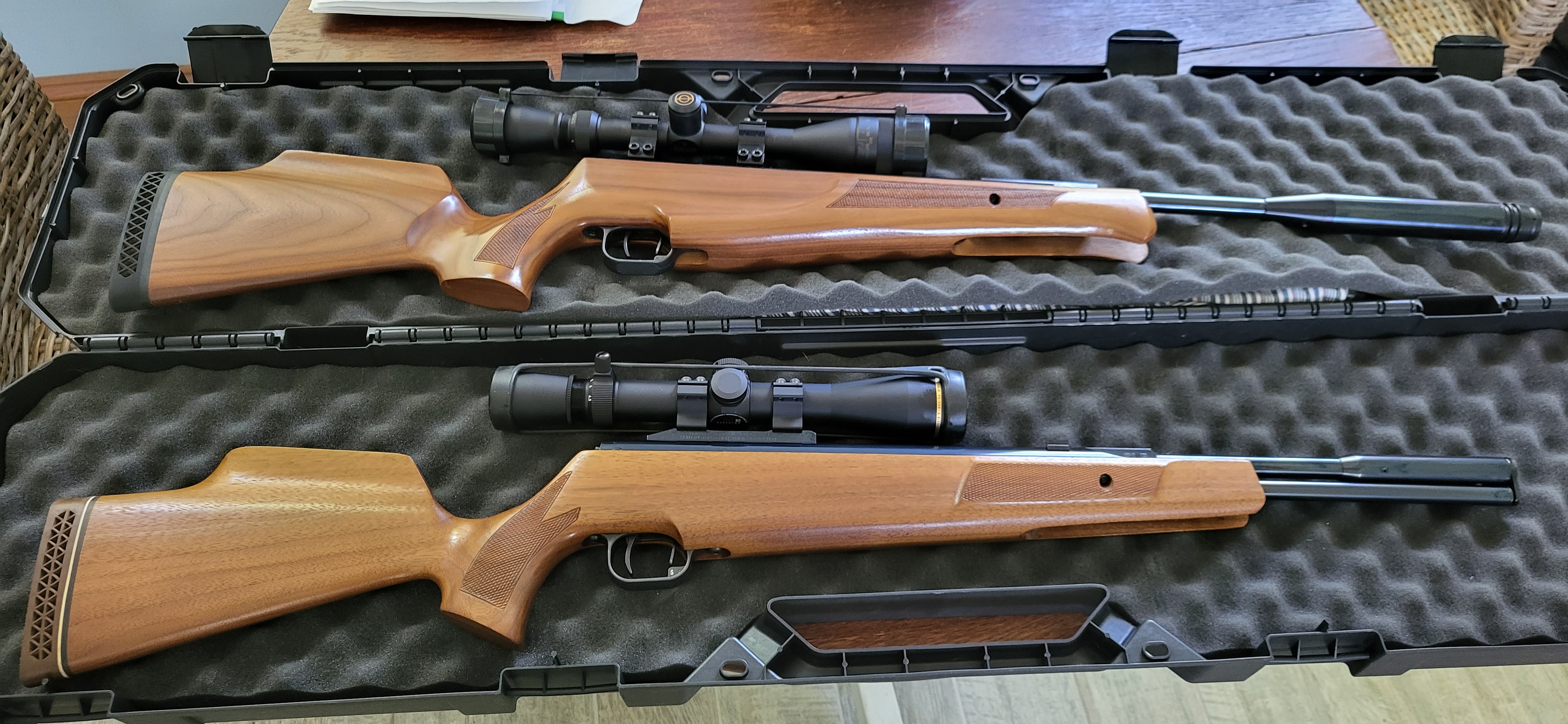

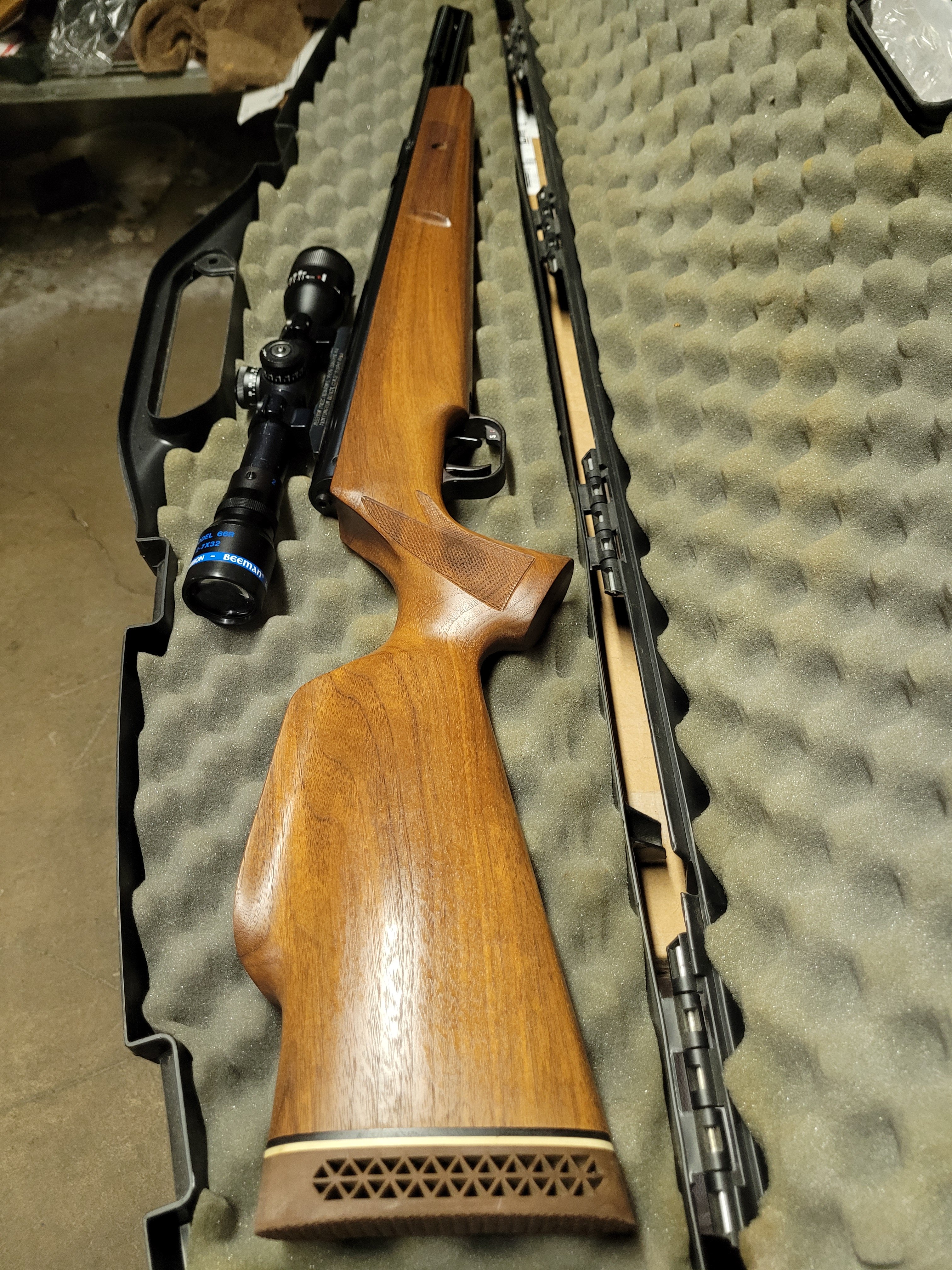

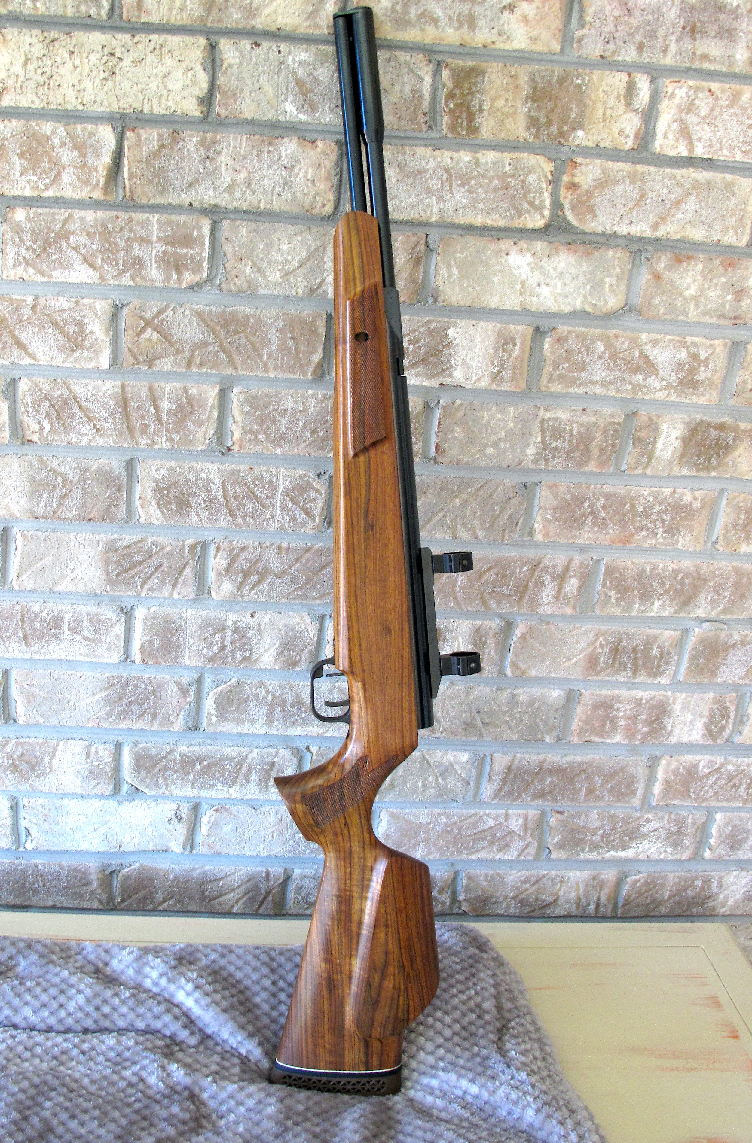

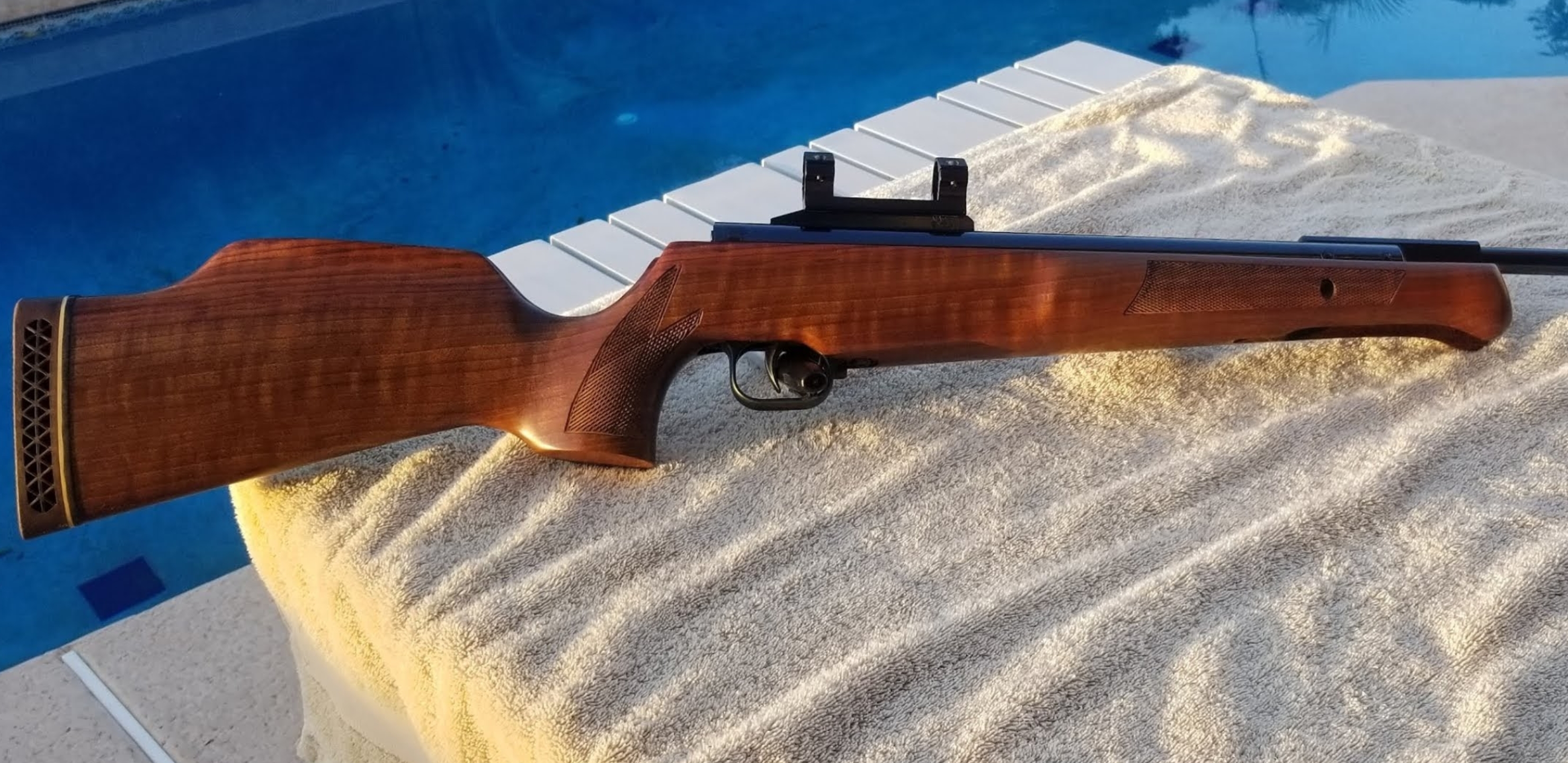

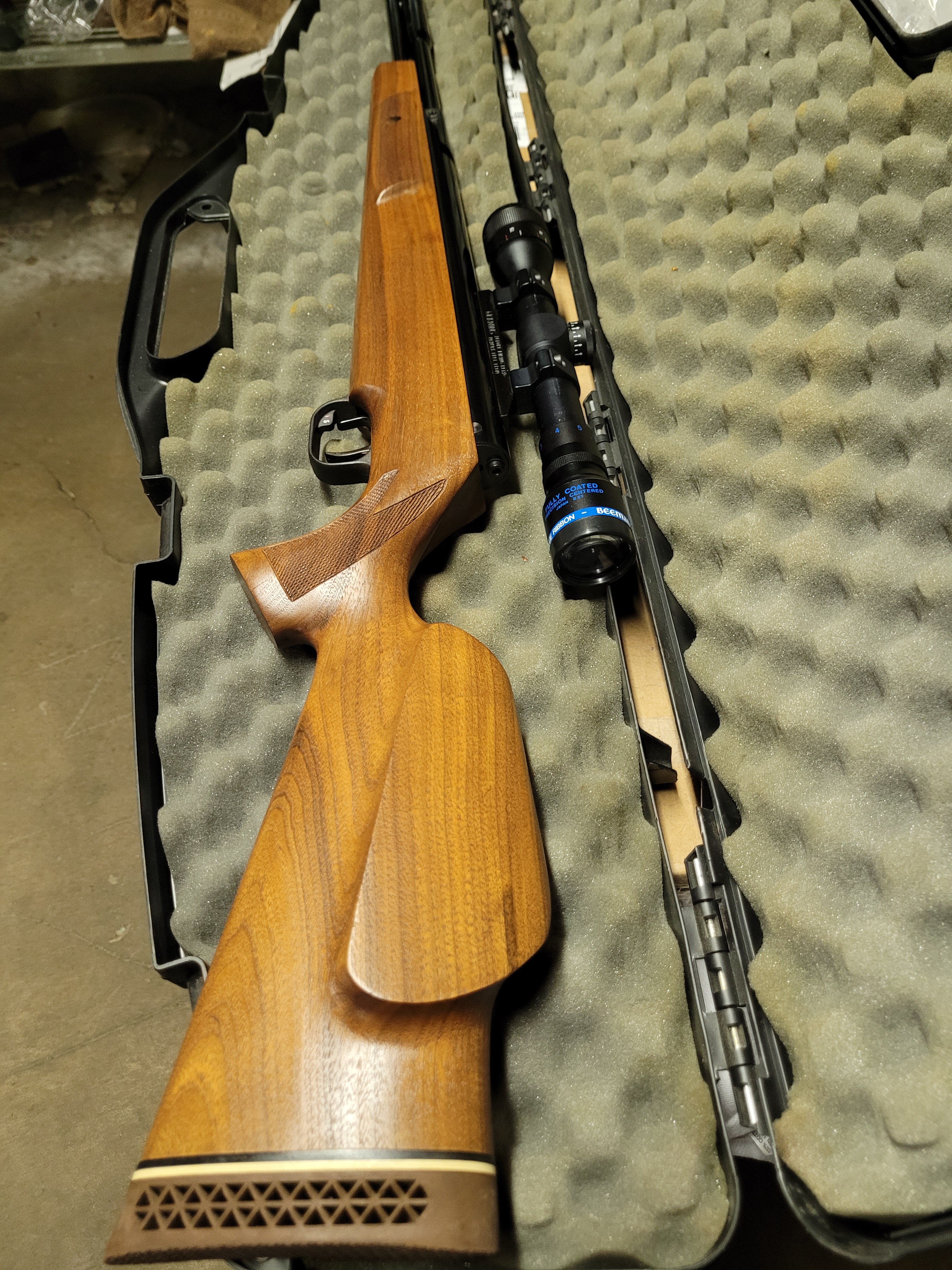

I'd recommend at least one gas ram for every collection. Here's a few pictures of my Beeman SLR98 carbine on. 22. Enjoy!
