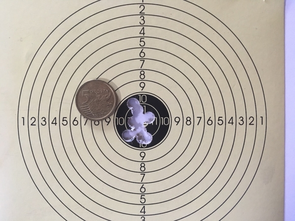

Here is my group from Huben K1 shooting MOnster Redesigned at 920 fps, distance 35 yards. Huben can push them up to supersonic, but they lose stability.
In my opinion .22 cal is much better than .25.

"lipsztyk"Here is my group from Huben K1 shooting MOnster Redesigned at 920 fps, distance 35 yards. Huben can push them up to supersonic, but they lose stability.

If thats as good as they shoot at 35 yards I wouldnt shoot them. Maybe try dropping that velocity below 900 fps. As far as the question goes I have .22 and .25 cal airguns and I will keep both and use them for different situations.
