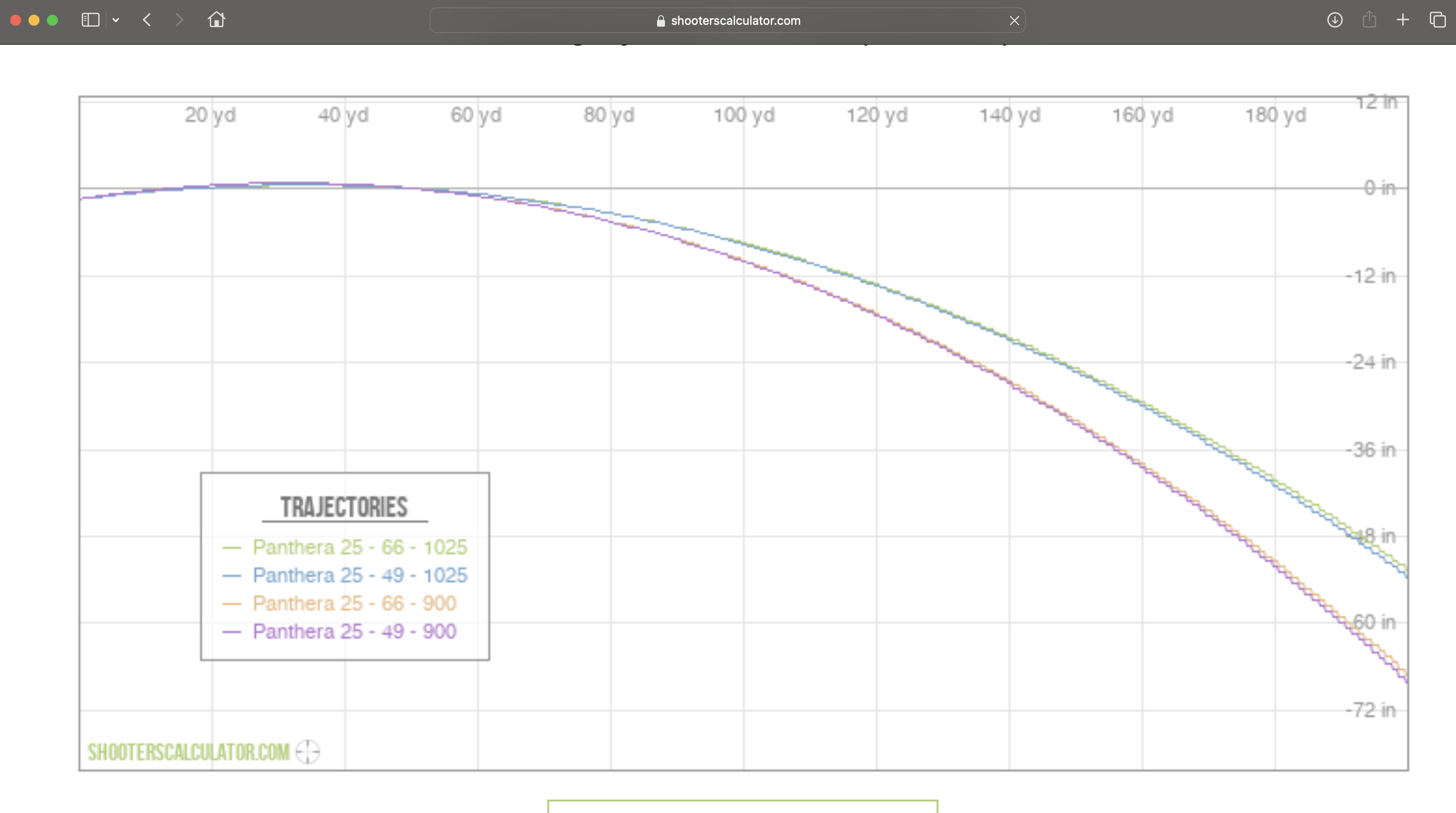

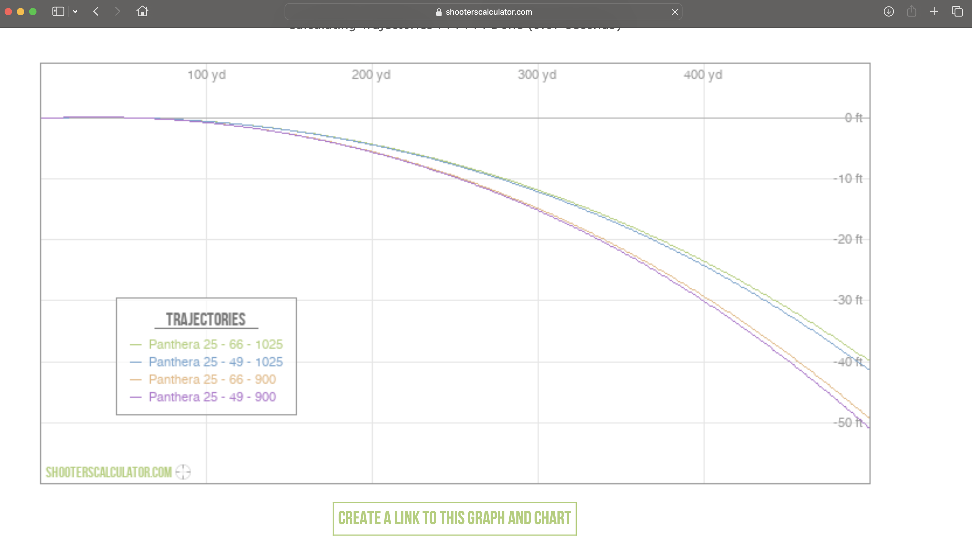

So I plotted these two graphs with the BC and weights and one set at 900 FPS and one at 1025. No accuracy data here, just ballistics. So until you are out beyond 300 yards doesn't look like grain / BC have any real impact. But when raising the FPS to 1025 do you see a change in the curve.. Interesting..
Mike
