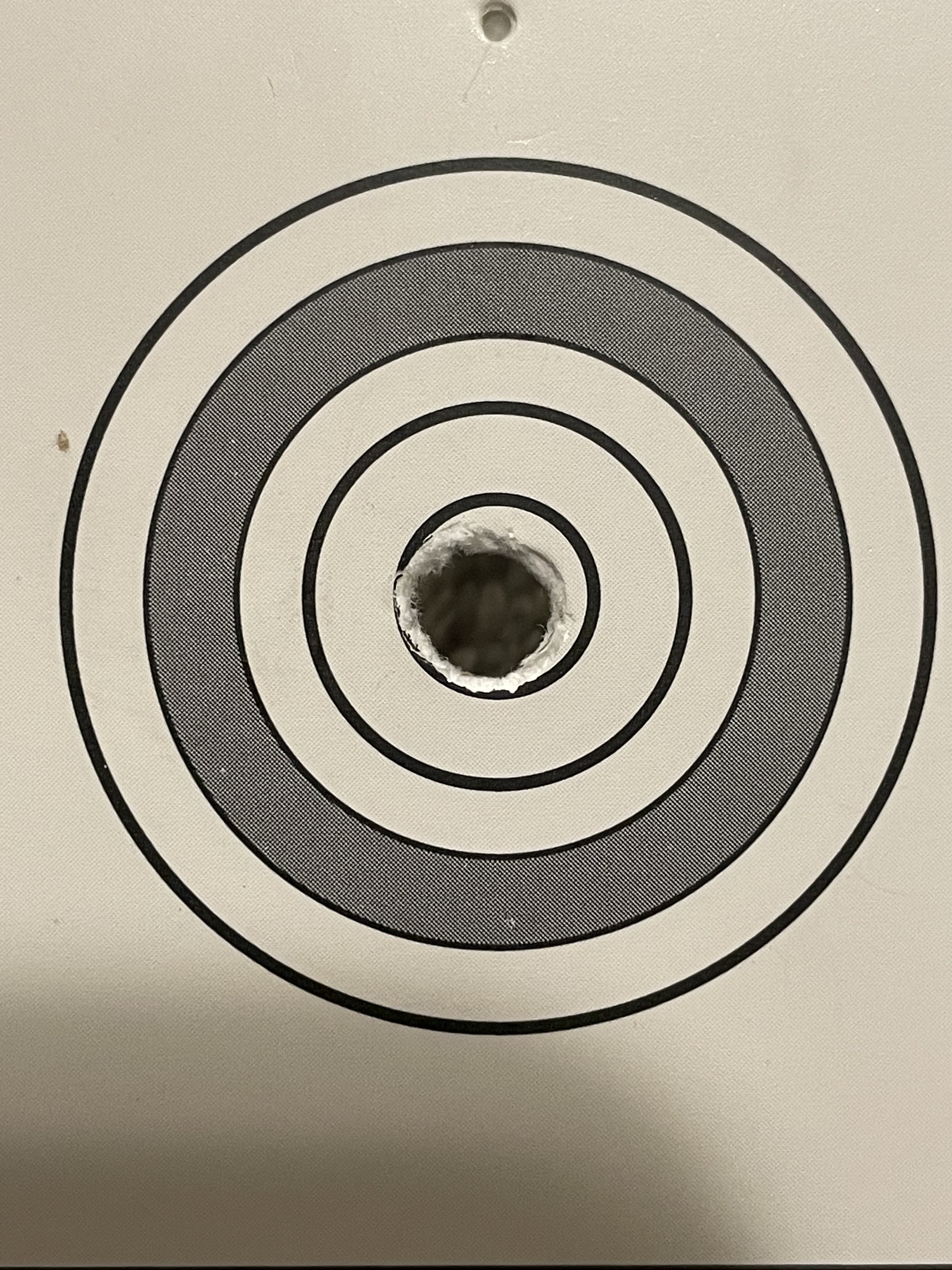

5 shots at 50y.
.021 ctc
I always knew this gun was an easy .1 MOA gun, but this proves it.

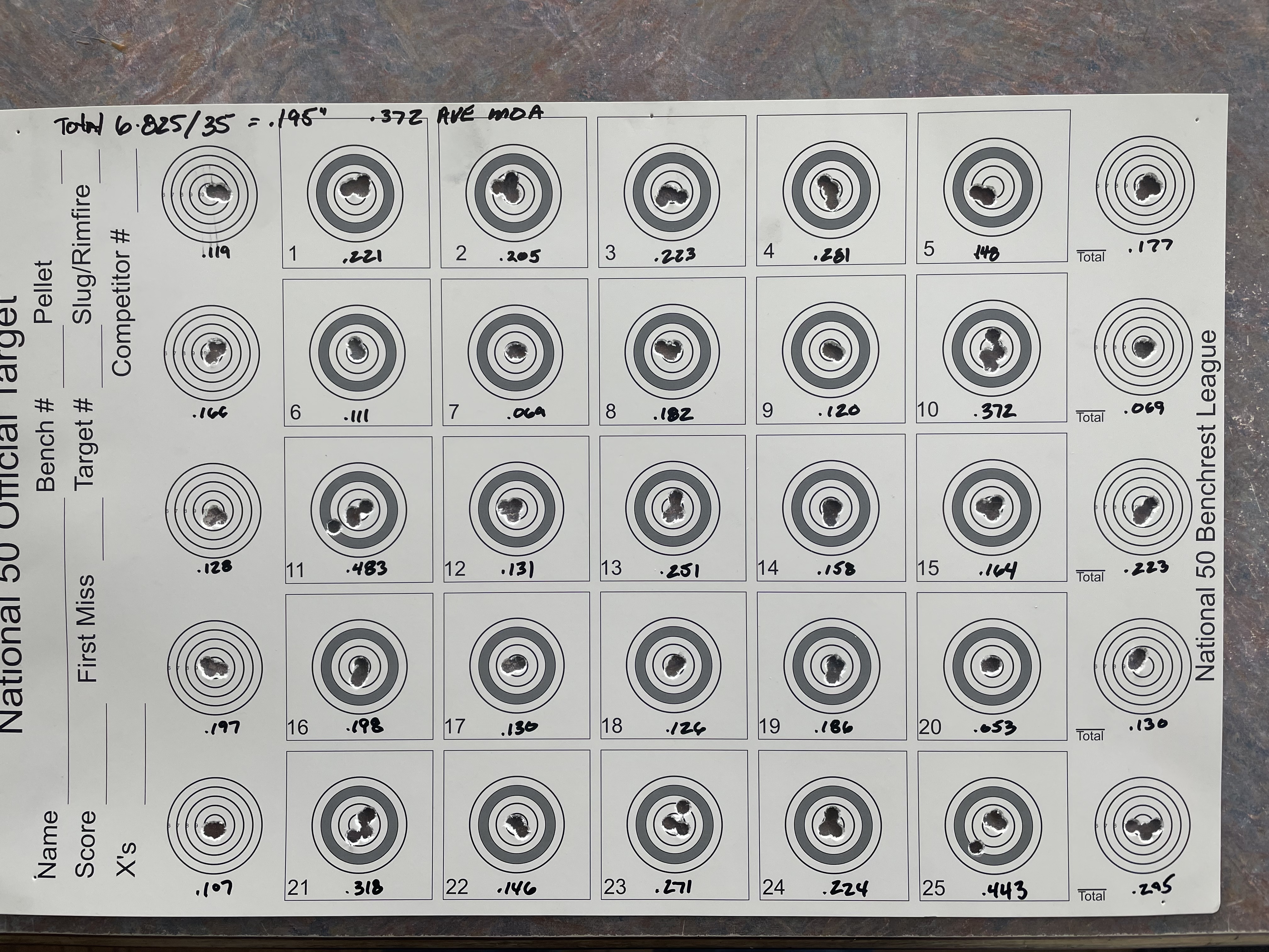

Ok, here is 35 4 shot groups at 50y outdoors.
For the first shot in every group I tried to hold what I felt was the appropriate amount so I could keep the groups mostly near the middle. For the remaining 3 shots of each group , I held in the same place as the first but tried to shoot in a similar condition. This was done to take me out of the test as much as possible for an outdoor situation.
Why 4 shot groups?
Read this. http://www.the-long-family.com/group_size_analysis.htm
This gun is set up the best that I am currently capable of for 50y.
So the 35 group average is .372 MOA at 50y. 140 shots in total.
What do you reckon the chances are for an exceptionally talented Indian with a 1 MOA gun to beat this gun in the hands of a mid level Indian? I’m guessing pretty close to zero.
This concludes the Benchrest lesson for today. 😀
