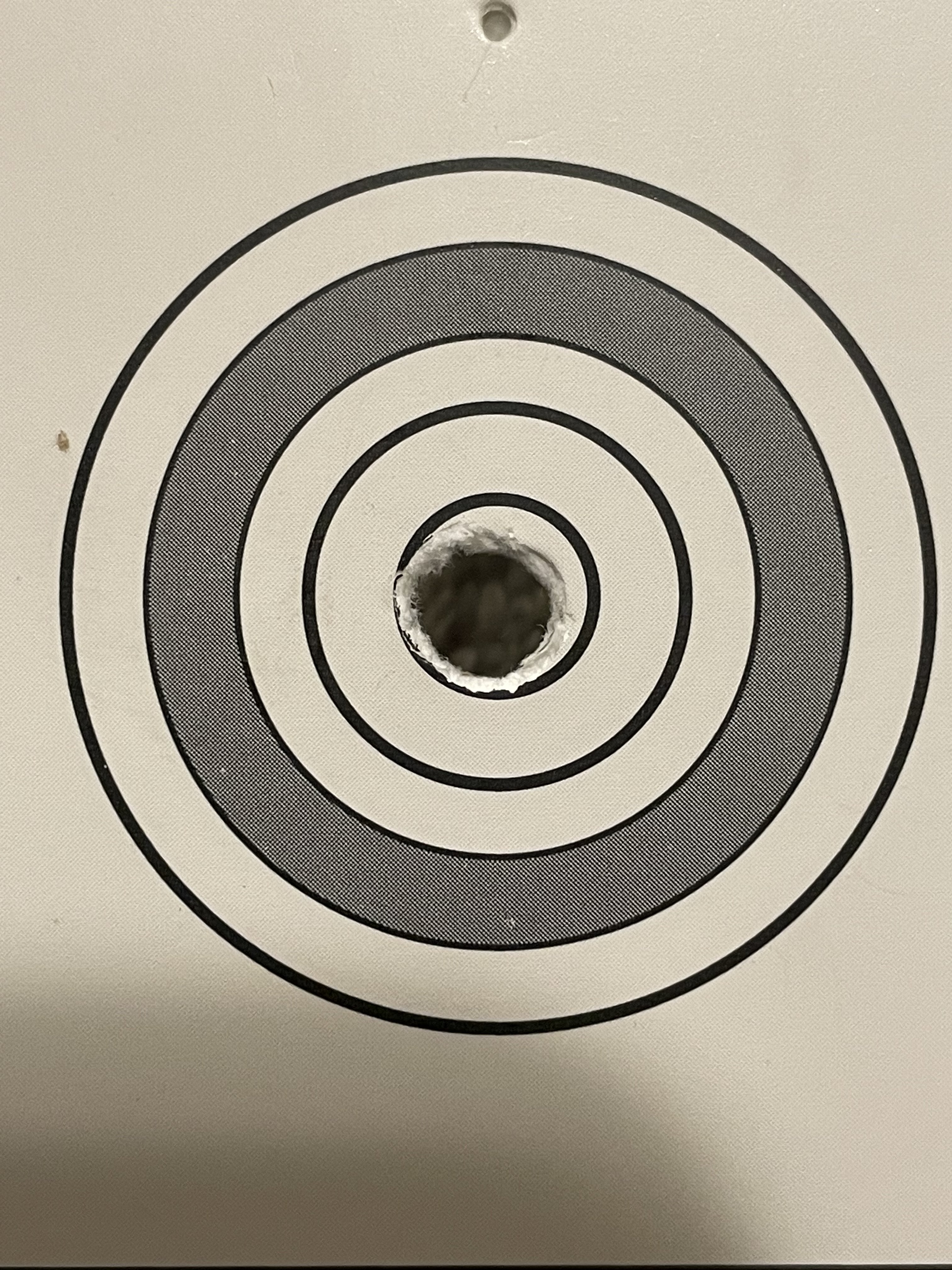

Lol….
5 shots at 50y.
.021 ctc
I always knew this gun was an easy .1 MOA gun, but this proves it.
Hahahaha

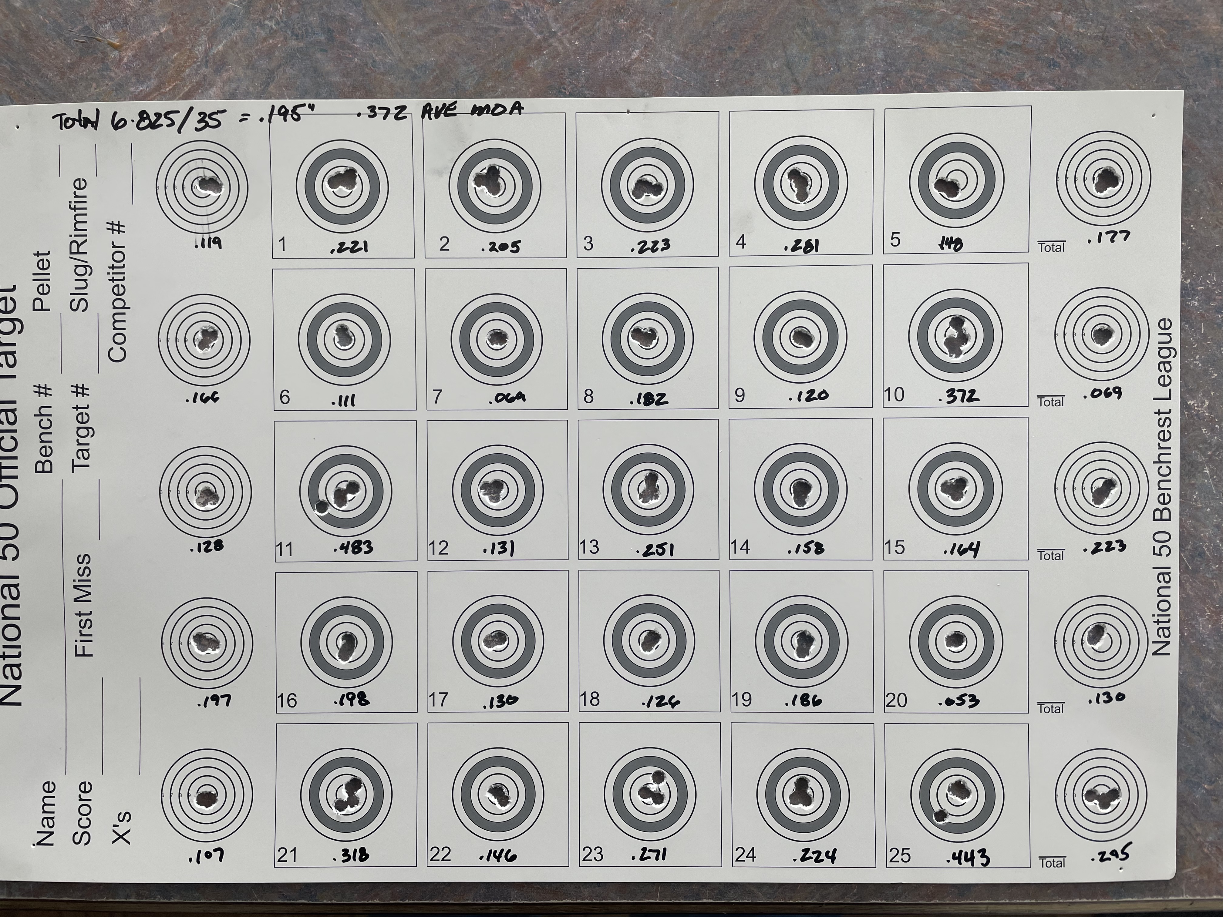

Ok, here is 35 4 shot groups at 50y outdoors.
For the first shot in every group I tried to hold what I felt was the appropriate amount so I could keep the groups mostly near the middle. For the remaining 3 shots of each group , I held in the same place as the first but tried to shoot in a similar condition. This was done to take me out of the test as much as possible for an outdoor situation.
Why 4 shot groups?
Read this. http://www.the-long-family.com/group_size_analysis.htm
This gun is set up the best that I am currently capable of for 50y.
So the 35 group average is .372 MOA at 50y. 140 shots in total.

What I can tell you is that the group was shot with a setup that I would never use for competition. It would never hold up for a 25 shots.
What does that mean?
It means that setups can often produce very small 5 shot groups and never shoot good BR cards because they will throw big flyers.
On the other hand, there are setups that will produce 5 shot groups 4 times or more larger, but never throw a flier. Those are the ones that win BR matches.
What do I mean by setup?
It’s the entire system. Slug, barrel, stock, velocity, strike, tuner position, rest supports, rest position, pressure, lube, etc, etc, etc.
Most people, after shooting a group like that, would assume it’s the best it’s ever going to get and blame the subsequent perpetual flyers on bad slugs or pellets.
Along the way to a great BR gun, there are many places that tease you with great, but fleeting, performance.
This was 38gr slugs at about 840fps, medium wind,
Singular 5 shot groups are absolutely meaningless for determining a rifles competition readiness.
Mike
