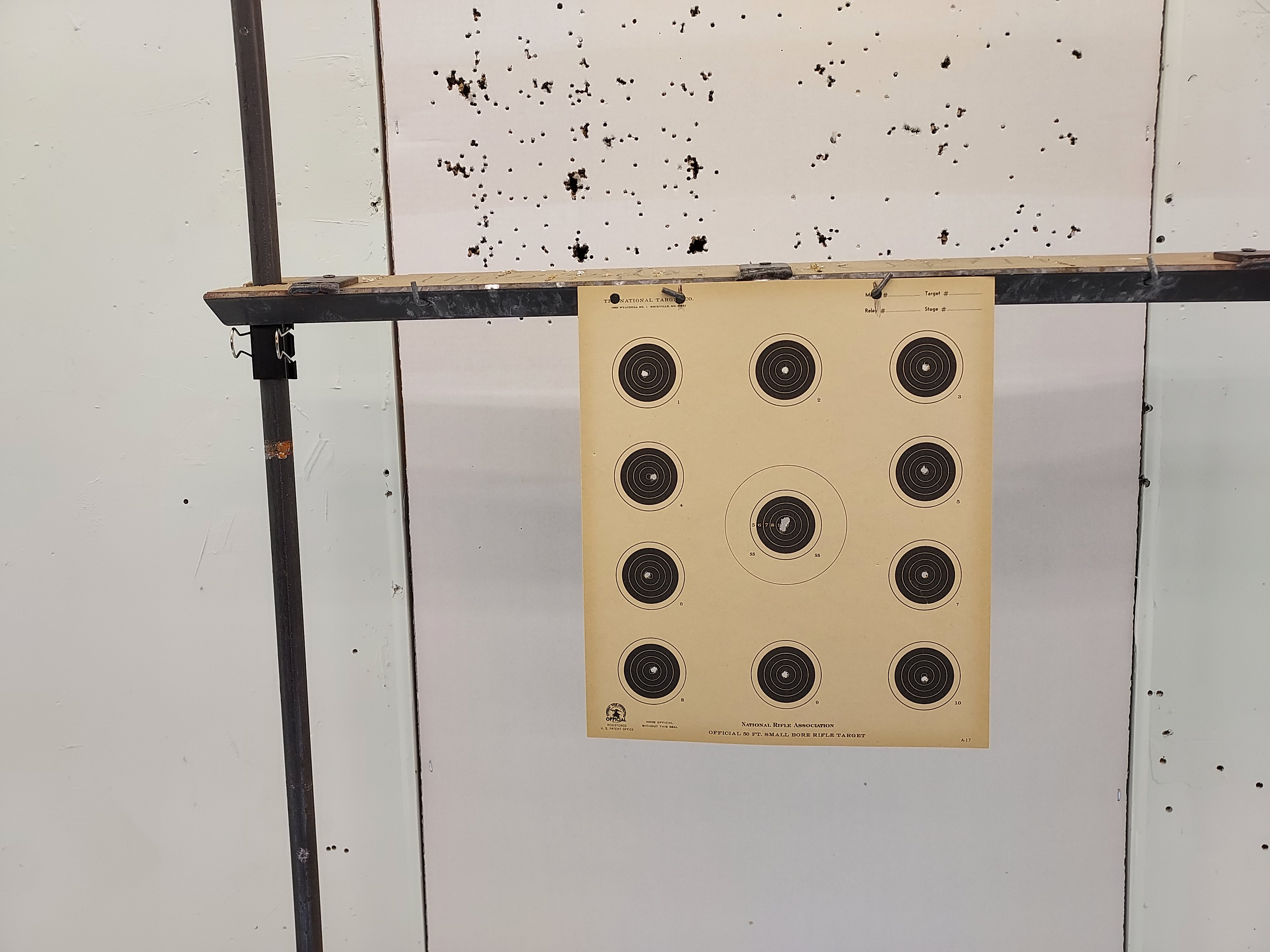

Now that I have finished tuning my Piatt/Thomas for the selected pellet, I have shot 12 cards with all record shots cutting the 10 ring indoors at 20 yards.
I have learned that 4 factors affect the POI:
1. Rest to rifle torque.
2. Regulator reset time.
3. How far the pellet is inserted in the chamber.
4. Sighter shot dispersion determines POA and therefore POI.
From reading Mike's posts, disagreeing with him, and then finally learning from him, and then applying what I learned, my scores improved and I became a consistent shooter. The most important lesson learned from Mike is that my sighter groups show me dispersion and to set my POA based on that dispersion.
The only time my POA is the center of the 10 ring is when I shoot my sighters and I always shoot 5 rounds per sighter.
