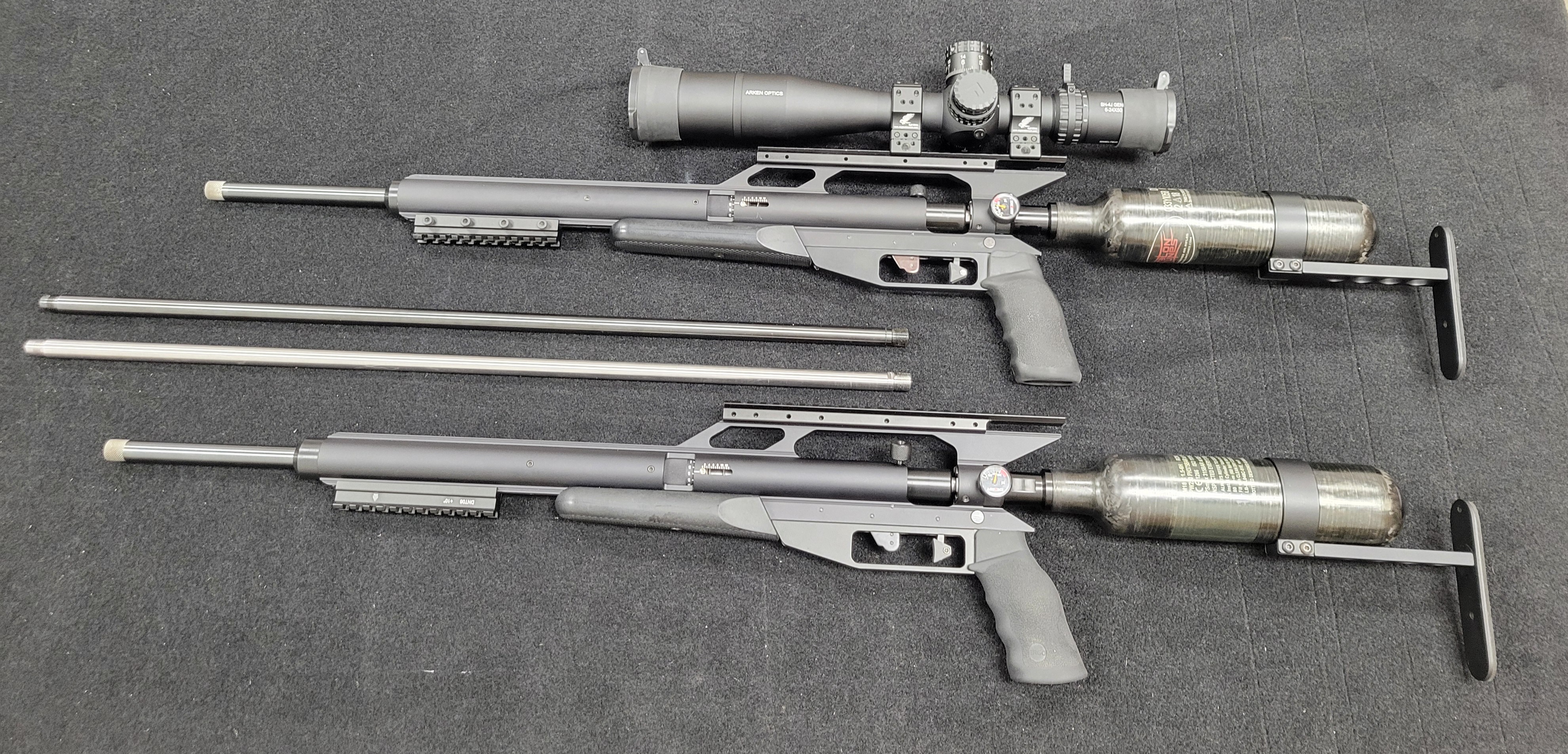

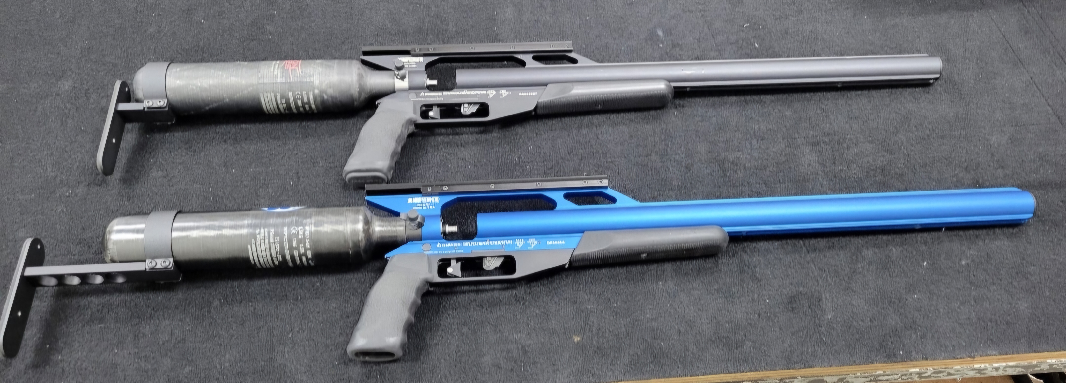

I purchased these pair of CZ unchoke.. .22 n .25 from talon tunes both are 1-17.7 twist for now both are using 70grams one pice hammer i also have a pair of 85grams hammers just in case. But the 70gram with the factory spring open the talon p valve at 3000psi without a problem.. in the pic both have factory 25" barrels.. those CZ are great since they don't have a transfer port all 700mm could be used..
