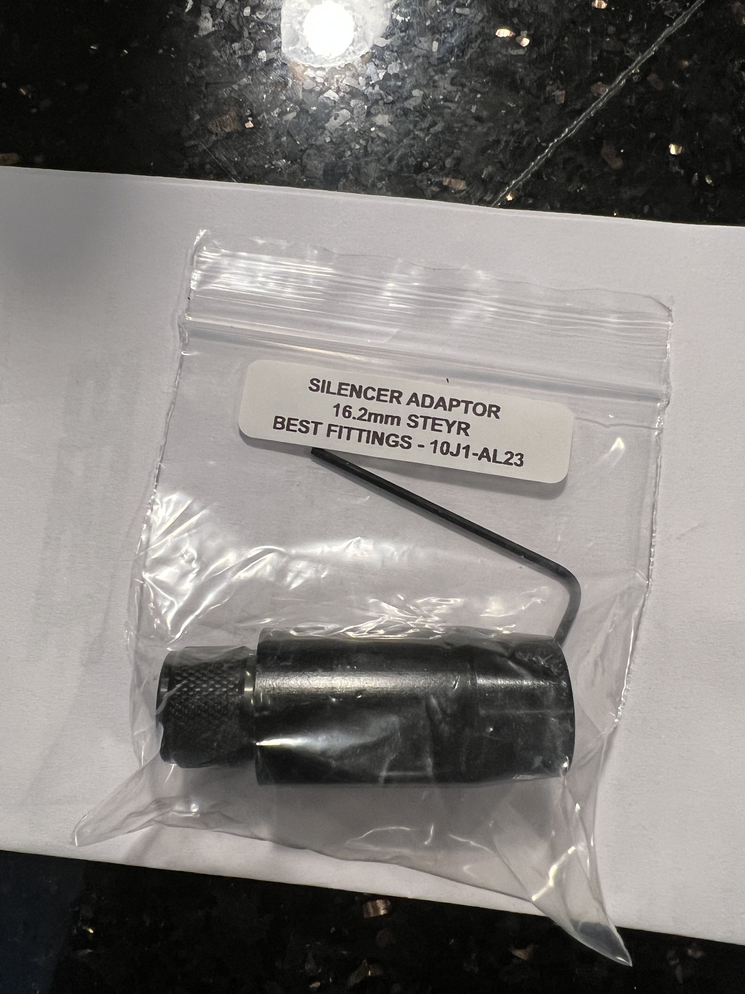

ya mean like this one from DonnyFlis there a 1/2-20 UNF male to male adaptor?. need this for my Huma mod50 to use with Edgun L2 Tri-Lug quick disconnect.
thank you so much for the response.. mine is a 30 caliber..there is no caliber choice to make in the DonnyFL page. Will it be compatible?ya mean like this one from DonnyFl
1/2 x 20 Double Male Adapter | Air Arms S510 Adapter | DonnyFL
Connect your airgun accessories with ease using the 1/2 x 20 Double Male Adapter. Perfect for Air Arms rifles and other compatible models. Shop now at DonnyFL!donnyfl.com
How long? And what diameter?Anyone know where I could pick up a 1/2-20 female to male extension, I can't seem to find any. One of my rifles I can not add a mod to as it hits the air tube.
Need to add about an inch in length the barrel of is just under 16mmHow long? And what diameter?
I checked w/ Donny and he says it has sufficient clearance for .3030cal ya say,,, I do NOT know if it will be OK,,, my adaptor measures .310" id, that is not much room
.005" clearance on each side, I would want to open it up a little more
you can reach out to Donny and ask
