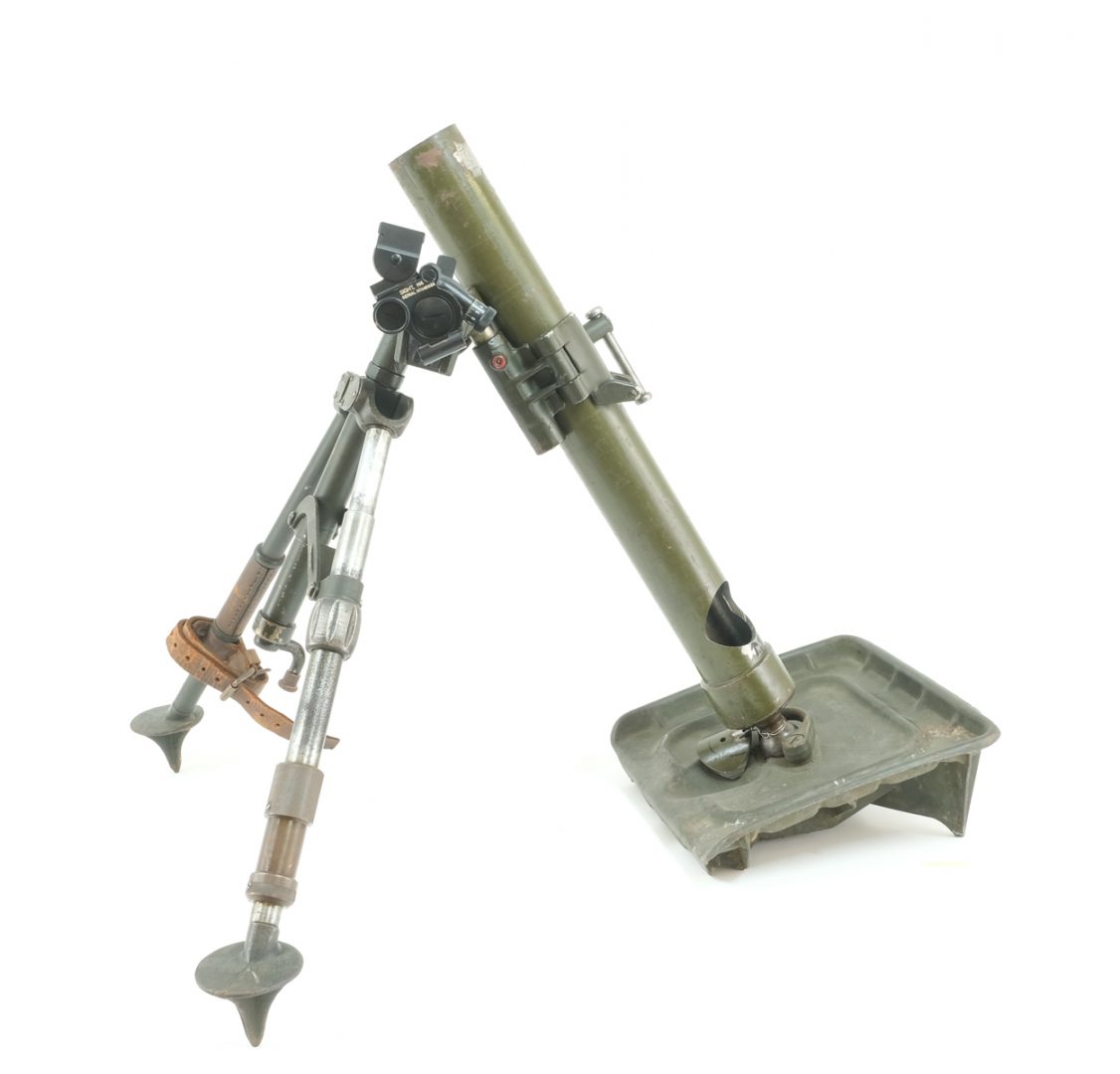

I don't understand how they can see through the scope with the barrel pointed at that angle up in the air. Crazy, but don't intrest me in the least.
It's that weird periscope looking thing on the end of his scope I believe. Otherwise he be looking at just sky🥴
Crazy angle.....straight up artillery launching style🤣🎩🤙

Reminds me of something, But I just can't put my finger on it. Nice lobbing!

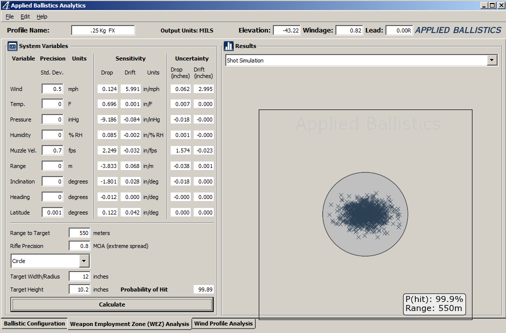

Now I will show you scientifically what the difference between accuracy and precision is in practice:
this is a screenshot from Applied ballistics analytics, a program used by the world's leading ELR shooters (King 2 miles competition,etc)
In this first picture is a model example for a 600 yard 4MOA target (I used one of my .25 rifles for it and MW 270 m/s 885 fps)
This is an almost pure simulation of the precision of shooting system, where I left only one change imput, the wind uncertainty + - 0.5 mph, all other inputs that are not related to airguns or slugs are turned off.
as you can see the probability of hitting a 4MO target at 600 yards (550m) is practically 100%

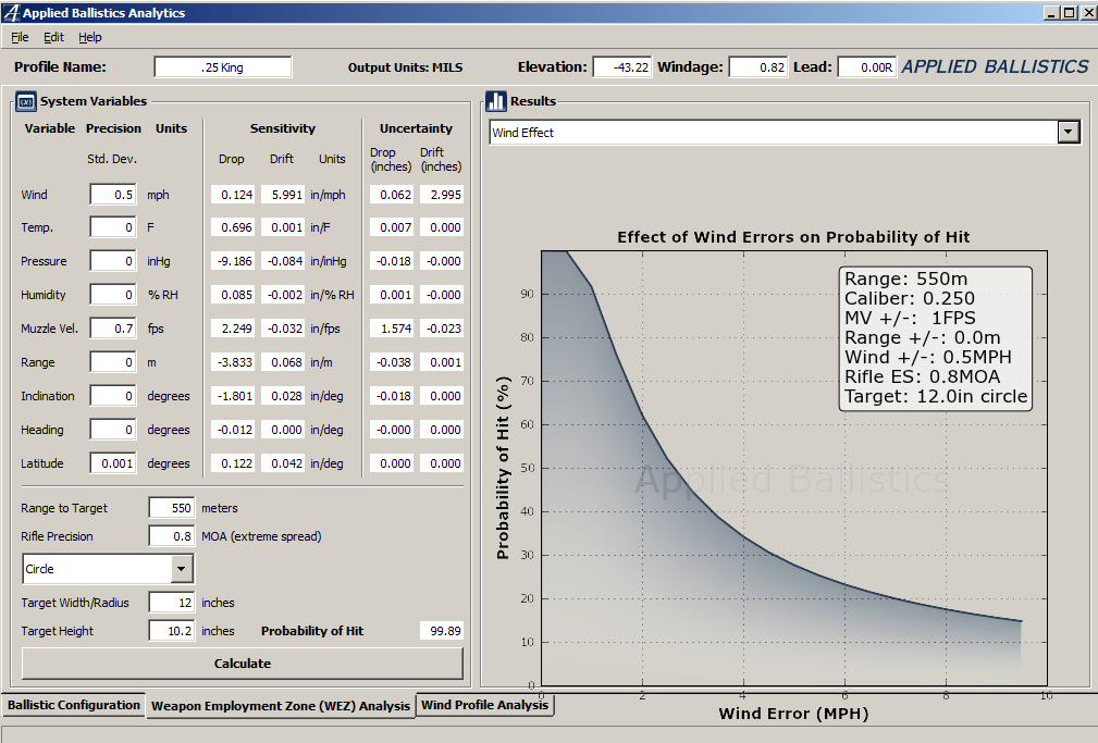

The second image shows how a 100% probability quickly becomes a lower probability if our estimate of wind strength changes from +- 0.5 mph to + - 2mph or more. (personally I don't think I'm capable of estimating better than + - 1 mph and I still like it a lot)
so even with an error in estimating the wind force of 2mph, we only have 60% of the 100% probability of hitting left
(accuracy of the rifle and slug remained the same, only the error from the shooter regarding the wind increased)

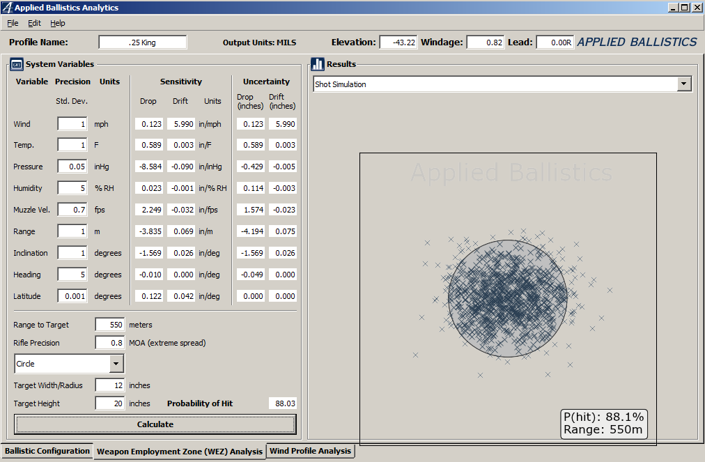

Now we will look at the case of accuracy for input errors as the program is set by default with the difference that we will use the wind error + - 1mph
This result is still very decent with a first shot hit probability of 88%. Unfortunately, this is still not a realistic case that is likely to occur in practice.

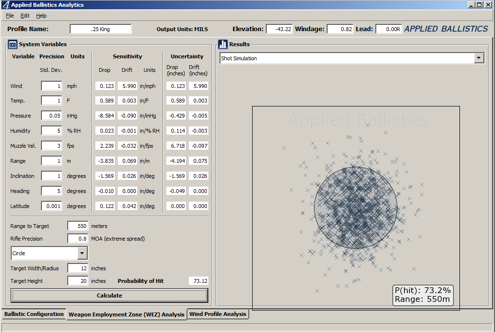

Now we will include one significant input error and that is the muzzle velocity variability, which we have increased from + - 0.7 fps (the standard deviation of this my rifle and slug when shooting like 20 shots in a row)
to + - 3fps.
This number is not random, but takes into account both the precision with which the muzzle velocity of the given system was measured ( precision of the chronograph measurement) and the fact that the muzzle velocity changes as the barrel gradually becomes dirty. Not to mention that if the rifle had not been fired at all for a long time before, then only temperature changes (change in pressure behind the regulator) can cause greater deviations than the deviation given here for all the imput error above.
so suddenly we have only a 73% hit probability from 100% and unfortunately we still haven't counted all variables imput.

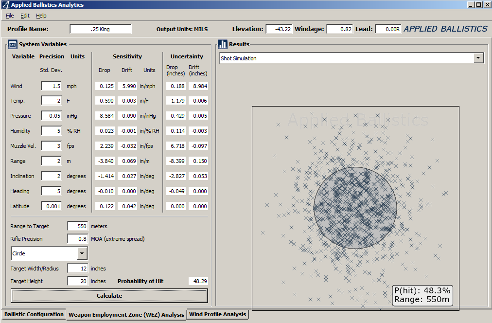

This is what the average chance of a hit might look like for a shooter using reasonably decent gear and able to estimate 1,5mph winds and have a really good riflescope:
So the reality is that from the 100% success rate guaranteed by the given shooting system, the probability has been reduced to 50% thanks to individual errors, whether by the shooter or the equipment.
it is an equivalent shooting parameters like this one, or from the point of view of flight time, I was longer by approximately 1s. From the angle point of view, it is true that I had 130 mRad more (95 vs 230) ;)
