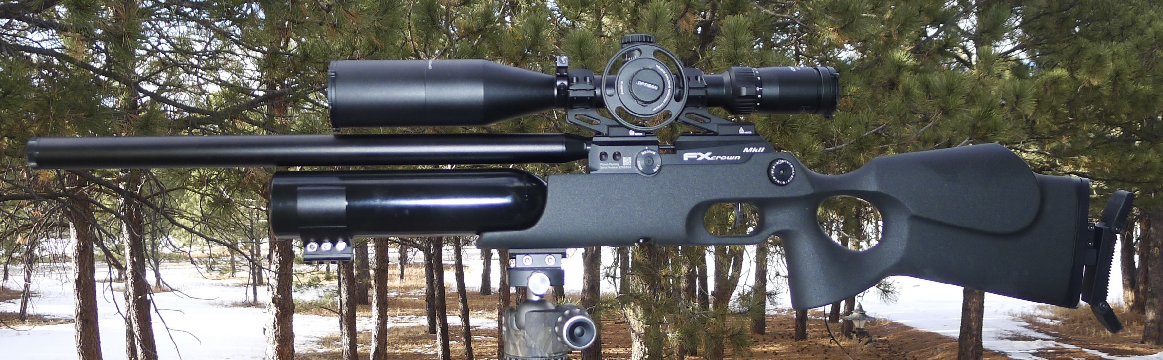

A few years ago I tried to buy a Crown when they updated the MK1 to 4 barrel hold down screws but after a three month wait I canceled that order and bought a Dreamline Classic in .25. The DL is a good rifle and I have it shooting 33.95gr pellets accurately with 60fpe. I’m 75 years old now and changing over to .177 because I am restricted to my home range and I like the challenges of the .177 pellets. My range is setup to a maximum of 90 yards.
Nine months ago I put a 600mm .177 barrel in my Impact MK2 PP and was impressed with it’s accuracy (despite all the negative comments on the FX .177 barrels). Was going to buy a .177 conversion for the DL but noticed UA had a special on the Crown MK2 VP so I bought the Crown. Received my FX Crown VP .177 on 7 Jan 23 from UA. Had UA install a picatinny rail to stock. I installed Saber Tactical picatinny to ARCA rail adapter. Also installed Saber Tactical bottle mounted picatinny rail. Mounted Optisan EVX 5-20x50i scope in Eagle Vision adjustable scope rings.

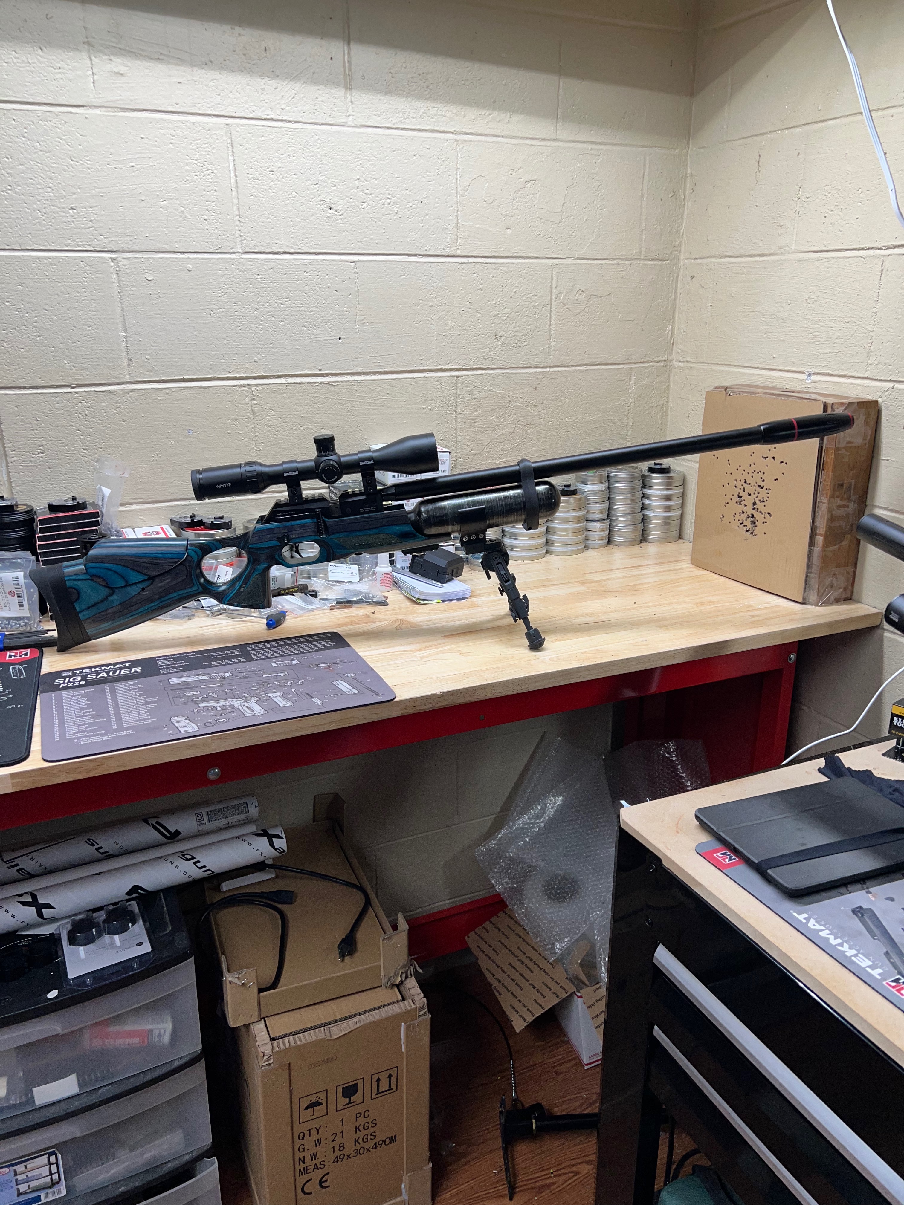

Changed the scope rings and fitted a K&L KLS-M butt plate for a better ergonomic fit. Had a window to get the Crown on the bench (enough snow melt to get on the bench and to get a target on 30 yard target stand). Six - five shot groups averaged 0.48” (measured from outside of most distanced pellet holes) with one group at 0.32”. For me this is great accuracy as I’m the limiting factor in a rifles accuracy (and I was cold).

Nice set up. Looks really good. If I had better hands I wouldn't hesitate to get a .177cal. I am always very interested to hear what pellets and slugs work well in the .177cal Crowns though.

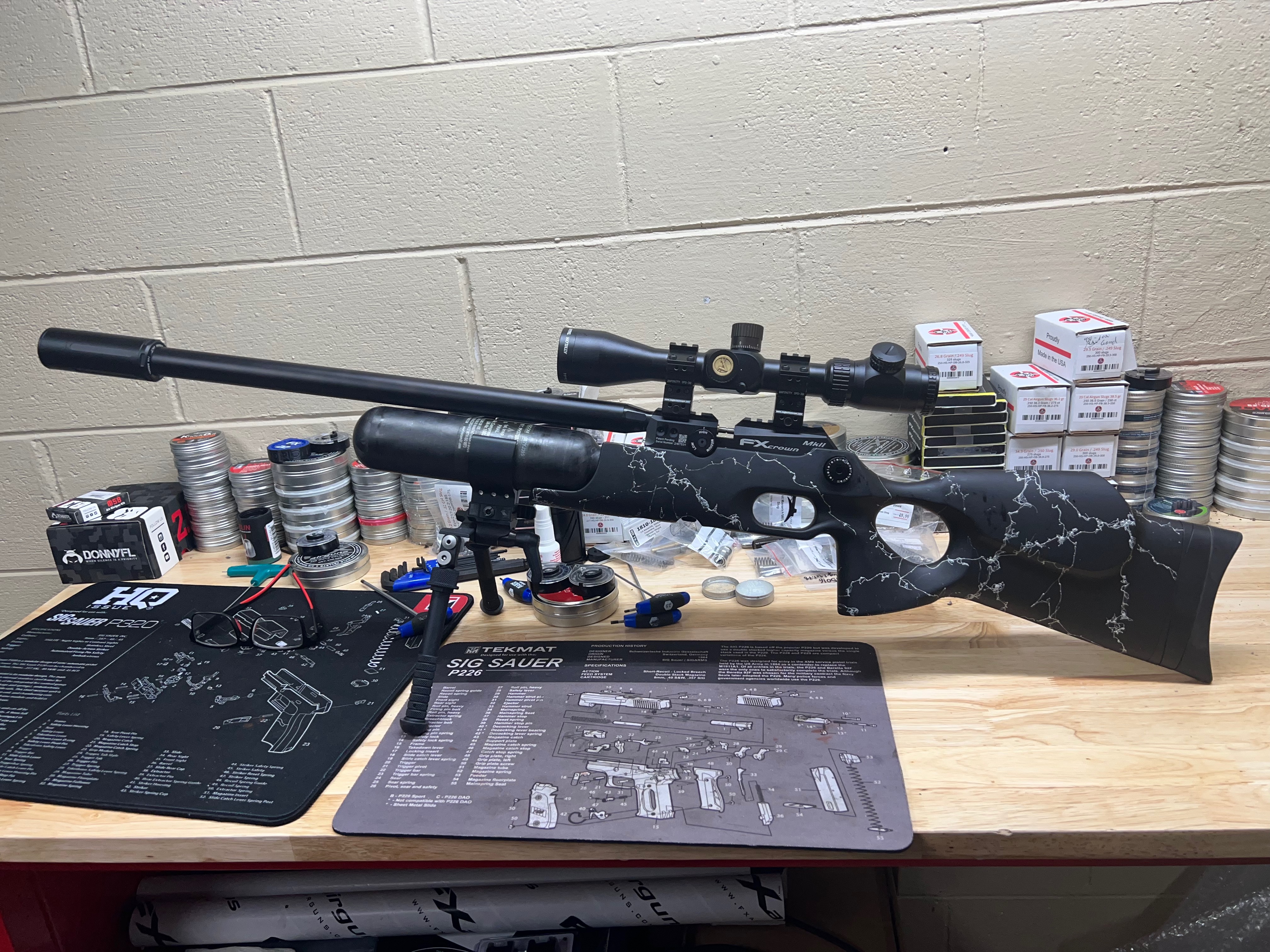

I bought 2 Mavericks when they first came out. Next I planned on buying an M3, but got side tracked and bought a Crown MKII. Then I bought another one, and the other day I almost bought another one. They are really light and have a great feel to them as well as easy to shoot. You will enjoy it. I bought the one below used from Utah Air on Black Friday. I was all ready to buy the VP Refurbished version when this one came up for the same price with the scope and mounts. It's a 22cal. Right now I am waiting on Bullet Central to get back in stock the Carbon Fiber Shroud and tensioner kit for my 600mm .25cal version, which, hopefully work great.
I'm not a fan of pre-ordering airguns but if a Crown MK3 came out, I wouldn't hesitate to get on the list.
Love my walnut 22cal mk2. The ergonomics are perfect for me. It shoots so well off hand, I struggle to find something better. I converted mine to a 380 barrel to help with maneuverability while trekking through the woods, and it really makes a sifference to the feel of the rifle.
