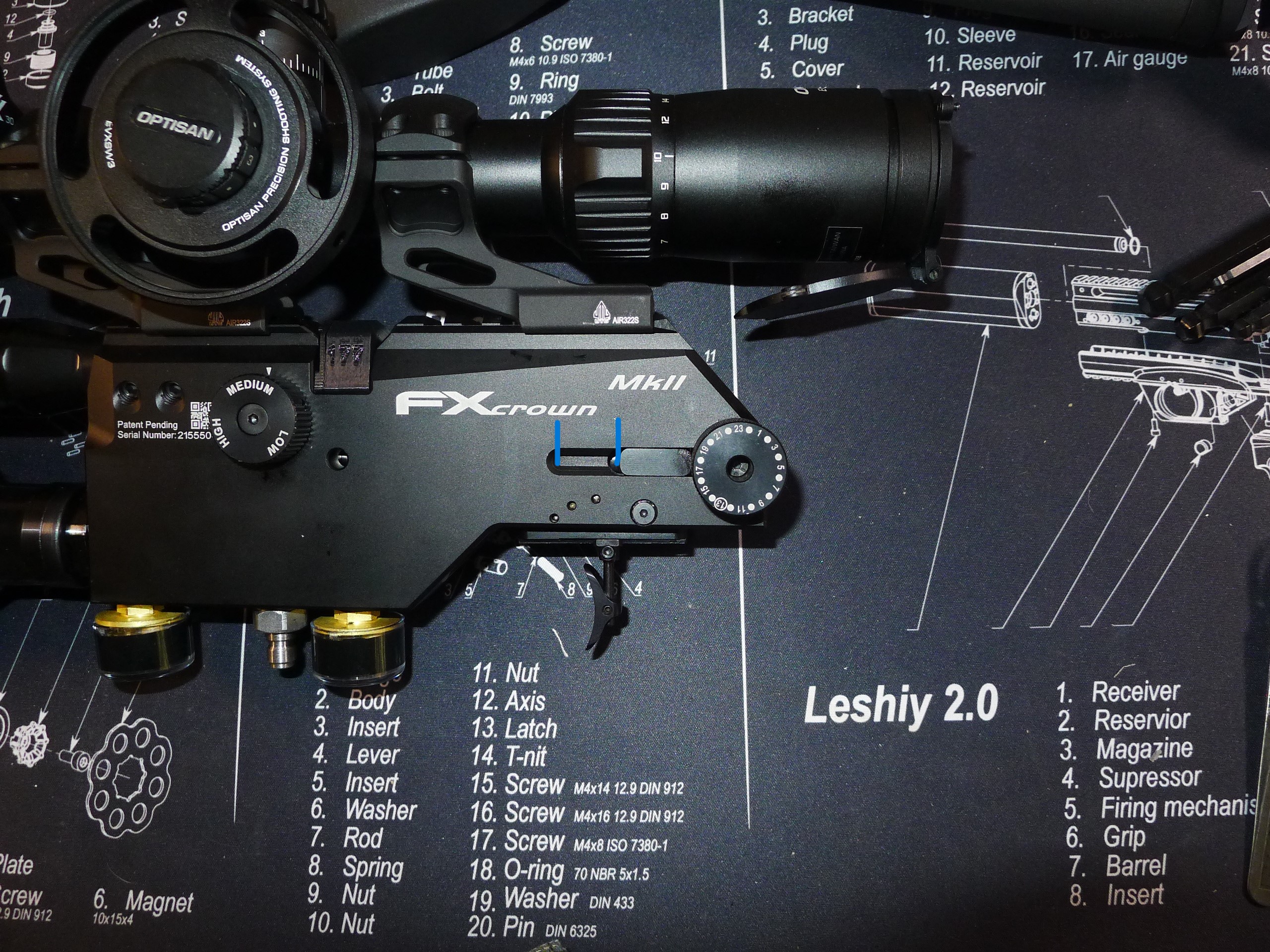

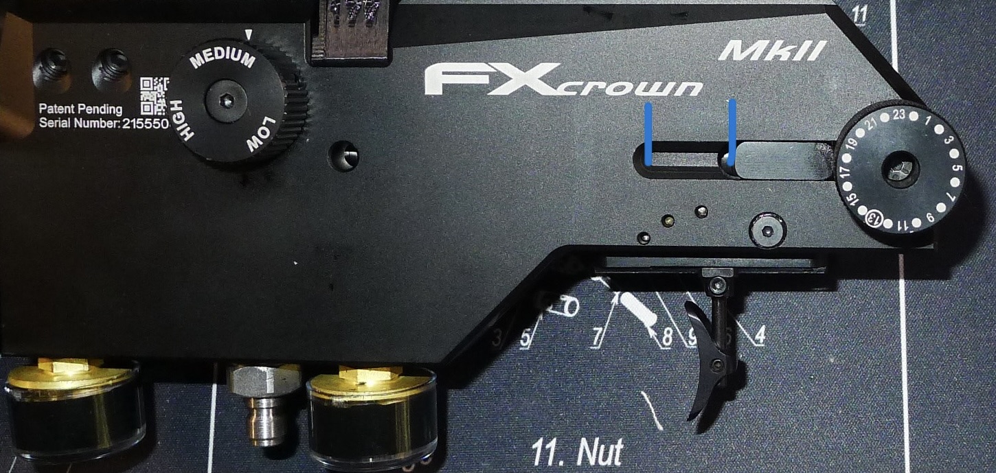

Original hammer spring adjuster was at .725” for the 98 BAR regulator setting. Final adjustment has it at 0.659” for the 120 BAR regulator setting. See picture to see what I am measuring/adjusting.
Still had enough snow to keep me from testing accuracy. That will have to wait until next week (hopefully).
