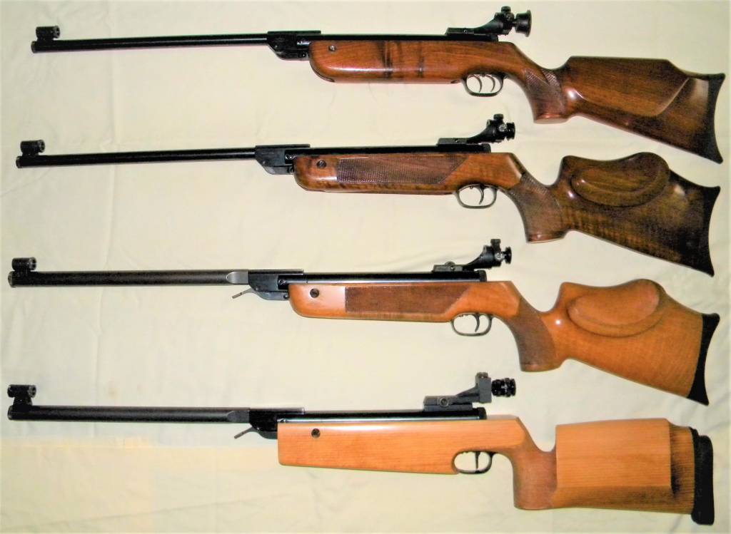

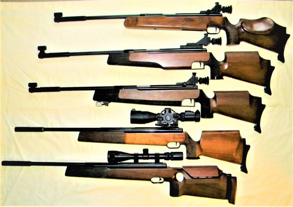

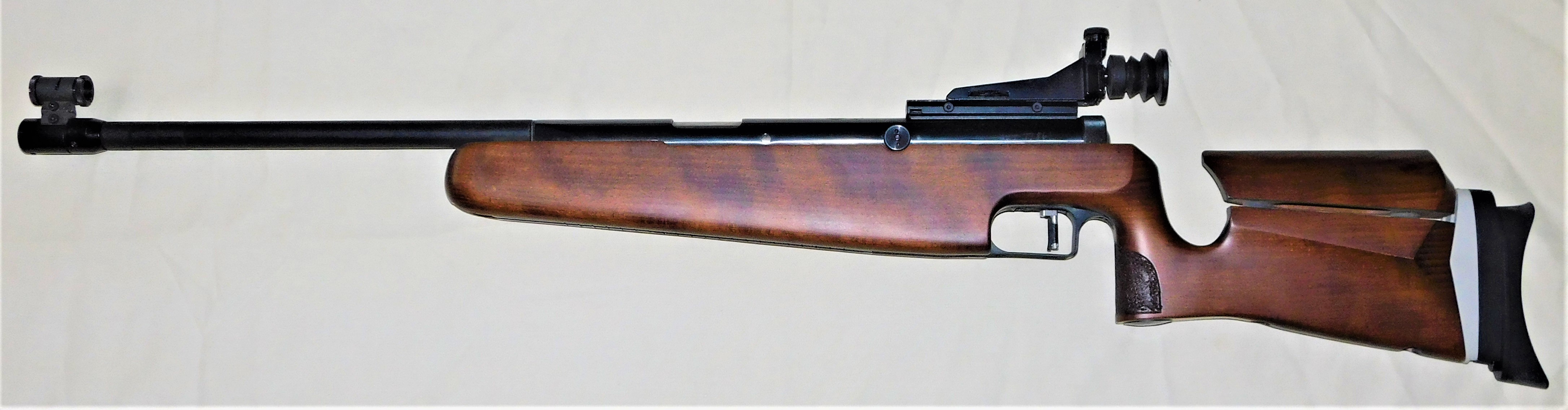

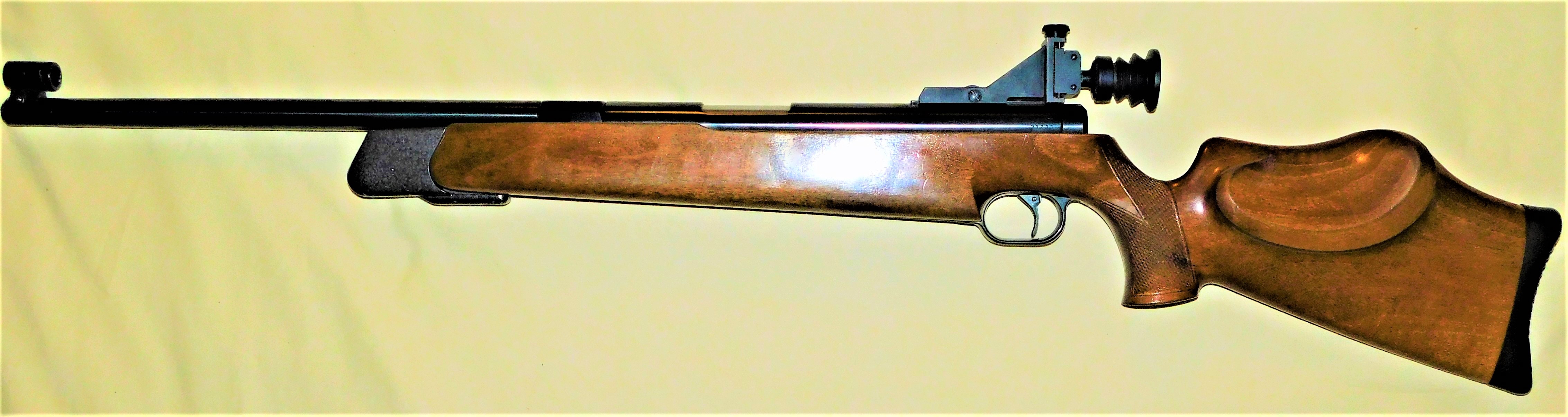

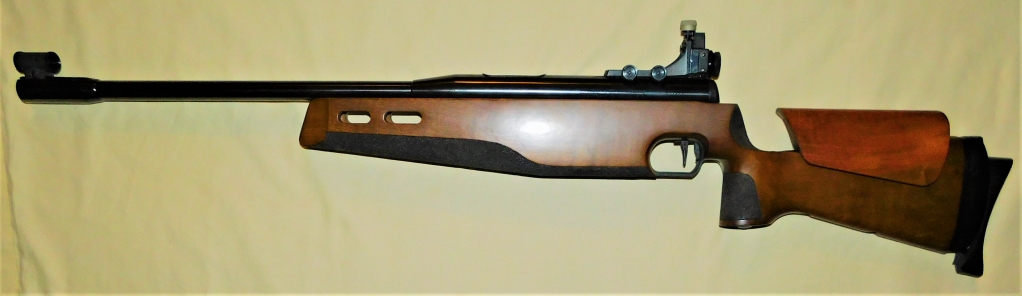

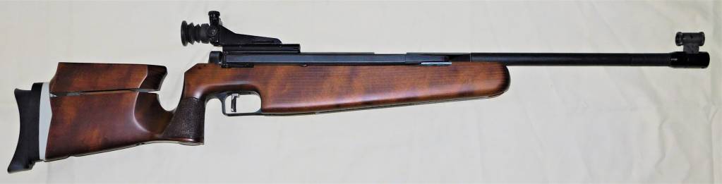

Some of the best built and best looking springers out there for me. None are powerhouses but they were never meant to be, precision though they have that to spare!
Walther- LG55 DST & Tyro, LGV Tyro & Special
Weihrauch HW55 SM, MM & Tyro
FWB 300S- Tyro, Universal v1, Match L, Running Target v1, Running Target v4
FWB- (top) 65 Mk2, 80 (bottom) 65MkI & 90

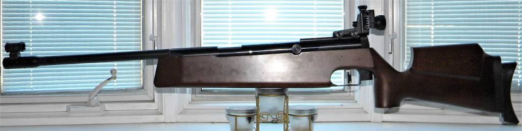

Anschutz- 380
Diana- 75B

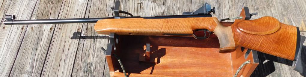

60T
10

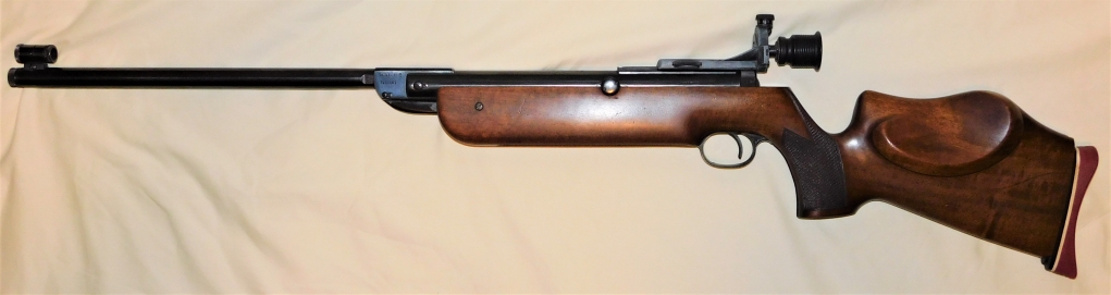

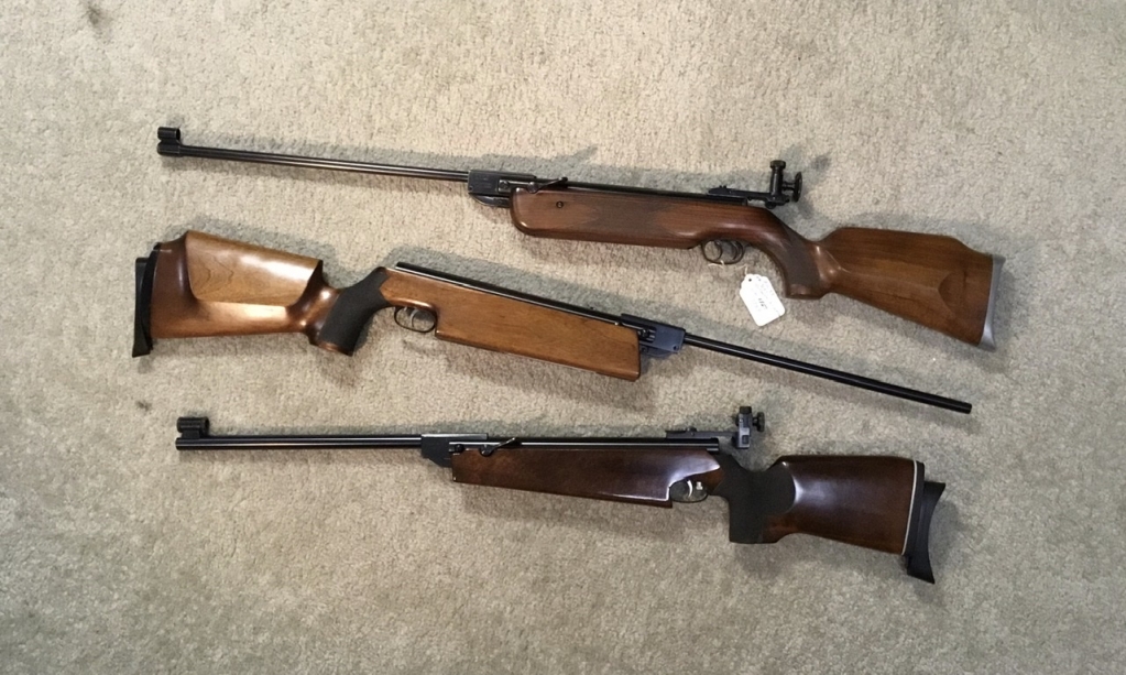

Beeman 800/Diana 6 with rare wire stock
Amazing collection of airguns.

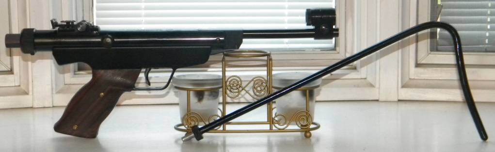

How they did it before there wuz recoilless guns, LOL.

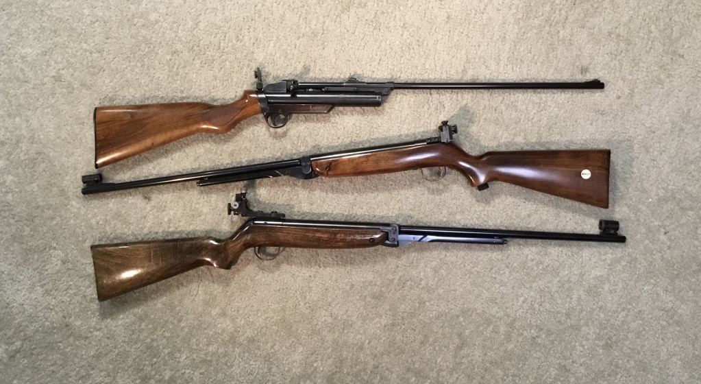

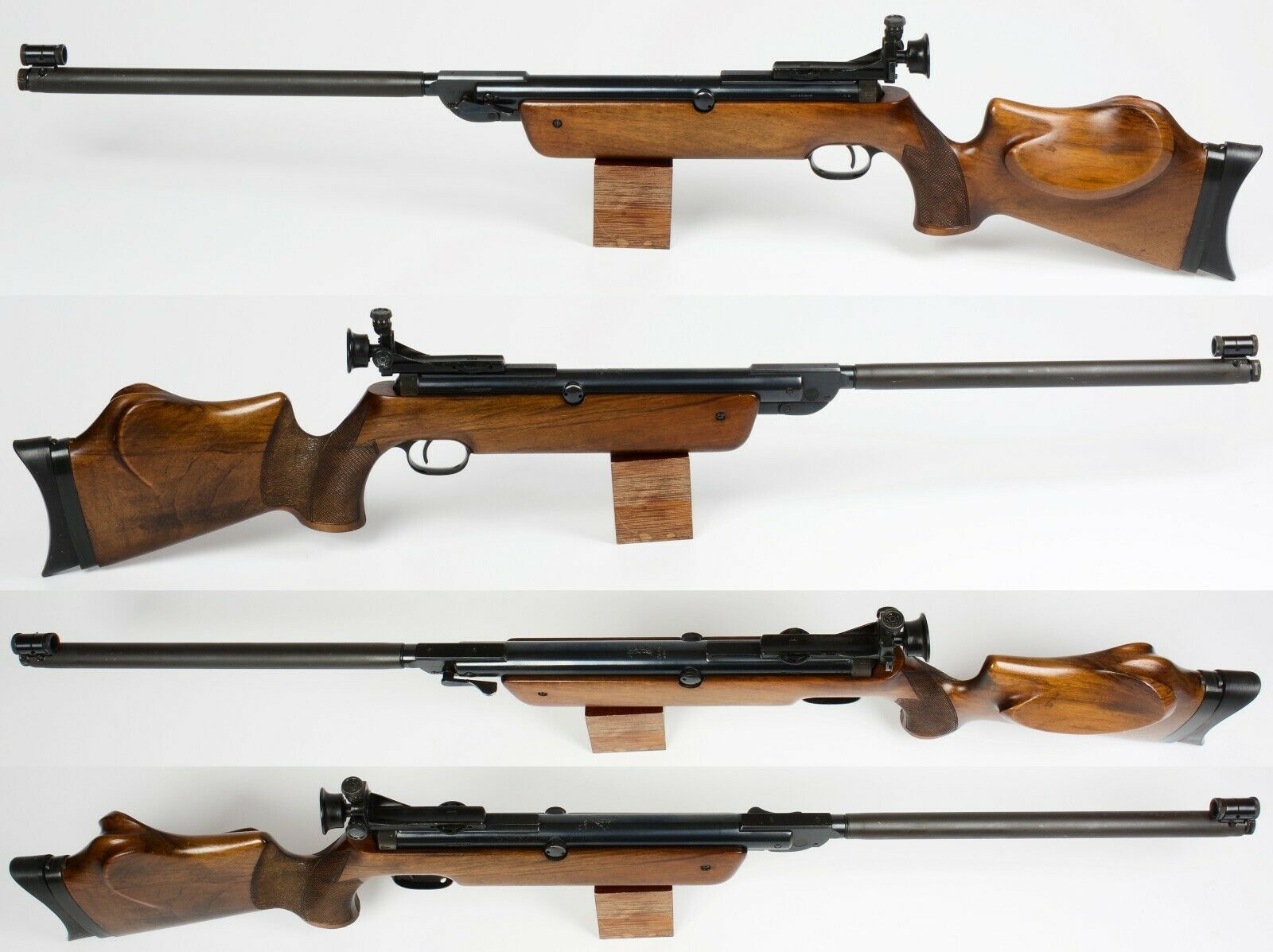

Webley. Top to bottom: Mk 2 Service with peep deployed; early Mk 3 Supertarget with Parker-Hale sights; late Mk 3 Supertarget with Anschutz sights.

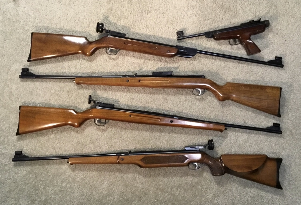

Weihrauch. Oddball HW 55's: early "short block" 55 M with double-set triggers; left-handed 55 CM; "HWB Champ," - Ambi junior model with shortened stock and short sleeved barrel.

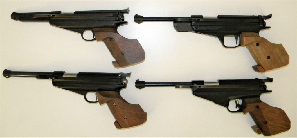

Diana. First post-war model 5 pistol with wood frame/grip; Model 35/b; model 50/a; model 50/b; model 50M.

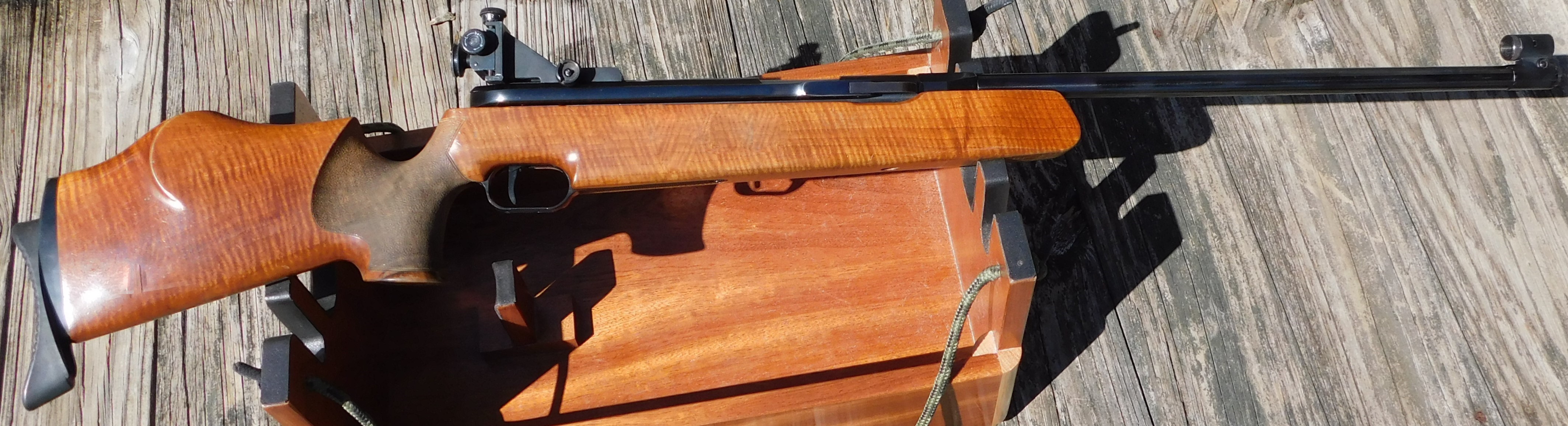

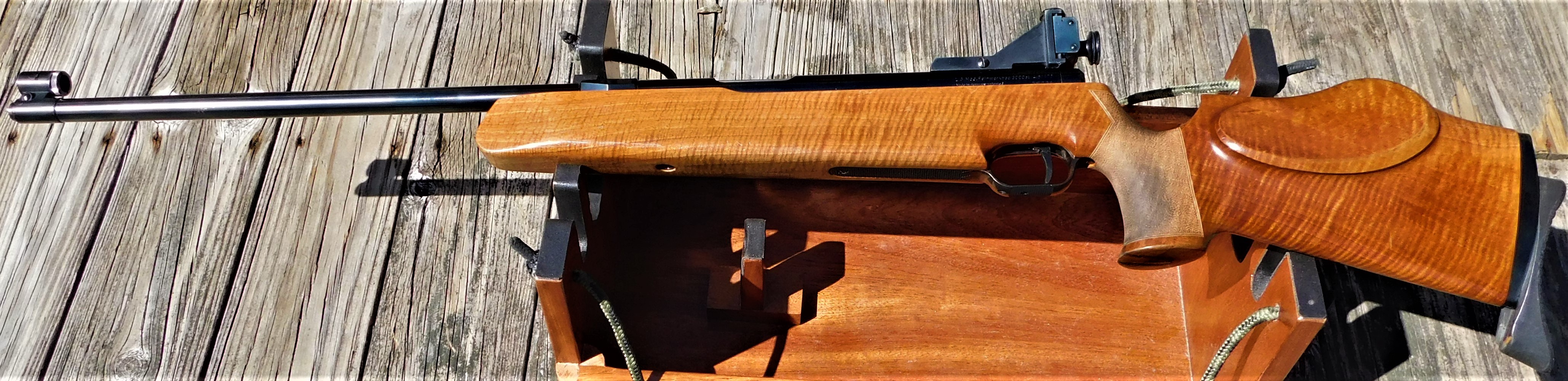

Lefty 55M Hmmm my list is getting longer .
