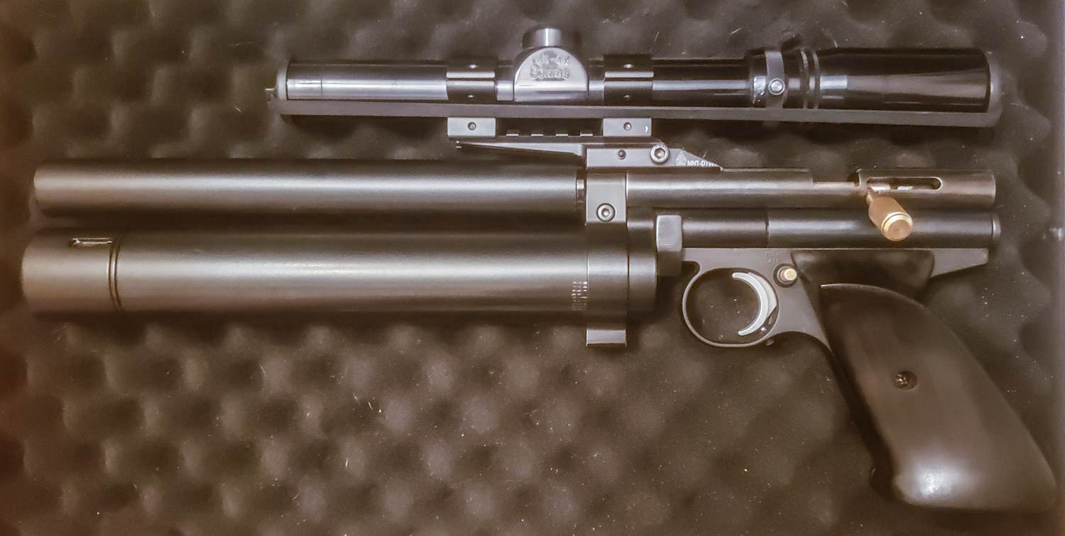

here’s my MA 2040
Deadly accurate with .20 FTT’s

Has integrated mod, so barrel stops half way down the shroud.
