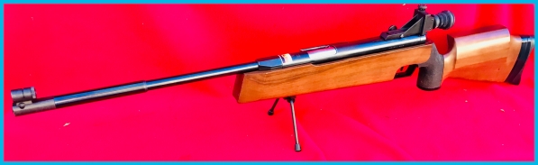

researching a 10 meter rifle for my 12 year old son. He is in a NRA sponsored club shooting the three position. Right now he is using an Anschutz 8001 that is provided. I have looked in al the typical sites for what is offed and the pricing. Thinking 2 k is about the limit right now.
Just need your feed back in your rifle experience. Or maybe you have one for sale ?
Thanks
1542750418_20860835665bf480d2c2d992.97200545_650599AF-578C-461D-BFF4-26BA4CABD238.jpeg
You can buy very nice FWB300 rifles on the AA Classifieds...
Shooting 3 position you need to stick to a pcp for ease of cocking in prone. Going with a cheap gun will be a frustrating downgrade from the 8001. I advocate putting a youth in the best equipment you can budget so they can progress rapidly and you don't have to upgrade as many times. Look for used 10M guns from Anschutz, FWB, Steyr, Walther on the classifieds and Target Talk. The quality on those four brands are pretty comparable, it all comes down to personal fit and feel preferences. Buying a quality jacket that fits properly is money well spent too and will be reflected in the scores.
